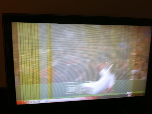

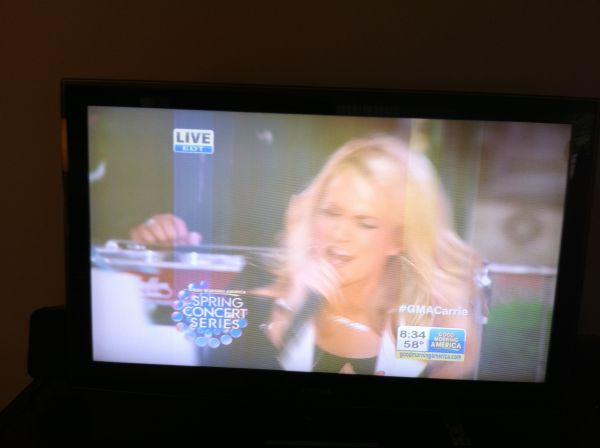

    Found this TV on craigslist and I have never seen this kind of problem before, so I would appreciate some help. Thank you.

    I dont like the looks of that problem. It may be a tcon board or it may be tab bond issue. If you can get it for $40 or less - go for it.
      Re: Samsung LN-46B610 possible purchase
      I agree, if you can get this 46" for $50 or so, then try the T-CON first, it is either T-CON or the panel.

        I'm scared about the panel part, I already had three TVs with bad panels.
