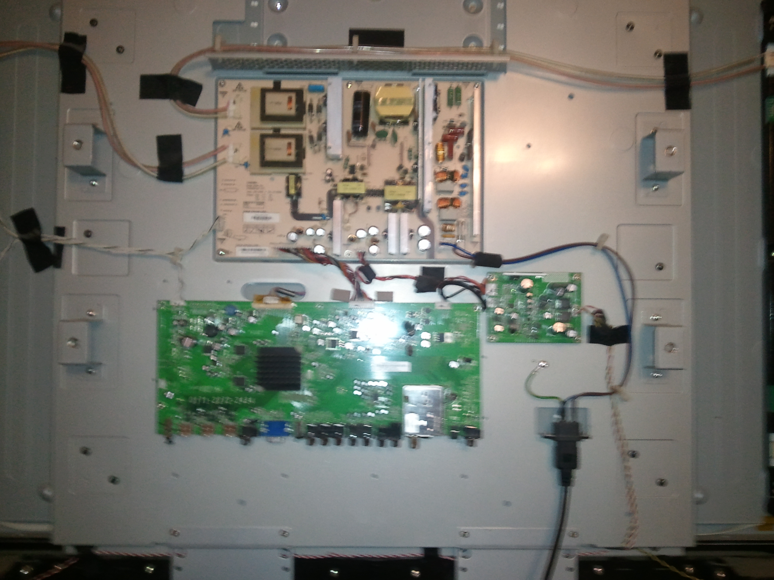

    Hi guys my name is Ronnie and i have another vizio that want turn on. I do have amber light on front. I got this tv from girlfriend that had a lighting stri. I took back panel off and checked fuses and all were good no blown caps or no burnt spots on board. I had 5 vdc on ps board but no 12 or 24v. Now heres the wierd thing put ps board back in tv and it powered up about 4 times and stopped again. I need some help to lead me in the right direction troubleshooting this problem!

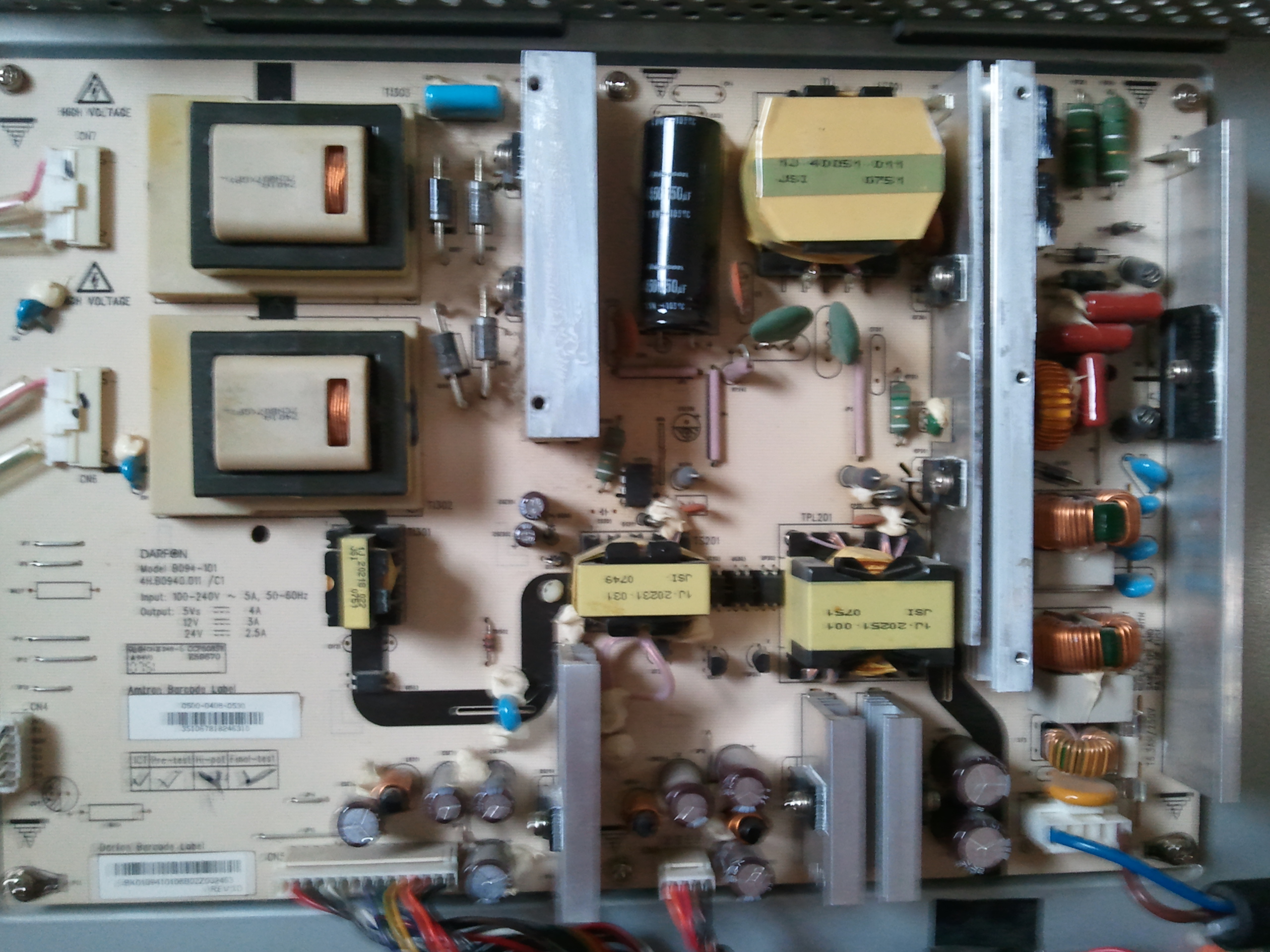

      Please post GOOD CLEAR AND FOCUSED pictures of both sides of the power supply board, closed up pictures of the connectors (power supply) so we can read the labels/markings. The whole back side of the TV so we can see how all the boards are connected together.
      Right now you may not have the PS_ON signal from the main board to turn on the main power supply sections.

        Re: Vizo VW46LFHDTV10A want turn on
        i have seen two of these in the 42" versions with bad solder joints at the power connector. dont know if they use the same psor not but might be worth a look to see if you have a bad connection on the back of the board where the pins go through.

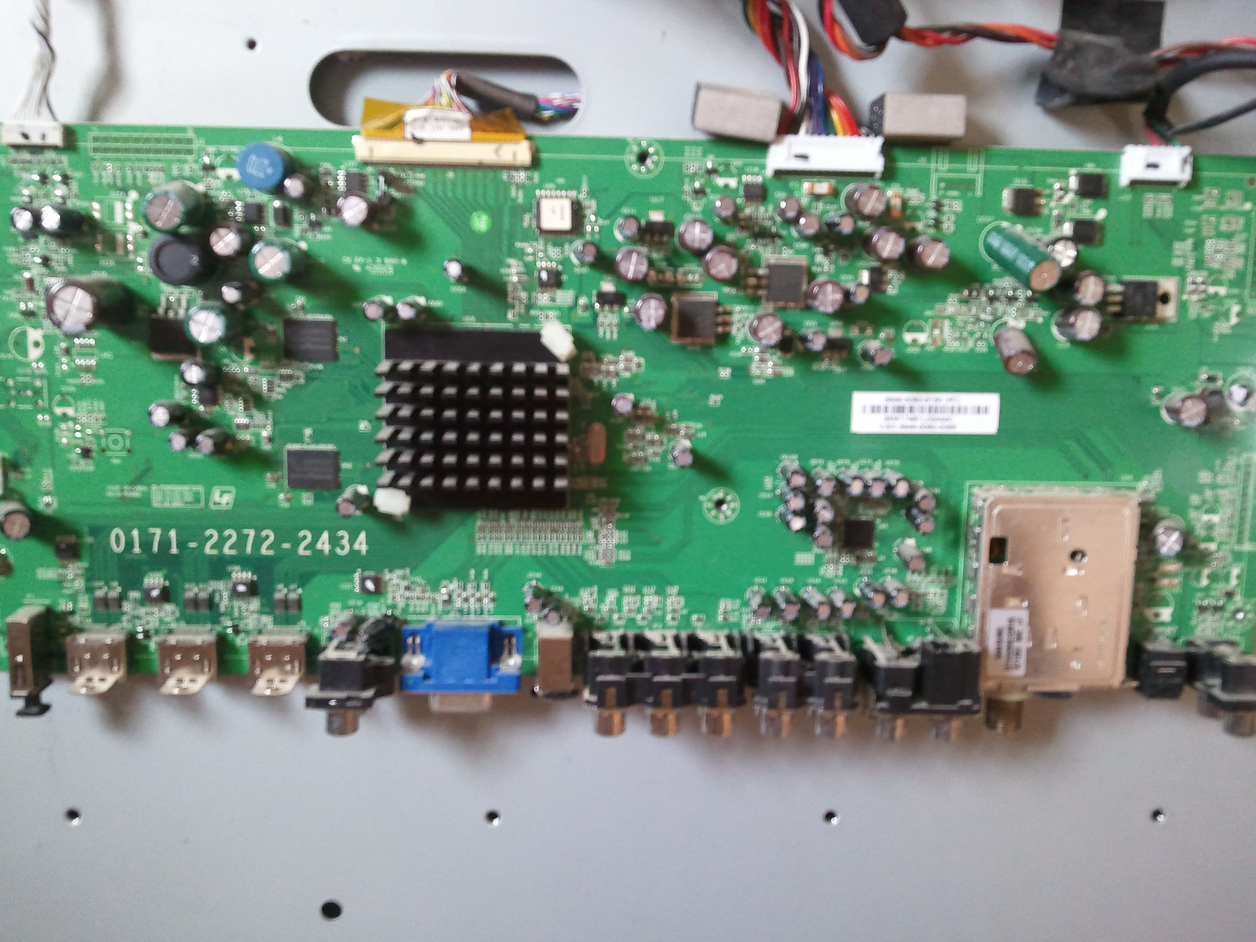

          OK I got to computer so i can post picturesso lets see if they are good enough from my mobile. I did not take any of the back because there were no burnt spots. Let me know if this is good enough. Thanks

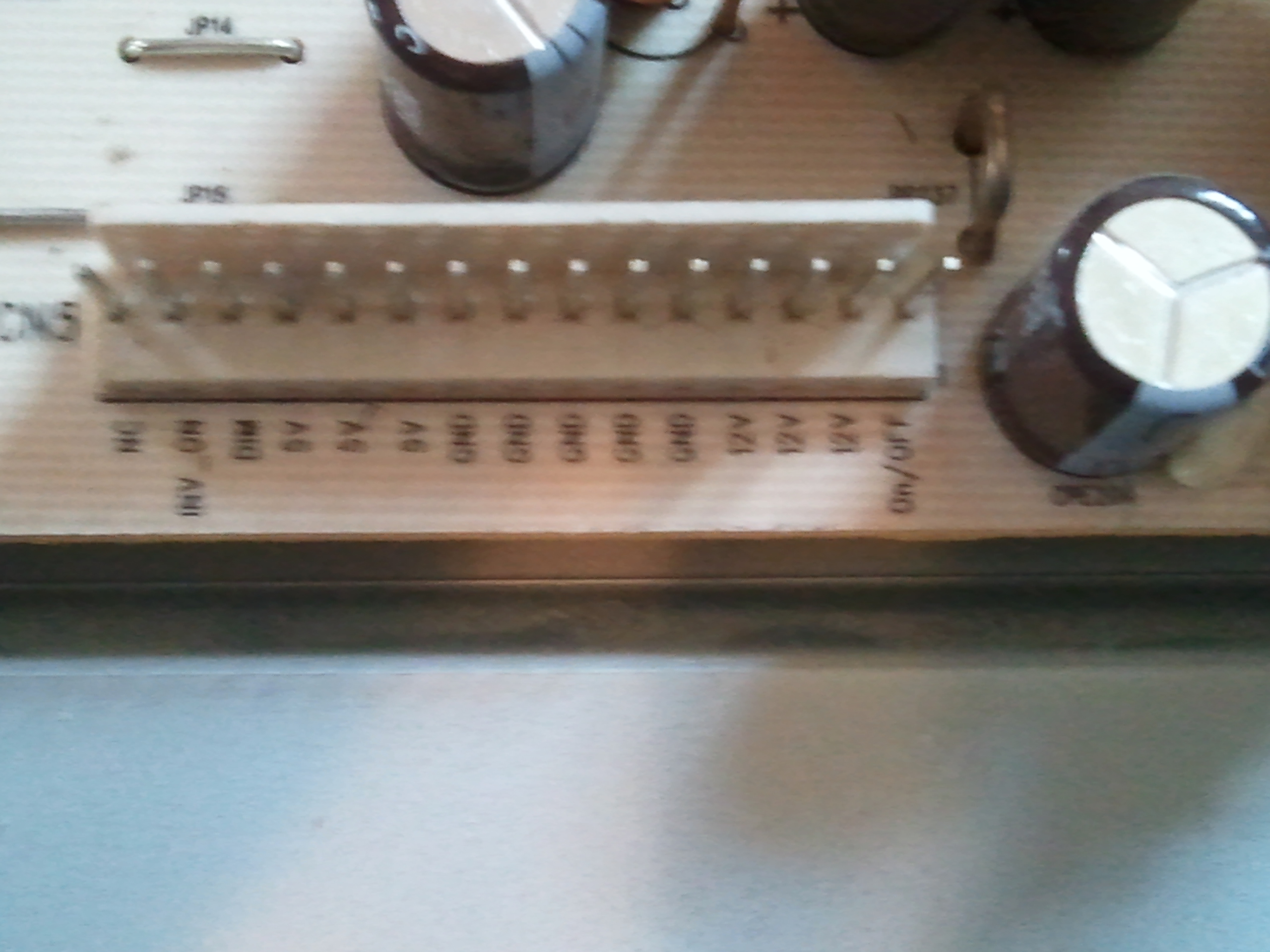

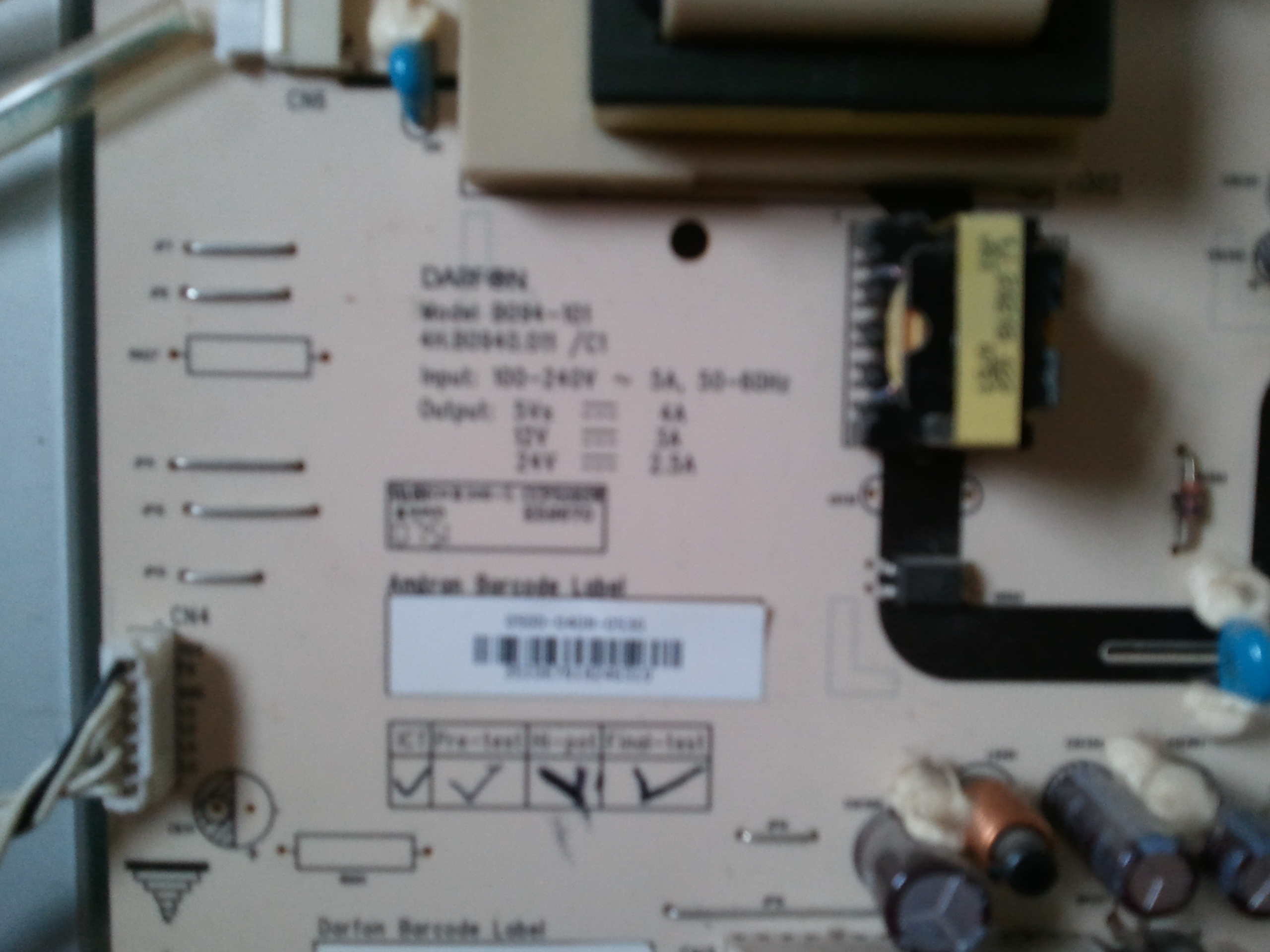

              Well, I cannot read any labels on the connectors of the power supply to see what the pins are, way out of focus.
              We are trying to troubleshoot the problem without having the boards in front of us, so good clear pictures are a must. I cannot help you much at this point since I cannot tell you where to test the voltages.

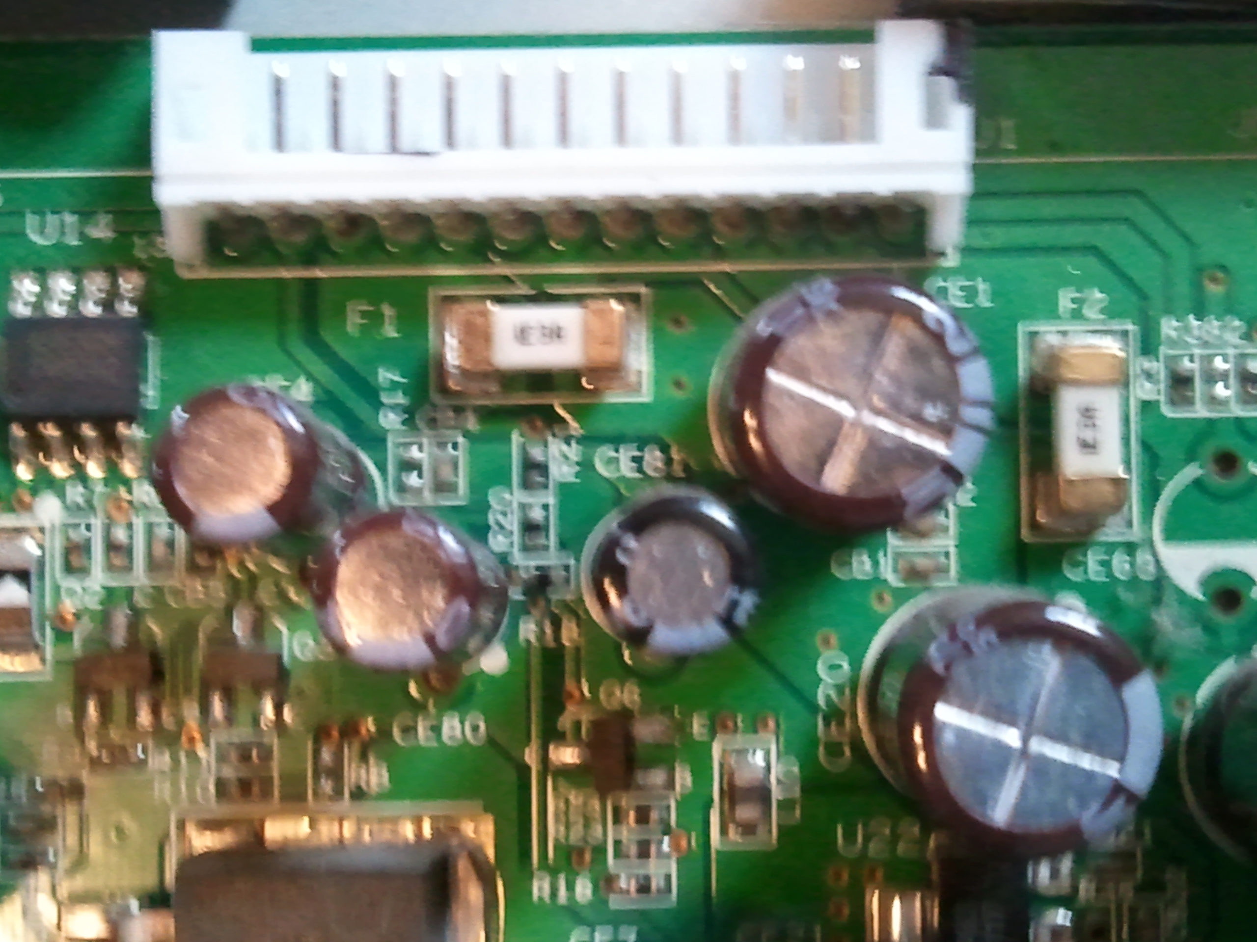

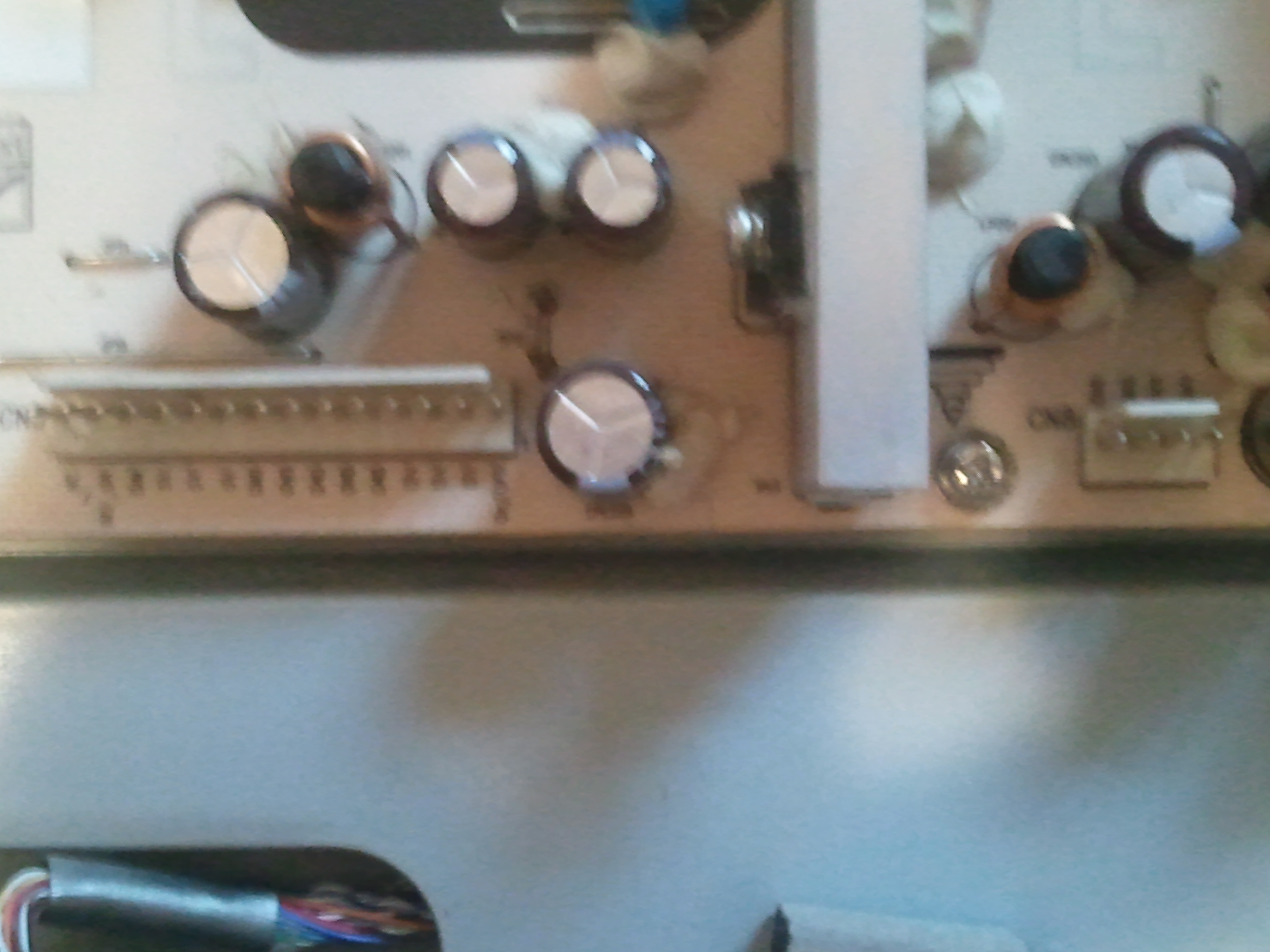

                Here`s a couple pics of connector. Please let me know if you need anymore

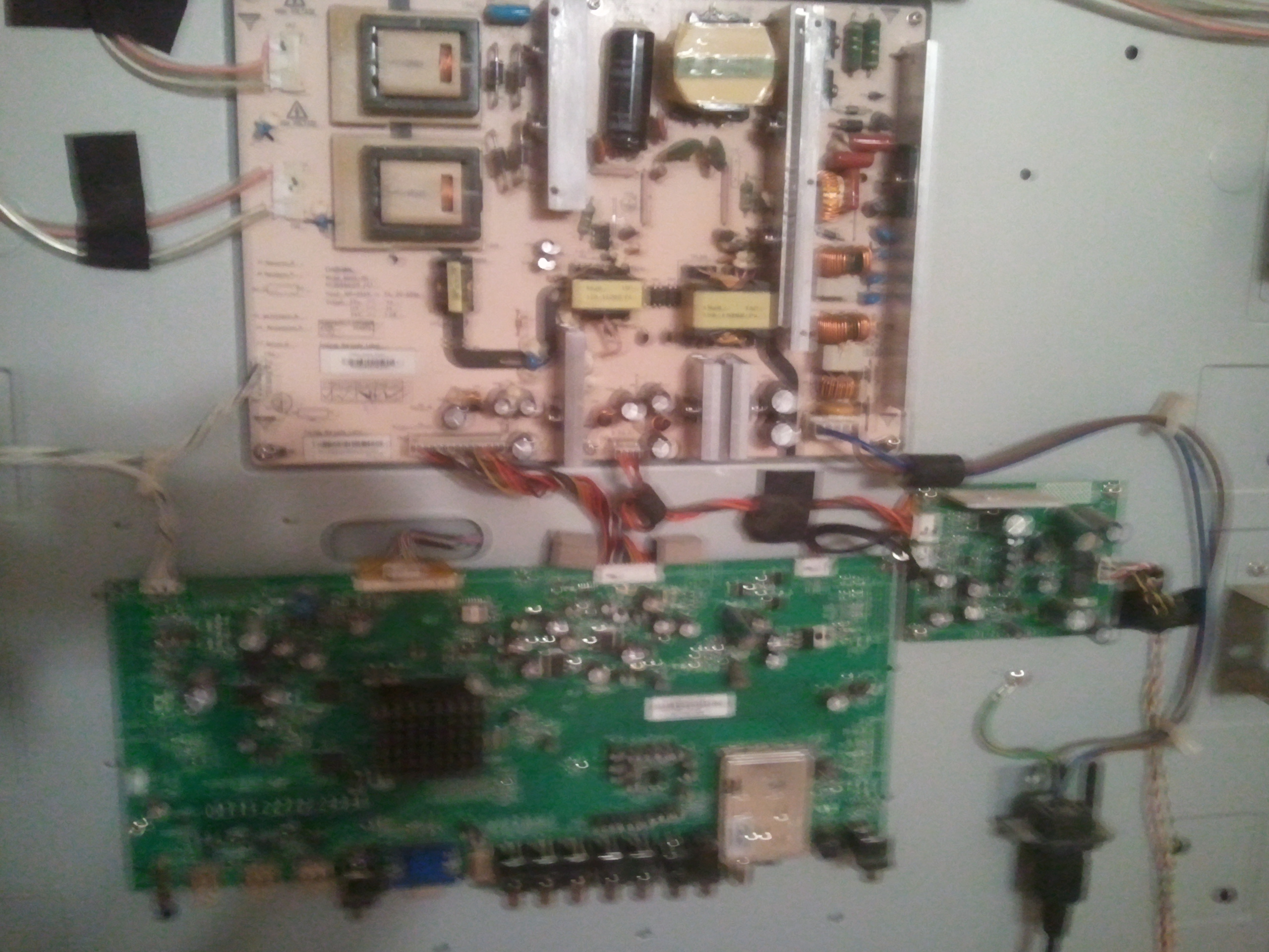

                  Pictures are not much better perhaps the second one will be clear enough for Budm
                  In the first one have you tested the fuses?
                  Have you checked the mains input pins as suggested by awyatt2
                    yes the fuses are good and which connector would you be referring to with the mains
                          Ok - In Pic 2 the end pin is marked on/off - with it all connected up can you plug it in but do not press power on and see if there is any voltage on that end pin. Set meter on 20vDC and put black probe on an earth screw and use the red to test on the pin. Actually you may as well do the whole connector list the results as:
                          Pin Name Actual
                          1 on/off 2.13v
                          2 12v 9.65v and so on.
                          Then do the test again after you press the power on button.
                          Then switch it off
                          You may need a helper for the next test. Again you have to measure pin one
                          same as before but hold the probes on the pin and ground and observe what happens when the power on is pressed.
                                Check your voltage regulators on the main board. See my sig file below on how to test and report the readings in the specified format.
