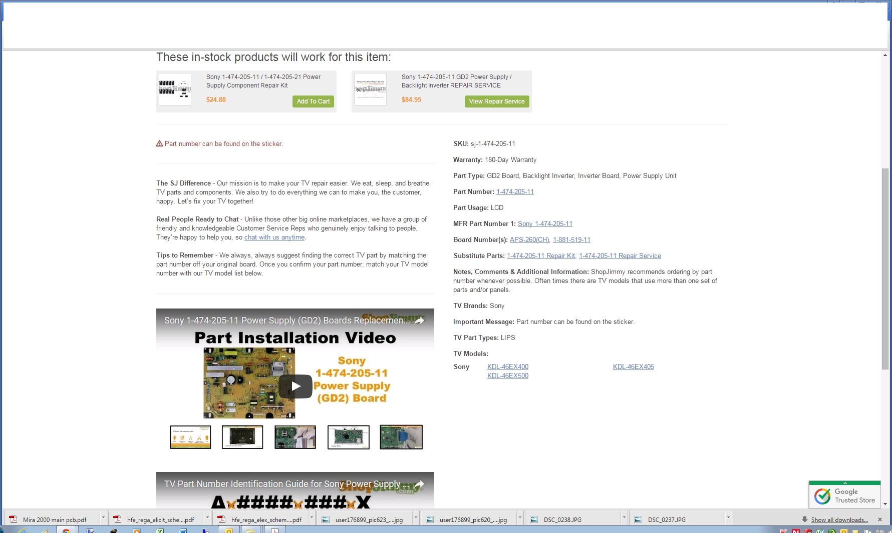

          My problem is, i have a sony kdl46ex402.
          I have a code error 2 red led binks
          I suppose that i have to change my g-board. I checked the number of the supply board 1-474-205-11 but i found innebay only for kdl 46ex400. Do you think it s the same of my supply poer board. Thanks for your response
            Re: Sony KDL-46EX402 firmware and restarting problem
            It looks to me that Sony 1-474-205-11 GD2 Power Supply / Backlight Inverter is also used in other model too per shopjimmy.
