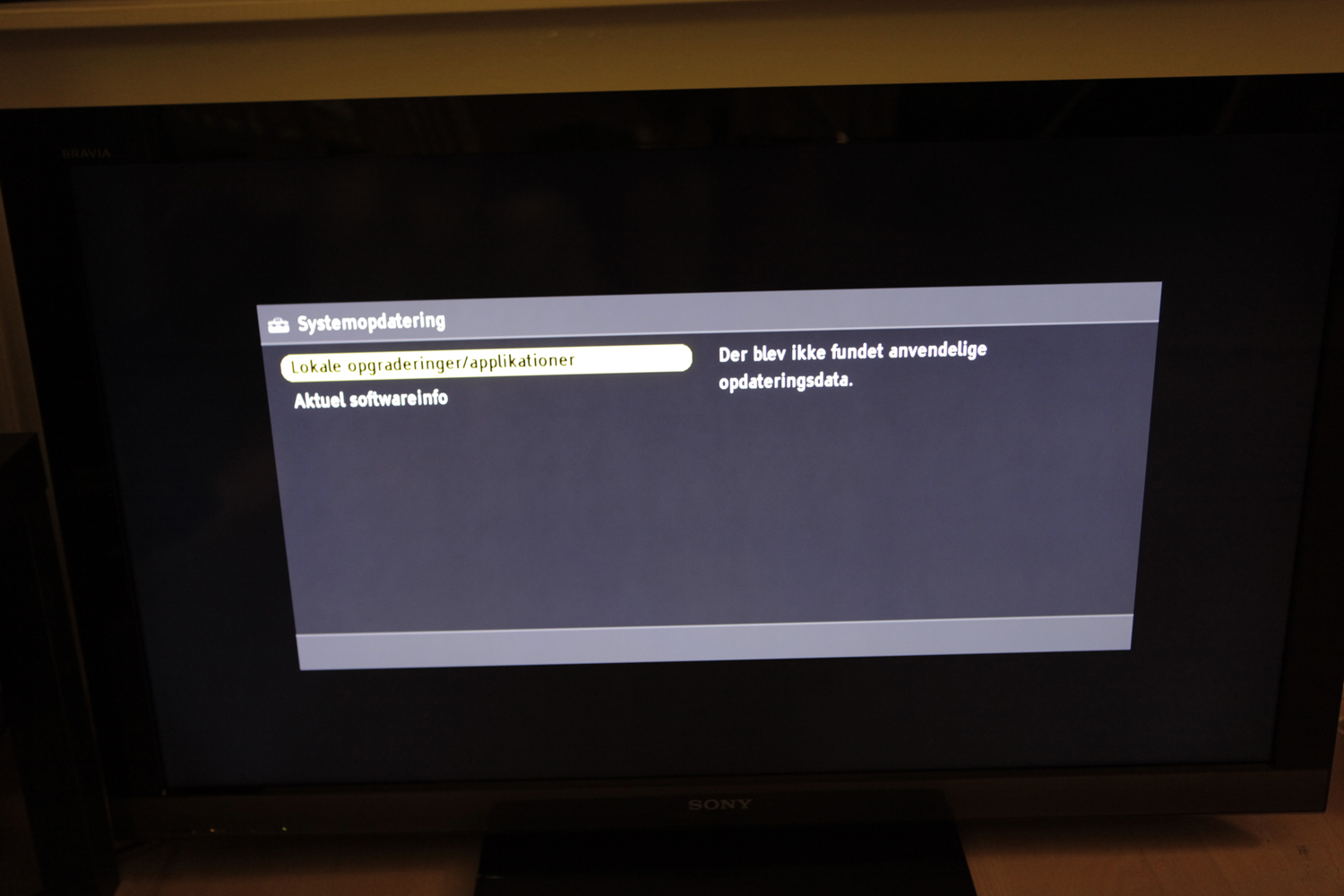

    The problem is with the unit called Sony KDL-46EX402. Which as i know of, is only sold in Denmark (yeah i'm from Denmark so sorry for the bad spelling ) and there's 2 problems with it, as i see it.

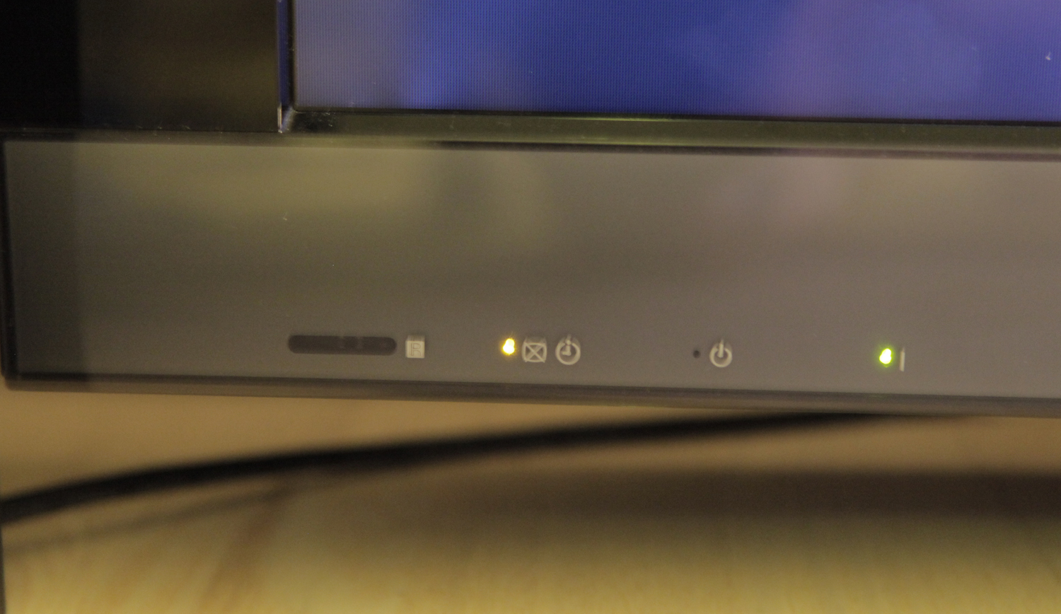

    1: It keeps turning on and off. If i plug in the power cable the unit starts by itself. And when it has been on for like 2-10min it powers off and restarts again. Now this is the first problem and since it keeps on restarting i can't get to the Service Mode.

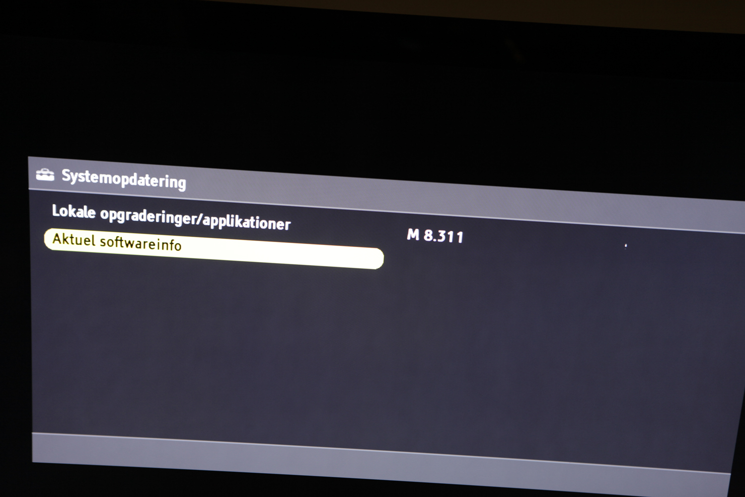

    2: So the next problem is because my friend tried to update the firmware on this unit. He tought it would be an easy fix of the restarting. And then the horror started. Cause it restarted in the middle of a firmware update, and when i plug in the power cord (and the unit powers itself on) i only get to a menu where i can update the firmware - nothing else is coming on the screen. And when i take the USB-drive with "Firmware.psd" on it and plug it in, it wont load the firmware onto the TV-unit.
    Now, i can't figure out what the problem is. But the 1. problem seems to have something to do with the power control i guess (i'm diffently not an expert). But the 2. problem i can't figure out. Cause it won't allow me to load new firmware onto the unit.

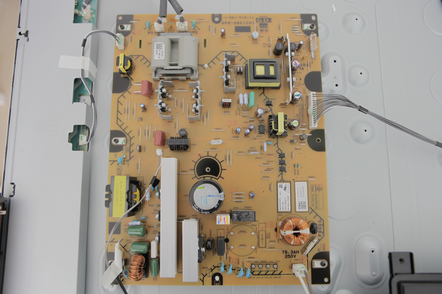

    I tought the 1. problem could be fixed by replacing the power board (yellow one) but that didn't do anything at all. So i'm thinking that it can only be the signal/video board, cause the T-con board and backlight converter is fine i guess since i have a picture when i plug it in the wall circuit.

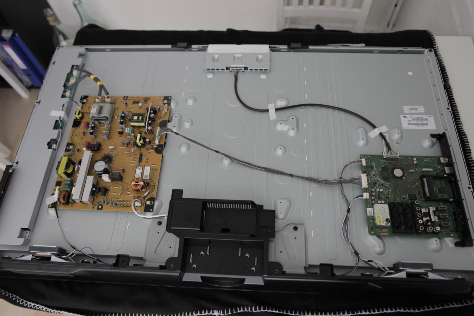

    I have attached some pitures (1,5MPixel, but i also have them in original 20mpixel) if it can help at all. The menus are in Danish but before i have plugged in the USB with Firmware on, it says: "System update", "Local opgrade/application", "There wasn't found any useable opdate data".

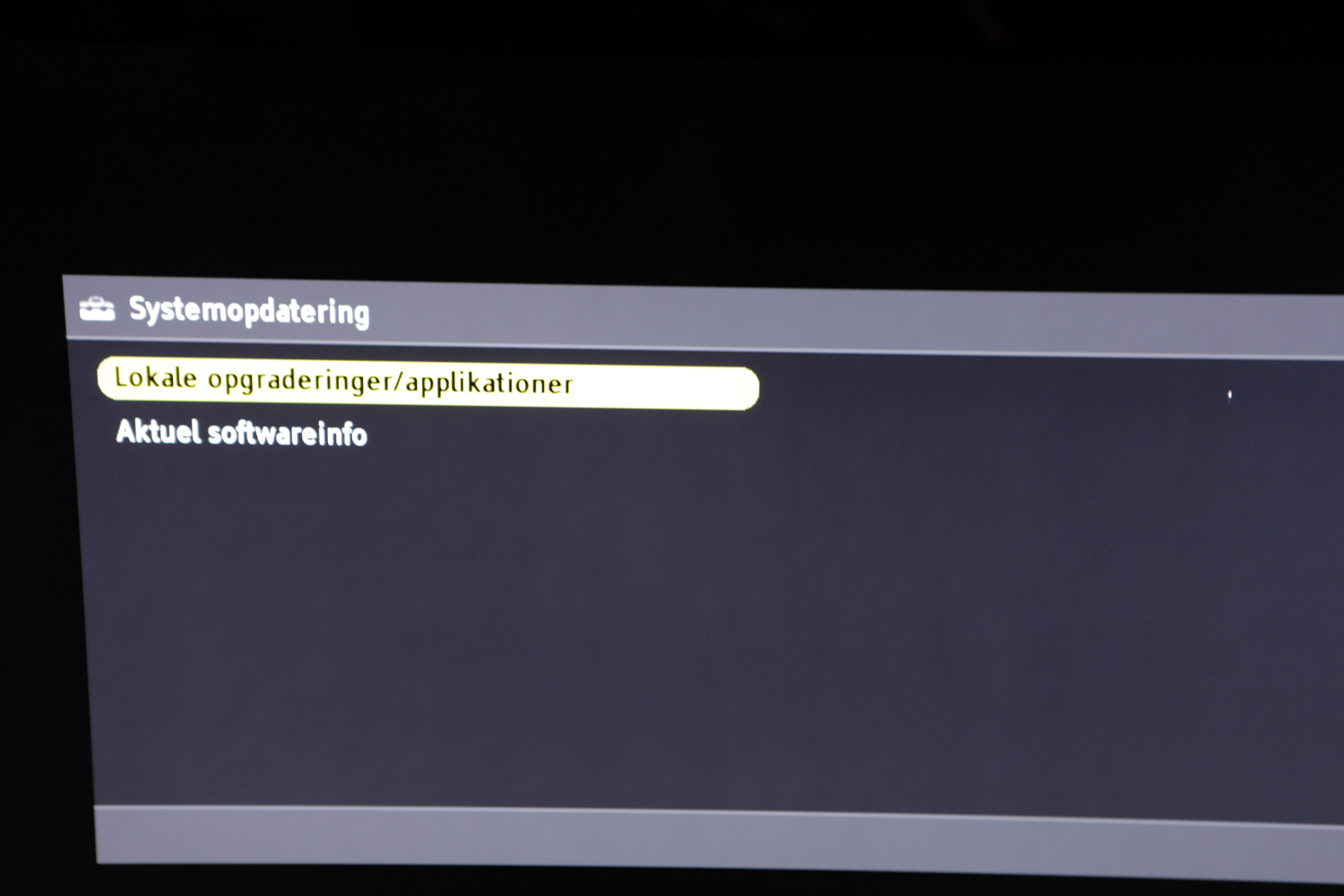

    And when i plug in the USB with firmware on, it says: "!" and when i move the menu cursor to "Actual softwareinfo" it says M8.311 (which i guess it the current firmware on the TV-unit. The Firmware laying on the USB is version "M8.728"
    http://www.sony.dk/support/da/produc...FW_BraviaM8728
    Now i don't expect somebody can say some magic word and my problem will go away, but i'll be glad if somebody could point me in the right direction.
    Ask anything if it can help at all!

      Your description of the issue is fine, so I'm guessing no one has an answer for you unfortunately. If I understand what you've done so far:
      1. When you say it won't load the firmware now, do you get an error message, or does it not see the updated firmware image on the USB device?
      2. You replaced the power board, and everything was still the same (could not update firmware, and the TV is still turning on and off)?
      Have you tried to get into the service menu and/or performing a reset to factory default (I have not tried these, since I don't have this TV.. but give it a shot):

        When i replaced the power board nothing chance - It the same. So i guess that the power board is okay.

          Since you were able to get a replacement power supply, would it be possible to get a replacement mainboard? The issue almost certainly lies there, as you have already figured out. I took a quick look at eBay but didn't have any luck.
          A thought on the USB firmware: It sounds like you are plugging it in after the TV has powered on. Have you tried plugging the USB device in first (while the TV is off) and then starting up the TV? Also, once the TV is on it is impossible to put it in standby mode (power off via remote)?

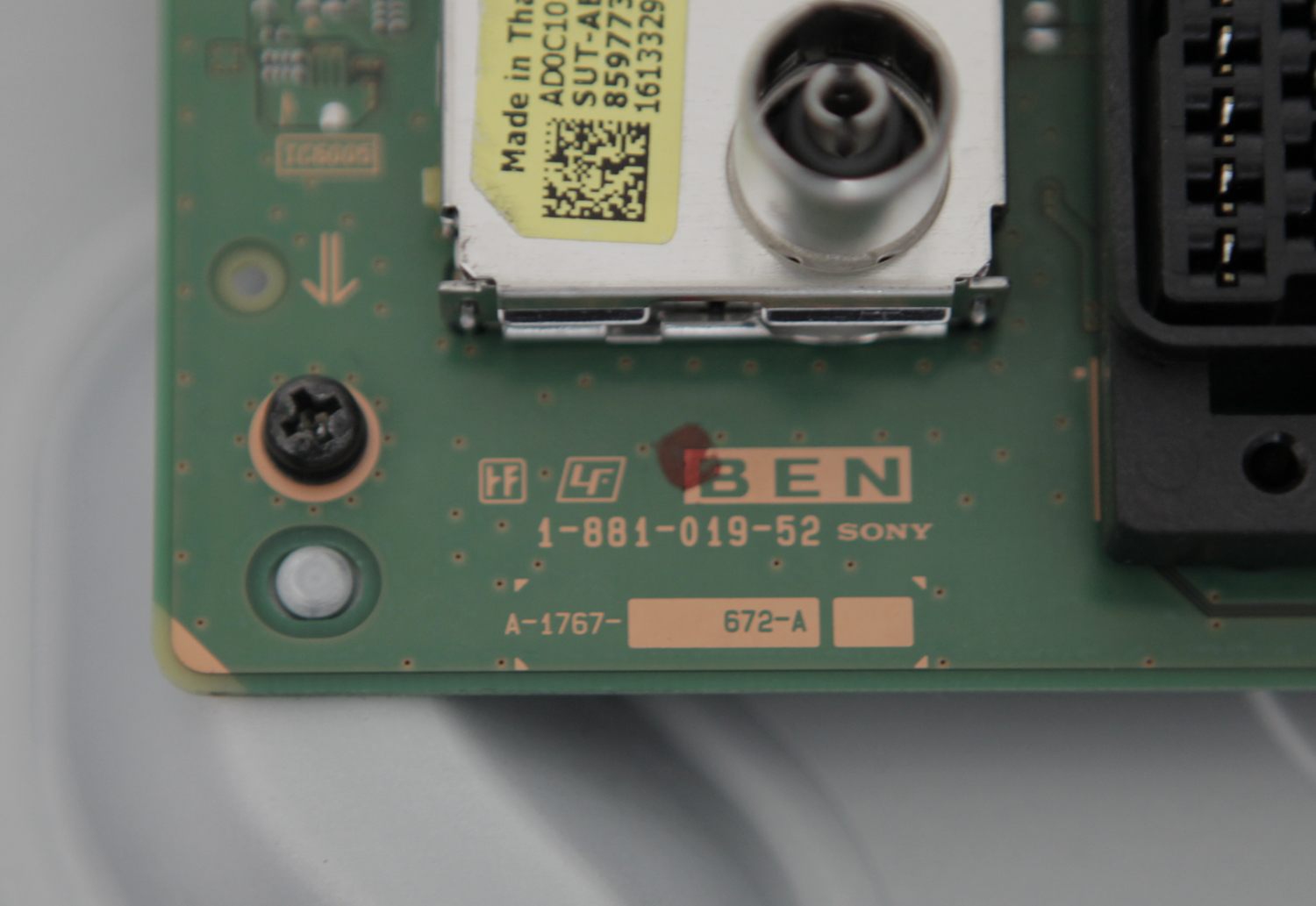

            Well, that was also what i came up with. I mean, to change the mainboard. There's not anything else it can be. But does it have to be the same model that it comes from? or can i use another mainboard as long as its the same serial number?
            I mean, as long as it's the same number as on this pictures, it should be okay? right? Or does it have to come from the same TV model?
            I have tried plugging it in before i switch it on - it's the same.

                The same boards are frequently used in different size models, or even across multiple vendors, so as long as the part number matches it should be OK. There are a few that match this part number on eBay and shopjimmy.com:
                http://www.ebay.com/itm/Sony-A-1771-...item3cc99ddf06
                http://www.shopjimmy.com/sony-a-1771...-ben-board.htm
                • truep
                  • Aug 2010
                  • 373
                  Re: Sony KDL-46EX402 firmware and restarting problem
                  Don't use that number!! That is the basic number used in many models. There should be a barcode sticker on the board with the correct number. It is usually one that is not on the tuner module. Check shopjimmy . com for more info.

                      Barcode sticker? where? Look at my images and guide me please. Is it the one above the mainboard?

                        And Where do i find what chassis number it is?
                        May not have it on but is usually on the label with the make and model number, voltage and place of manufacture
                        which is usually on the outside of the back cover, but may be on the inside of the back cover

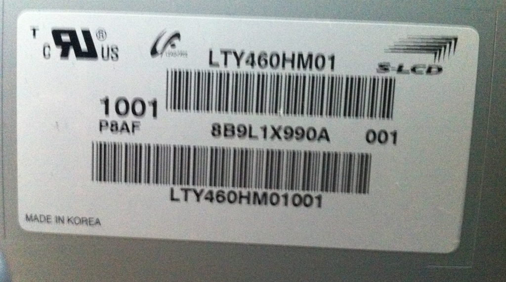

                          This is the only label i could find on the back - well there was another one but it said KDL 46EX402 (which the model is called).
                          but the label is pictured here. It doesn't say that much to me.
