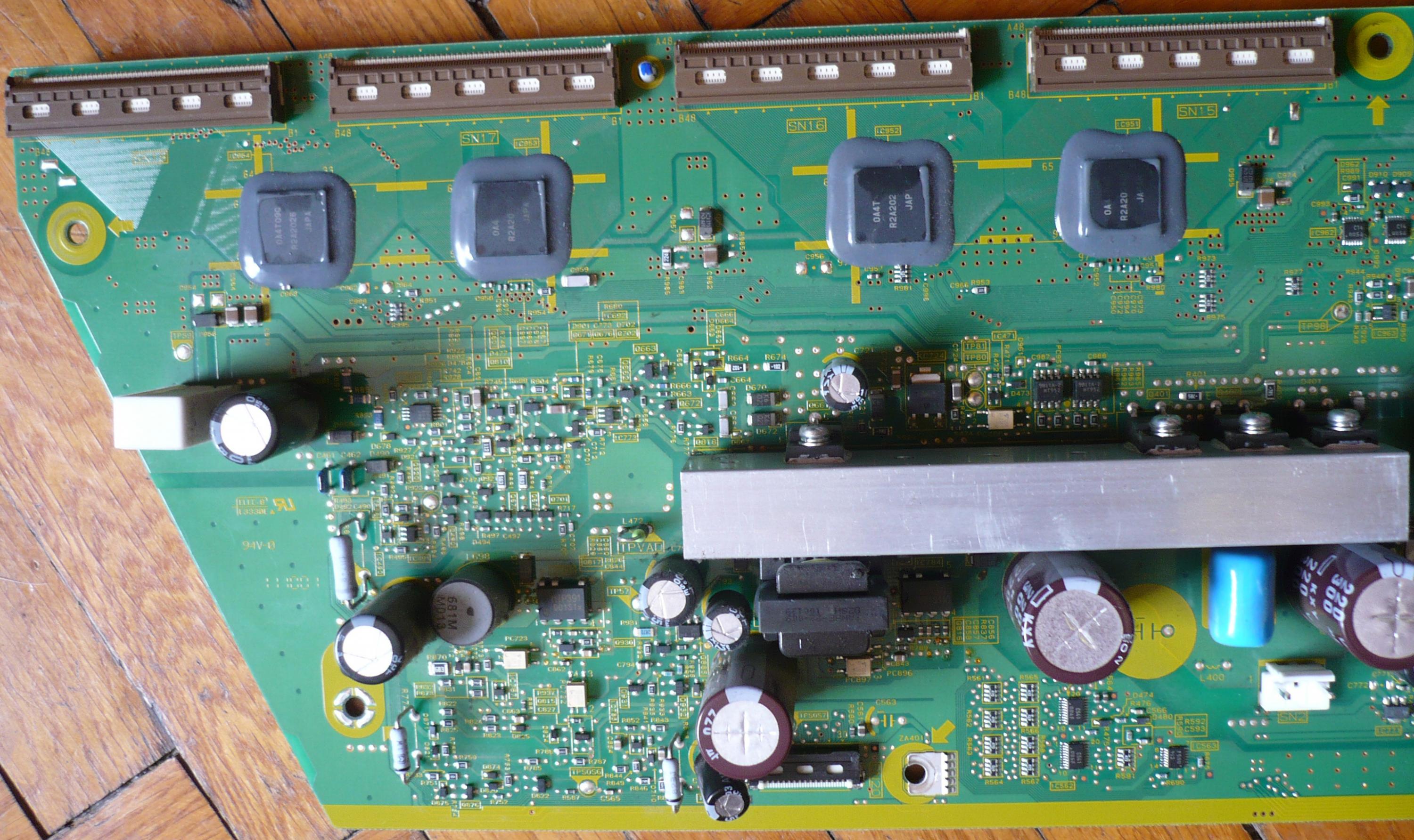

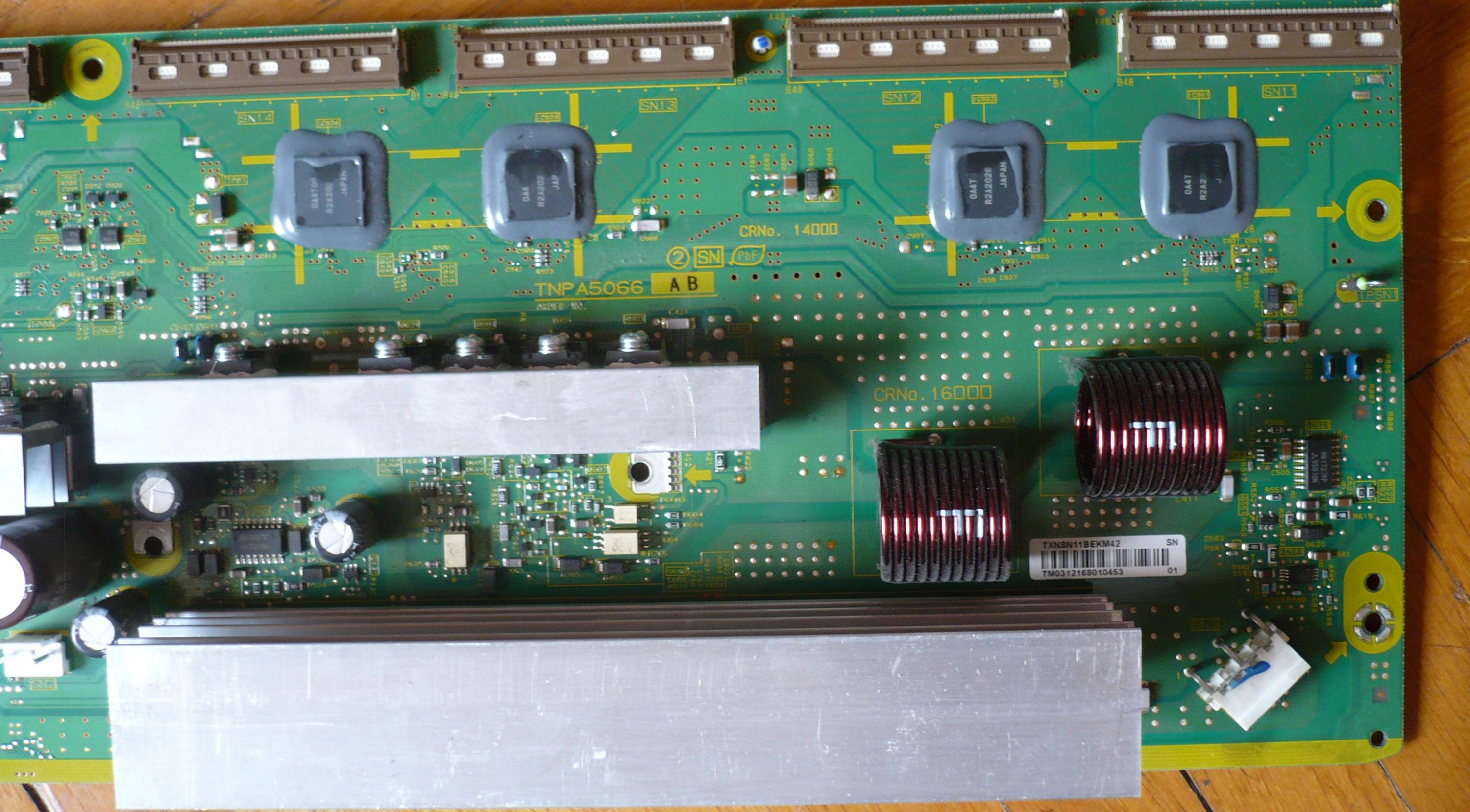

    Another question:
    my SN board is TNPA5066 AB 2 SN
    It pobble to use a TNPA5066 AC 2 SN?
    Since I found that my SS TNPA5072 AC 1 SS can be replaced with a TNPA5072 AF 1 SS (n the way) because the only difference are the connectors for the ribbon cables,
    maybe be the same with the SN board?
    From the pictures seems that the only difference is the passive cooler

      Re: Panasonic P42X20E 4 red blinks
      I would imagine they're compatible, couldn't guarantee it but likely so. The bigger heatsink may be for a bigger screen size that needs more drive current to make a bright picture.
        Ok, I'll wait for the SS first
        I found here that they are compatible
        http://tvpartsfast.ecrater.com/p/112...1lfuu-sn-board
        At the end I can swap the heatsink since I cannot find the AB for a decent prize
        Thank you again for the support
                  you are lucky that you can isolate the SS board, in my case the SS depends on the SN and they removed the led indicator on it.
                  I visuallly inspected my SN board and it seems ok, only one 220uF/25V capacitor is dead
                  I'm not a electronic expert but is possible that only one capacitor make the entire board fault?
                    I never Isolated the SS board just removed the VSUS line to the SC and left the ribbon cable connected. Backprobed the VSUS connection and then powered up psu. It started, normal voltages present but then detected that the SC was not online so shutdown and spat out the 6 blinks for a bad SC.
                    When the SC was connected it aborted due to the dead shorts, no voltage and 4 blinks.
                    A bad cap could yes but I have not struck a Panasonic Plasma yet with one. Had one set with 10 000 hours on it and all the caps looked visually good.
                    Can't make out much in the photo except clumps of dust?
