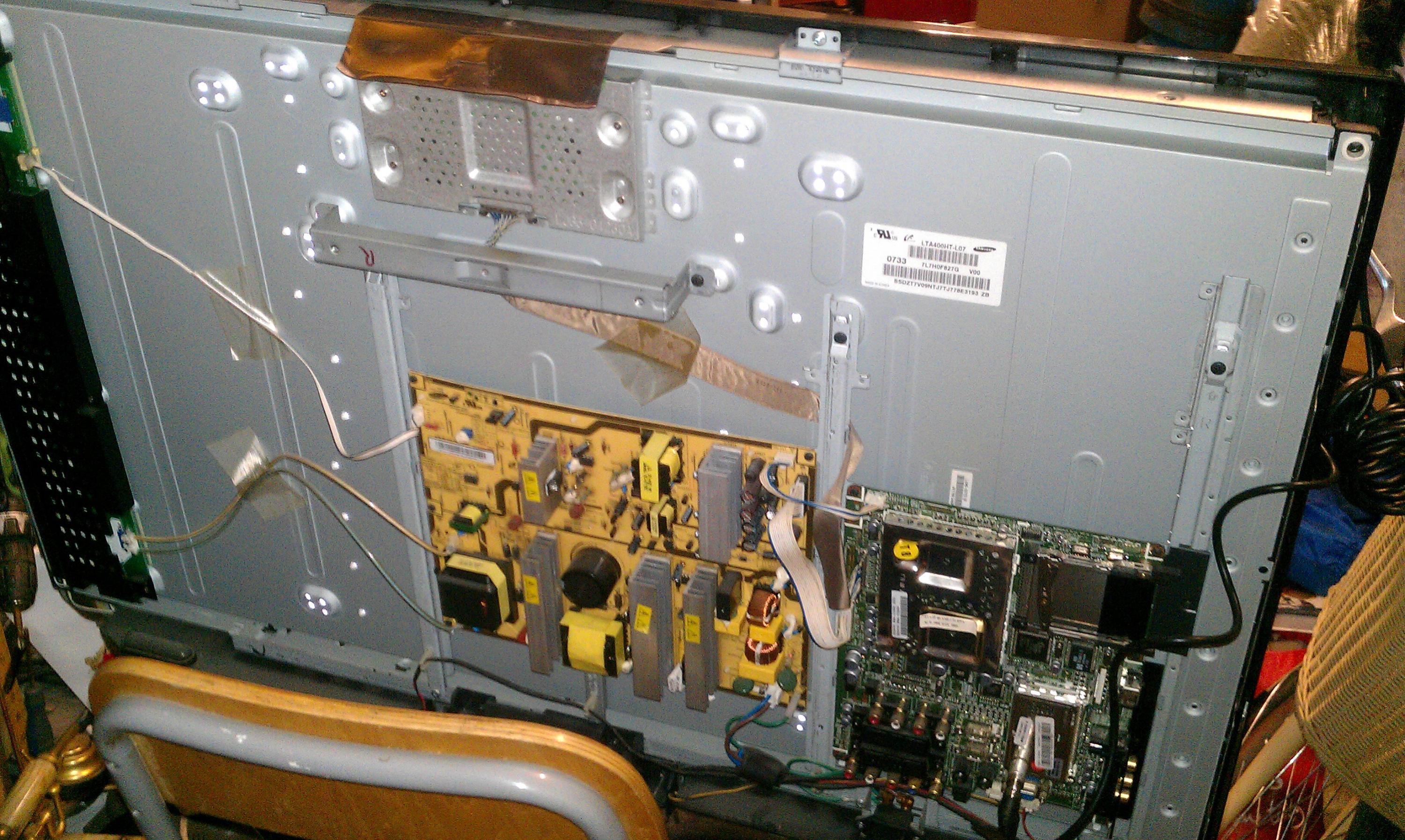

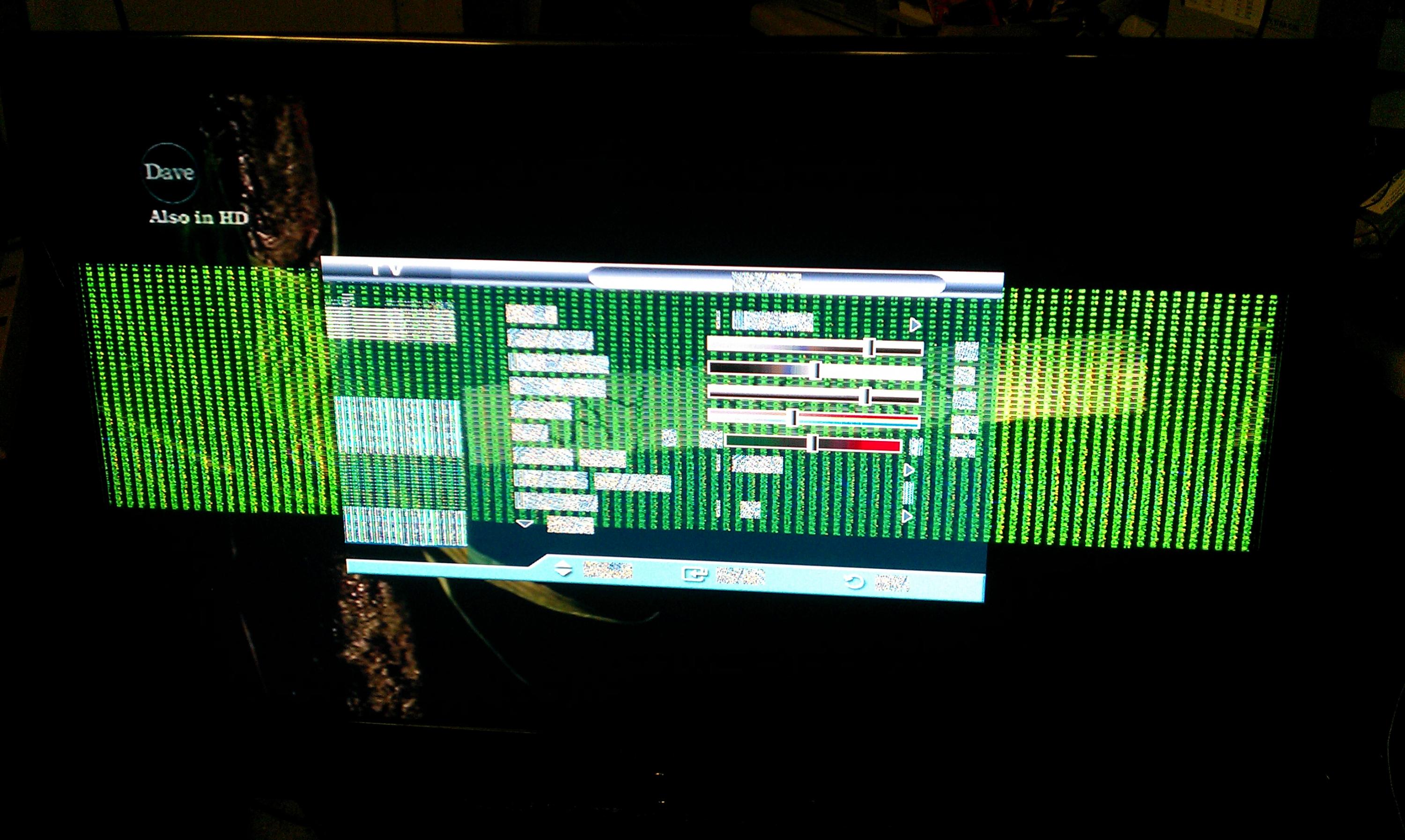

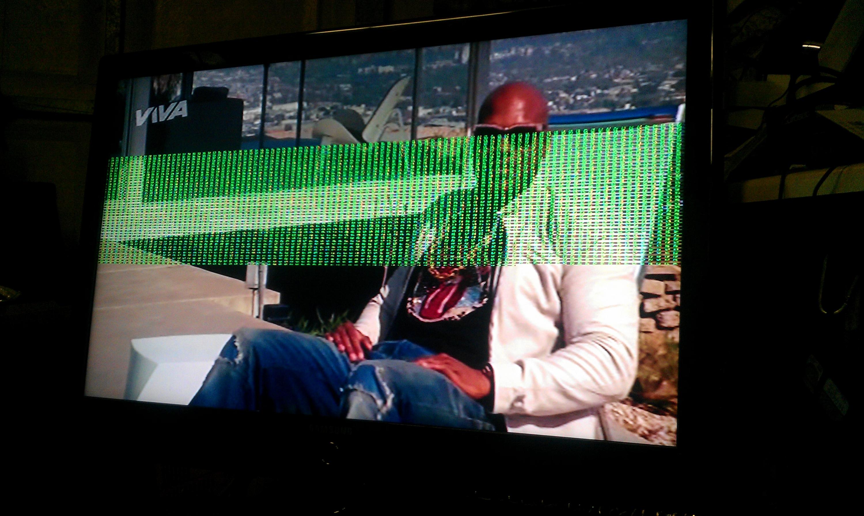

    Got a LE40M87BDX Sammy with this green lines across the middle of the screen.
    They do come and go.
    Main board or T Con?
    Can get some better pics if needed.
    Any help would be great
    Cheers

    Does it affect the menu?
    Are lines fixed?
    On all inputs?

      Re: Samsung LE40M87BDX. Green lines across the middle of the screen. Like the Matrix
      Are lines fixed?
      On all inputs?
      Yes
      No

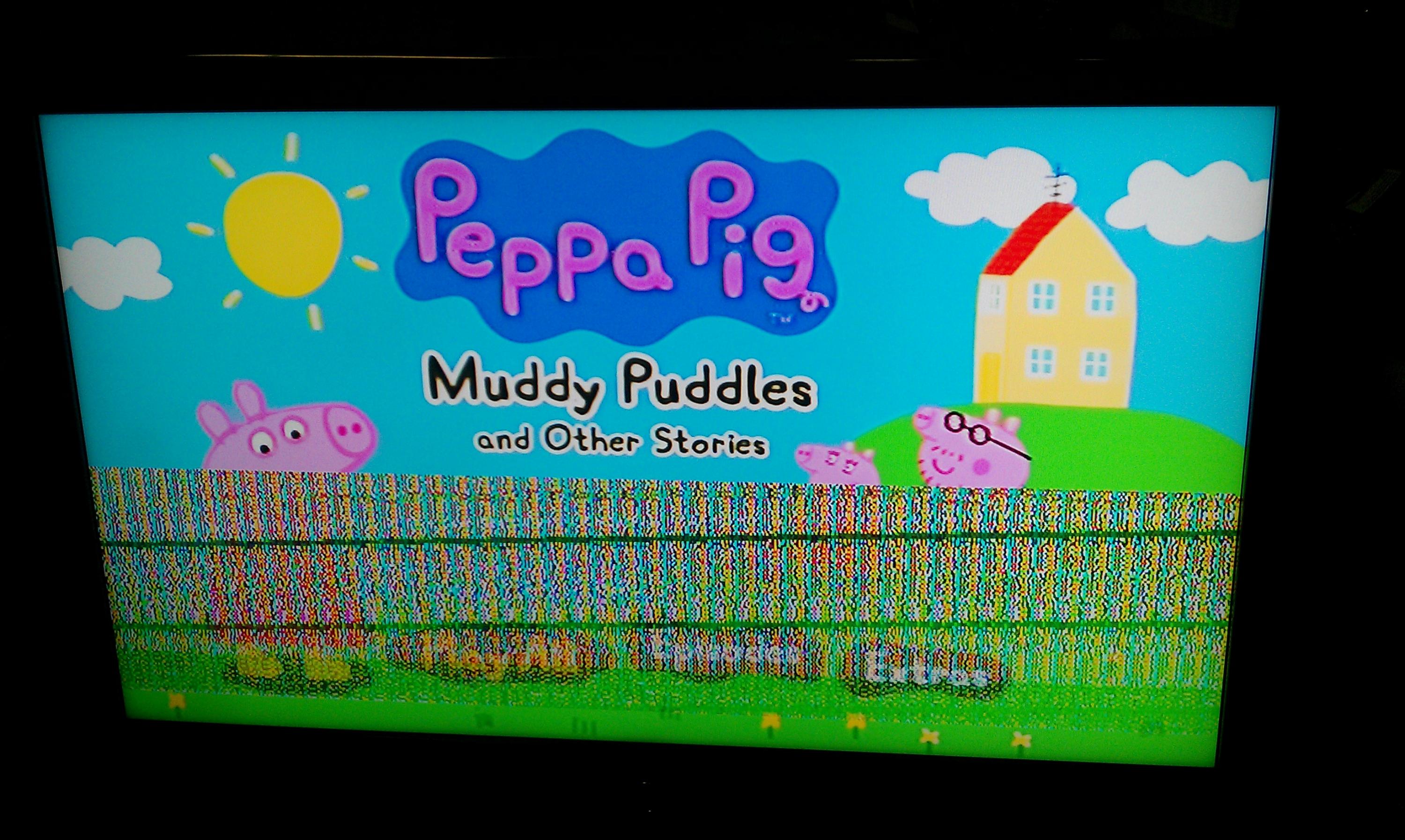

      Yes, tried composite, but moved and different.
        Affects menu completely (scrambled) - I'd say main board but first try this:
        On remote control:
        POWER OFF into standby
        INFO
        MENU
        MUTE
        POWER ON
        Set will boot into service menu, select factory reset and then power TV on (it should power off after reset but if it doesn't just turn it off.)
