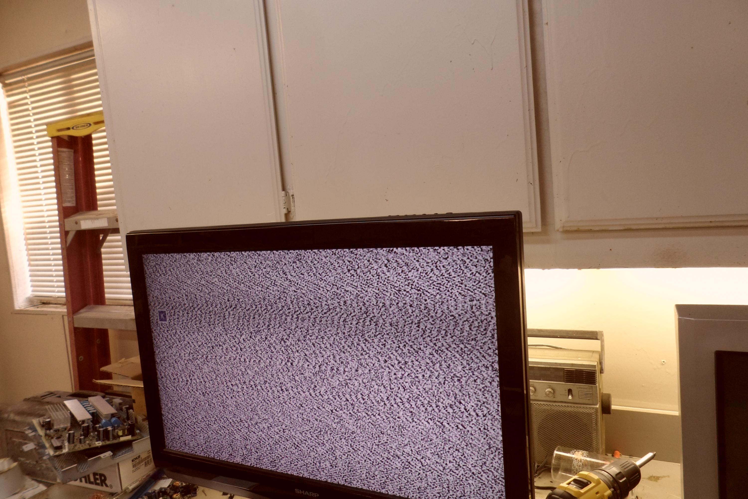

    bad lamp on lc-32sb21u
    I have a sharp lcd tv that when i plug it in it starts flashing green power led.I read on post that says to go in service mode and look see if you have bad bulb.I tried to go into service mode but would not let me.So i did the capacitor remove and jumper trick and was able to get into screen that says k.I looked aty screen i see dark spot looks like lamp maybe out.just wanted make sure it was if you guys can take a look at pic tell me what u think.
  • ricosavy
    • Jul 2012
    • 457
    • united states
    Re: bad lamp on lc-32sb21u
    here is pic

          How you did that K?
            That looks like service mode to me - just restart TV.
            • ricosavy
              • Jul 2012
              • 457
              • united states
              i put tv in service mode because the green light would blink then shut off read that it might have bad ccfl .if u look at picture u can see black strip which makes me think it is bad bulb.the tv would not go into service mode so i took off c7558 and placed jumper and and restarted tv pushed - vol and input and bing service mode i read this one of threads here how to do this even had pic.
