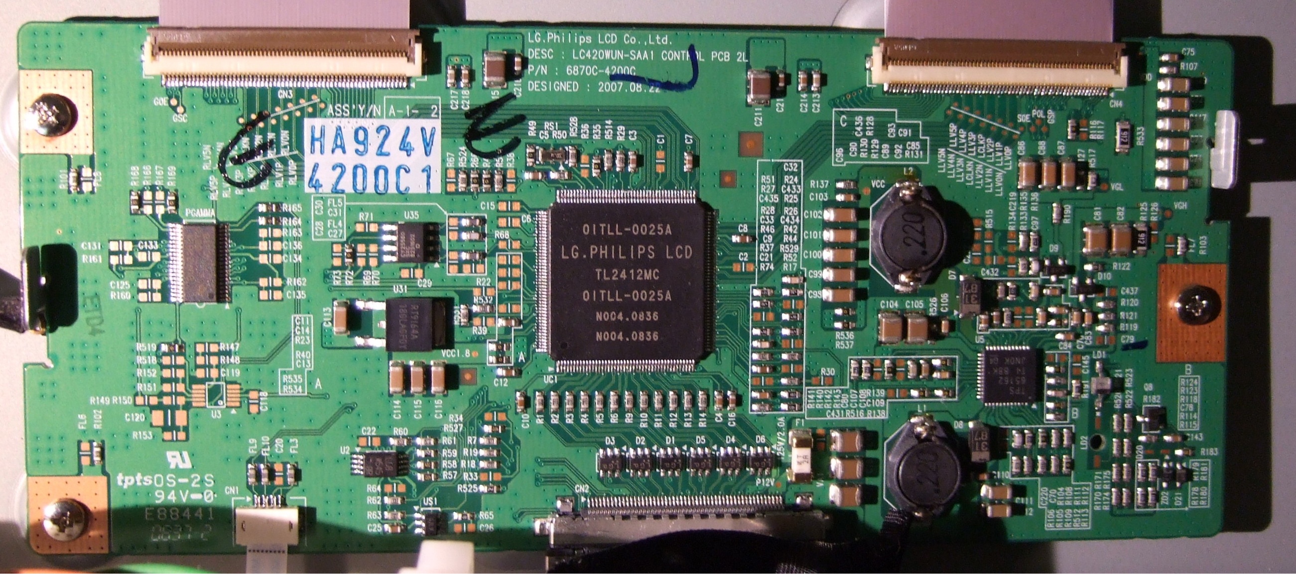

        T-CON board is the board sitting under the metal shield in the top middle of the LCD panel assembly. Post the pictures of your TV will help.
        • mikew67
          • Aug 2012
          • 20
          Re: Vizio VO42L, Backlite & PS OK, no pic, now what?
          Aha, one more metal shield to remove. Here's a pic of the T-Con PCB.
          Good suggestion. I think we're on the trail of the problem here. The fuse was OK, and the voltage on it (both sides of course) is 12.0v with power on.
          But the voltages around U31, the only LDO I could see on the board (just under the rubber stamped numbers) aren't right. The output, pin 2 & tab, is connected to a PCB trace labeled "VCC1.8", but the voltage on it is only 0.569v. (I'm presuming this regulator is supposed to produce +1.8v for the LCD panel bias.) Input (on pin 3) is only 0.837v and pin 1 is 17.2 mv (probably gnd)
          Does the 12v through the fuse source U31? Or does it come from another connector pin. So what's upstream from the U31 input that I should check.
          Thanks!
          Mike
            I see two regulated switching power supplies (two round inductors), driven by the IC close to them. Yoy can Ohm out the input pin of the regulator to the fuse to see if it is supply by the 12V input, more likely to be fed by one those two swtiching regulators.
            I see pad with VCC label next to L2, I also notice that around L2 has brown area due to heat?
            Check the Voltage on the Cathode side of D7 and D8. You may want to get the spec of U5.
            U31 does look like 1.8V reg for the processor.
            You may also want to check those MLCC (Multi Layer Ceramic Cap) for shorts (they are those brown rectangular shape component).
            See shopjimmy.com to see how much this T-CON baord is also.
