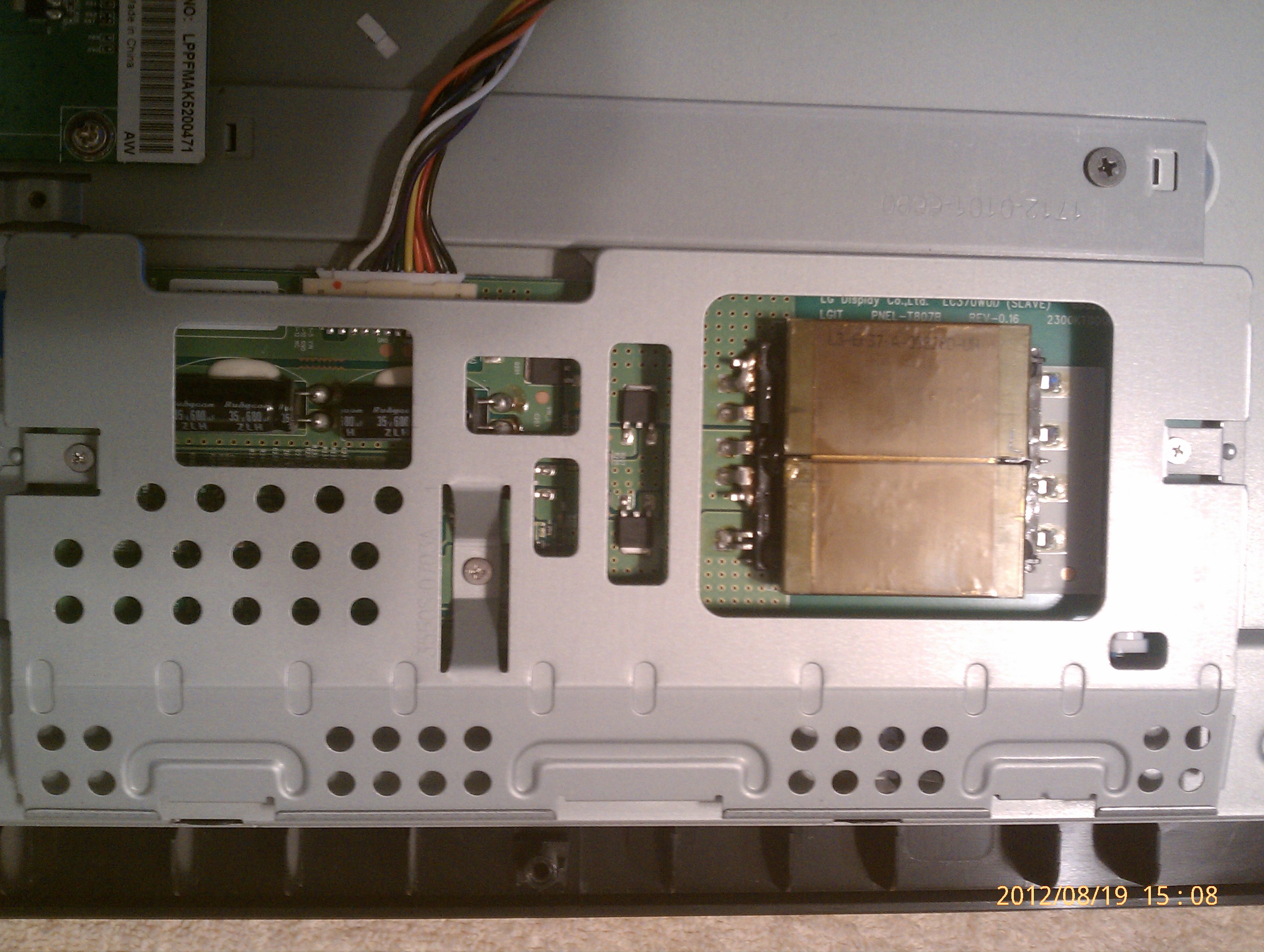

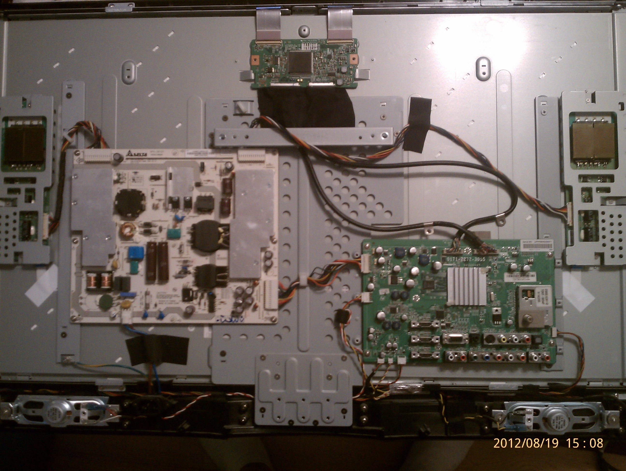

    First time I turned this set on, Vizio logo went from orange to white, backlight came on, I then saw Vizio logo come up on screen and go away quickly and then nothing. Backlight still on but no video.

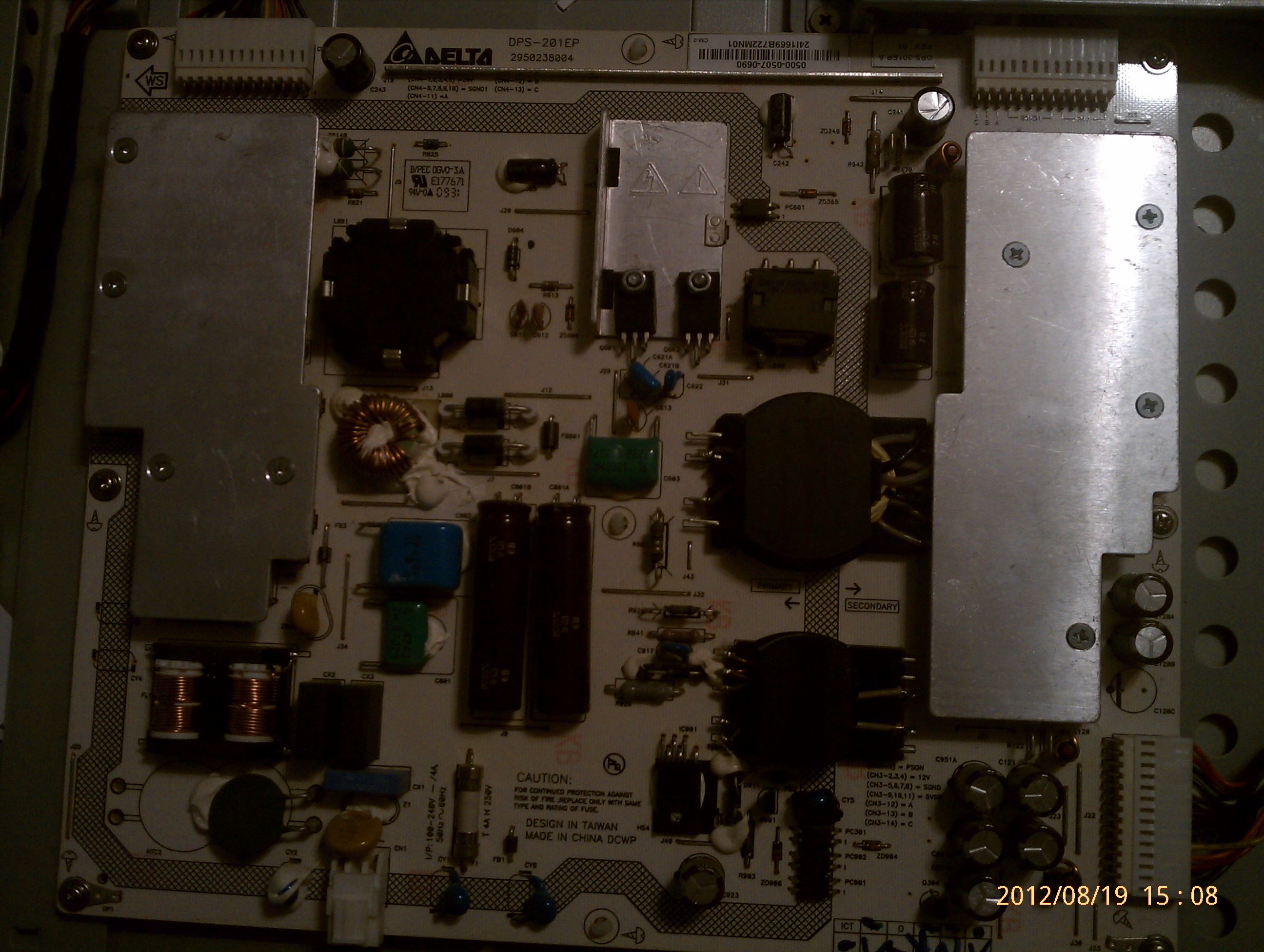

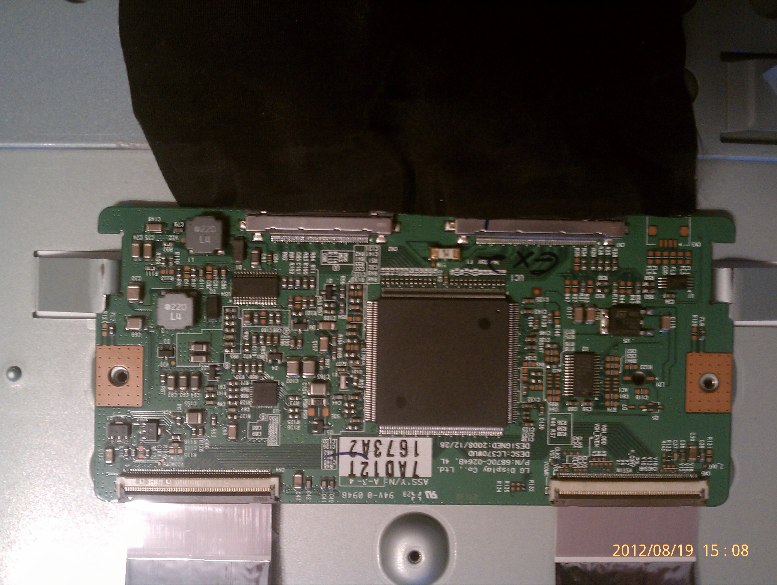

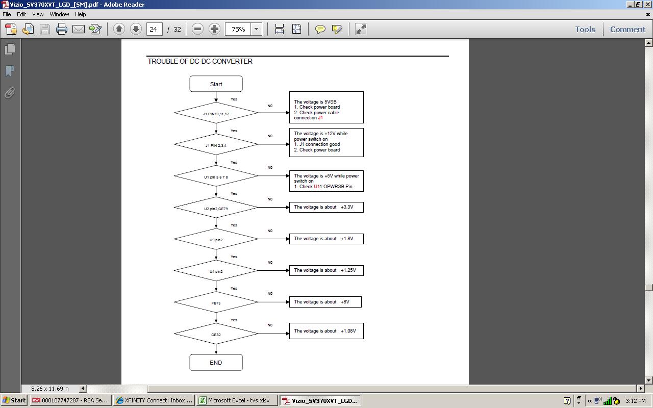

    From then on backlight came on but no video. Took it apart to check voltages now backlight not coming on either. All voltages are good and fuses on t-con, main board and inverter boards good. DC-DC voltages all tested where they should except for CE82 which was low.
    Oh, also once set comes on, will not shut off. Remember Vizio having this issue before with voltage regulators on the main board I think. Service manual is not great... Anyone have experience with this, seems like a main board issue to me...

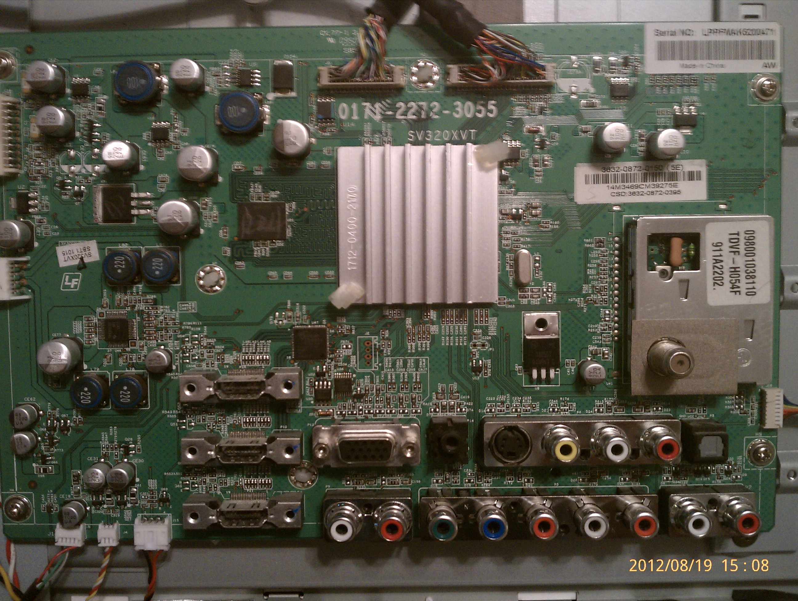

      I measured all referenced in the SM, all seems good. Not sure what is going on. The fact that all voltages are good at inverter boards but now no backlight seems to indicate the main board wouldn't it? There are 3 pins coming from main board to PS board, and PS board to inverter board, labeled A, B and C. No voltage on those. As with the older Vizio I worked on, the available SM has no schematics just some basic troubleshooting. There is a more complete SM I found for the older one, but it wasn't easy to find.

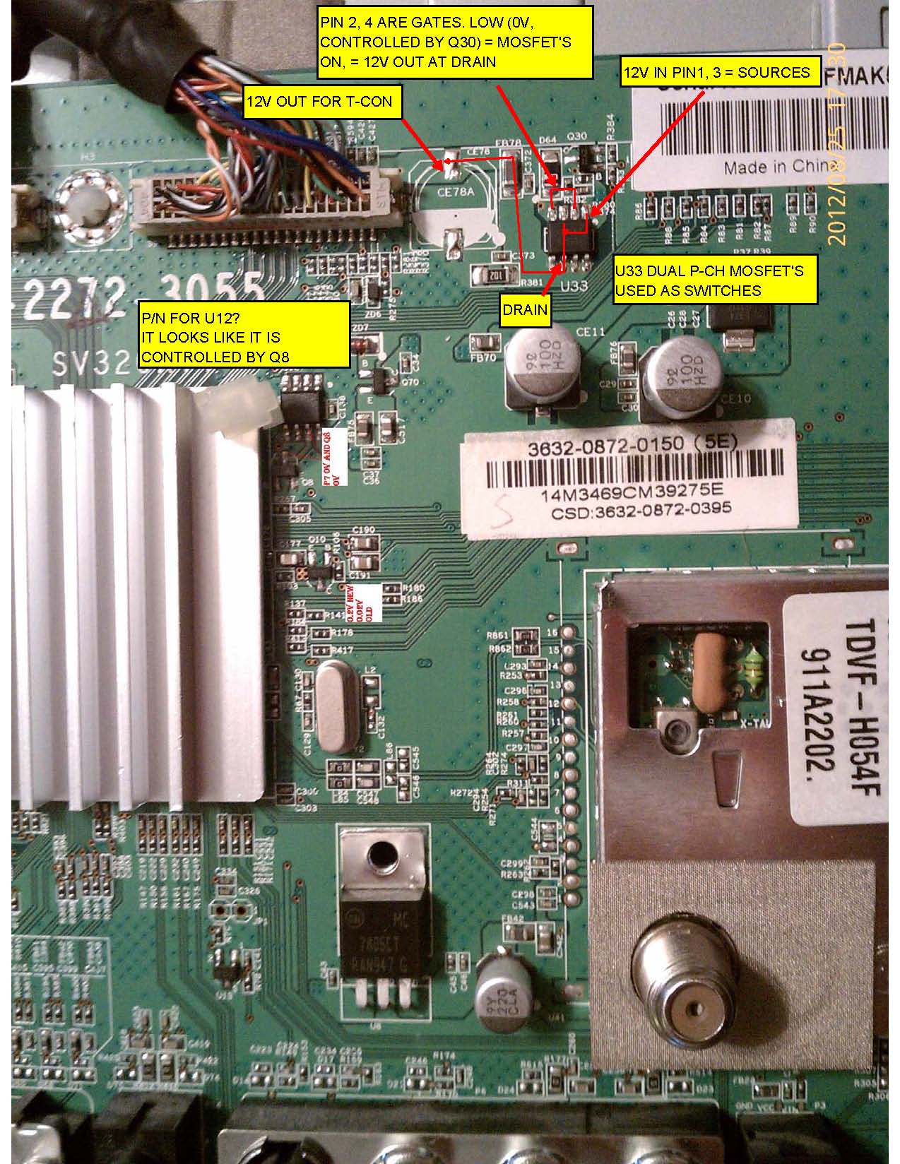

        Picked up a new main board for this TV knowing the history of the main board issues.. Set fired right up..

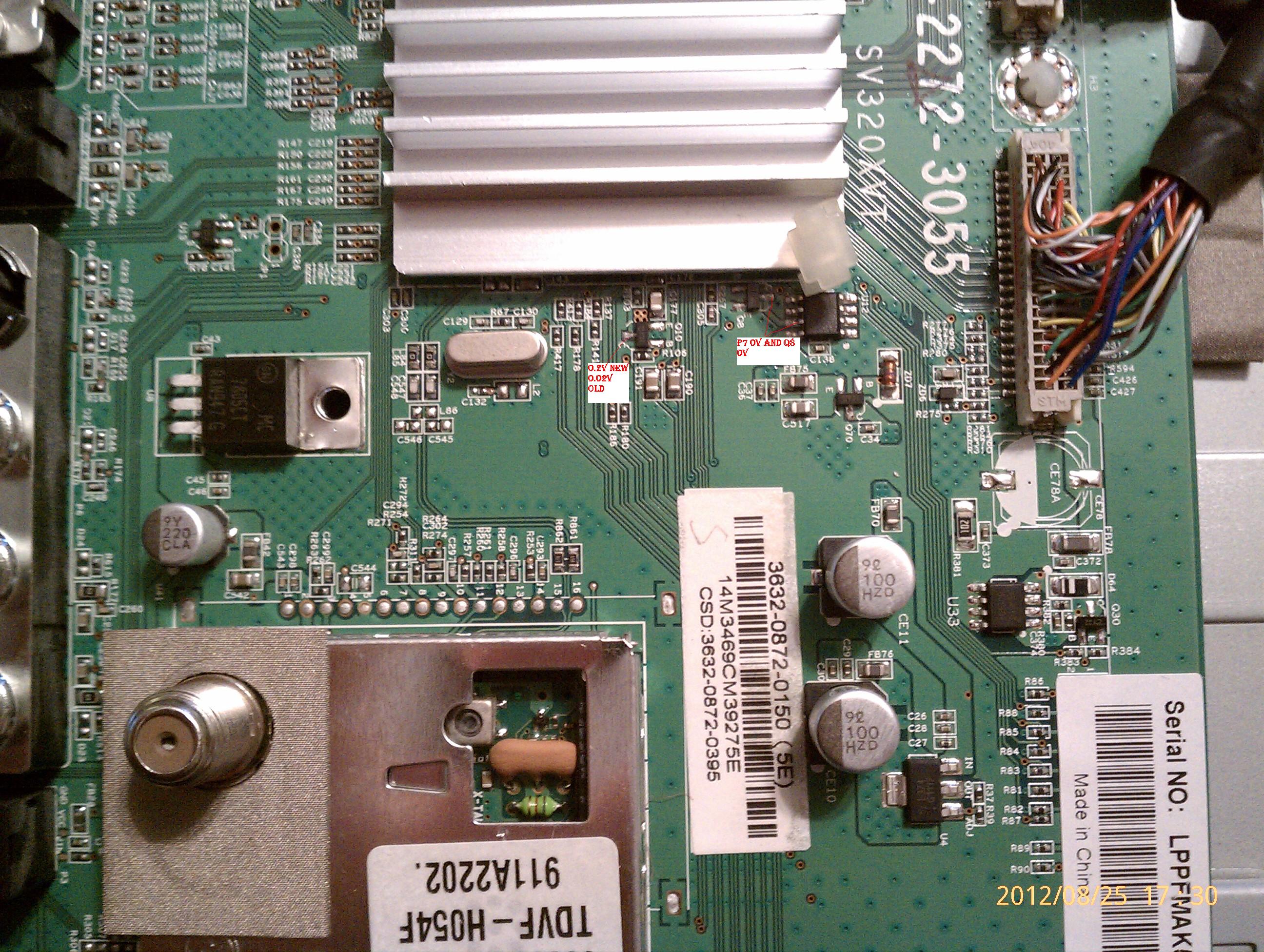

        So now my with curiousity as to what's wrong with the old board and the lack of info in the SM, I decided to compare voltages...
        The only voltage is the SM that wasn't right originally was CE82, should be about 1.08v and was 0.6v on the old board. The new board is 1.1v. And....
        NEW--------------OLD
        U12 pins 5-8 = 3.4v ---------------U12 p 5,6,8 = 3.4v, p7 =0v
        Q8 = 3.4v-------------------------Q8=0v (seems to trace to p7 on U12)
        U8 = SAME
        U1 = SAME
        U2 = SAME
        U9 = SAME
        U4 = SAME
        FB75 = SAME
        Q10 = 0.2V--------------------------Q10 = 0.02V
        U33 = P 1,3,5,6,7,8=11.8v,p2,4=0v----U33 = P 1,3=11.9v, p 2,4=11.6v, p5-8=0v
        U14 = SAME
        U6 = SAME
        Obvious issues at U12 and U33.
        U12 having 0v at pin 7 which seems to lead to collector of Q8 which is also 0v.
        U33 has about 12v on all pins except 2 and 4 on good board, and 0v on pins 5-8 on bad board..

                  I think this is U33
                  http://pdf1.alldatasheet.com/datashe...4953GM_08.html

                      OK, I looked at the picture of U12 (P/N? same as U33?), U33 (Dual P-CH MOSFET's).
                      U33 is used as switches for supplying the 12V for the T-CON board, when Gates are low, the U33 is turn on, it looks like the Gates are control by Q30 (the Voltage at the Base should toggle (which will also toggle Collector which I believe is connected to the Gates) voltage when the TV is turn on/off.
                      U12: I do not know what it is so I cannot tell by the pictures.
                      It seems to me that the processor is not sending the signals to turn on U12, U13.
