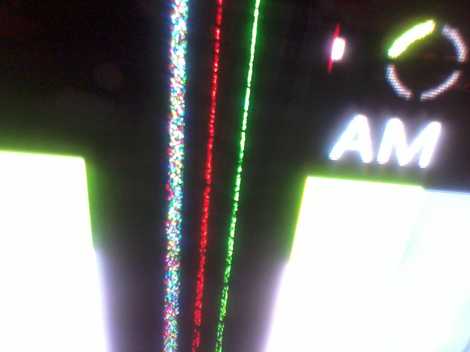

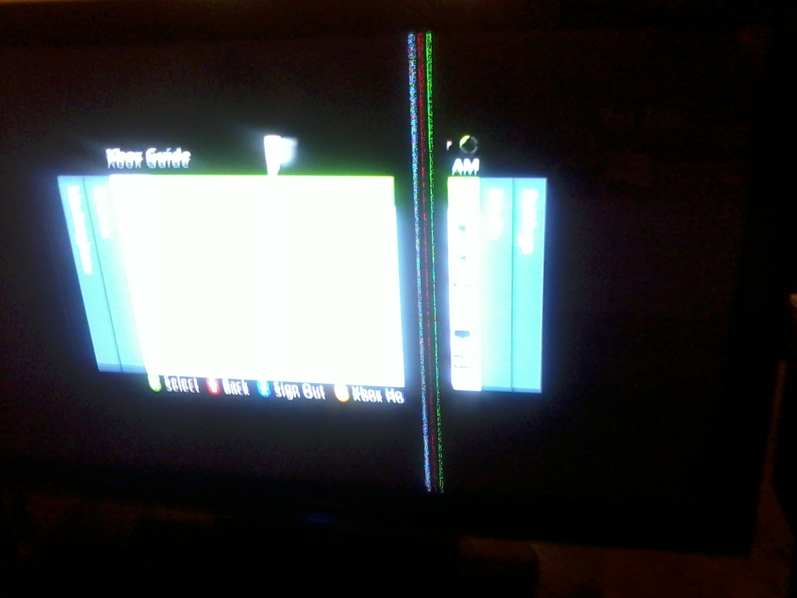

    I have a samsung model listed above and it has a solid vertical black line with a rainbow bar, red, and green bar seperated within it. The bar is about 2-3" wide and stretches from top to bottom of the screen. It is on the right half a bit <1/4 of the screens width from the center.
    i have heard this is the y buffer or y sustain. very rarely but possibly the panel itself.
    The parts for this tv well at least the buffer is near impossible to find.
    My question i guess is just does anyone have advice on where i should go from here.
    I have opened it and checked cables but didnt bother with the sustain at the time because i was unaware it may be an option.
    Is it possible the sustain can cause this issue.

    What you are seeing is likely a panel failure. Never heard of a PN450A though?

        If you can get to it you may find something as in this post. - The tab may need reseated or the resistors can become unsoldered - maybe worth a look. Tv models usually have more digits than that - is that what it says on the label on the back of the set?
        https://www.badcaps.net/forum/showth...=plasma+stripe

              There is a service manual here is yours the same inside
              http://www.scribd.com/doc/34870662/S...sma-Pn42a450p1
              Its a different sort of setup try unplugging cleaning and resetting the flat cables.
