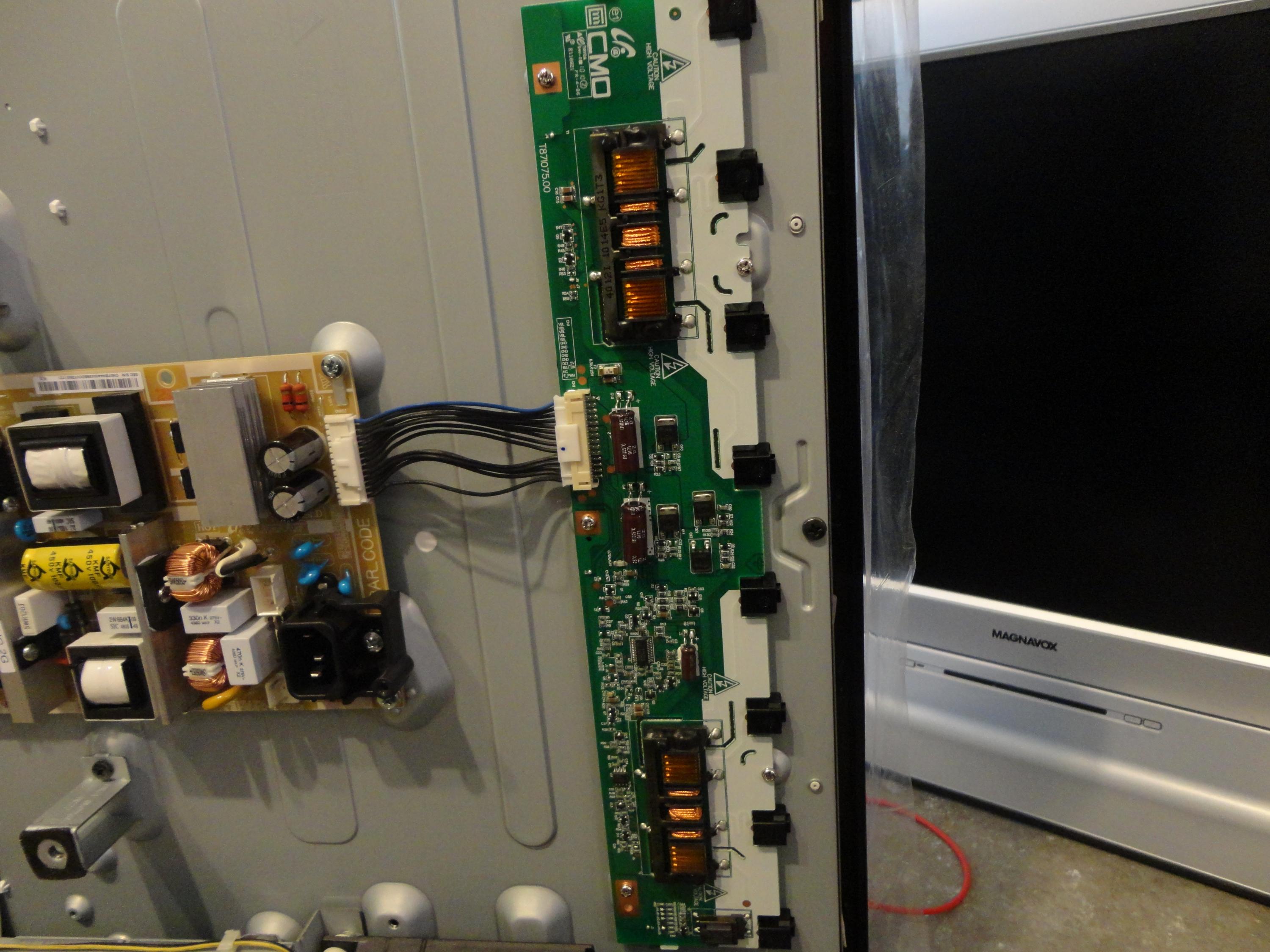

    Hi everyone,
    hope you can help me out i have a 32 samsung lcd tv model ln32c450e1d and the tv will have a red led power light when i plug it in.
    Soon as i hit the remote to power it on it will blink 5 times red power light then the light will go off.the back light never comes on it does have the 24v to inverter.5v det only has 1.5v.There is also no voltage to e-pwm.the power supply the tv has is a BN44-00338B i am thinking the power supply is the problem but not sure.i uploaded the wiring diagram to board.I will post pictures of the power supply and tv.Any help will be appreciated thanks.
    Re: 32 samsung lcd will not turn on just blinks 5 times
    If the power supply is bad you will not be getting the 24V, since the PS_ON from the main board and the PFC Voltage booster is working.
    I will wait to see good clear pictures of all the board and closed up pictures of the board as well.
      here are pictures of the boards

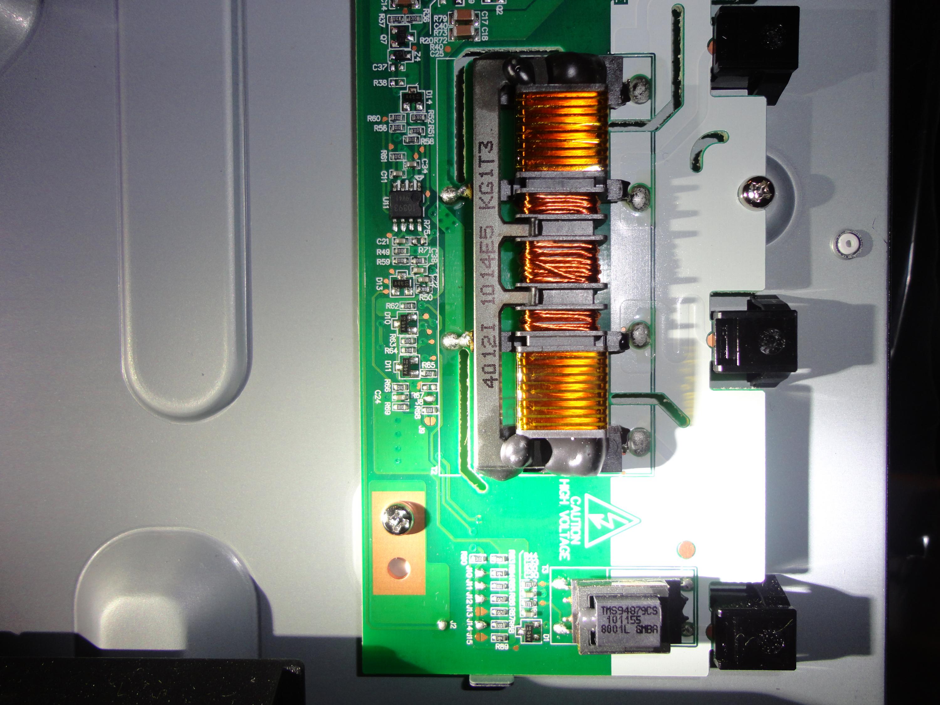

        Can I see closed up picture of the inverter board. I am looking for small black fuse for PWM controller IC. Please take the pictures in sections.
        All the fuses on the inverter board are OK?
        • ricosavy
          • Jul 2012
          • 457
          • united states
          i checked fuses f1 f2 they both checked out good on inverter board will post picture
                here are the pic of inverter board
                  OK, it does not use one of those black fuse on the inverter board. You need to look at BLU_ON signal and find the LCD panel number for me.
