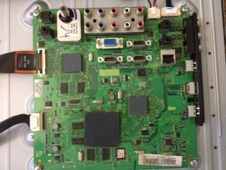

                          Thanks in advance
                            #73
                            Re: 32 samsung lcd will not turn on just blinks 5 times
                            This problem is very likely caused by a defective diode in the PFC circuit (DP805). Apparently there is a service bulletin for this problem. I just fixed a TV with this problem and when I tested the diode out of circuit, it tested fine in diode check mode and resistance mode (in both directions).
                            The defective diode causes a "UVLO" failure in the backlight circuit because the voltage across the main cap is not as high as it's supposed to be. I'm now getting around 340V with 120V line, but with the bad diode I was only getting around 320V.
                              #74
                              I believe 340V is still too low, most PFC/Voltage booster will bost the voltage to around 380 ~400V range.
                                #75
                                I got a LN32C540F2DXZA that uses the same power supply (BN44-00338B) as the original poster indicated. The tv has a cracked screen though but I want to fix it to gain experience and also sell the parts or something.
                                What happens is I get the red stby led, but the tv won turn on.
                                I believe in my case the problem is with the power supply. Because:
                                #1 If I disconnect the motherboard and plug the ac, the tv still won turn on and light up the backlights, although you see them flash when you connect and disconnect the power plug, not all the time but most of the time.
                                #2, because if I connect the motherboard or any load the power supply will drop the output voltages.
                                #3 The output voltages I'm getting are rather weird, depending on whether I have or dont have boards connected.
                                Here are some voltage measurements I took:

                                        Hi Budm and Beowulf,
                                        I have the same exact TV(Samsung LN32C540F2DXZA) and the same exact symptom as posted by Beowulf(see post #75). After searching the internet and checking with a digital multimeter, I think something wrong with the power board(BN44-00338B). The readings of the multimeter are very similar to that posted by Beowulf:
                                        1. When disconnecting all the cables, power board readings are:
                                        CN802--pin1/3/5/15/17(B13V): 4.2v
                                        CN802--pin11/13(B5V): 2.13v
                                        CN802--pin16(A5V): 5.2v
                                        CN803--pin10~14(24.5V): 8.7v
                                        2. When all the cables are connected:
                                        CN802--pin1/3/5/15/17(B13V): continuous change from 0 to 2.9v
                                        CN803--pin10~14(24.5V): continuous change from 0 to 3.9v
                                        Since
                                        1) A5V voltage is ok;
                                        2) the main cap(100uf, 450v) reading was 100uf when I measured it (on board);
                                        3) the PFC_OUT voltage reading is 377v(half sine wave);
                                        4) B13V reading is 1/3 of its normal value;
                                        5) 24.5V Inverter reading is 1/3 of its normal value;
                                        6) no obvious physical damage(cap popup etc) on the power board and main board.
                                        I guess one or more of the following components might be bad:
                                        1) ControlIC ICM801, I see someone selling the IC on ebay;
                                        2) High power cap "CM808", I also see someone selling it on ebay;
                                        Could Budm and Beowulf please tell me what should I do next? Thanks a lot!
                                          I had the same thing on a Samsung 40inch replaced main pwb works great
