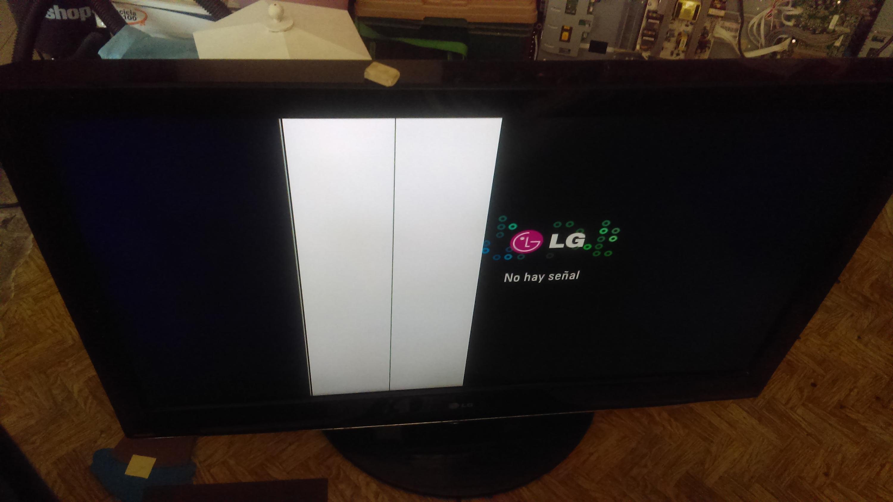

              Re: LG 42LH30 with no picture, audio and backlight/screen work
              Hi, I have the same problem, i fix the fuse and turn on mi tv appears white bars in the tv.
                What do you get on the screen if you have the ribbon cable between the T-CON board and the LCD panel connected one at a time?
                  black screen
                    #29
                    black screen
                    That does not sound right, you should see white screen on the unconnected cable between the T-CON and LCD panel.

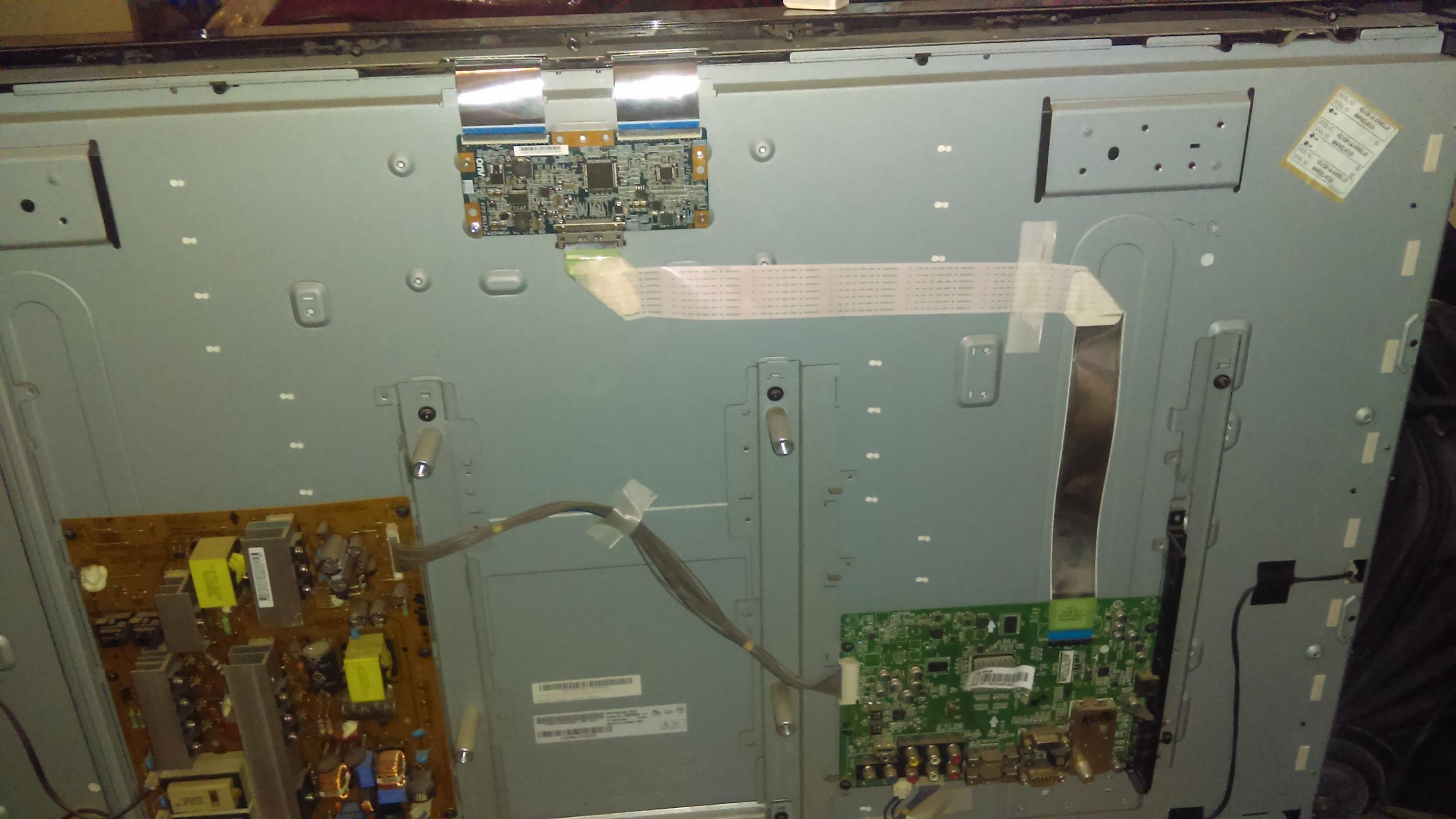

                      #30
                      My t-con board is different, use one ribbon to Main board to T-con
                        #31
                        Again, may be you do not understand what I am telling you what to do, we are talking about the ribbon cables BETWEEN THE LCD panel and the T-CON board, NOT the cable between the main board and the T-CON board.
                        You have TWO cables between the T-CON board and the LCD PANEL! It does not matter if you have one or two cables between the T-CON and the main board.
                        So did you do one cable at at time?
                          #32
                          https://www.badcaps.net/forum/attach...0&d=1474415342
                          That is bad panel.
