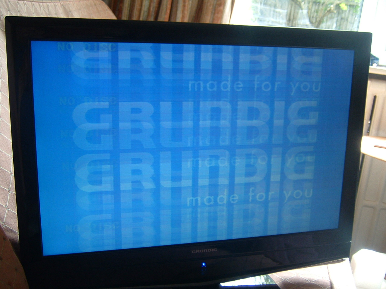

    Got this one to repair and return - normally don't do this but it's for a friend so I said I'd have a look at it.
    The problem is the picture is fuzzy, each line is skipping a few pixels randomly, and sometimes it loses vertical sync. It also has difficulty with composite video inputs, they always show "No Signal". OSD is affected as well as the video.
    I tore it down and checked the regulators. They're all 3.3V; one is outputting 3.29V, another 3.31V, but there's one on the board that's doing 3.25V. It's a little low, so I scoped the output (with my new DS1102E ) - sure enough, it's oscillating at around 400kHz with over 1Vp-p of ripple.

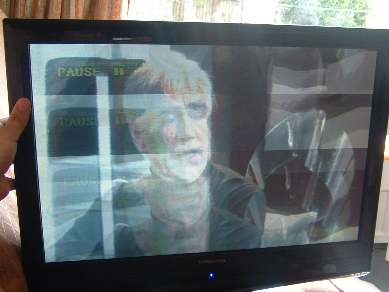

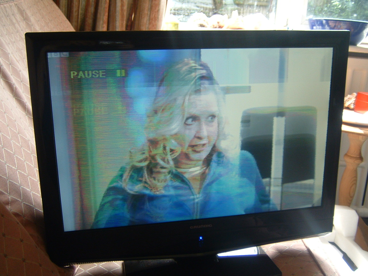

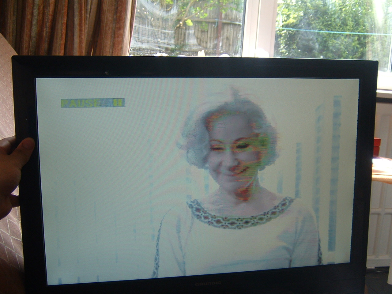

    Some photos of the fault.
    Some scenes cause vertical rolling, others do not. Seems very light or very dark is okay but lots of brightness transitions = problem.
    Also note the colour noise, didn't notice that before.

          Amazingly, it looks like the oscillating regulator ISN'T the problem. I soldered a 47uF cap in parallel, 0.9 ohm ESR. Now it's not oscillating but the picture problem is the same; time to check the T-con.
            Re: Grundig GU22DVD - Fuzzy/rolling picture
            Okay... it WAS a loose cable in the end. Just on the T-con end. I'm sure the LDO would have eventually caused issues though... It's fixed now though.
