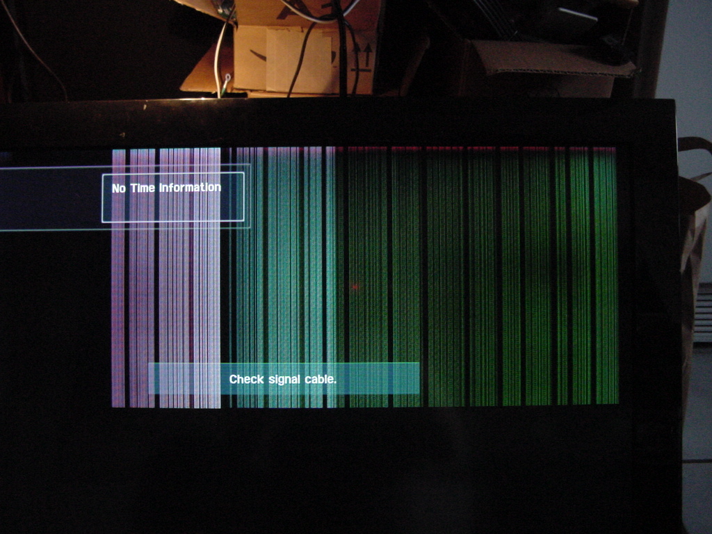

Samsung LN32B540P8D with bad screen

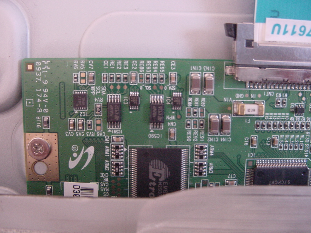

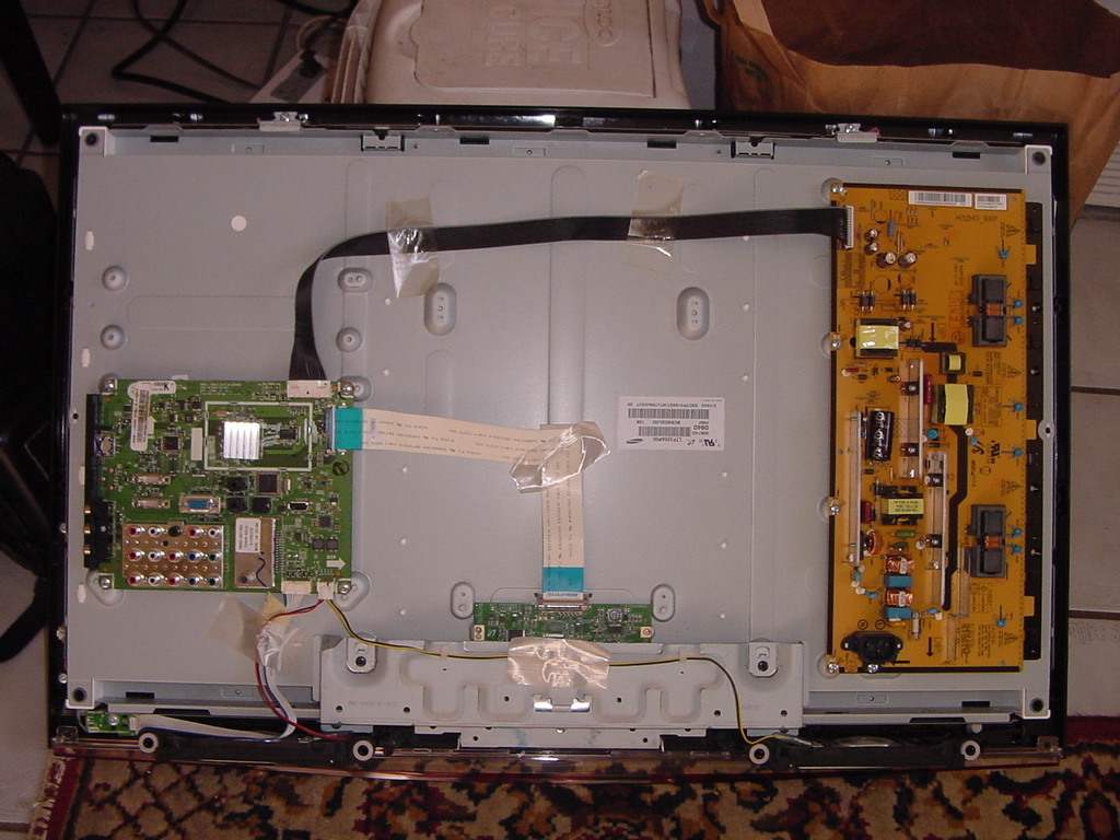

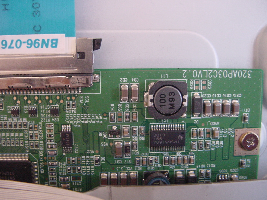

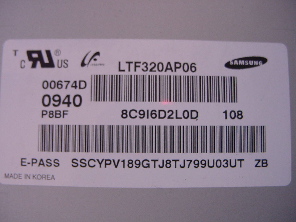

Lines and picture freeze up if you flex the screen. I had spare T-CON that did not fix the problem. I did not dis assemble the panel yet to see if I can fix the bad tab bonding.Never stop learning

Re: Samsung LN32B540P8D with bad screen
I had a 52" that did this, it was only on half the screen though. the COF ribbons from the panel actually started to corrode/tear away from the buffer interconnect board itself. No fix. I tried and it only lasted maybe a few days.Comment
No luck keeping the tab bonding in place to keep contacts mating to stay on, it works for whilw and then the problem came back again. I will wait for another panel to show up.Never stop learning
http://www.badcaps.net/forum/showthread.php?t=24809Comment
