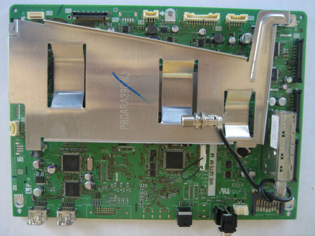

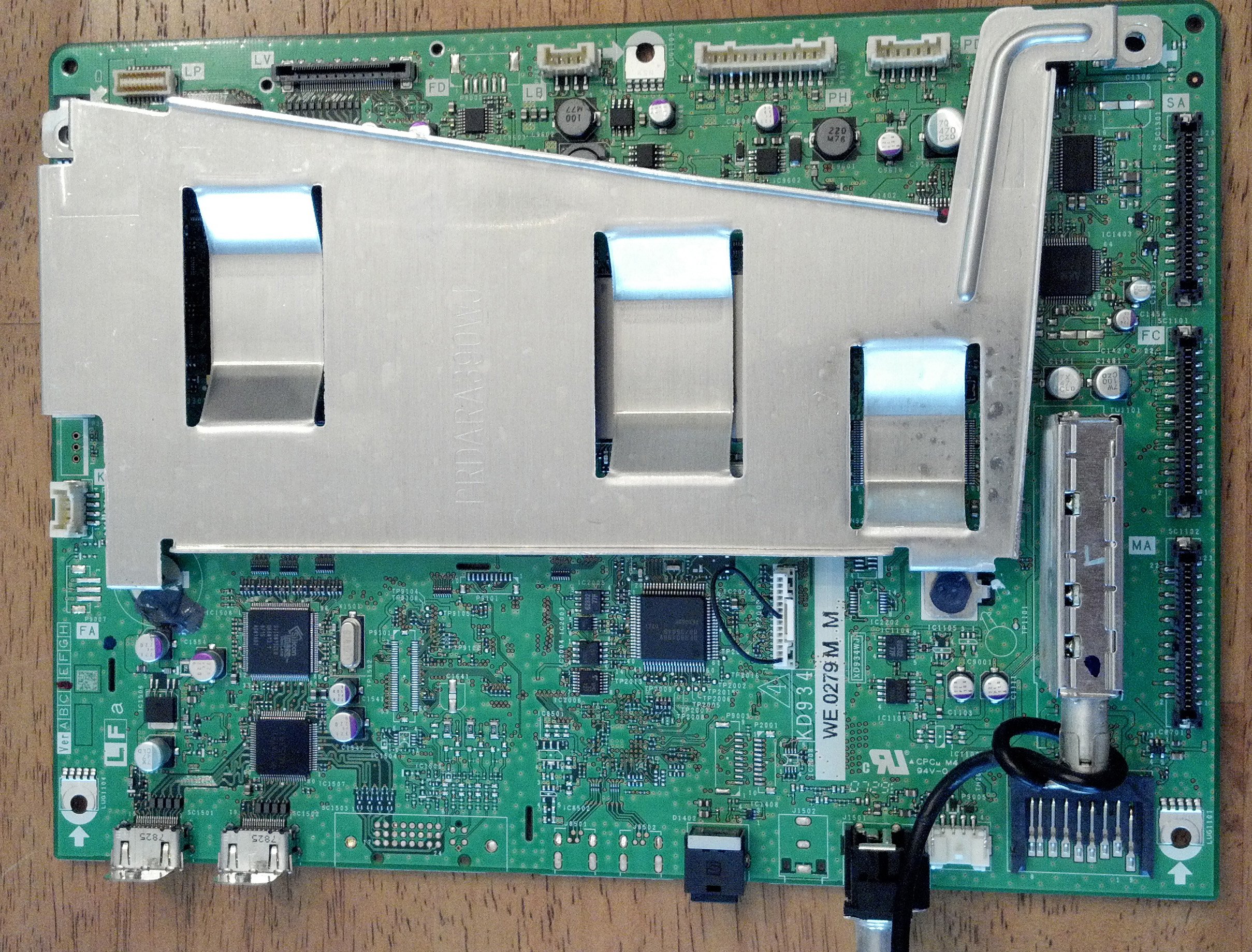

        See attached pics of the old and the new mainboard from ebay. All the numbers are the same except for the number in the white box which I am told is a production code and will be different on each one (hopefully).
        New board from ebay is on left in the pictures below.
        Both boards are KD934 Ver 4. The ebay seller is very friendly and is also willing to take back any parts that do not fix the TV. He told me that this board came out of the same model TV I have (LC-C5262U) that had a broken screen.

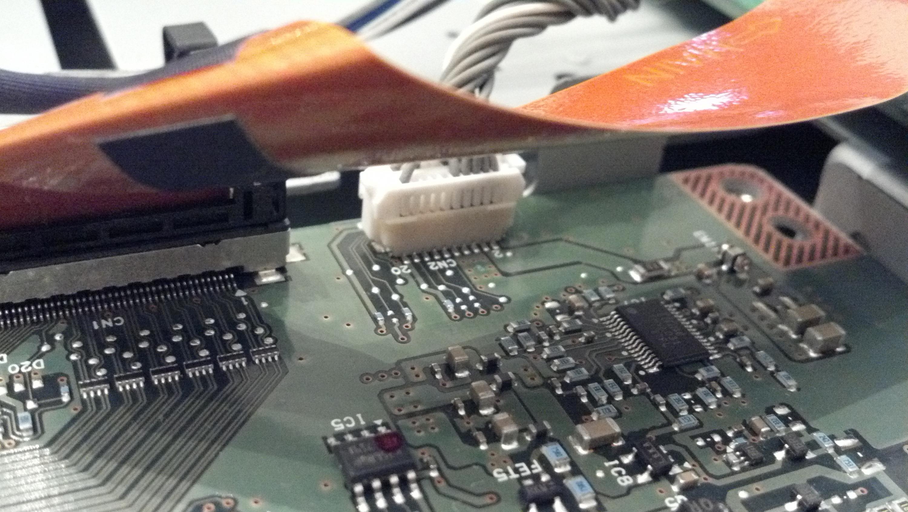

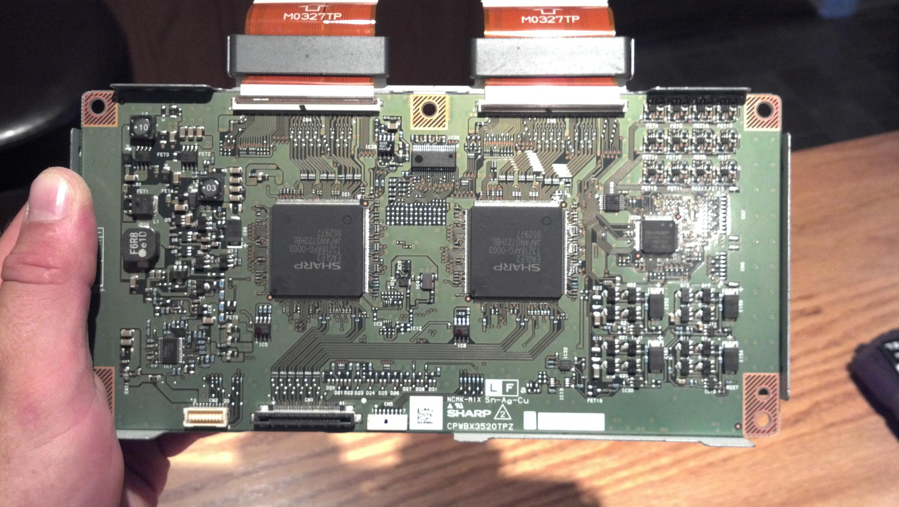

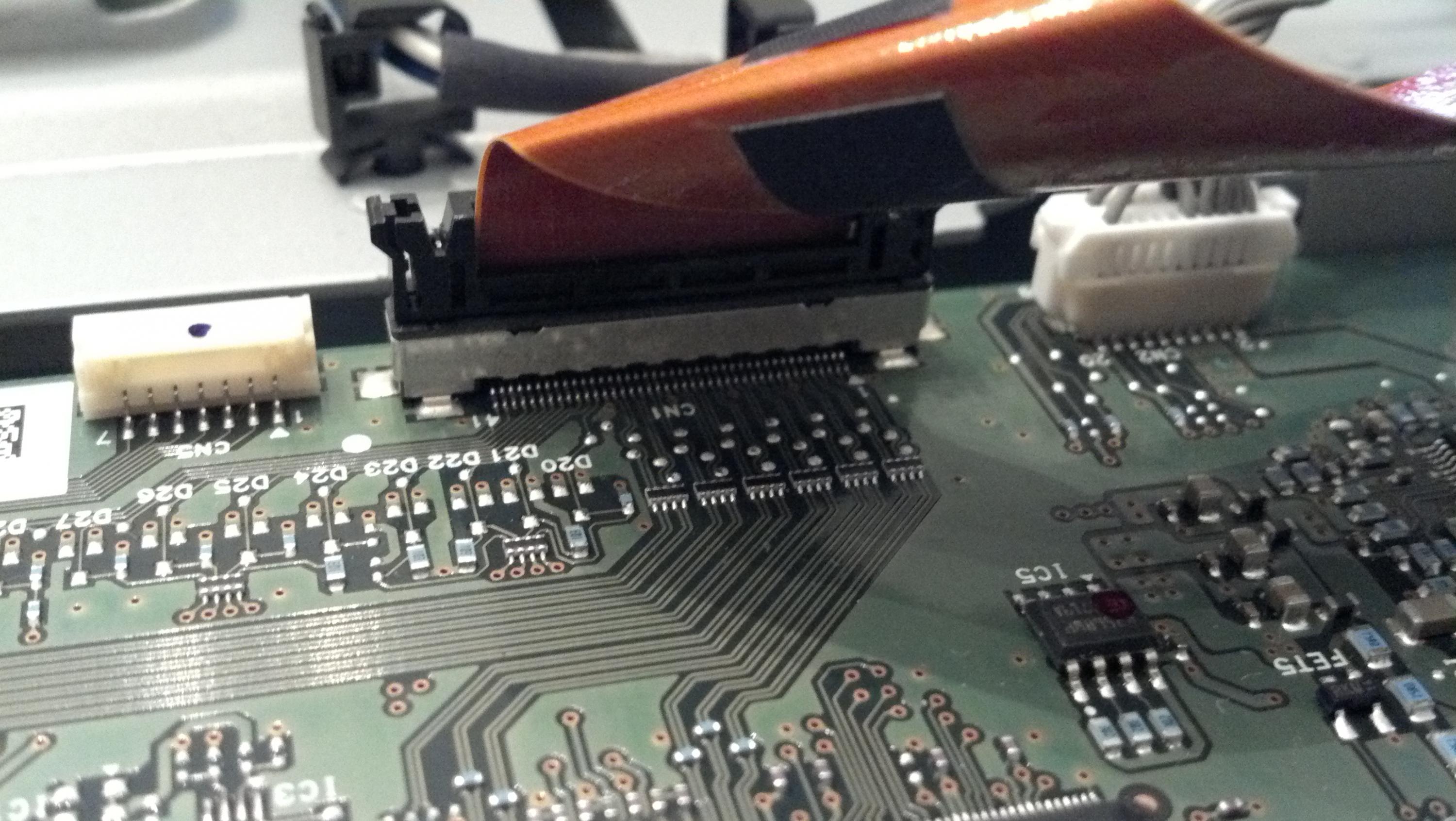

                Not really sure how to check for power at the boards,... I have a digital multimeter, and I have a friend that can assist me. I posted pics of the LCD controller board,..I assume the grey is the power cable to the board, and the ribbon is the data? Where do I check for power and what setting do I put my muiltimeter on? (Sorry, but I am bit new to this part)
                Secondly,.. I unplugged the grey cable to the LCD controller and turned on the TV. No more blinking lights,... It seems like I have back-lights as the screen is lit up in black. I only did this for about 10 seconds as I do not know if I can damage the TV if I leave it on for long periods with boards unplugged. Does the fact that I do not have blinking lights with the controller unplugged mean something?

                  To me, it suggests there is a short circuit on that T-con board (the small board connecting to the LCD.)
                  I cannot see any harm in leaving it unplugged; if you connect a source to it and blindly select sources, can you hear sound?

                    Although,.. I turned the TV on with the T-con unplugged and then plugged in the T-con board while the TV was still on. As soon as I did that, the TV clicked and gave me the blinking lights.
                    I guess it sounds like there is a problem with this board
                      Re: Sharp LC-C5262U Power & OPC Lights Blinking
                      It was the T-con board. Replaced it and its all good. The original mainboard ended up being ok. Thanks to all for the help!

                          @buldogrec, the same model TV can be using different LCD panel, so the T-CON board for your TV may not be the same as your. You should get access to the T-CON and look at the number on the board and also on the bar-code sticker to get exact match.
