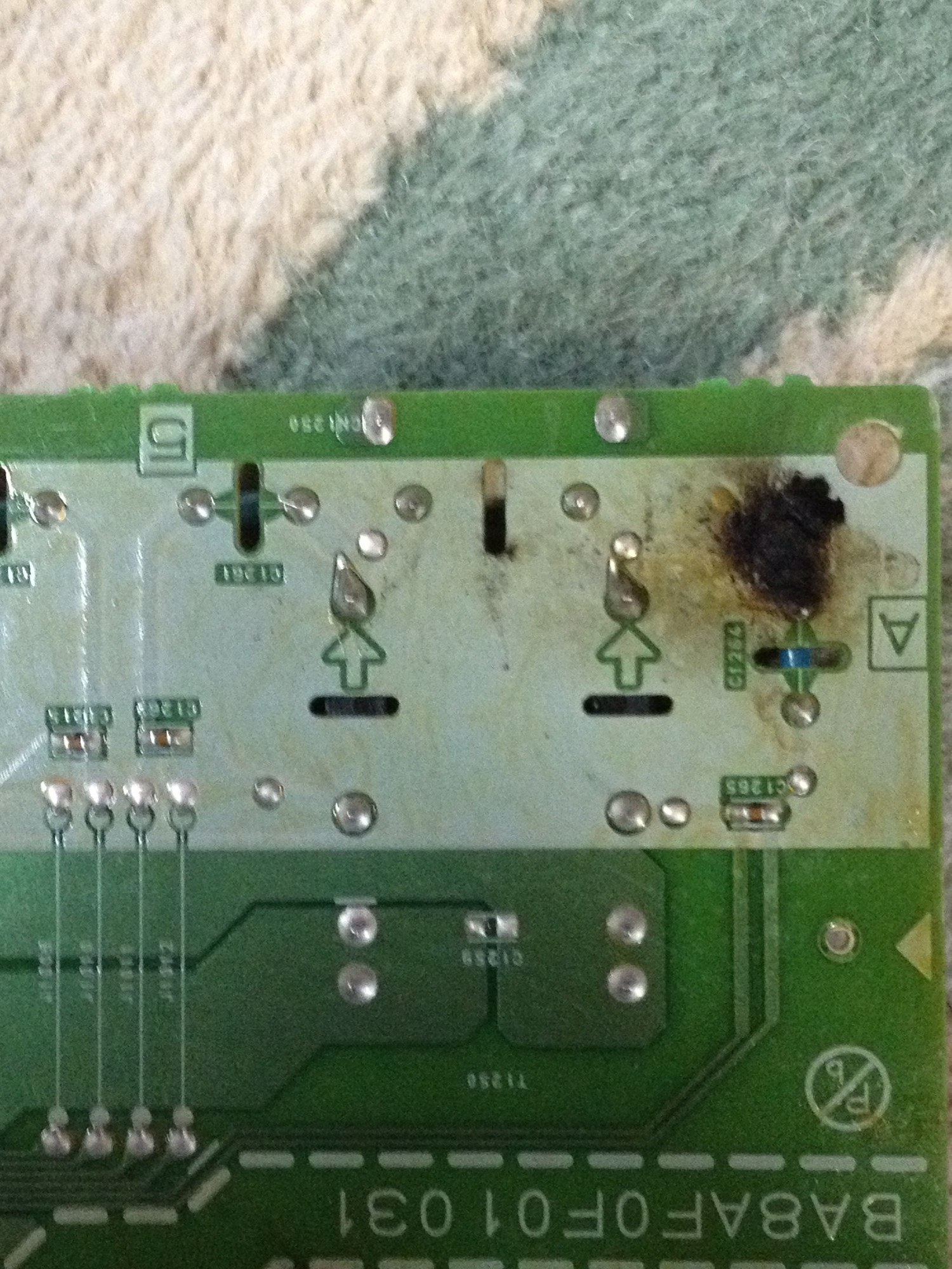

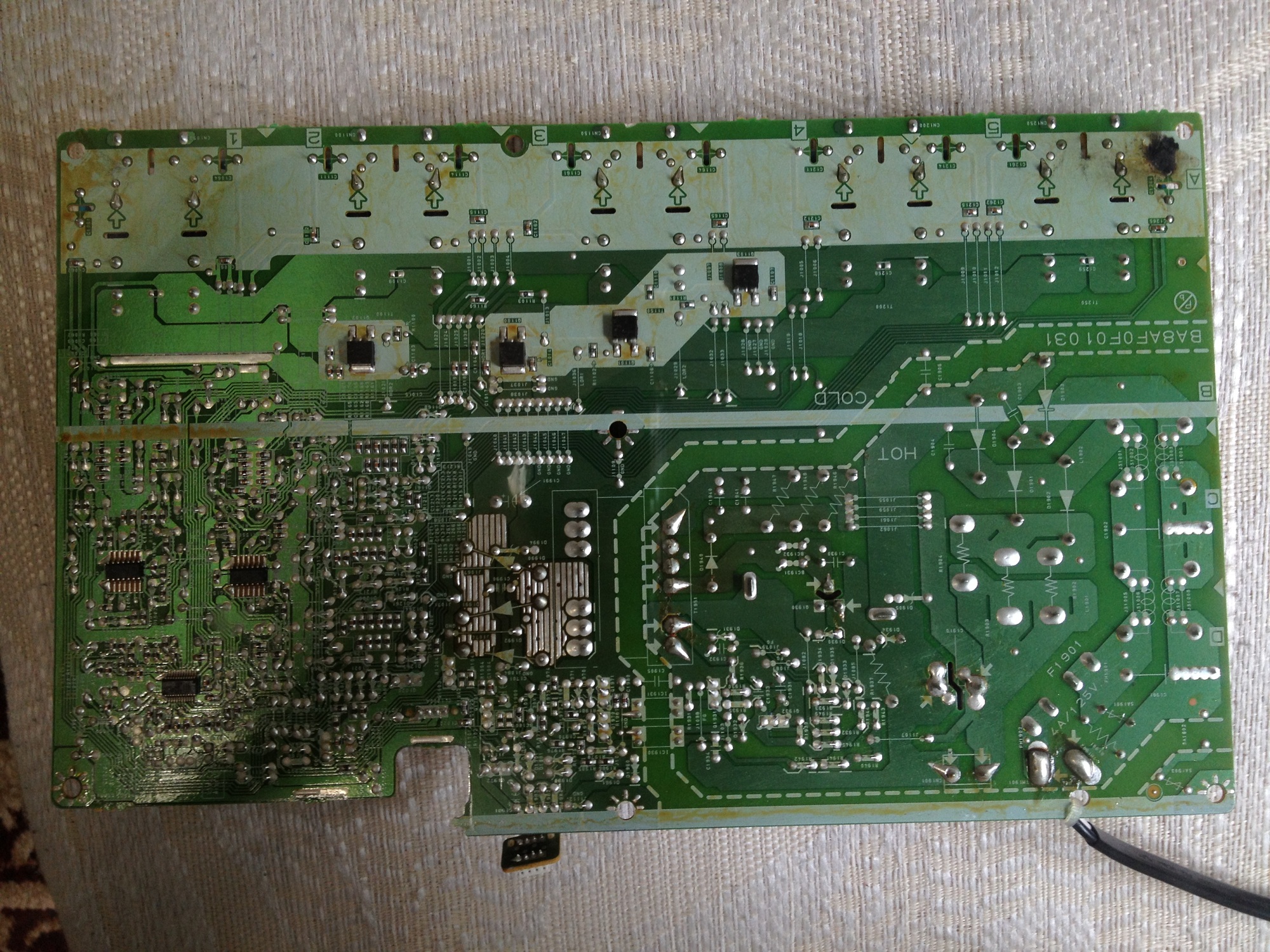

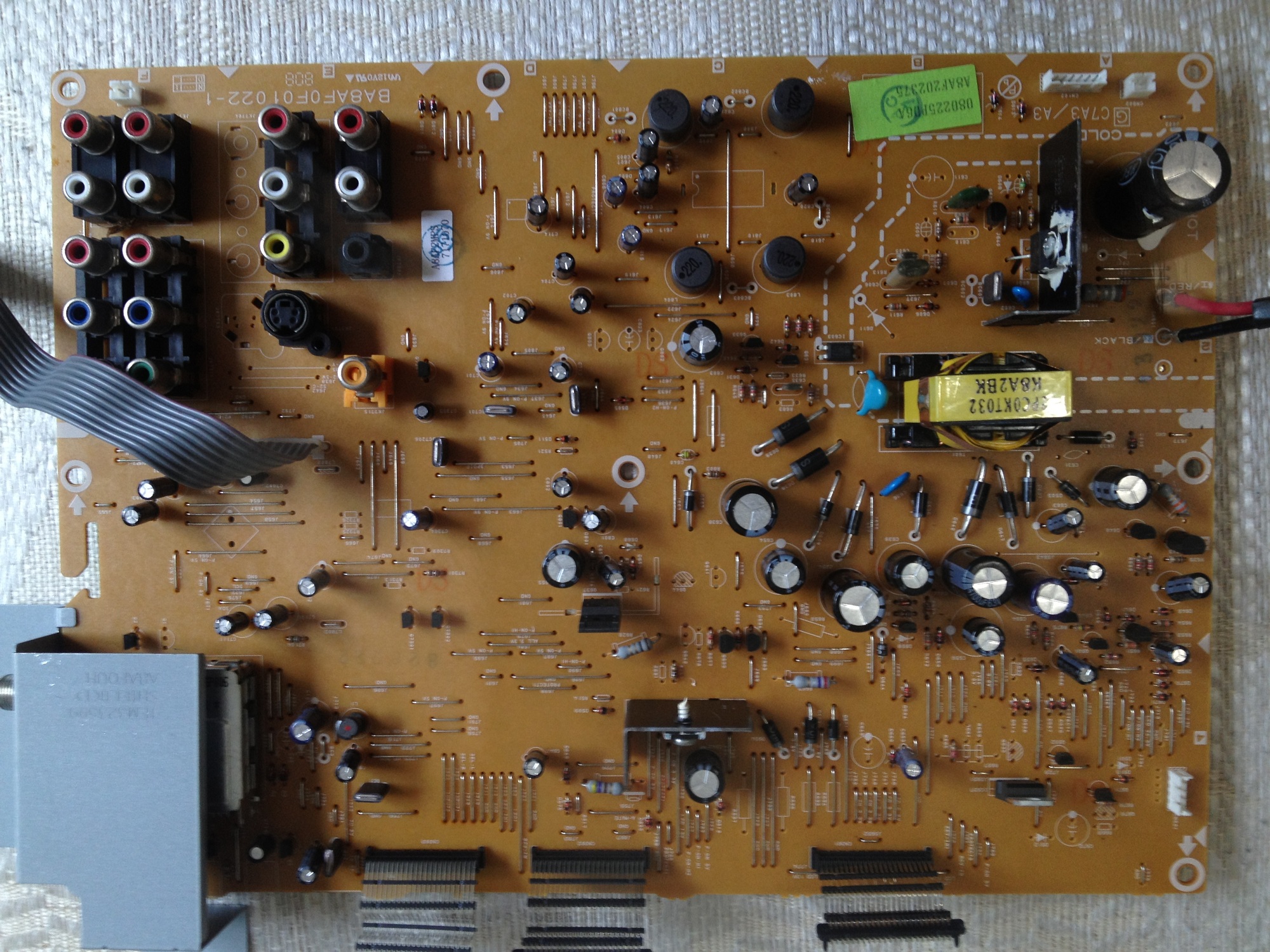

        Okay, So I just got the TV. I plug in the TV and the Green LED would start blinking a number of times and then the TV automactically turns on and the screen with the words "Digital Television" starts flashing like struggling to stay on. Theres a strange buzzing sound coming from the back and I get a funky smell coming off of the TV (part of it smells like burning).

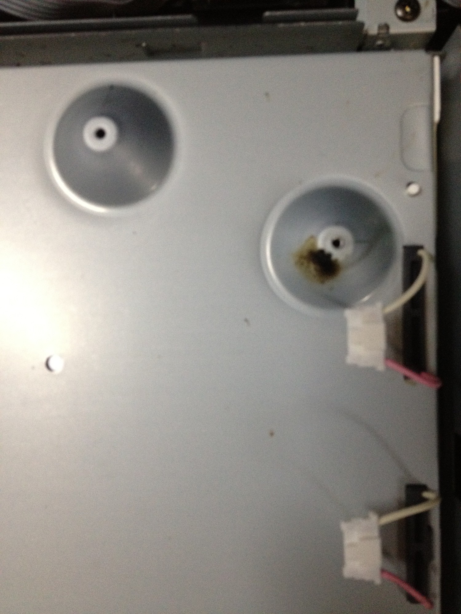

        I removed the board and theres a burn spot on the back of the corner near one of the CCFL connectors. So I disconnect that connector and try turning on the TV again. I get the same exact problem as is nothing as changed when I disconnected it so I think it might be part of the problem. I'm not sure if that burn spot was done from a repair from the previous owner or it was caused by a short because there doesn't seem to be anything there that would cause that spot to get that hot. And it also burned a spot on the back of the panel. The trace might of been damaged so I might have to wire that blue cap to where ever its suppose to go.
        The buzzing sound I get is coming from the transformer on the main board. But I think theres also another buzzing whistling sound coming from one of the inverters on the power board.
        For now I'm just checking diodes, and capacitors to see if there good. Any suggestions on what the problem is?

          If it turns on for second and shows the "digital television" on the screen chances are the diodes and caps are ok. I think the caps on this board are general purpose anyways. I do remember seeing a post a while back saying that if one of the inverter transformers was out of range the tv would shut off instead of a traditional 2 seconds to black. Since you have a big burnt spot at one of the transformers thats where my bet is going to be placed.

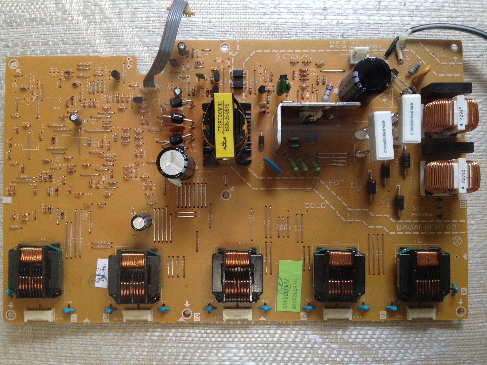

          Start by checking your inverter transformers with your meter in the ohm setting. You can check it right at the connector where the bulbs plug in. They should all be in the 7.5Mohm range. Post your results.
          I have almost the exact same board. My board number is BA8AF0F01032. It's one model number higher than yours. It was pulled from an emerson LC320EM9.

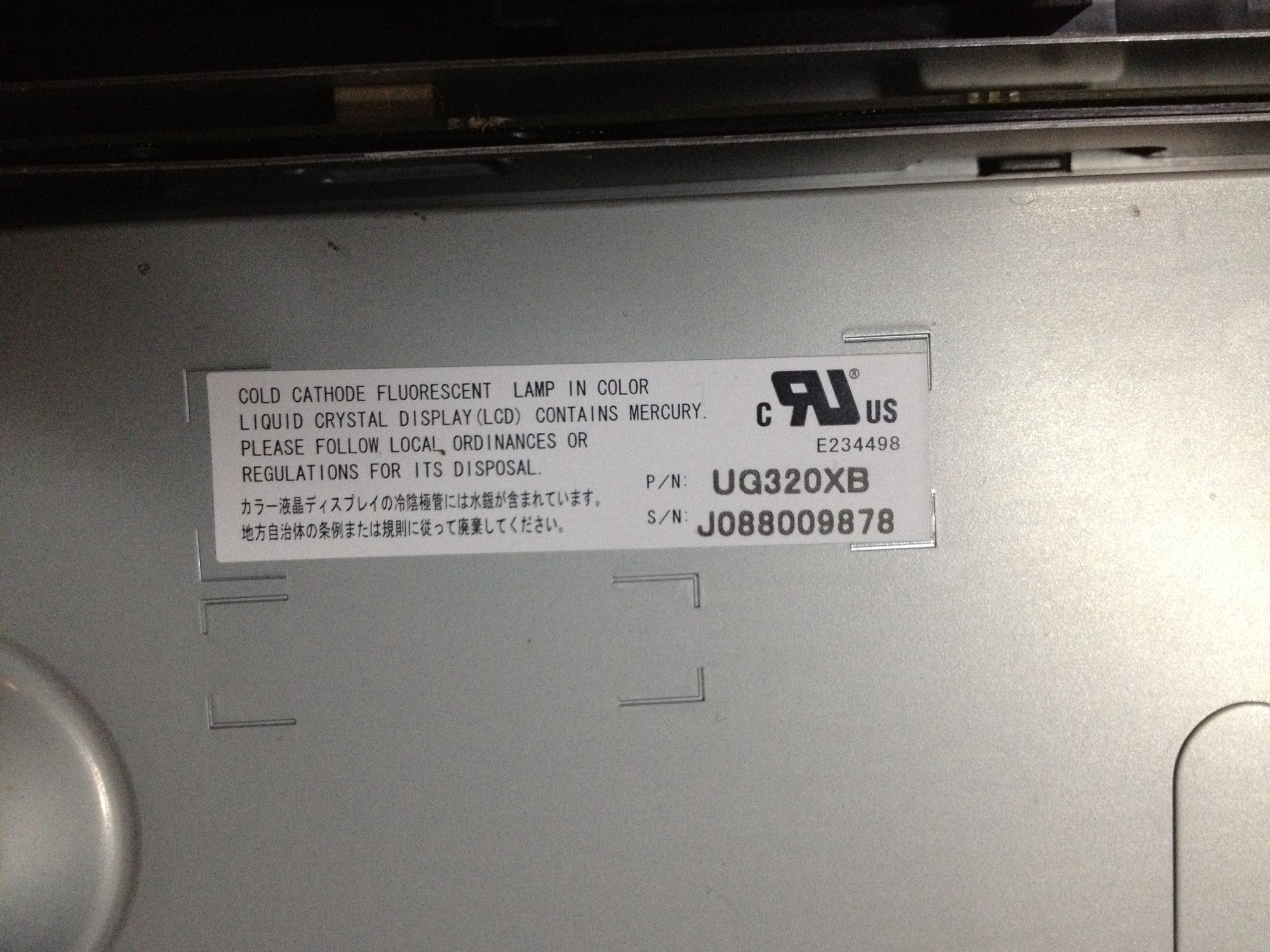

          Also btw, what panel is in your tv incase you have to goto plan B

            Heres my panel number:

                            Re: *Possible Purchase Magnovox 32mf338/27 Turns on for a second

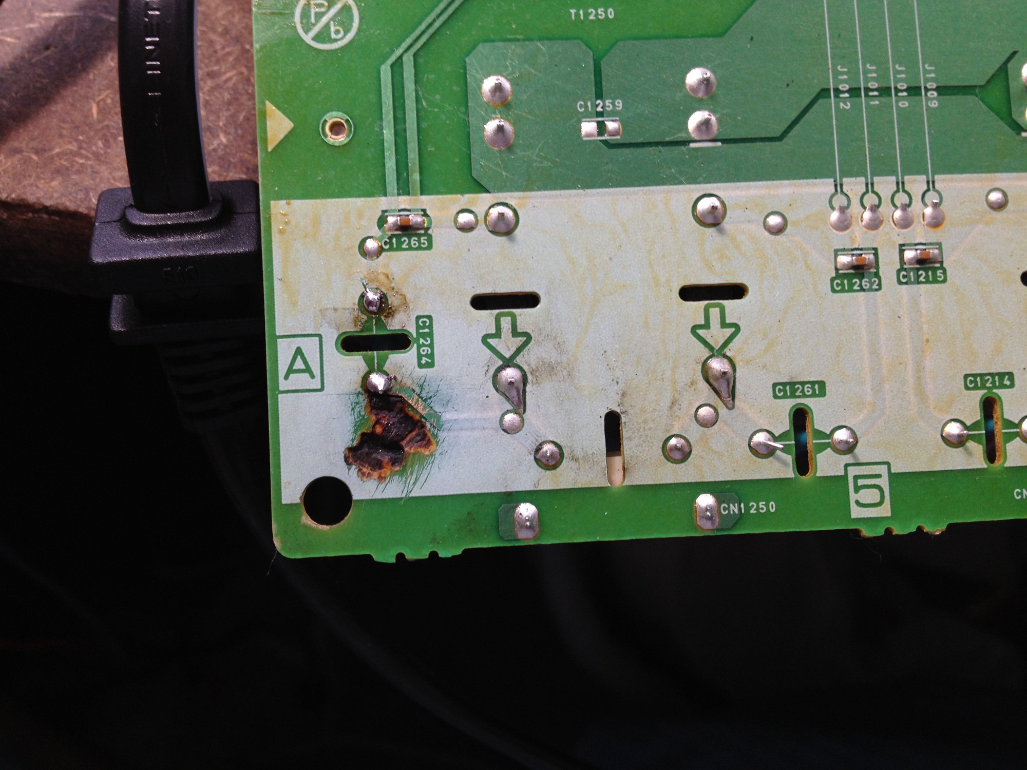

                            Doesn't seem to be any physical damage. Heres a photo again of the spot after I cleaned it.
                            As for the buzzing sound im hearing from the transformer. I unplugged the TV but the buzzing sound is still there for about 15 seconds. The Service manual said is there is a "buzz sound heard in vicinity of power circuit." I should check all the diodes that are near the transformer. And also IC637, I think is a voltage regulator?
                            All the diodes seem to be good, so I'm gonna measure the capacitors that seem to be in series with each diode.

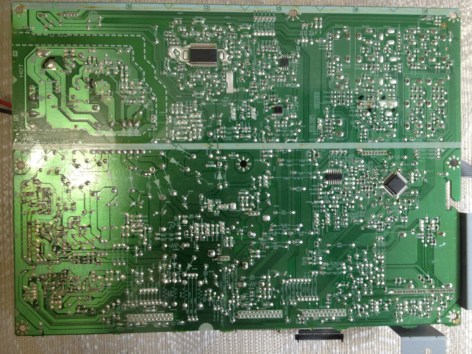

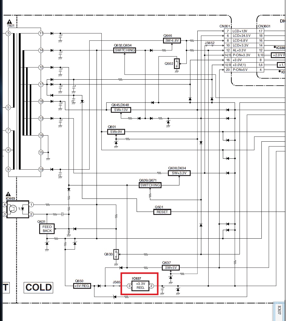

                              Well, all the diodes and caps checked out good, so I'm guessing IC637 might be the cause for the buzzing. How would I test this componenT?
                              • Mr Bill
                                • Nov 2011
                                • 648

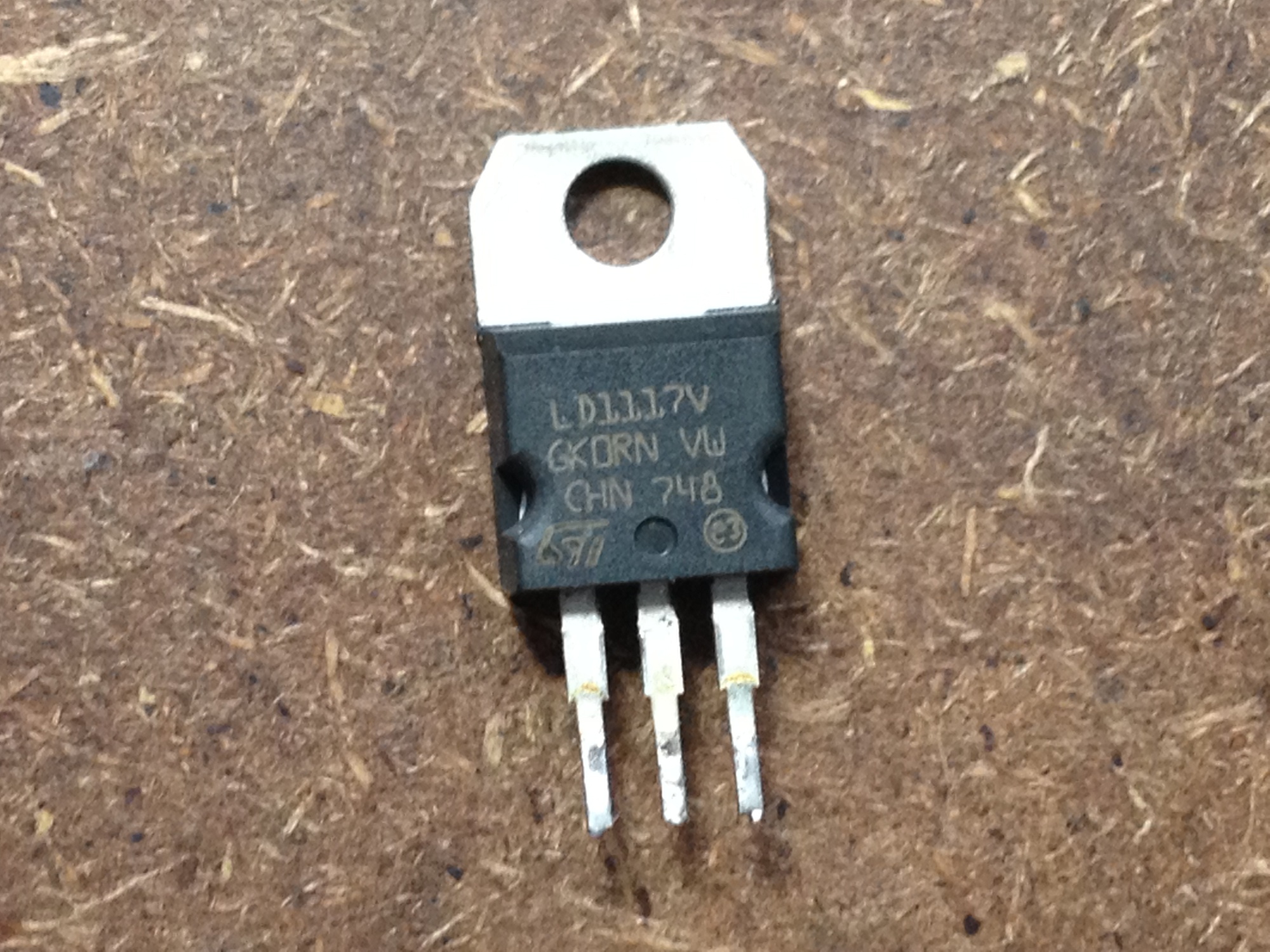

                                That is a LDO voltage regulator. The usual method it to see if its give 5v IN and something like 1.8, 2.5, 3.3 volt out. Its an adjustable regulator or it would have a -xx after the 1117. (xx being 18, 25, 33).
                                • XtraTN
                                  • Mar 2012
                                  • 81
                                  • Usa
                                  On the Block Diagram it says +3.3V so does that means it outputs 3.3V? I don't understand how to read much of block diagrams yet.
                                  Should I put all the boards back together and measure the voltages of each pin of the LDO? I don't want to further damage something.
                                  Also just wondering, What do all the other labels on the LDO mean after "LD1117V"?
                                  • Mr Bill
                                    • Nov 2011
                                    • 648
                                    It'll have 5v In and 3.3v OUT.
                                    Thats the usual method for checking a voltage regulator.
                                    I think they are manufacturing codes, dates, ect.

                                      Good news, the TV is able to turn on. I guess that burnning caused a bad solder joint which caused no connectivity to that last inverter. I cleaned and resoldered the joint and the TV stays on now.
                                      Another Problem:
                                      I think there might be another problem though. The input voltage I measured for the LDO was at 6.26V. Output voltage was exactly 3.30V. Will the high input voltage be the cause of why the TV completely skips going on standby when it is plugged in and gets the blinking green LED (defect code maybe?)
