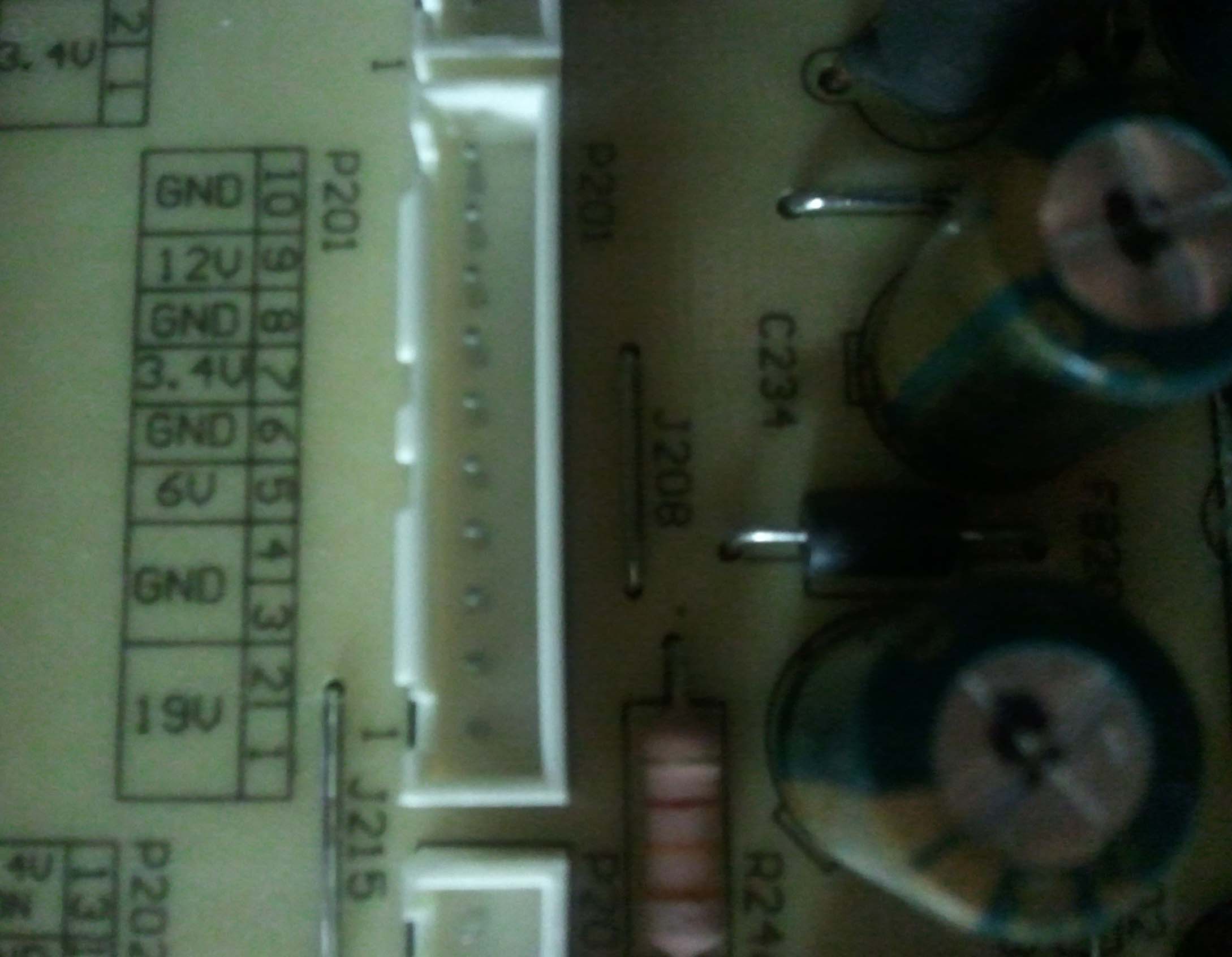

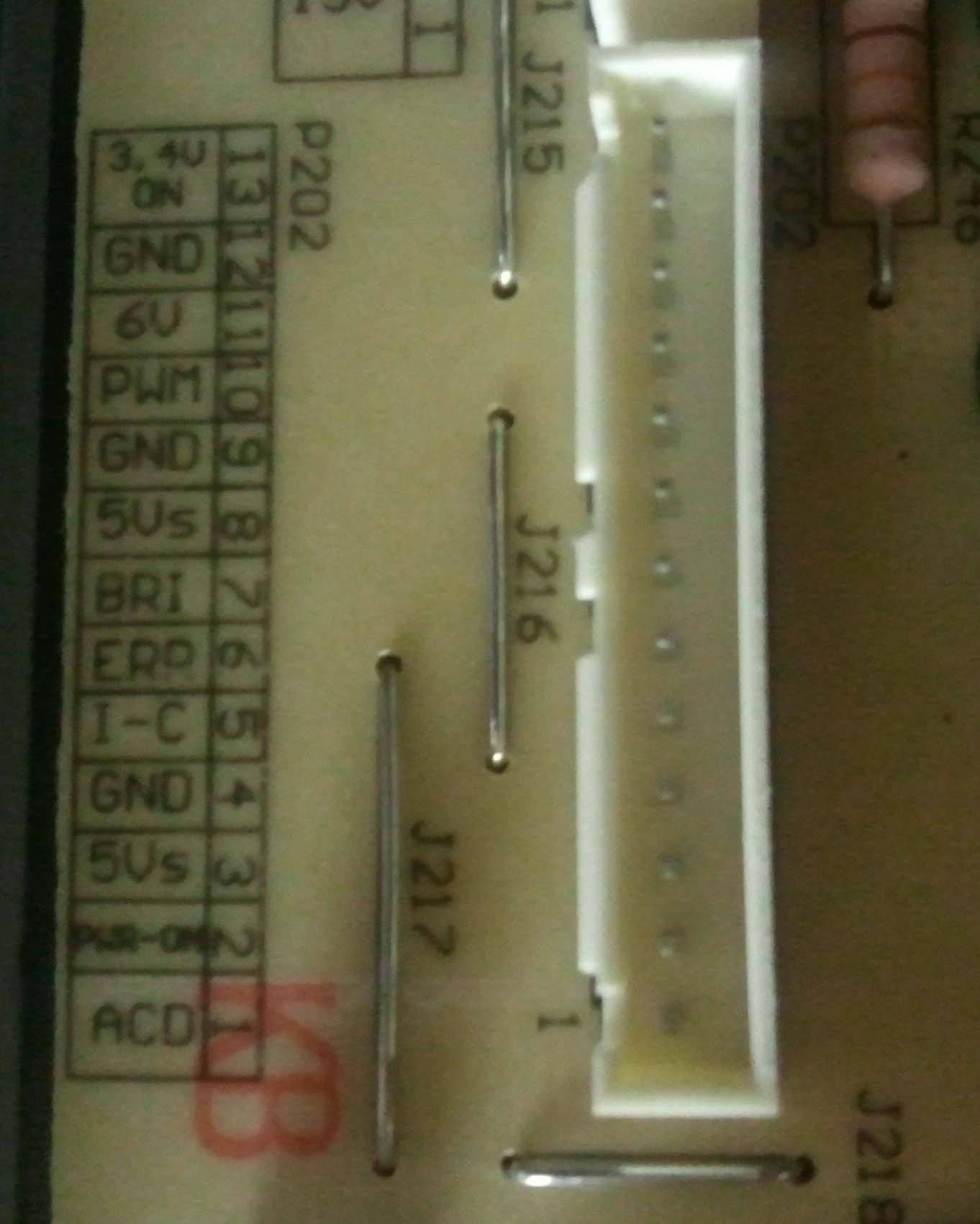

    Hi Pictures are not really good enough for troubleshooting
    remember that is all we have to work from. They need to be as follows and should not have the edges cut off.
    The only in focus picture is the one of the meter dial.

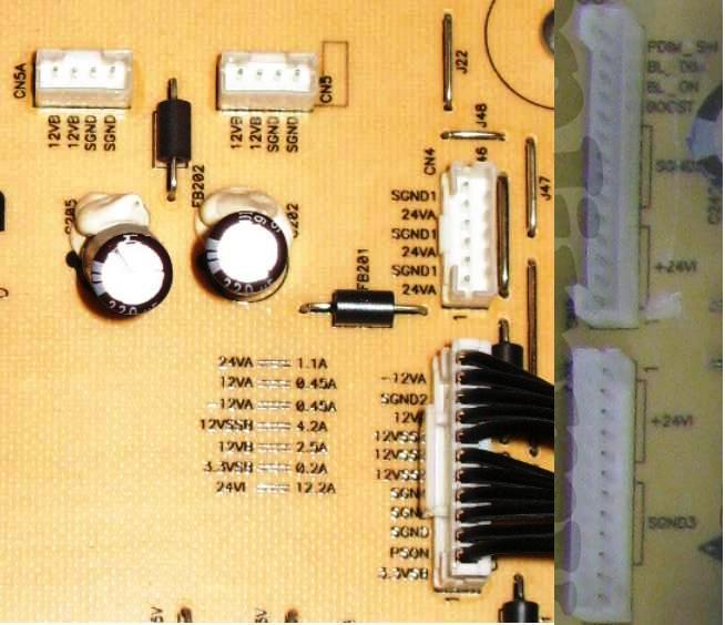

    Examples of what is needed
    https://www.badcaps.net/forum/attach...1&d=1290283049
    https://www.badcaps.net/forum/attach...7&d=1280167246
    Attached is a picture of a cable connector with the legend
    beside it showing what pin does what. If you can post in focus pictures of yours we will talk through testing.

      Ok Please try that test again - ALL the connectors should be connected and then the set plugged in and the power button pressed. What happens when you do that - any lights or sounds- what does the power led do?
      Put your meter on volts DC20 and put the black lead on the ground screw in the right hand corner of Mr Bills picture.
      Use the red probe and check along connector p200 each pin in turn.

        Power plugged in, pushing the power buttong does nothing, no lights on the front or anything.
        I tried testing the connectors like selldoor suggested but getting no readings at all.

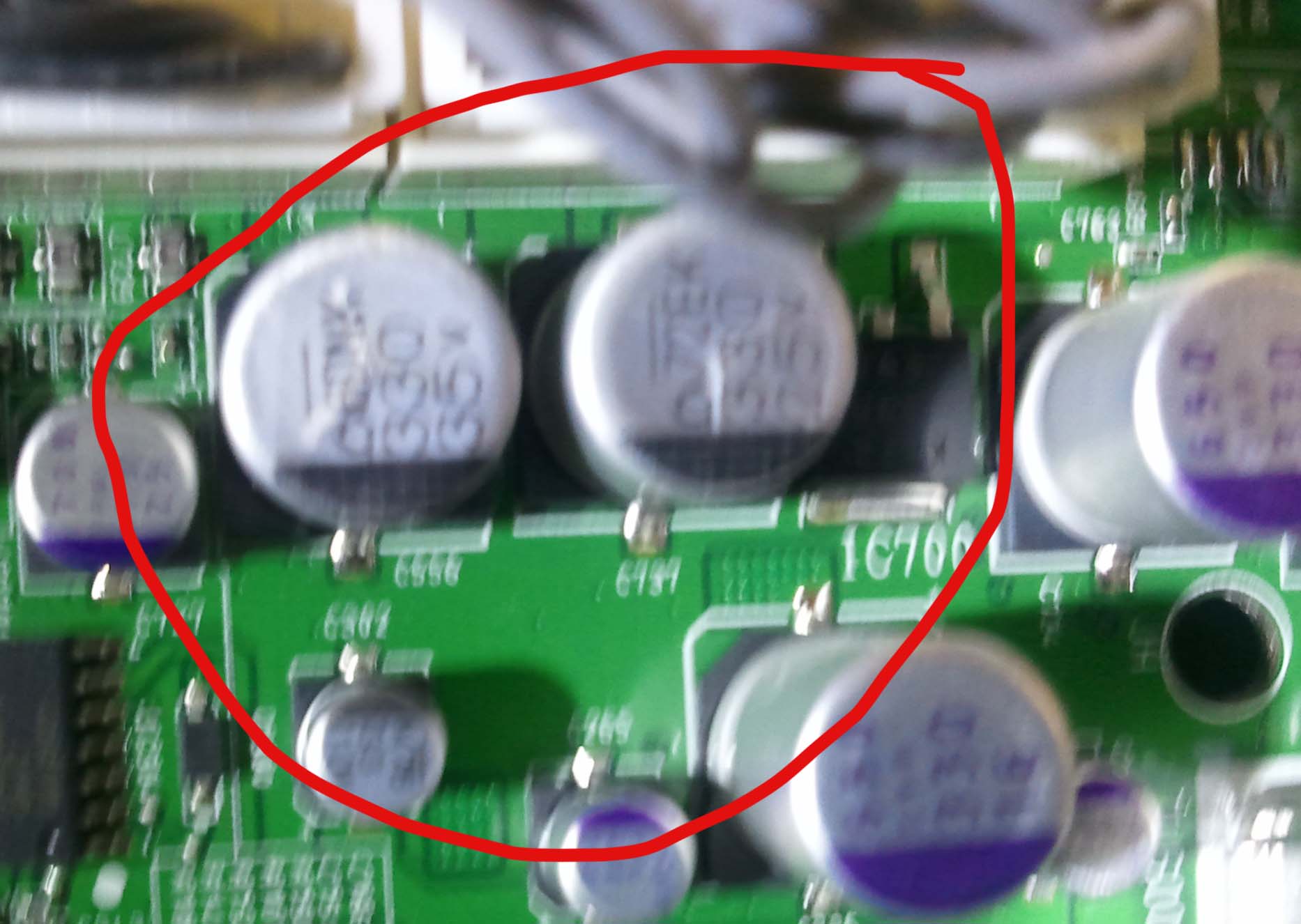

                  I just noticed these 2 caps on the main board. Do they look like they are getting ready to burst? All the other caps are smooth and seemless, those 2 have lines going down towards the center like the top is getting ready to split open.
                    those are fine ,visualy

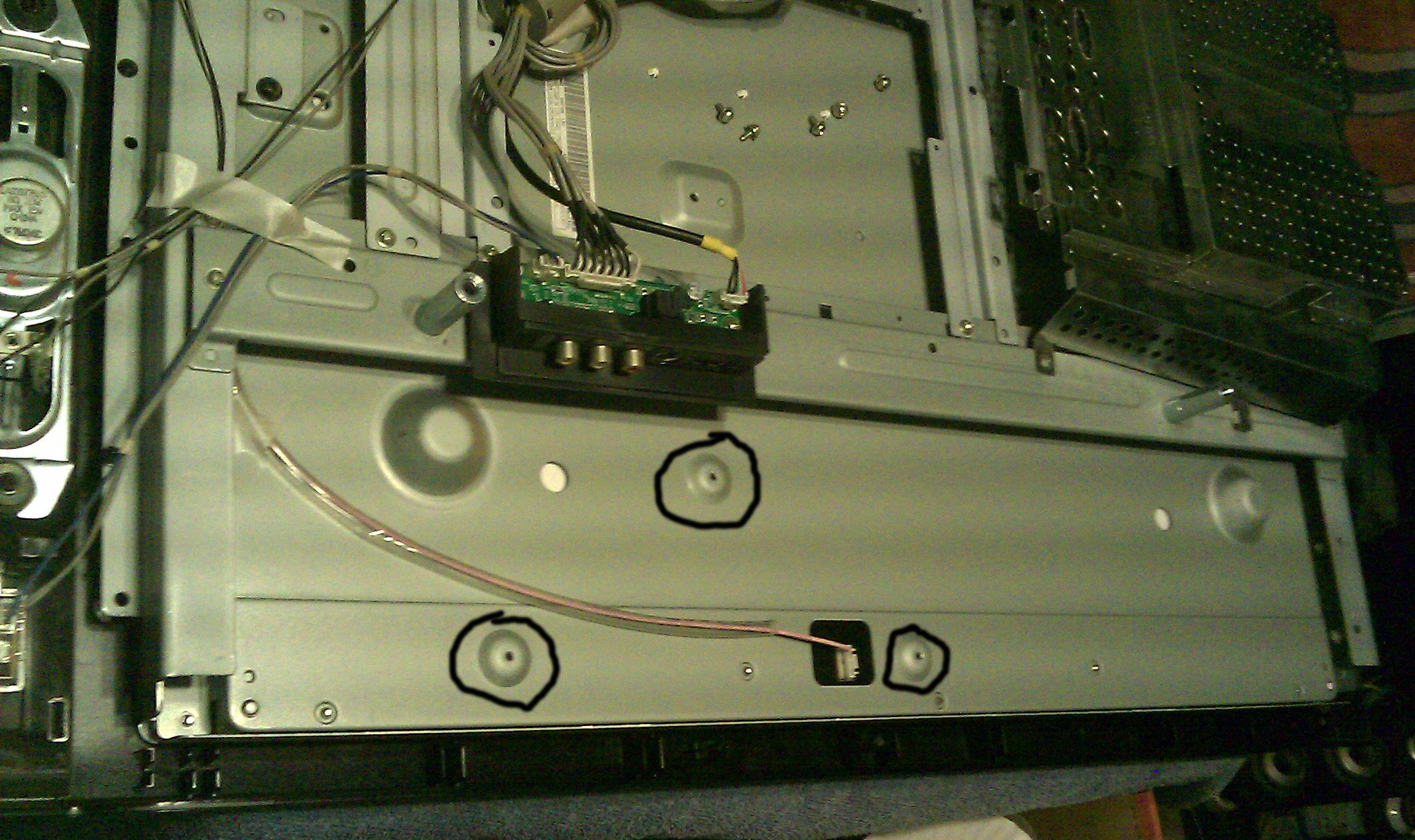

                          Hello all i am new here so my posting abilities are very limited but i also have a LG 47LC7DF but i cannot find any post about my sub model number which is instead of it being 47LC7DF-UB mine is a 47LC7DF-UK and finding a service manual seems impossible. The reason why this is important is because my TV looks different from any other 46LC7DF that i see on the inside.
                          I don't mean to be high-jacking someone else post But like i said i am very limited.
                          My problem isn't total power loss because my TV will turn on and have sound just no picture but how i acquired my TV is something that is important and some of the reason why i will be asking a few questions.
                          I got my TV from a yard sale as a freebie if i bought something else. I was buying a vase anyways so it was only the cost of transport.
                          I have been reading and searching about this problem in other LCD TVs and just about all of them say its the power supply or the inverter board but as i am a novice i cannot locate the inverter board on this TV for the life of me.
                          I replaced the 2 large caps that were clearly blown (450v 150uf) & the fuse(250v 5a) that was blown near it and after starting it up again the problem remained and the fuse was blown again but how to trouble shoot this i don't quite know what my first step should be. I was thinking the Voltage Regulators but this once again i don't quite know because my lack of experience. I do own a Fluke 87 DMM but i and very new to it.
                          This TV appears to have been tinkered with a little before i opened it up so i have to ask is this TV missing something?
                          Any help is greatly appreciated and if this post is in the wrong spot or my questioning is out of order i apologize.

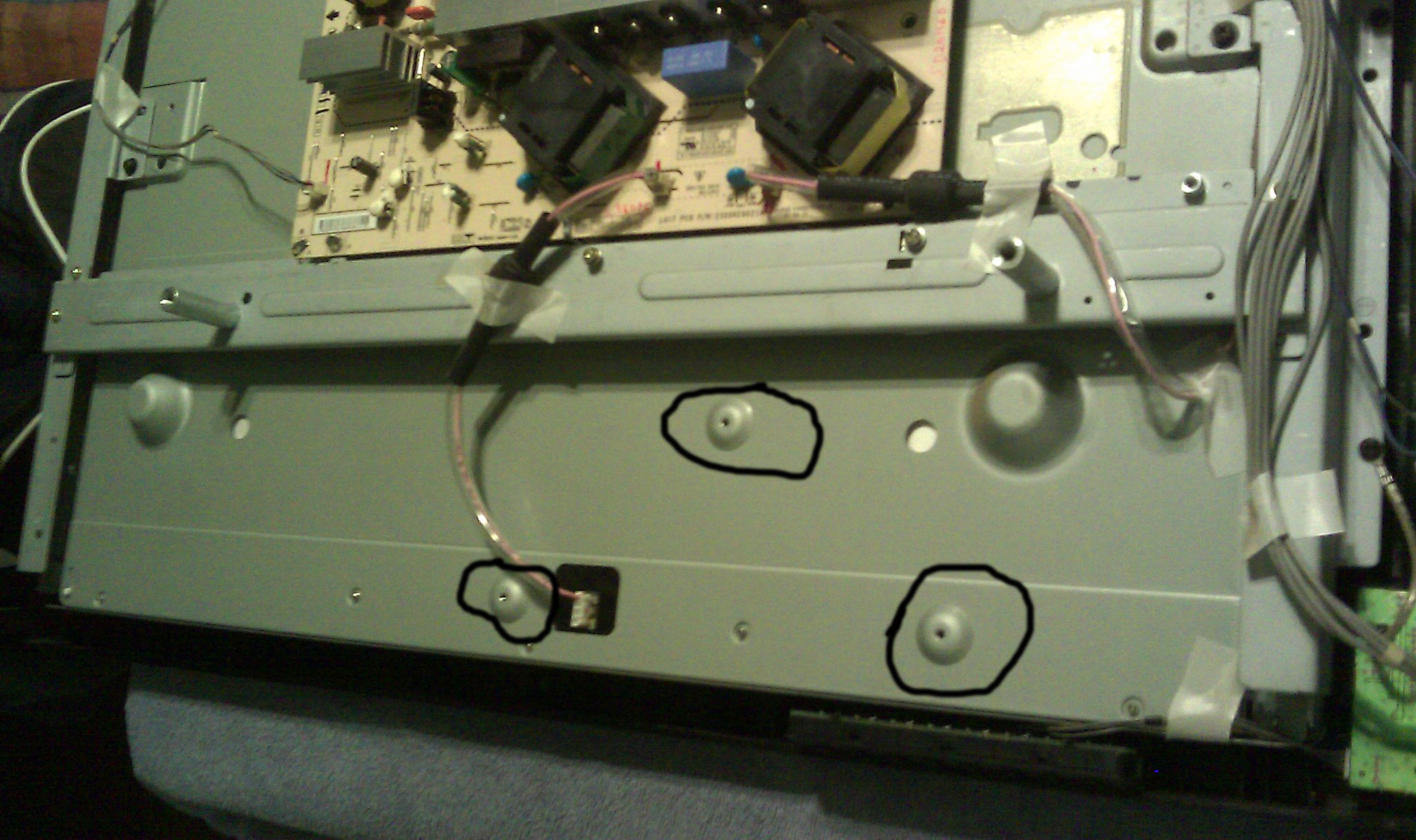

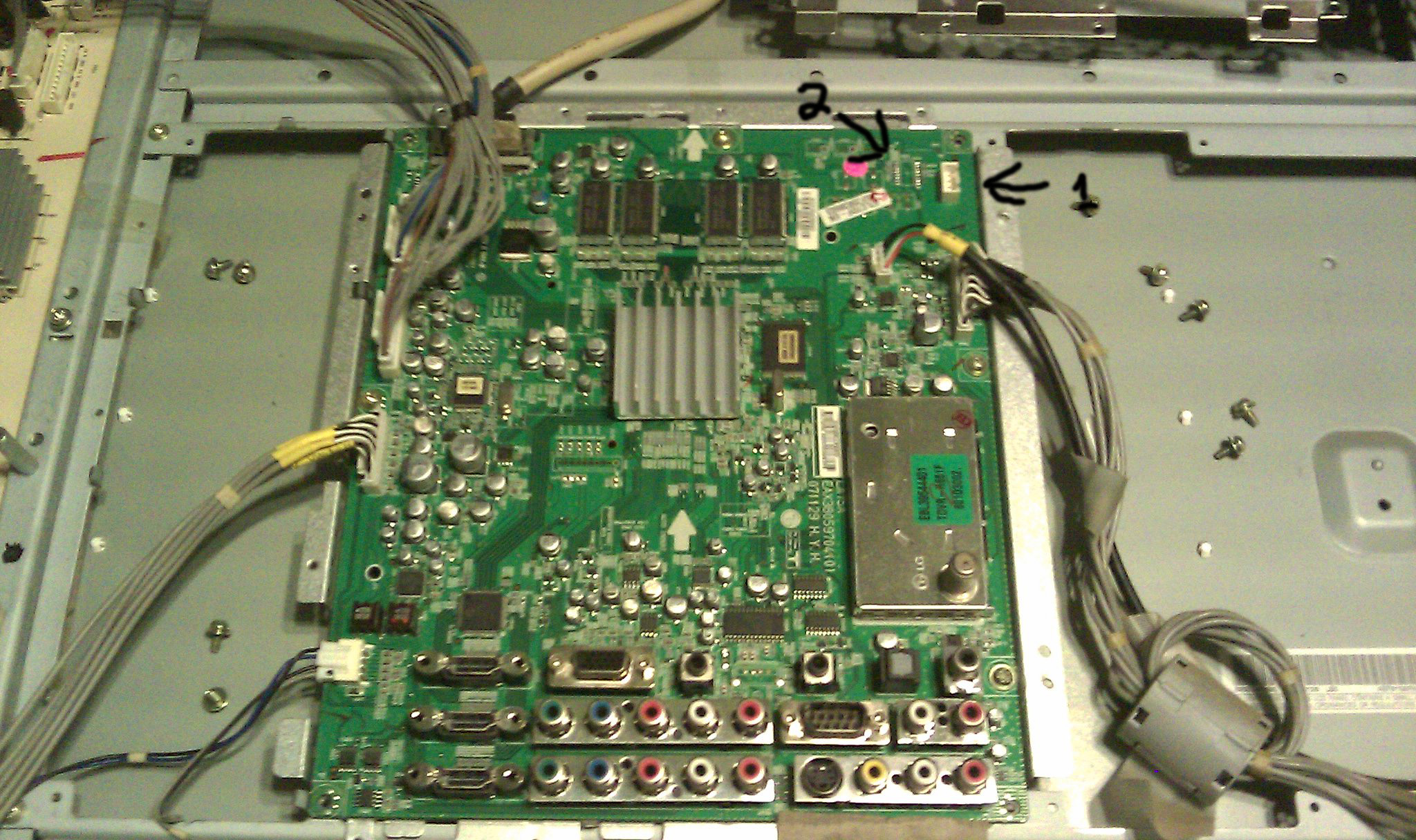

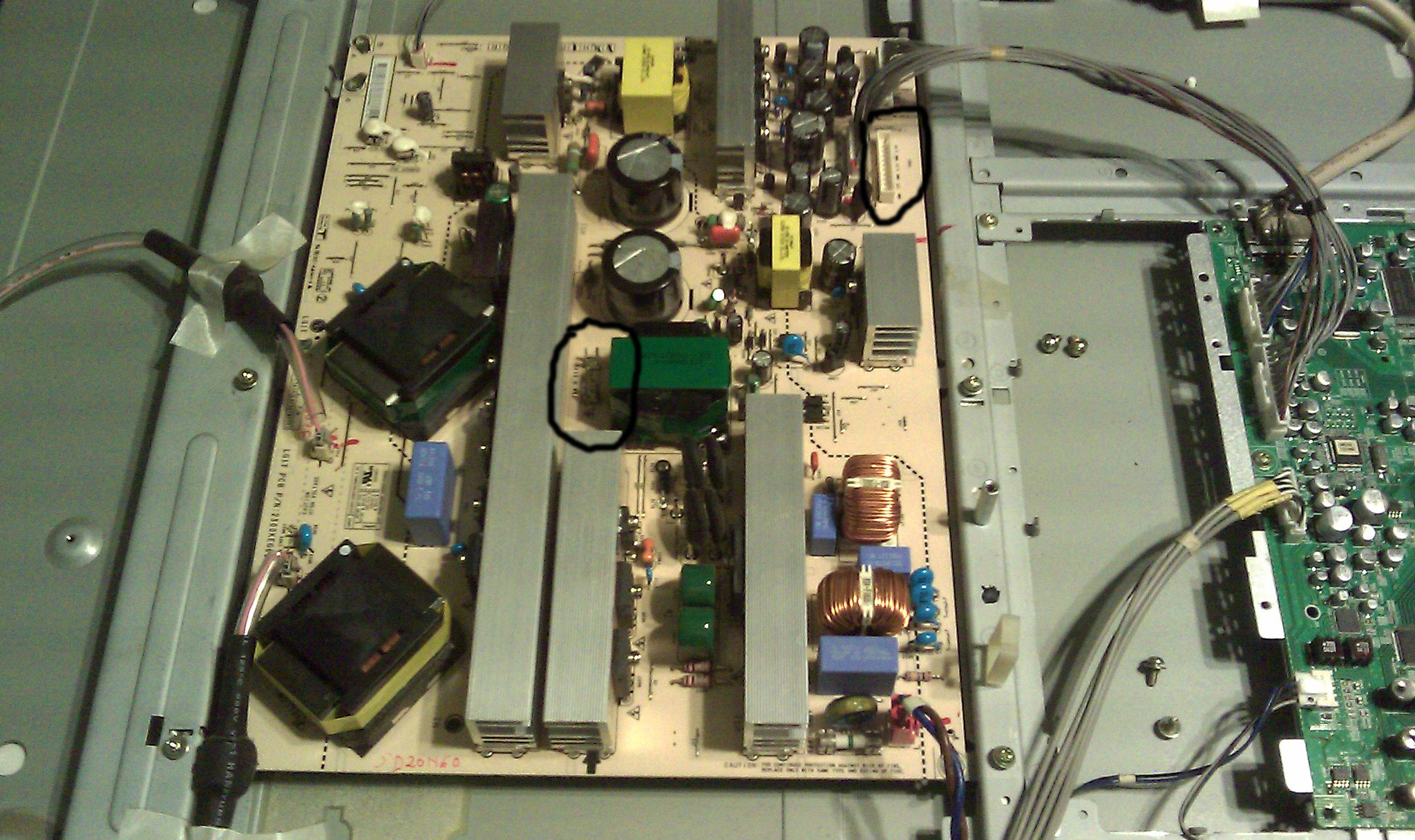

                              Please forgive my picture quality but i only had a phone and had to re-size them which degraded them. I am not too good with Photoshop but i drew some lines in to help direct attention to the areas of concern.
                              The picture of the left side is basically the same as the right but i put some outlines of where screw hole posts are where it looks like an inverter board could go but the problem is in the UB versions of my TV it has 4 boards and if you look at the picture there clearly isn't screw holes for all those boards
                              The picture of the Power Supply has the fuse missing because i took it out as it is blown. I circled the area of the fuse and the area where there is nothing plugged in.
                              The picture of the Main Board i have numbered 1 & 2, 1 is an open port where nothing is plugged in 2 is where i believe a chip/driver would be located.
                              The reason i showed the missing driver is to maybe ask if the power supply & main board are used in many different models and they only used the ports needed for this TV
                              checking to see if a fuse is blown is one of the things i do know how to do and it was well over 1 ohm and i doubled checked this with the lower fuse on the board which measured .2 and even triple checked it and turned on the buzzer part and it beeped for the lower and nothing for the upper (blown).
                              Power supply model = P/N : 2300KEG021A-F
                              Main board model = LA75A EAX38059704 (0) 071129 H.Y.H.
                              I didn't think anyone would respond so fast but i thank you for that and any help is always appreciated.

                                This may help:
                                http://www.shopjimmy.com/lg-eay36781...upply-unit.htm
                                http://www.shopjimmy.com/catalogsear.../?q=LG+47LC7DF
                                Your version uses power supply-inverter board combo instead of separate power supply and inverter board. There are more than one version of your TV model.
