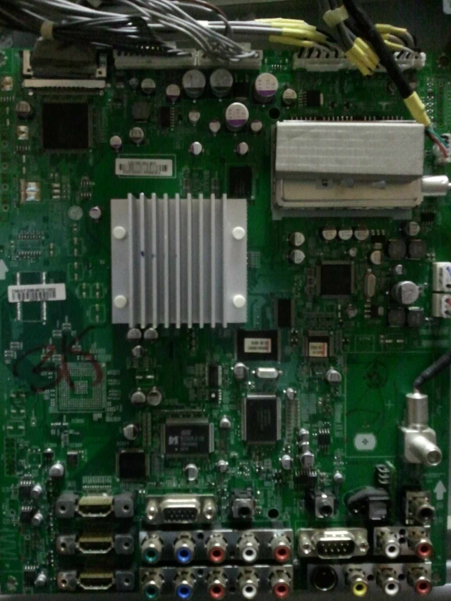

              OK here is the picture I took of the main board. Let me know if the quality is good enough and I will take more pics of the rest.

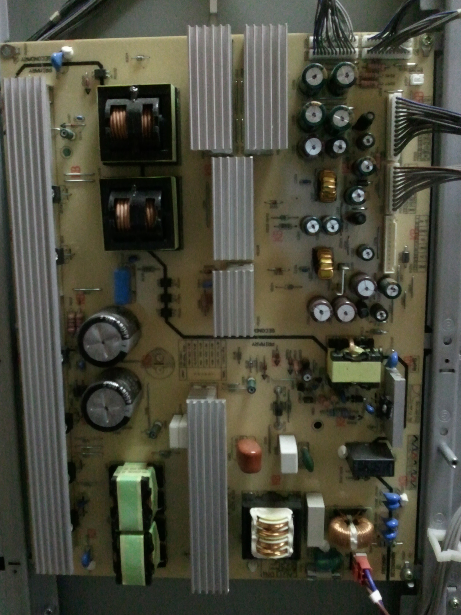

                I took this picture of the other board. Not sure if it is clear enough.

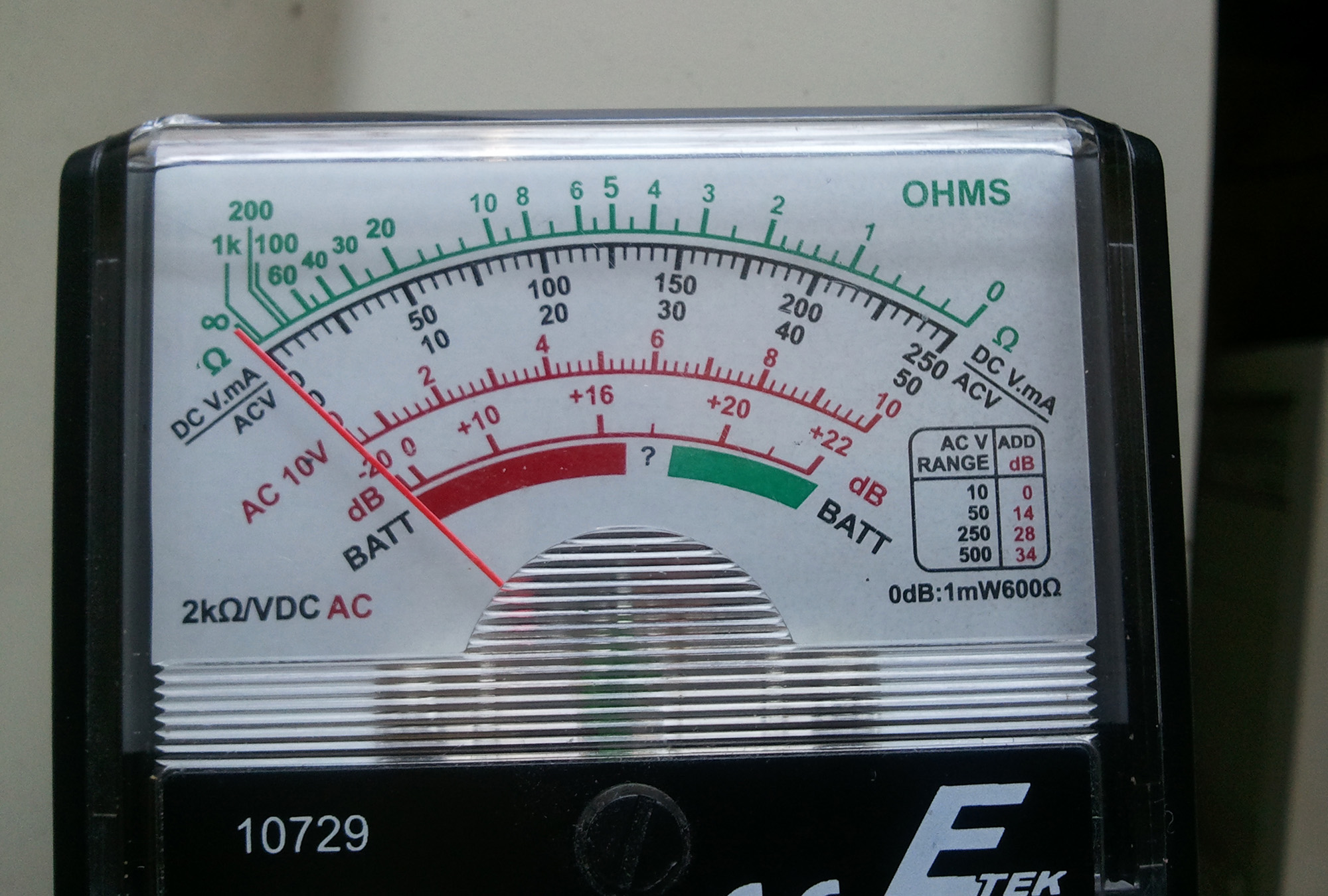

                  Resistance rading on what? I have a regular tester it has x10 ohm and x1k ohm when I tested the fuse with it the needle flies all the way to the right.

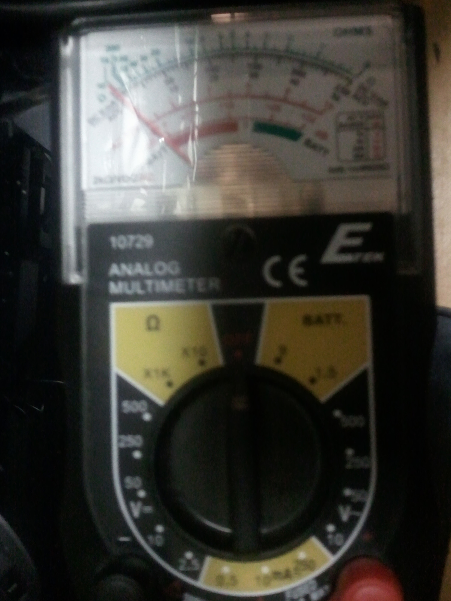

                    post a picture of your meter. I am assuming its an analog meter since you used the term "needle".

                      Sure thing!

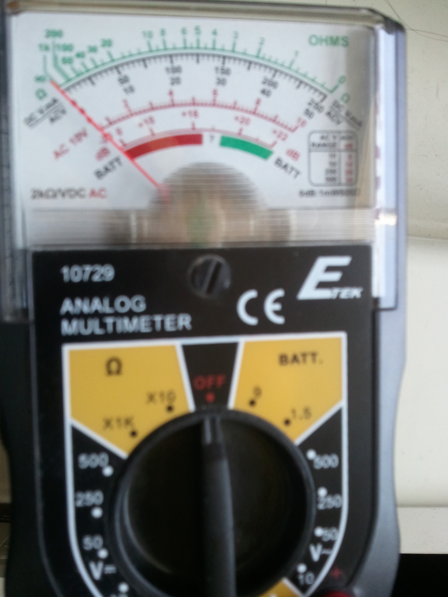

                        The multimeter photo is so bad and out of focus, I can't see the scale. No retiredcaps bonus point.

                          Is this better?

                            If your needle swings towards 0 ohms, then it is a good fuse.

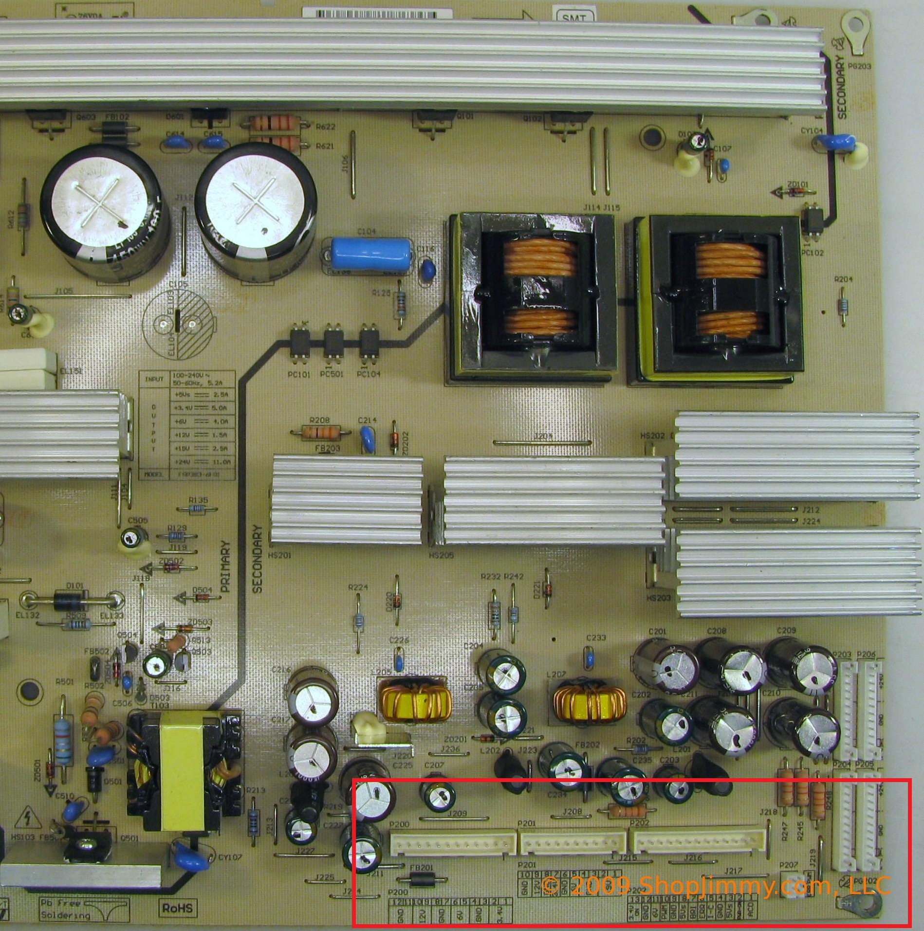

                            The next step is to measure DC voltage on all your cable connectors on the power board.
                            If there is a legend on the connector, list it like so
                            CN100 -> connector
                            pin 1 says 5V SB - I get 4.99 V
                            pin 2 says 12V - I get 12.0V
                            PS. The 5V SB is 5V standby. It is required so the main board works properly.

                              Thanks, any chance you can show me on the picture I posted what you mean by all cable connectors?

                                Did I lose you guys? I am just curious why you wanted the pictures of the boards but never commented on them?
                                I spent 2 hours examining the board yesterday and I do not see any problems with any capacitors. I do not believe the problem is with the power board.

                                  the reason we ask for pics,is beacause someone might see something wrong that the person trying to fix the tv cant,although i struggle trying to get really decent pics up myself

                                      Here is a picture of your power supply i saved from shop jimmy. I put a red square around the connector legend. What we need you to do is plug the tv in and see if what voltages you have (if any). Post you results like retired caps explained in post #14

                                        There is a legend. I am using the same multimeter in my other picture. I am touching the black rod to the GND and the red rod to the other pins but getting no readings. With the TV plugged in.
