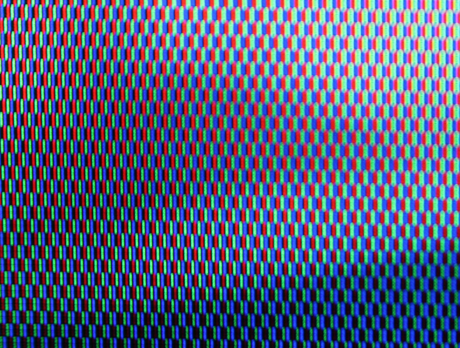

        It's a CMO panel. I've completely disassembled and reassembled the TV down to the panel, so I've tried removing and reseating all connectors multiple times now. The PCB connected directly to the LCD was bowed a bit, so I relieved the strain on that board during reassembly but it didn't seem to make a difference.
        I managed to get a photo of some of the pixels in focus. It actually looks like every row is interleaved, and possibly multiple rows are repeated unless the pixels are rectangular.

          I've seen these panels - never liked the look of them, motion is awful and you can see the dot-crawl on fast movement. My guess would be T-con as it is more global. Panel issues are less rare when they cover the whole panel.
            Re: Samsung LN37A450C1D screen "dimming" issue
            Thanks tom66. Yes motion is horrible and if I move my head in any way while watching it I can also see the pixel blur even worse. I'll try picking up a new T-con and report on if that fixes it. Thanks!
