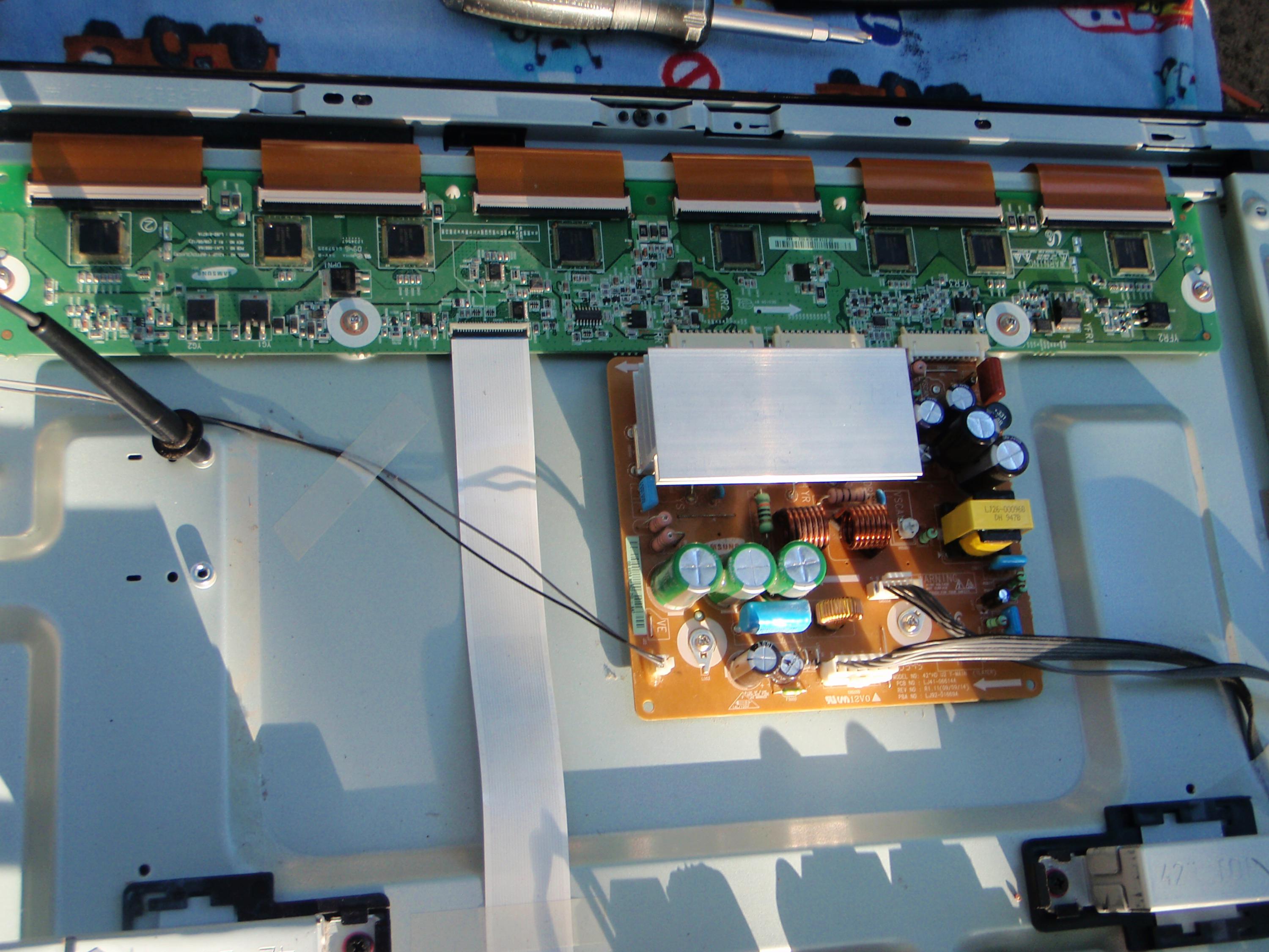

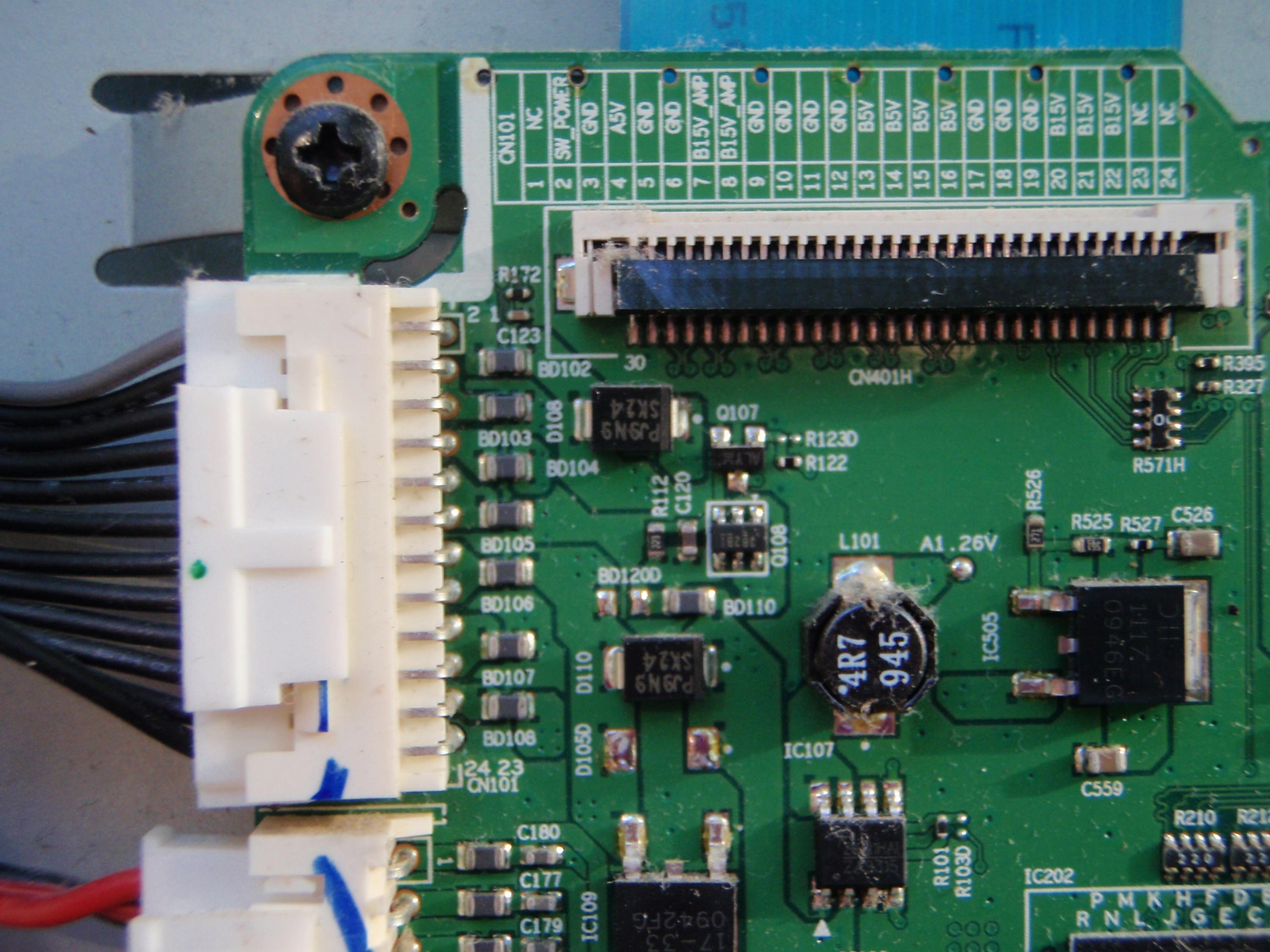

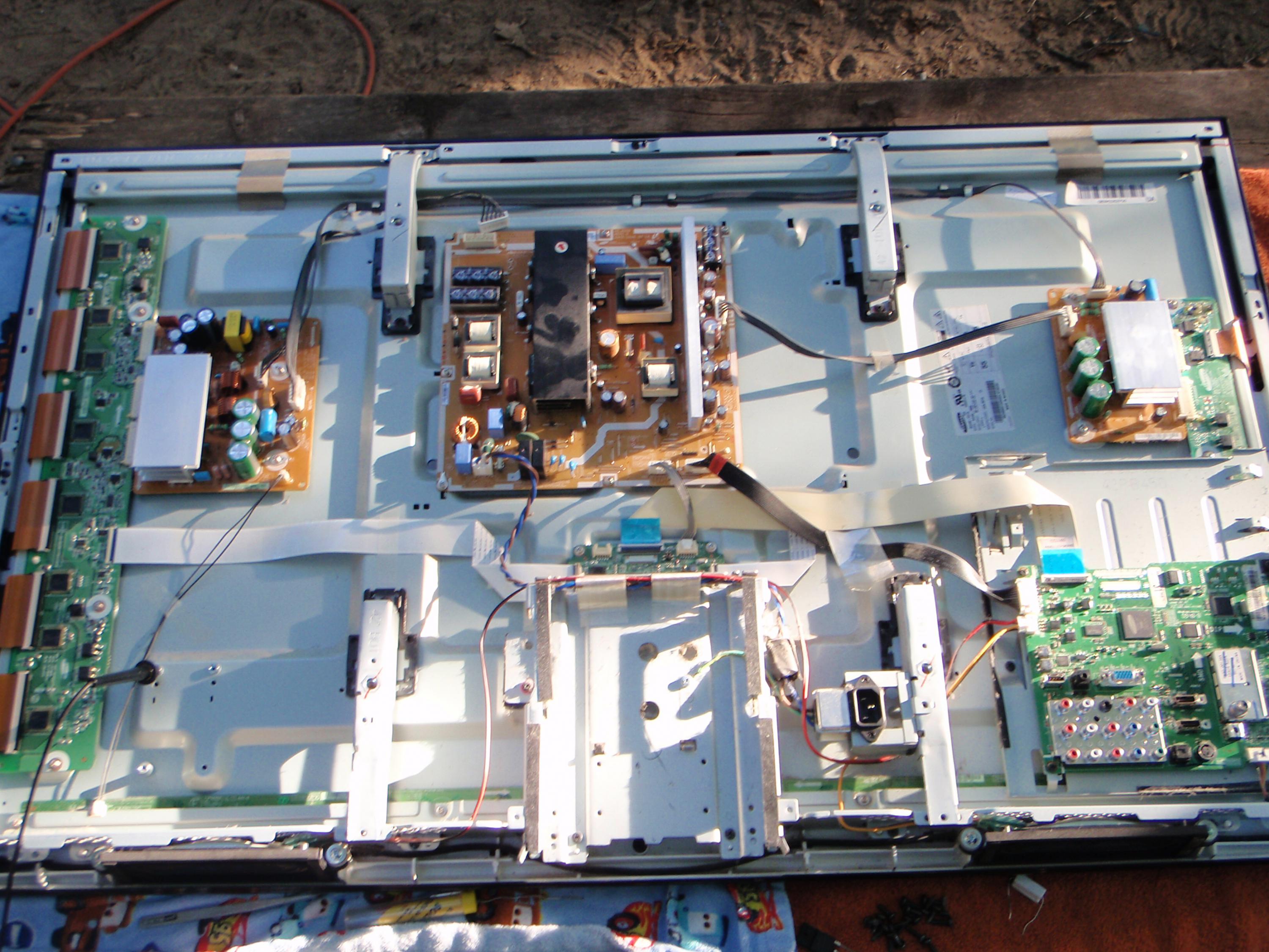

            hi i been working on this very same set similar symptoms but no squeal, this thing has me stumped , here is what i did i disconnected y main and power board will have all proper voltages soon as i connect ymain set will power on then power off, once in a while i could get a static picture on the set, but it made a loud humm noise and never got a picture again.
            so i replaced the ymain despite it never showed a short and the buffer shows no short....and as you guessed it same results and no static, so i short ps-on to ground to try to get a test pattern ,nothing but it does try because it makes that famous samsung chime every time even on normal power ups...
            and again disconnect ymain power board will stay on and all voltages are good...
            panel number is s42ax-yb08 i think i may have a dud panel not sure thou
            y-main was purchased from shopjimmy and never ever had them send me bad parts before so i highly doubt that is the problem... now if i jump 3.3 with a 180ohm resistor volts to vs-on i can get the y main to stay powered up but still nothing on screen not even a hint of life....

              Re: Sanyo plasma- samsung s42ax-yb08 panel-psu squeal no picture
              could buffer be bad and not show shorts? don't think main board is bad due to chimes and power button response ....
              i am ready for any suggestions ....
              going to upload pics shortly...

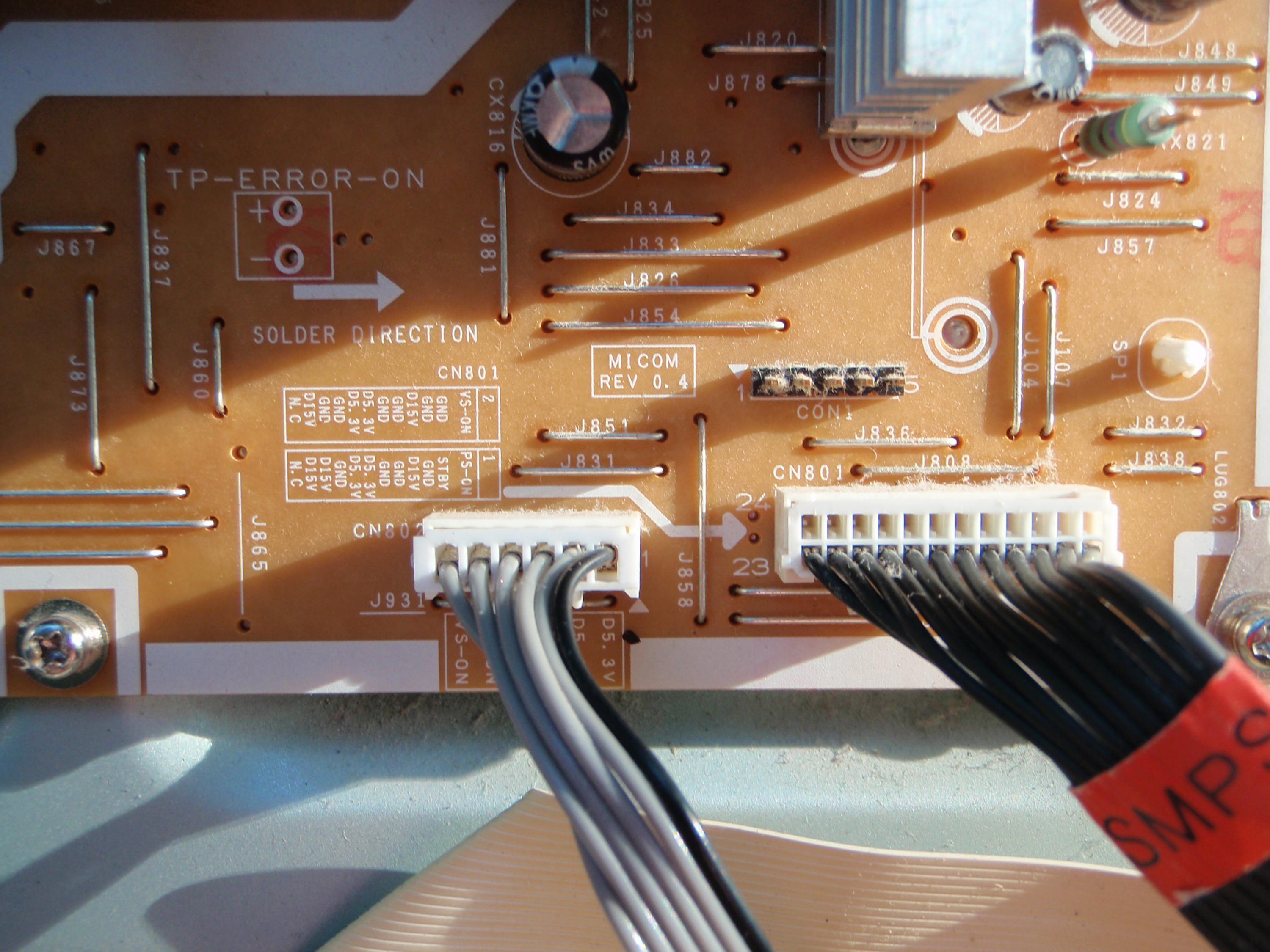

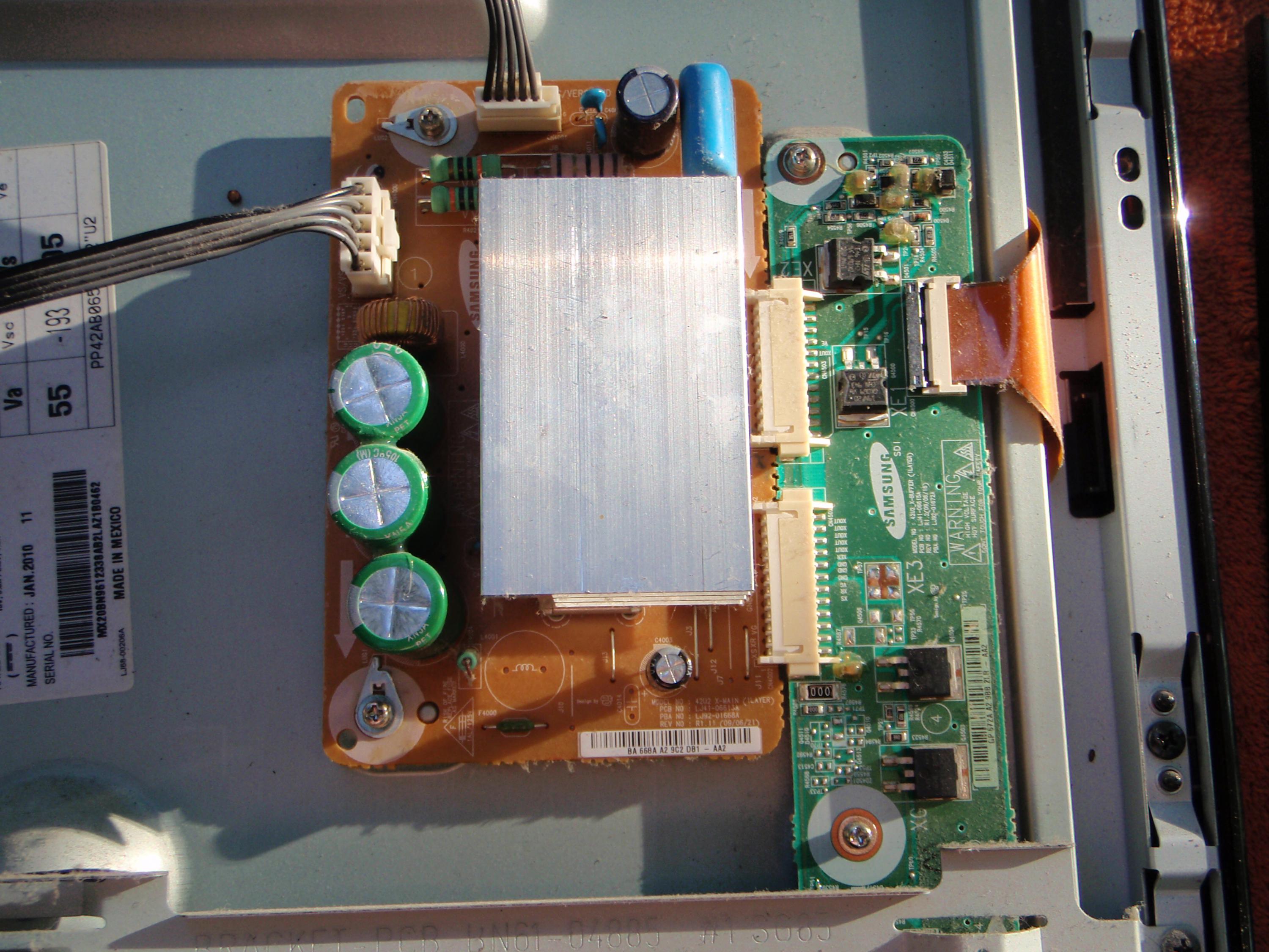

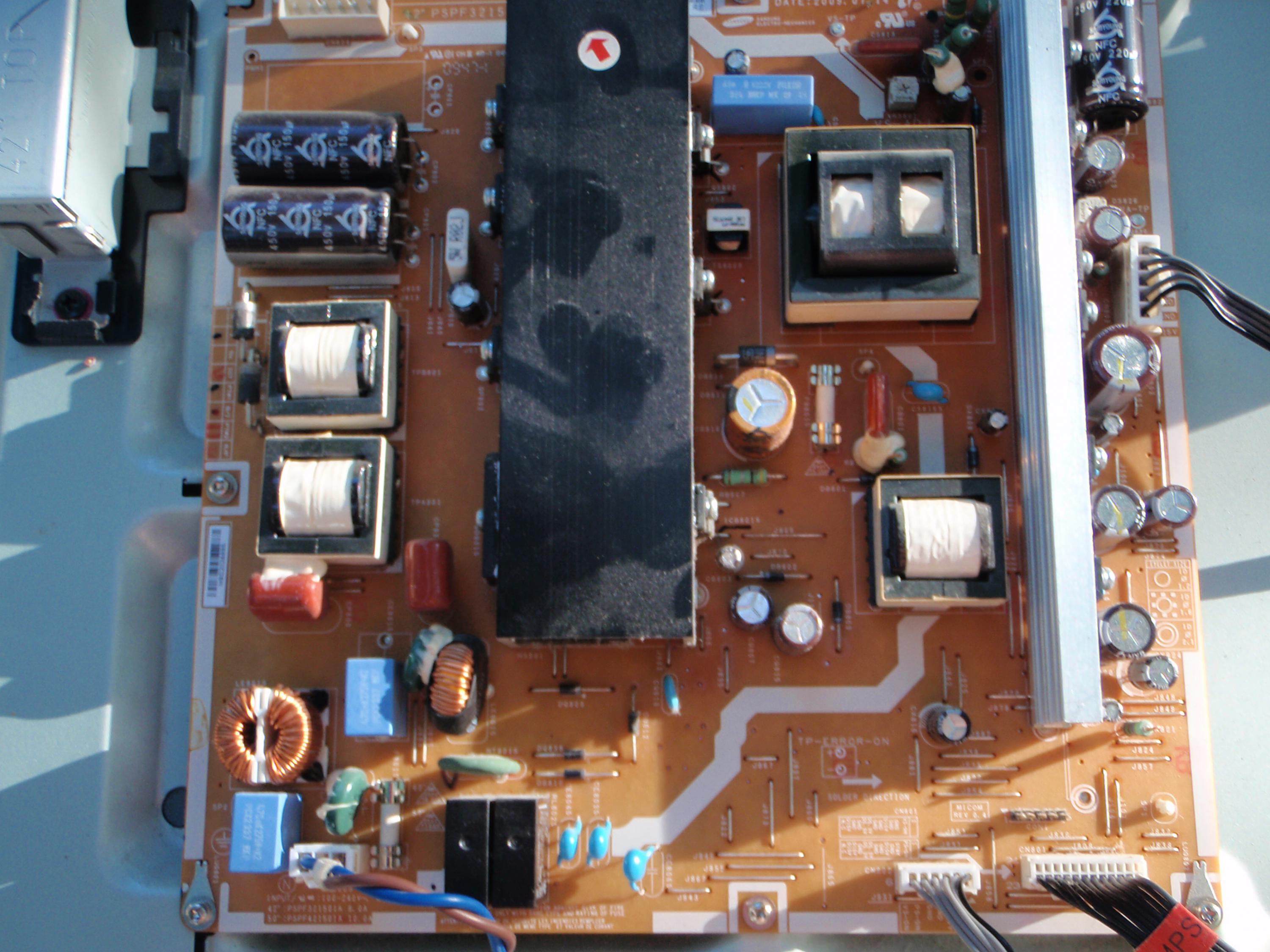

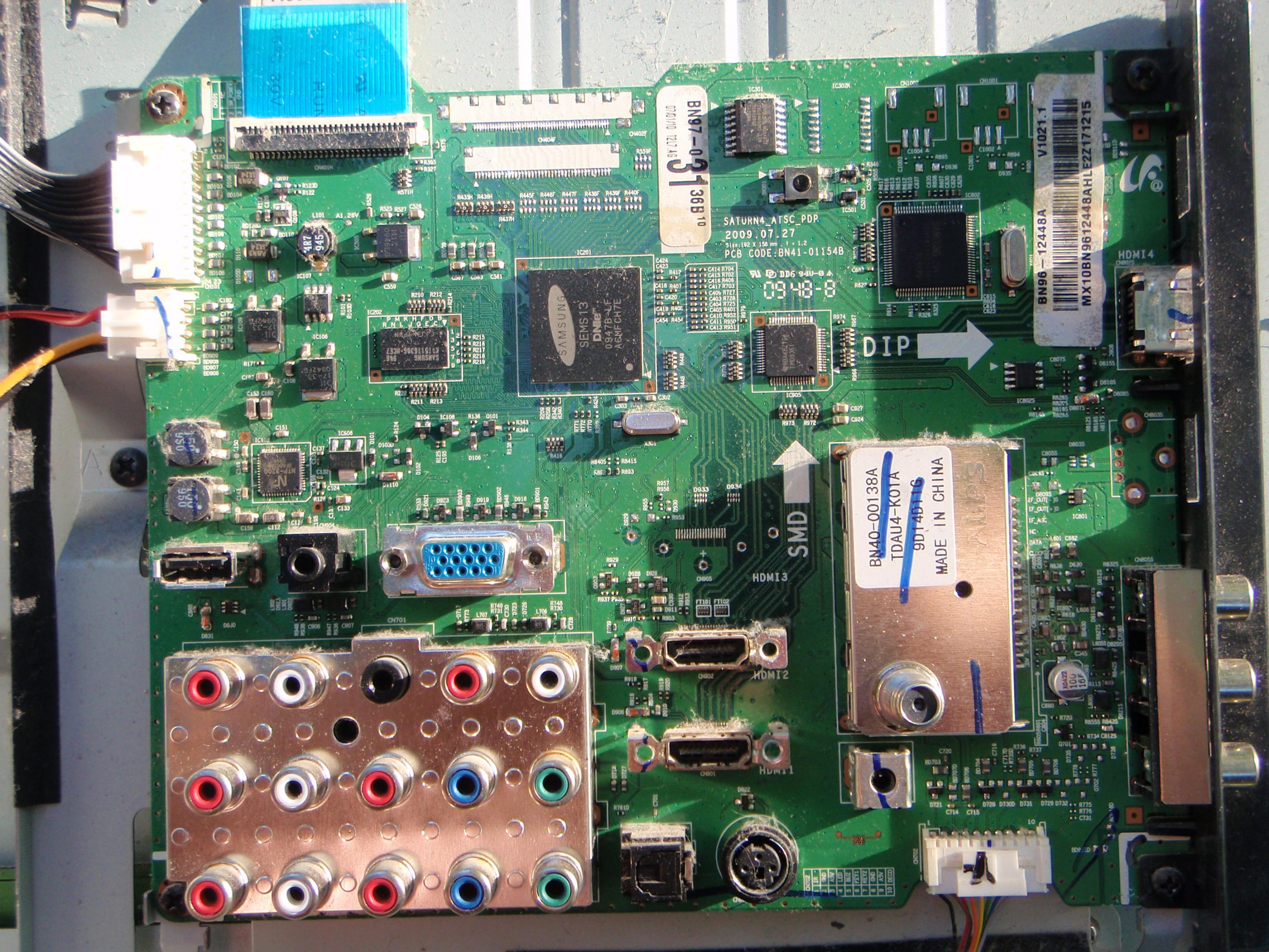

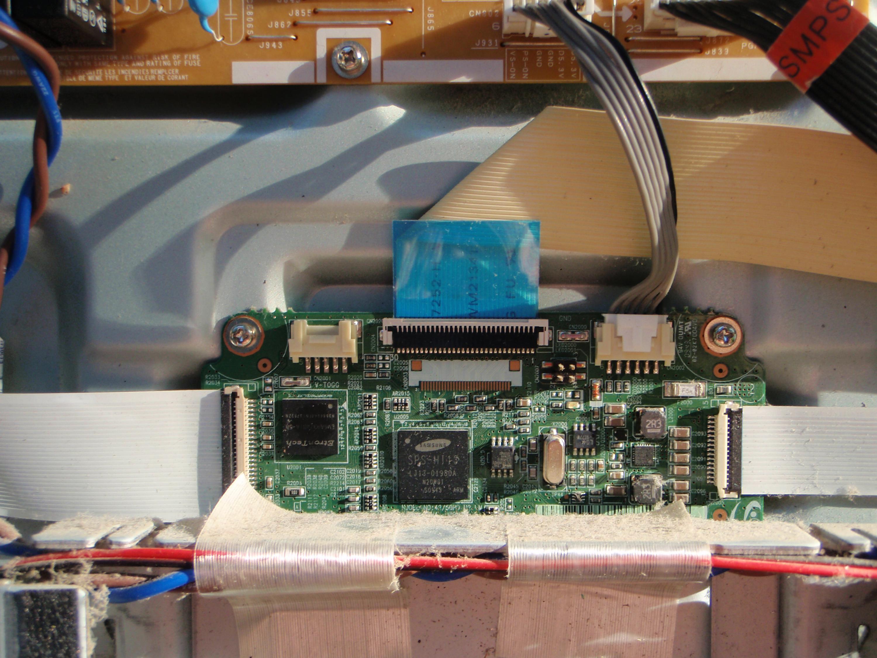

                here is layouts etc....
                      Check -Vsc, Ve?
