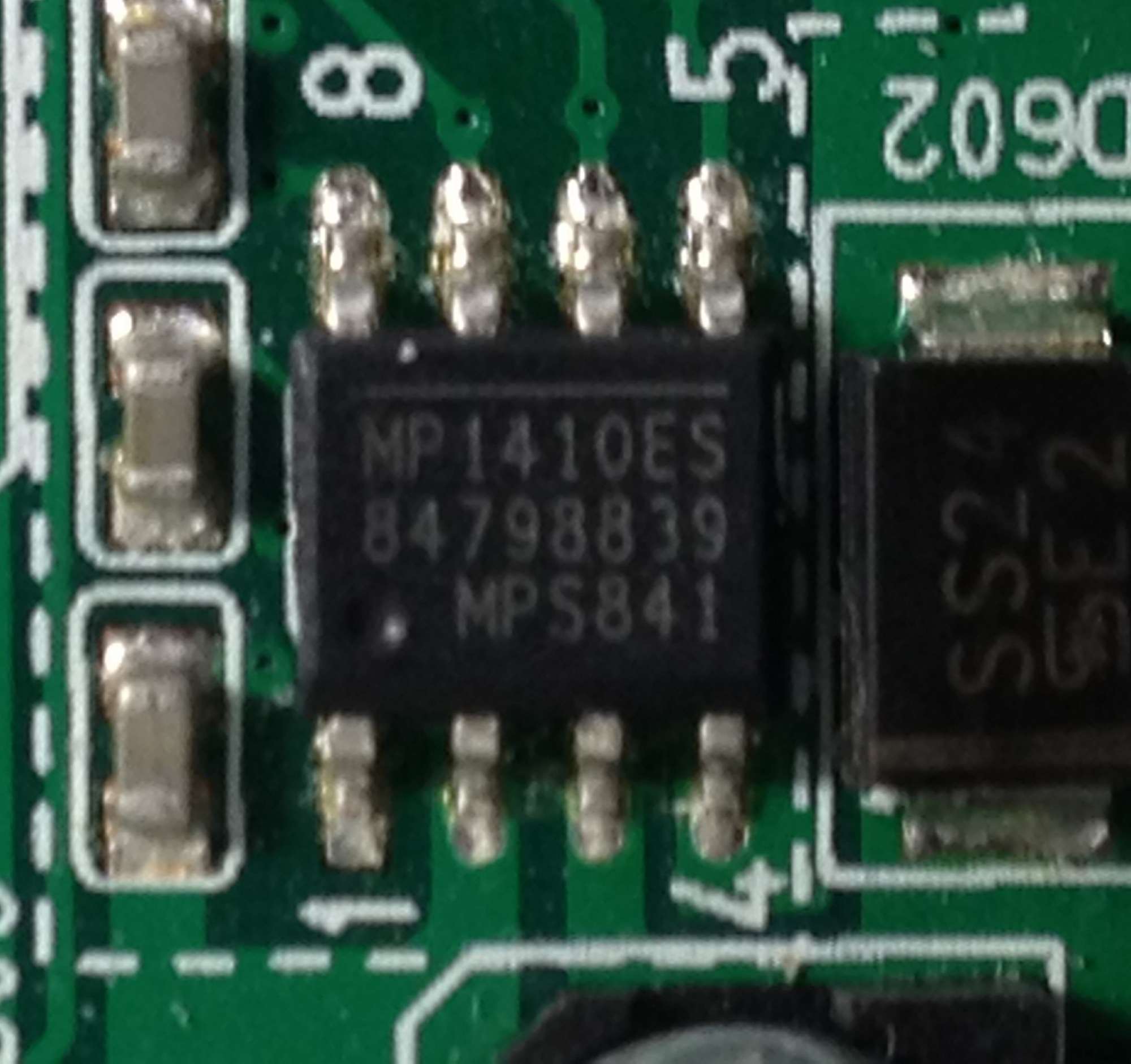

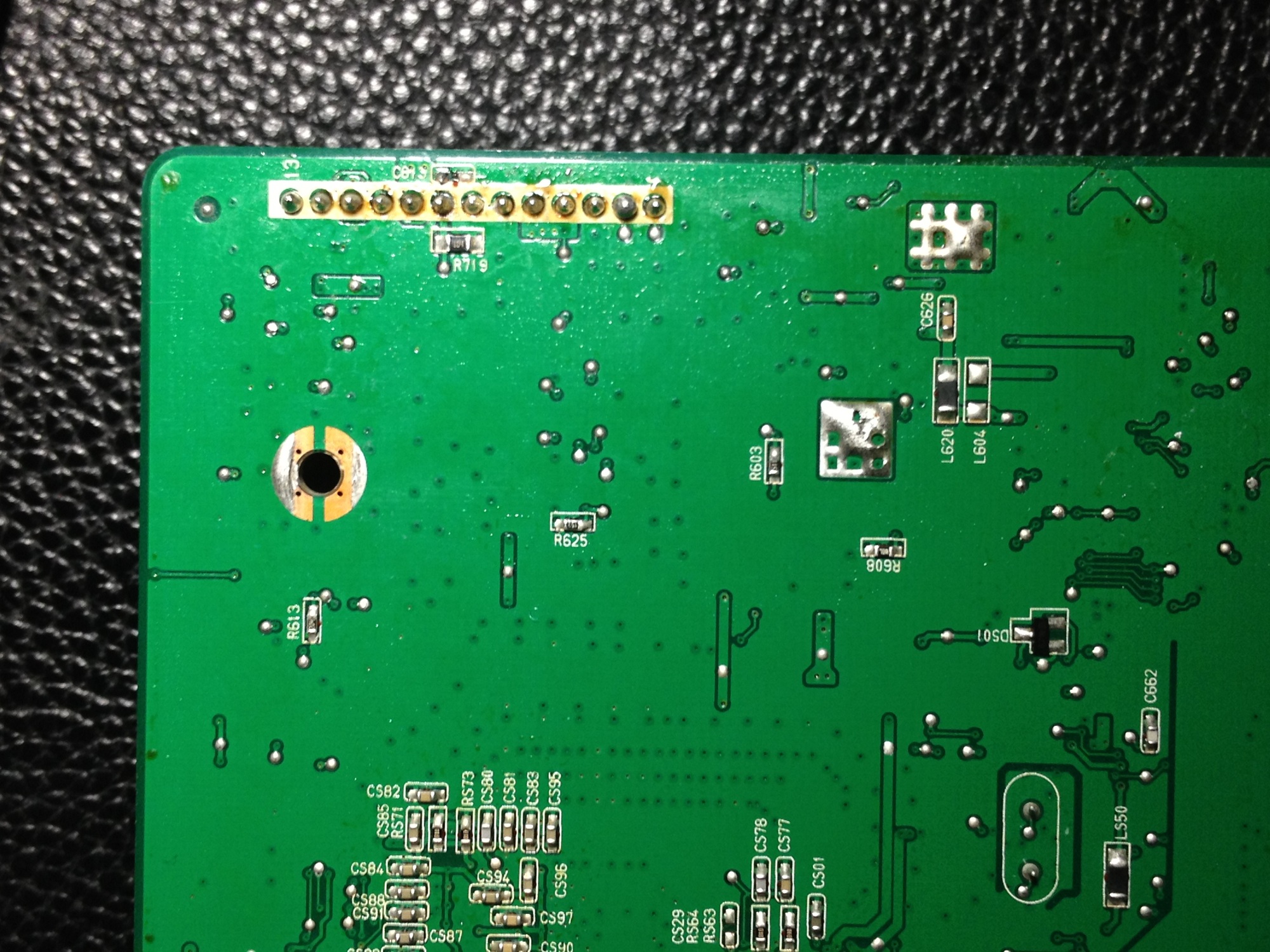

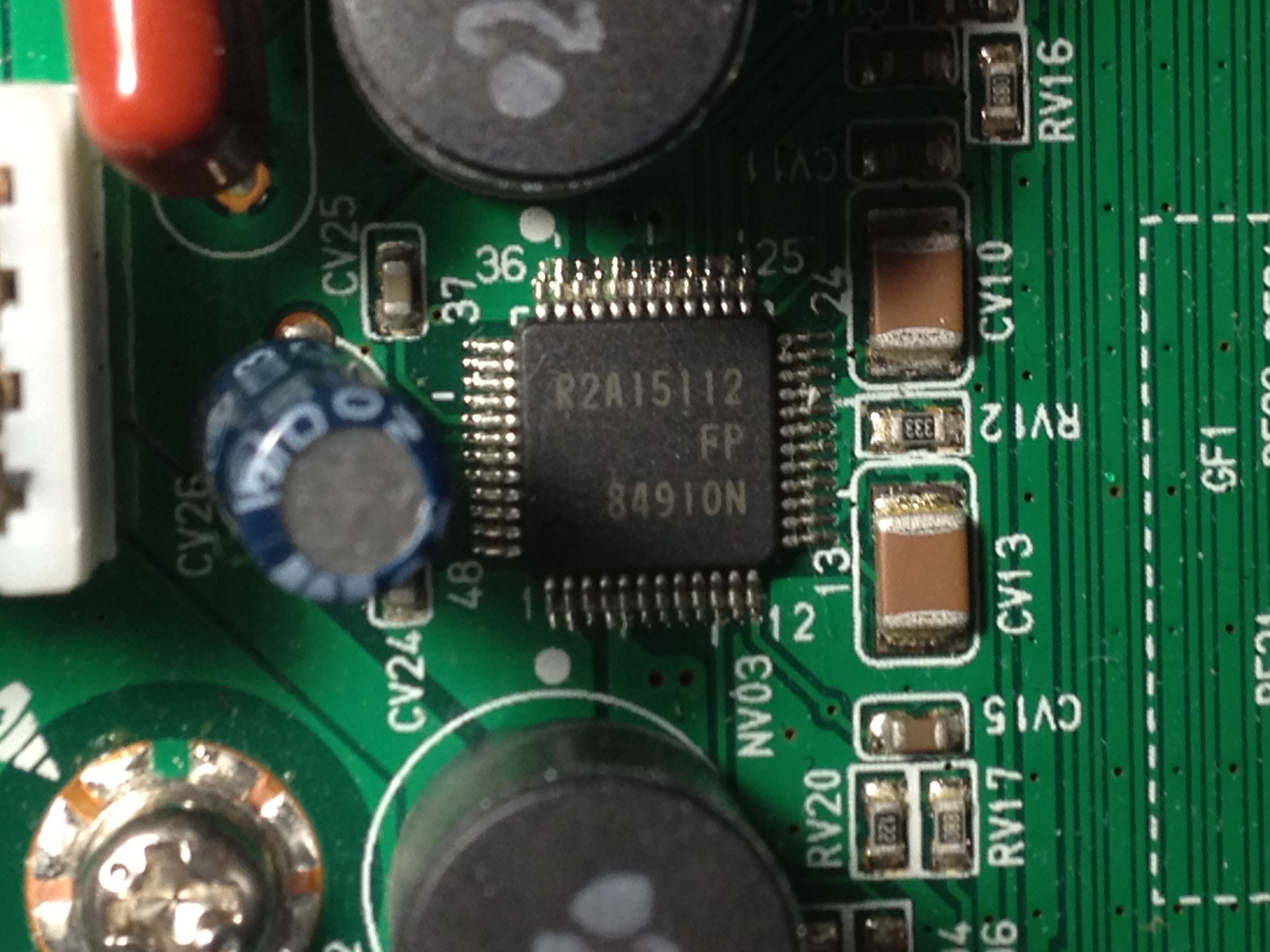

32" Dynex DXL3210A Won't Power On
  • ben7
    replied
    Re: 32" Dynex DXL3210A Won't Power On
    Originally posted by tieny
    For that cap, I get 1.31V
    Ok, thats just about right.
    R624 (10k-ohm) and R629 (81-ohm) make up the feedback voltage divider.
    Tieny, have you tried to shine a bright flashlight into the screen, to see if the pixels are lighting up? Im just wondering, maybe its not telling the backlight to turn on?
    Leave a comment:
  • tieny
    replied
    Re: 32" Dynex DXL3210A Won't Power On
    For that cap, I get 1.31V
    Leave a comment:
  • ben7
    replied
    Re: 32" Dynex DXL3210A Won't Power On
    Originally posted by tieny
    C648 is that the smd cap labeled, 470 10V VS? Measuring across the cap means red probe on positive and black probe on negative correct?
    Yes and yes.
    Leave a comment:
  • tieny
    replied
    Re: 32" Dynex DXL3210A Won't Power On
    Ill take a look at components V601 and V605 once i get home. I would try that time consuming method if i did have anothet board to work with.
    C648 is that the smd cap labeled, 470 10V VS? Measuring across the cap means red probe on positive and black probe on negative correct?
    Leave a comment:
  • ben7
    replied
    Re: 32" Dynex DXL3210A Won't Power On
    Tieny:
    Measure the voltage across capacitor 648 (470uf 16v) near the power connector.
    Leave a comment:
  • selldoor
    replied
    Re: 32" Dynex DXL3210A Won't Power On
    Tieny- Couple of things - on the back of the board just above the connector it says C813 but whaterever is next to it looks a bit odd - what is it?
    The other thing is are ther any part numbers on the very small ics V601 V605.
    And another time consuming idea, if you have another board the same you could just work through them both checking every component for shorts or differences in resistance.(Well I did say it was time consuming)
    Leave a comment:
  • selldoor
    replied
    Re: 32" Dynex DXL3210A Won't Power On
    Originally posted by electronicsurplus
    I am wondering whether this model is the same
    Mine is Dynex DX-L321-10A
    The main Board looks much different
    Yey, I have the same problem. Set appears to power on, led on front turns blue, I have 24V to inverter but, no BLon voltage at all
    Hi Jon
    You asked why no-one answered you? I think I have told you before that
    we are all just volunteers so we have lives to lead outside badcaps and join in when we feel like it, if we know something that might help or if we think someone is about to do something dangerous. .
    If you have read this post thoroughly you will know that having tried all the
    usual stuff and some pretty unusual stuff we are really struggling to fix thisIt is not any easier because it is not a mainstream make.
    You then come in and say you have the same problem???? so what would you expect us to say - "Sorry Jon we have no idea what might be wrong with your set."
    As it happens you now say that you probably dont have the same set so anything we might have said would not apply- you could have compared the boards before you posted or you could have simply waited and watched the thread until a fix was found?
    I suggest you start your own thread ( I recall suggesting that to you once before?)
    Posting pictures of your boards - you will be able to do most of the tests
    as per this post and state your results and part numbers then someone might take a bit of interest.
    Leave a comment:
  • electronicsurplus
    replied
    Re: 32" Dynex DXL3210A Won't Power On
    I am wondering whether this model is the same
    Mine is Dynex DX-L321-10A
    The main Board looks much different
    Yey, I have the same problem. Set appears to power on, led on front turns blue, I have 24V to inverter but, no BLon voltage at all
    Leave a comment:
  • ben7
    replied
    Re: 32" Dynex DXL3210A Won't Power On
    Originally posted by electronicsurplus
    I wonder why I never receive any response whenever I post a question here? Am I disliked here or something?
    I won't bother asking anymore if so
    Thanks a bunch
    Jon
    Electronic Surplus
    What?! no, sometimes people don't answer you right away...
    Leave a comment:
  • electronicsurplus
    replied
    Re: 32" Dynex DXL3210A Won't Power On
    I wonder why I never receive any response whenever I post a question here? Am I disliked here or something?
    I won't bother asking anymore if so
    Thanks a bunch
    Jon
    Electronic Surplus
    Leave a comment:
  • electronicsurplus
    replied
    Re: 32" Dynex DXL3210A Won't Power On
    I have the same problem, except, when the power button is pressed the light turns blue and, i have 24V to the Inverter, when I short 5v to BLon the screen lights but no video
    Any ideas?
    Please
    Jon
    Electronic surplus
    Leave a comment:
  • tieny
    replied
    Re: 32" Dynex DXL3210A Won't Power On
    Heres the back of the area you asked for.
    Leave a comment:
  • ben7
    replied
    Re: 32" Dynex DXL3210A Won't Power On
    Originally posted by selldoor
    What about this one then?
    http://www.alldatasheet.com/datashee...05DMI-12G.html
    Think thats what Tom66 said it was some posts back
    Ahhh, foiled again!
    Leave a comment:
  • selldoor
    replied
    Re: 32" Dynex DXL3210A Won't Power On
    What about this one then?
    http://www.alldatasheet.com/datashee...05DMI-12G.html
    Think thats what Tom66 said it was some posts back
    Leave a comment:
  • ben7
    replied
    Re: 32" Dynex DXL3210A Won't Power On
    Originally posted by tieny
    Heres the other two chips,
    Can you please take a picture of the back of this area?
    Leave a comment:
  • ben7
    replied
    Re: 32" Dynex DXL3210A Won't Power On
    Originally posted by tieny
    Heres the other two chips,
    The first one is a MP1410es.
    The second one is a Renesas R2A15112 audio amplifier chip.
    I was wrong about the maxim chip, im not sure what model that one is.
    Leave a comment:
  • tieny
    replied
    Re: 32" Dynex DXL3210A Won't Power On
    Heres the other two chips,
    Leave a comment:
  • ben7
    replied
    Re: 32" Dynex DXL3210A Won't Power On
    Originally posted by tieny
    I can barely make it out, it reads: (the one i suggested to chalk)
    12G
    25L3205DM2I
    2Y305600
    TAIWAN
    a083536
    Its a MAX120 ADC chip, the 120 is right next to the big MAX text.
    EDIT: Bah, it is the wrong chip, nevermind..
    Last edited by ben7; 07-24-2012, 02:04 PM.
    Leave a comment:
  • tieny
    replied
    Re: 32" Dynex DXL3210A Won't Power On
    I can barely make it out, it reads: (the one i suggested to chalk)
    12G
    25L3205DM2I
    2Y305600
    TAIWAN
    a083536
    Leave a comment:
  • ben7
    replied
    Re: 32" Dynex DXL3210A Won't Power On
    Tieny, you said you found 6 voltage regulators on the board back in post 38.
    I see two more chips that I think could be voltage regulators.
    They are both near inductors and capacitors, so I'm guessing they are buck-regulators.
    What are their chip numbers?
    Leave a comment:
  • GLISIT
    by GLISIT
    01-16-2025, 02:29 PM
    by sam_sam_sam
    03-31-2024, 02:12 PM
  • SkishyIshy
    Sony Bravia XBR-65x900f: No Power, No Standby-light - however 3.3v STBY is present
    by SkishyIshy
    Hey All,
    I have a Sony 65x900f that I purchased cheap because of a no-power issue.
    I assumed that because there is no standby light visible, it would be an easy fix - however upon opening up of the unit I can confirm that the 3v3 standby voltage is making it's way from the power supply to the main board. I'm a little confused as to why there is no standby light.
    I am firstly wondering if anyone has this model of TV, or has worked on one and can give me some insight. I have tried to find a service manual for this model, to no avail - and would really appreciate...
    03-17-2021, 11:44 AM
  • AleMonti
    LG 55EG910V - no power and no standby light
    by AleMonti
    Hi everyone,
    I'm trying to troubleshoot and repair this old LG OLED curved TV, model 55EG910V.
    I did some basic troubleshooting and reviewed most related posts here, but I wasn't able to isolate the issue.
    The TV shut itself off during playback and never came back to life - the standby light remains off. My dad claims that it has happened a few times in the past but the issue resolved itself after some time. Not this one.
    After checking the basics I did the following:
    • I measured all voltages and as expected the only active supply is the 3.5V standby. It
    11-04-2024, 05:02 PM
  • redbaron1007
    Yamaha HTR-3065 No power/No Standby
    by redbaron1007
    I got a Yamaha HTR-3065 on the bench currently that's got a no power/ no standby issue.When I plug it in it draws 0.01A from the wall, the relay for the ac transformer never clicks, there are no standby lights on the front, and pressing the power button does nothing. The fuse was not blown but upon measuring the voltages on the power low voltage power supply board (labeled operation 3 pg 89 in the schematic) they do not match what the schematic says they should be.
    S9 13.7V
    Pwr Ry 0V
    AC Det 9.1V
    Mgnd 0V GND
    The two pins on the transformer for the operation...
    09-12-2024, 03:04 PM
