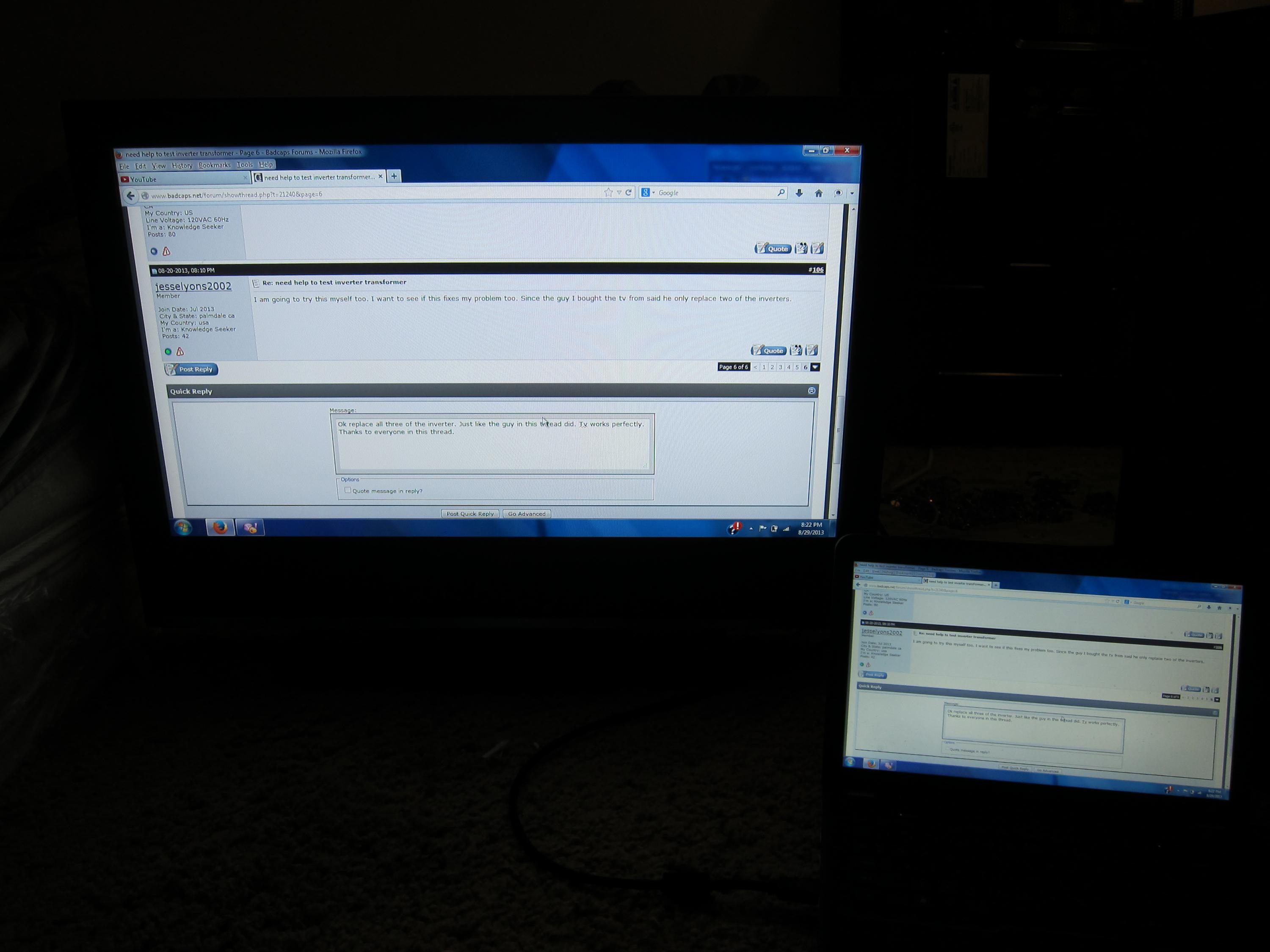

              I am going to try this myself too. I want to see if this fixes my problem too. Since the guy I bought the tv from said he only replace two of the inverters.
                Re: need help to test inverter transformer

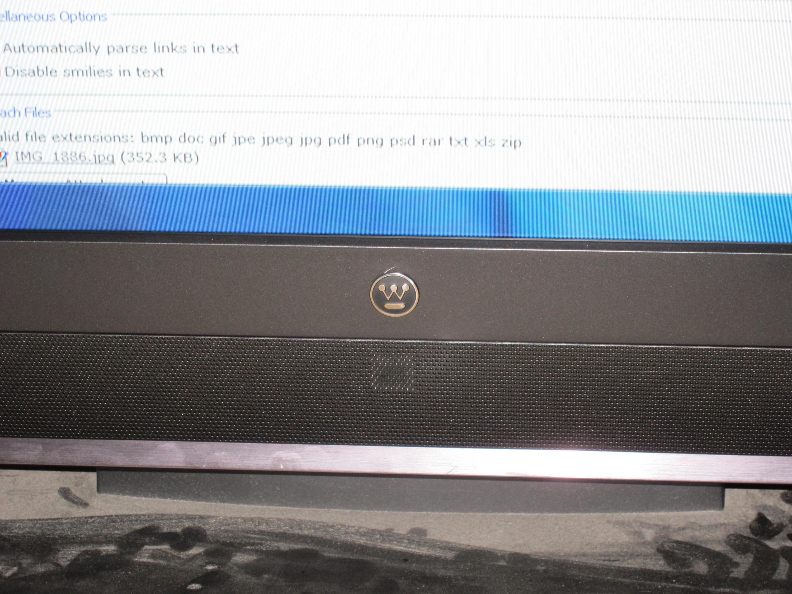

                Ok replace all three of the inverter on the power inverter board. Just like the guy in this thread did. Tv works perfectly. Thanks to everyone in this thread.
                This is the WESTINGHOUSE SK-32H540S
                fyi. This is cheaper then buying the power supply board and was easier to get. Just incase anyone else wants to do this.
