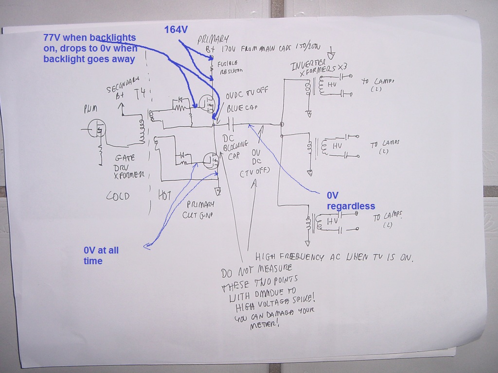

                    #89
                    Re: need help to test inverter transformer
                    I tested the 2 mosfets (photo attached) again using 200 ohm method and the readings between pin 1&3 on both mosfet read only 22 ohm, but they were fine when being test off circuit. I soldered them back and measure voltage around that area. All measurement was done using the filter cap (-) pin as ground point. I did used the chassis ground but the reading were very much different, in the mV range. There are not much around the mosfets, I tested them all and they seem to do fine, unless they break when applied loads.
                    What do you think of those voltage readings? what causing both mosfet to display 22 ohm between 1-3 on circuit test?
                    • selldoor
                      Slow Learner
                      • Dec 2010
                      • 7870
                      #90
                      Will need Budm to comment on that - can you give us a rundown again on what happens when it is all connected and with a working source, from plug in via power on to stable fault position. What do any leds do what does the screen do - any sound any noises - clicks etc.
                      Disconnect the cable from the main board to the Tcon and try again.

                        #91
                        OK this is what the set behavior. As soon as power cord plugs in (without a need to press the ON button) the set comes on for about 5 seconds, shows a perfect screen then the screen goes dark. Sound is still on. The blue led that came on when plugged in power still blue. I'm able to see the screen content with a flashlight. If I press the power button to turn it off then on again I would see that same behavior repeat again.
                        I disconnected the t-com board from the main board, the screen come on a few second flashes away then come back a few second then gone. So, it's pretty much the same with the t-com connected, with just a blank screen.
                        I tested 1 bulb at a time with the others disconnected. I can see it flashed on went away and flashed back on within 5 seconds then stay off after that. All bulbs show the same pattern.

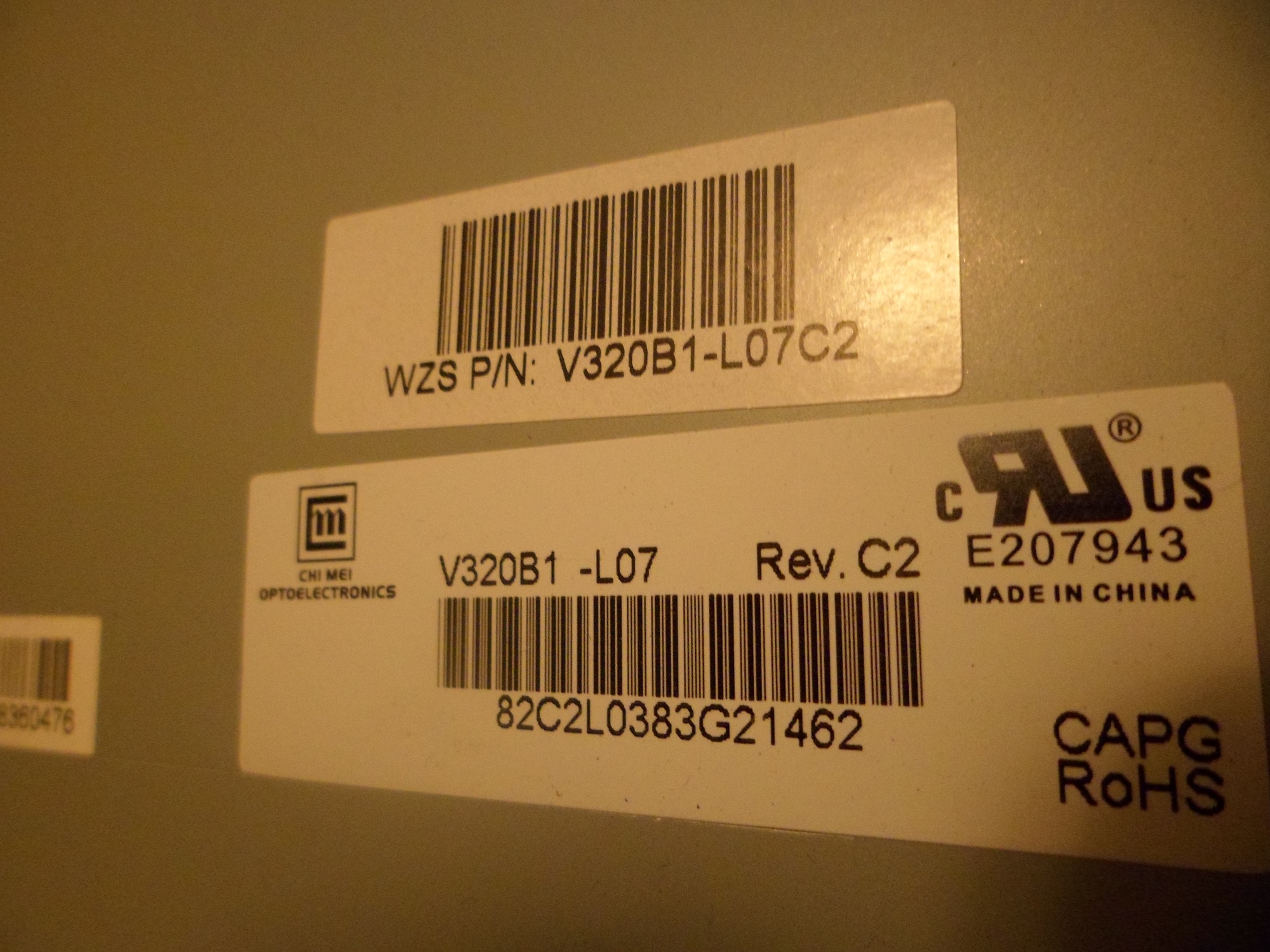

                              #94
                              OK, it sounds like the inverter was trying to startup (you get about 70V, but more likely to be higher AC signal that your meter cannot handle).
                              I do want to use the test lamp at this point, I never try with TV inverter yet, I am not sure if your TV uses U-SHAPE or Straight setup, if they are a straight lamps, then there should be small lamp return wires back to the inverter board or may be tied to the chassis some where, you will have to look real close. See PDF for details.
                              You may be able to use T5 12" LAMP for testing, not sure it will work since I do not try it yet but I will.
                              http://www.amazon.com/10pcs-F8T5-CW-...words=t5+12%22
                              Can I get the model number of the LCD panel so I can search for the spec sheet to see what it uses?
                              • woaimi
                                • Sep 2005
                                • 94
                                • US

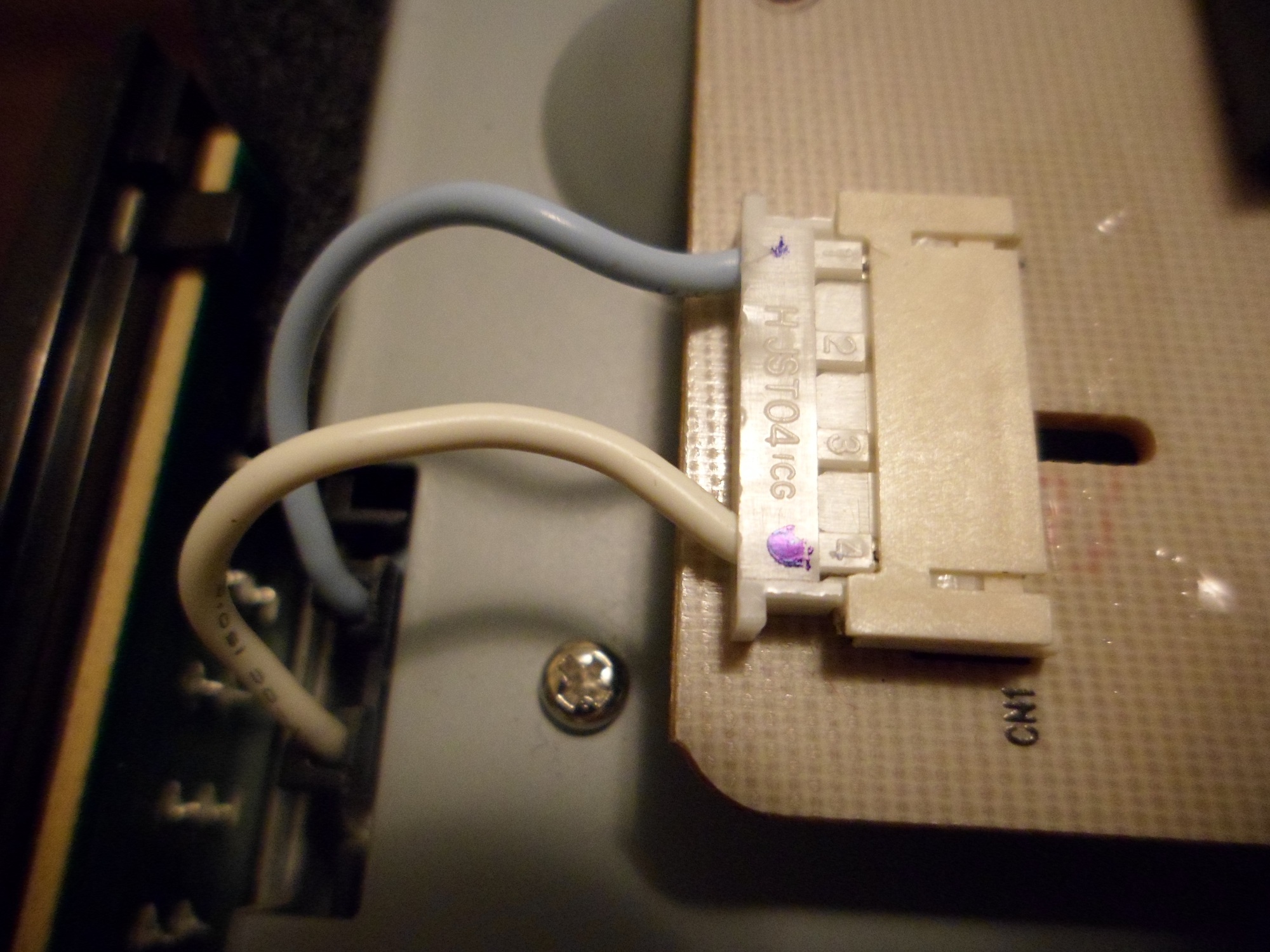

                                #95
                                I snapped a couple photos of the lcd and the bulb connector, hope they'll help. The connectors are the only thing that are visible from the lcd, I'll open the case when I have a chance. The bulbs connectors mark JST04 10A, the color on those wires are baby blue and white.
                                  #96
                                  OK, it does not use U-SHAPE tube but the two tubes are coonected in series to form one tube, so there is no ground return wire. You can try hooking up CFL lamp to the Blue and White wires.
                                  See spec sheet of the LCD panel.
