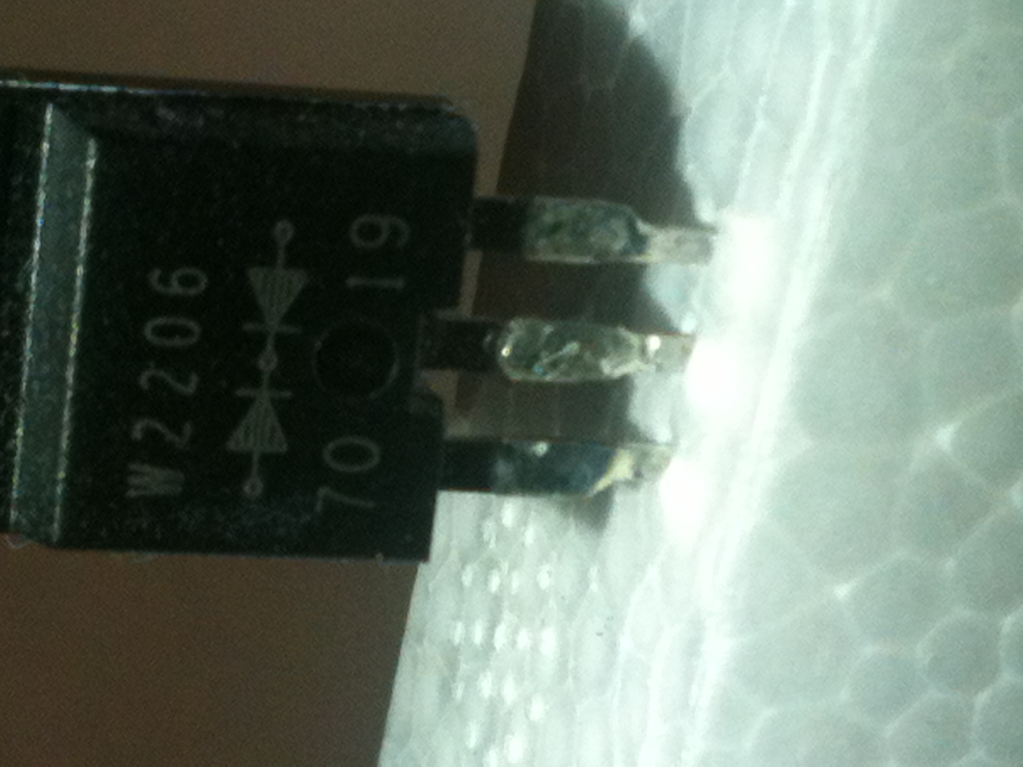

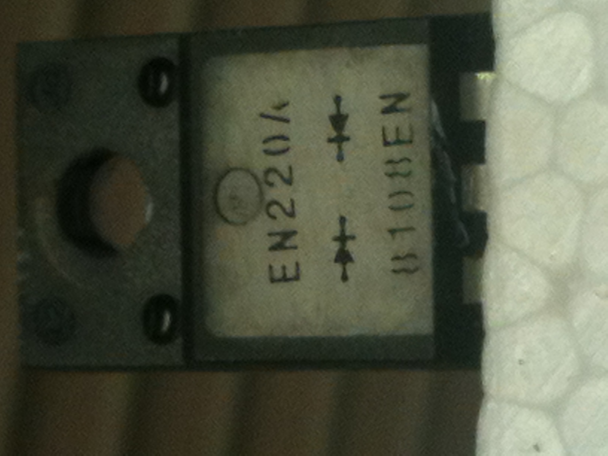

      they are
      1x EN220A
      2x W2206
      they all indicate having common cathode in the middle lead

        I found this testing method from Tomm66 in this forum to test EN220A
        Number pins 1-3 left to right.
        Labelled (pos/red) (neg/black) respectively (use diode test.)
        Test 1-2 should read ~150 - 700.
        Test 2-1 should read single "1" or "OL".
        Test 2-3 should read single "1" or "OL".
        Test 3-2 should read ~150 - 700.
        Test 1-3 should read single "1" or "OL".
        and the result
        1-2= 159
        2-1="1"
        2-3="1"
        3-2= 159
        1-3= "0.00"
        meanwhile from a user name multimeter's suggestion on that same thread
        <<< set your meter if dmm to 200 ohm,or 10k ohm anologue, pin 1 and 2 should show reading one way ,pins 2 and 3 should show reading one way >>>>
        it shows reading only one way 1-2 & 2-3 as I flipped the probes, i got "1"
        couldn't find any info for pair of W2206 diode.

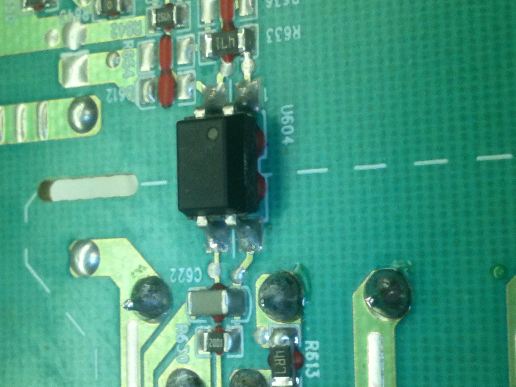

          well I de-soldered all 3 schottky diodes (photo attached) and test them using the diode test and they seems to be working. The primary and secondary filter capacitors were also de-soldered and test using capacitor test mode, them too were fine. I have not test the transformer and the "optoisolator" (guessing) as some reading material point out.
          Can anyone suggest how to test the transformer and the "optoisolator"? Other than that I run out of option, might just give up.
          the 1st photo is EN220A
          the 2nd photo is W2206, the 2 diodes that I couldn't find any info.
          the 3rd photo is from what I'm guessing is the "optoisolator"

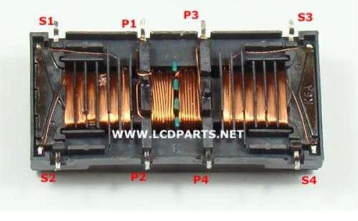

                    Can you re check the secondary winding resistance on the 3 transformers report result as
                    T1 s1>s2 = xxxohms
                    T1 s3>s4 = xxxohms and so on

                        Please measure as per my diagram - ignore the other pins.

                          Re: need help to test inverter transformer
                          I measured the transformers according to your diagram and got "OL" on all pairs
                          s1-s2=OL
                          s3-s4=OL
                          p1-p2=OL
                          p3-p4=OL
                          I have not get a chance to test with light bulb but will follow up and keep you posted

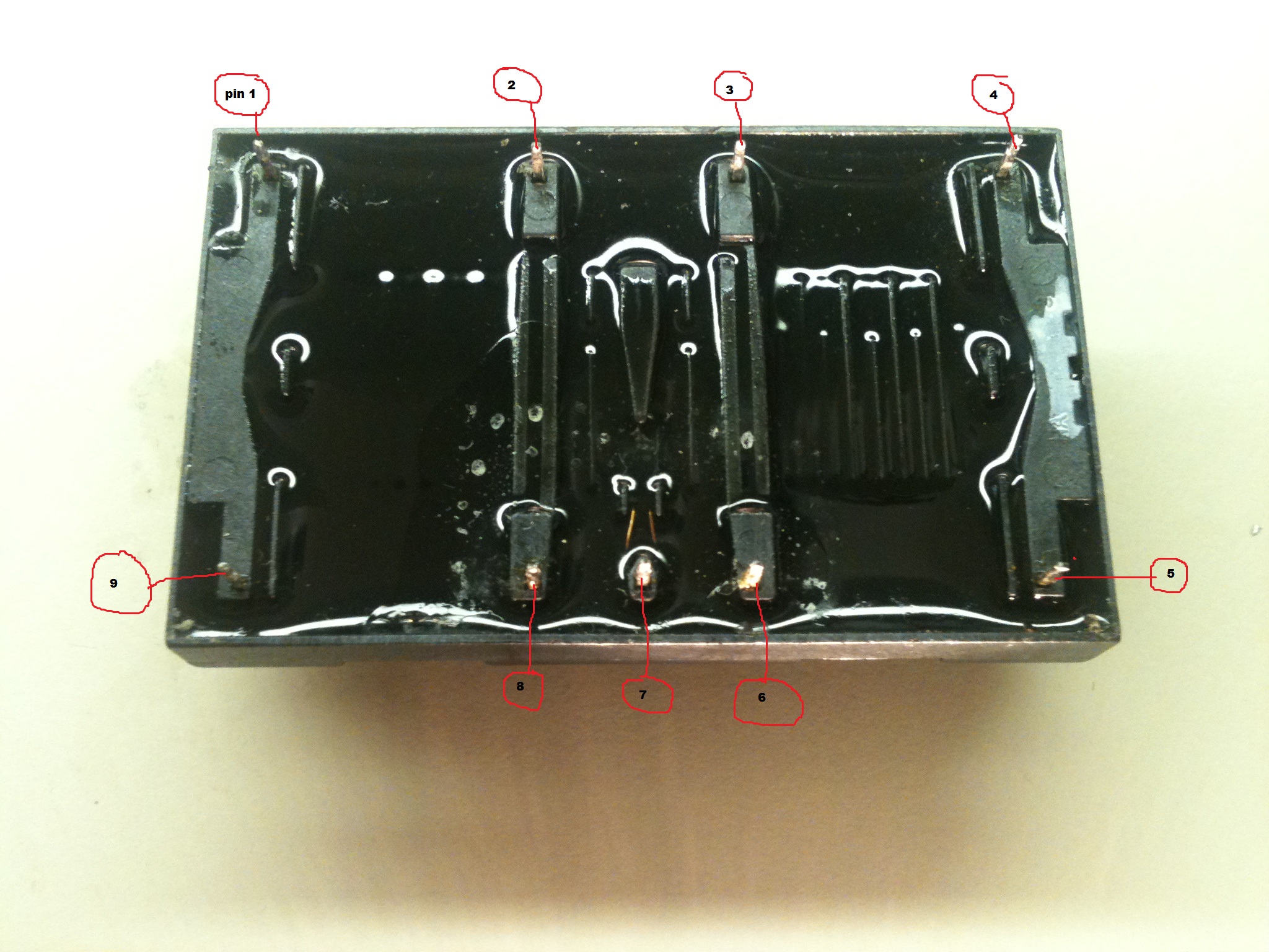

                                      ok this what i got out of 1 transformer. I labeled the pins in the photo.
                                      1>2=1.77k / 1>all other 8 pins = OL
                                      2>all pins = OL
                                      3>4= 1.77k / 3> all pins = OL
                                      4> all pins = OL
                                      5> all pins = OL
                                      6>7= 2.9 ohm; 6>8=5.3 ohm; 6>9= OL
                                      7>8= 2.9 ohm; 7>9= OL
                                      8>9= OL
                                        #59
                                        Well, that is a bit different - can you do 1>2 and 3>4 on the other transformers ( Leave them on the board)
