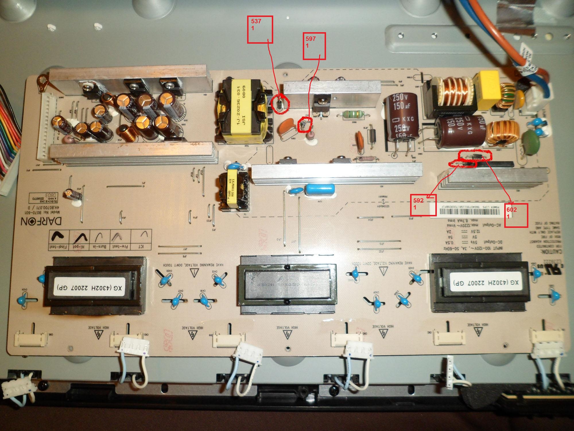

      Referring to the photo that retiredcaps circled the mosfets
      The top one (by itself)
      S-G: with red probe on S = 528 Ohm, with red probe on G = 1032 Ohm
      G-D: with red probe on G = 1695 Ohm, with red probe on D = no reading
      S-D: with red probe on S = 400 Ohm, with red probe on D = no reading
      The pair below
      The left one
      S-G: with red probe on S = 22 Ohm, with red probe on G = 22 Ohm
      G-D: with red probe on G = 427 Ohm, with red probe on D = no reading
      S-D: with red probe on S = 403 Ohm, with red probe on D = no reading
      The right one
      G-D: with red probe on G = 425 Ohm, with red probe on D = no reading
      On the rectifier: meter was set at diode mode
      Between (+) and the 2nd leg with red probe on (+) = no reading, with black probe on (+) = 548
      Between the 2nd and 3rd leg = no reading
      Between the 3rd leg and the (-) with red probe on (-) = 547, with black probe on (-) = no reading
        Re: need help to test inverter transformer
        Originally posted by woaimi View Post
        The pair below
        The left one
        The right one
        1) Multimeter tutorial. I have written about this before several times and just last week.
        2) A multimeter always gives a reading. There is no such thing as "no reading". If your multimeter is displaying "1" on the left hand side of the lcd, it is telling you the measurement is "out of range".
        3) For finding a short, we are only interested if the reading is below 30 ohms. We don't care if the actual reading is 200 ohms, 2000ohms, or 2M ohms. So on the lowest scale (200 ohms), if the multimeter shows a "1" on the left hand side of the screen, it is telling you the reading is > 200 ohms. That is, not shorted.
        4) Most people understand green means go and red means stop. However, if I say green means don't stop and red means don't go, it messes people up. This is why #3 above is so hard for people to understand.
        5) The "pair below" are shorted S-G (22 ohms is shorted). Desolder both and retest out of circuit.
        6) For the bridge rectifier test, which I have written many times, I prefer to see this test. Number the bridge rectifier pins 1, 2, 3, and 4. Measure the resistance between pins 1-2, 1-3, 1-4, 2-3, 2-4, and 3-4. Report all readings.

                                Okay, so now that you understand the mosfets are not shorted, there are 4 other diodes in the primary section (as outlined on the pcb by the dotted line) that are suspects in causing the fuse to blow.
                                Test all 4 in circuit first using the diode test function on your multimeter. Report all your readings. Again you should have 2 readings per diode. If any of them look suspicious, then desolder them to verify out of circuit.
                                --- begin sig file ---
                                --- end sig file ---
                                  #36
                                  got the measurements includes in the photo. there was 1 (the one with 597 &1) initially was 1 & 1 in both direction. I desoldered it, retested still 1 &1, 15 mins later before i post result i retested again, that's when it gave me 597 &1
                                    #37
                                    The above is odd behaviour. I would retest that diode again out of circuit maybe every 15 minutes and check the results again.
                                      #38
                                      done it many times since then and getting the same readings. there are only the caps and resistors are untested in the primary. Should those diodes (i think) on the secondary be concerned? These devices look like transistors with 3 leads but the board indicates with Dxxx.
                                        #39
                                        done it many times since then and getting the same readings. .
                                        What same readings 1 and 1 or 1 and 597 ?

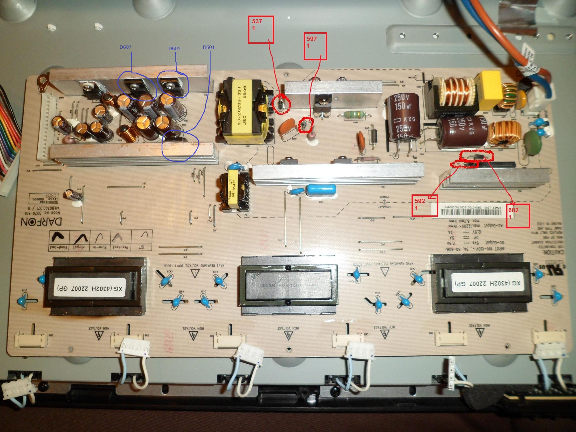

                                          #40
                                          Yes those are diodes some examples are here
                                          http://www.westfloridacomponents.com...ierDiodes.html
                                          Can you make out any part numbers on them?
