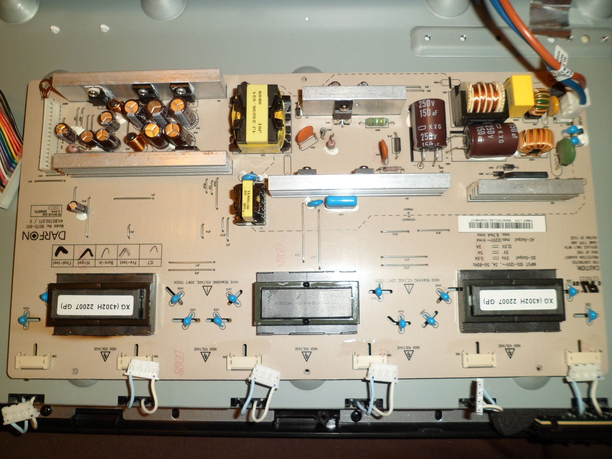

                      Thanks selldoor, I will have some pictures uploaded later tonight. As for the tv, yep! seems like there no power to the machine but I got power read at the board entrance connector. There were no fuse that I can find which I find very odd for being a power supply & inverter board.
                      I take a step back to describe the background. This tv is actually belong to family in a community that I volunteered to work with. They were watching tv and it just shut down without any warning signs/ noise. Since I got some basic knowledge in electronic works, I offered to fix their if possible (no promises were made ) and gave them my son's 32" tube keeping the kids happy. Anyhow, that's how I end up with a this task and that's all I know about the original symptom.
                      thanks again and stay tuned for the photos

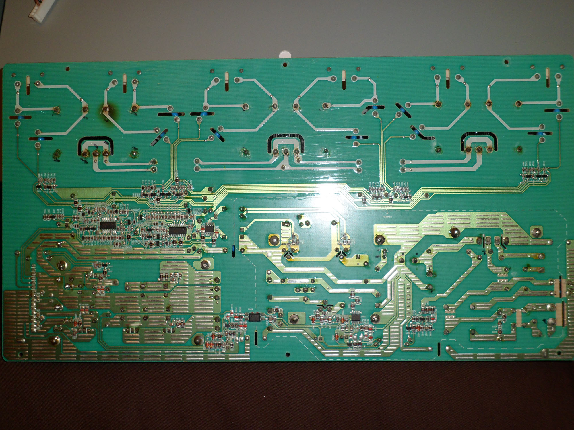

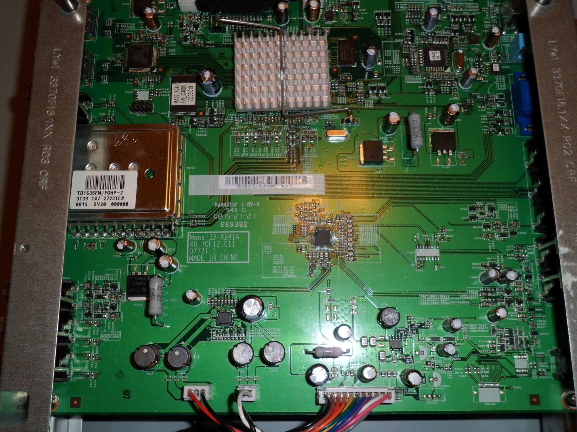

                        I got a bit crazy at work, finally get sometimes to up load. So, the tv has 3 boards all together: a power/ inverter board, main board, and a tiny board called T-con board. Let me know what you find. Thanks

                          Re: need help to test inverter transformer
                          If I may, let's start at the very beginning.
                          On the power board, there is a connector.
                          List the legend and your readings. For example,
                          pin 1 says 5V SB - I get 4.99V DC
                          pin 2 says 12V - I get 11.97V DC
                          etc

                            do exactly what retired says and also on the picture of the bottom side of the board i see burn mark this is probably due to that pin being dry jointed i hope you cleaned al the crap off that area or your new tranformer will not make contact,that dry was what caused the problem in the first place

                              Thanks retiredcaps for that thought! I did just that and realized I'm getting no output from that connector. I worked it backward and found the missing link in continuity at the little component that I have always suspected for being a fuse from begining. It was indeed a micro slow blow fuse. I couldn't find any at local electronic shops so I ordered from amazon 10 PC's for $5. I'll update when I get the part, let's hope that will fix the whole thing. I'll attach the photo later so people with the same board can identify the component.
                              Have a festive independence day
                              Popeye, I'll take note of that and will make sure the area is well cleaned. Thanks

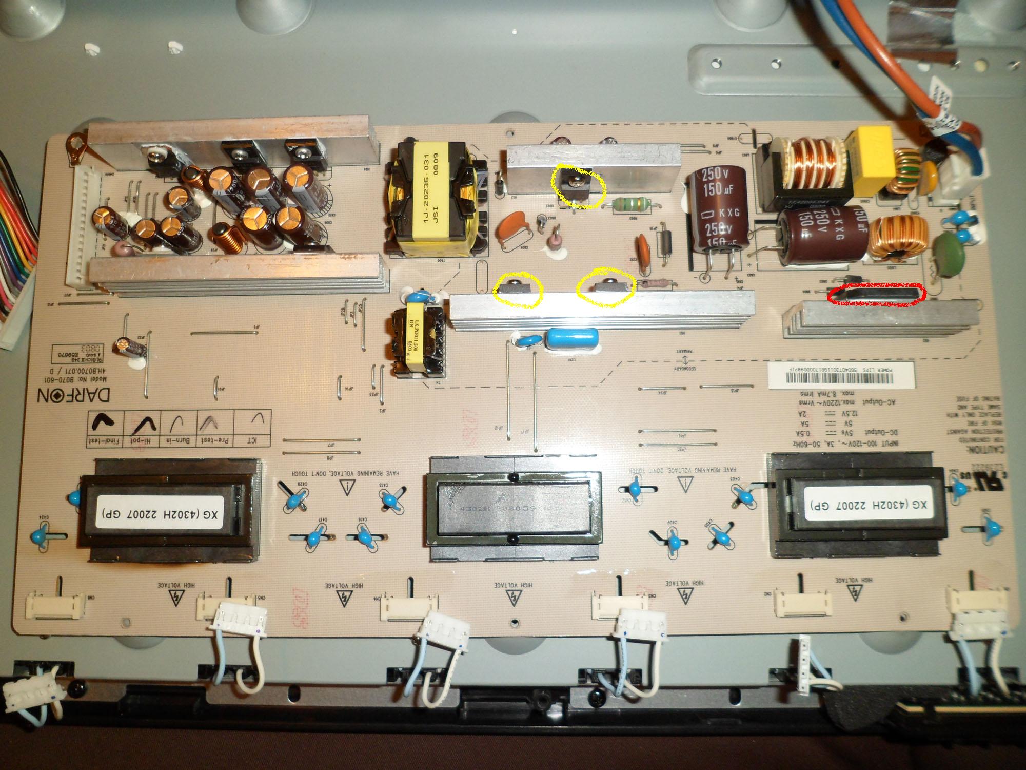

                                    Originally posted by woaimi
                                    What might be the next thing to check?
                                    Circled in red is your bridge rectifier. Circled in yellow is your mosfets. Check both for shorts
                                    I have written procedures on how to check both at least 30 times so search around here.

                                      well, i got the fuses, soldered it in and it blown instantly, so I followed your suggestion. the rectifier is good but I couldn't confirm the mosfets (following your ohm method) as each time i try i get different result.
                                        change the battery in your multimeter,and confirm it reads "1" or "0L" when shorting the probes together, set to 200ohm setting
