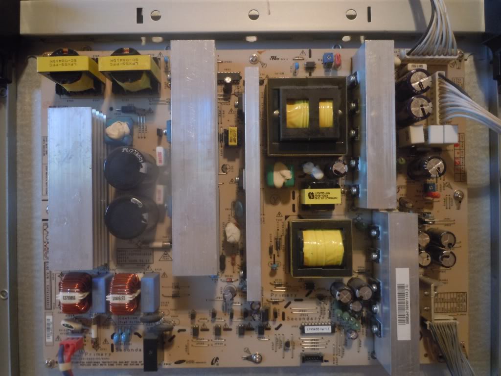

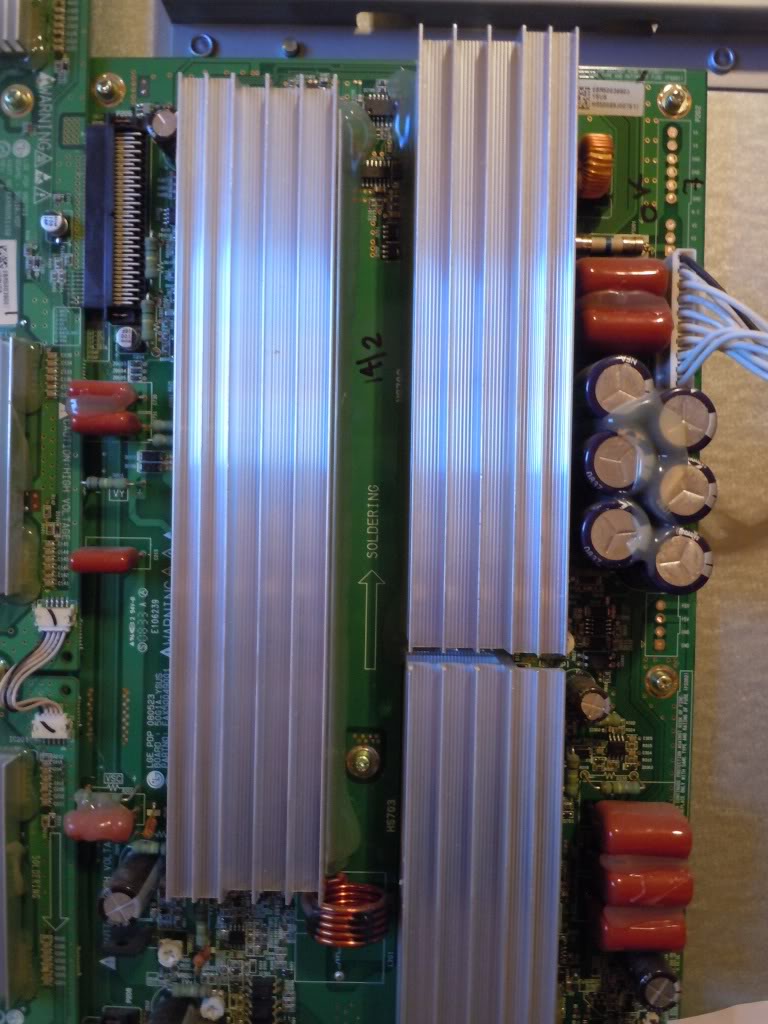

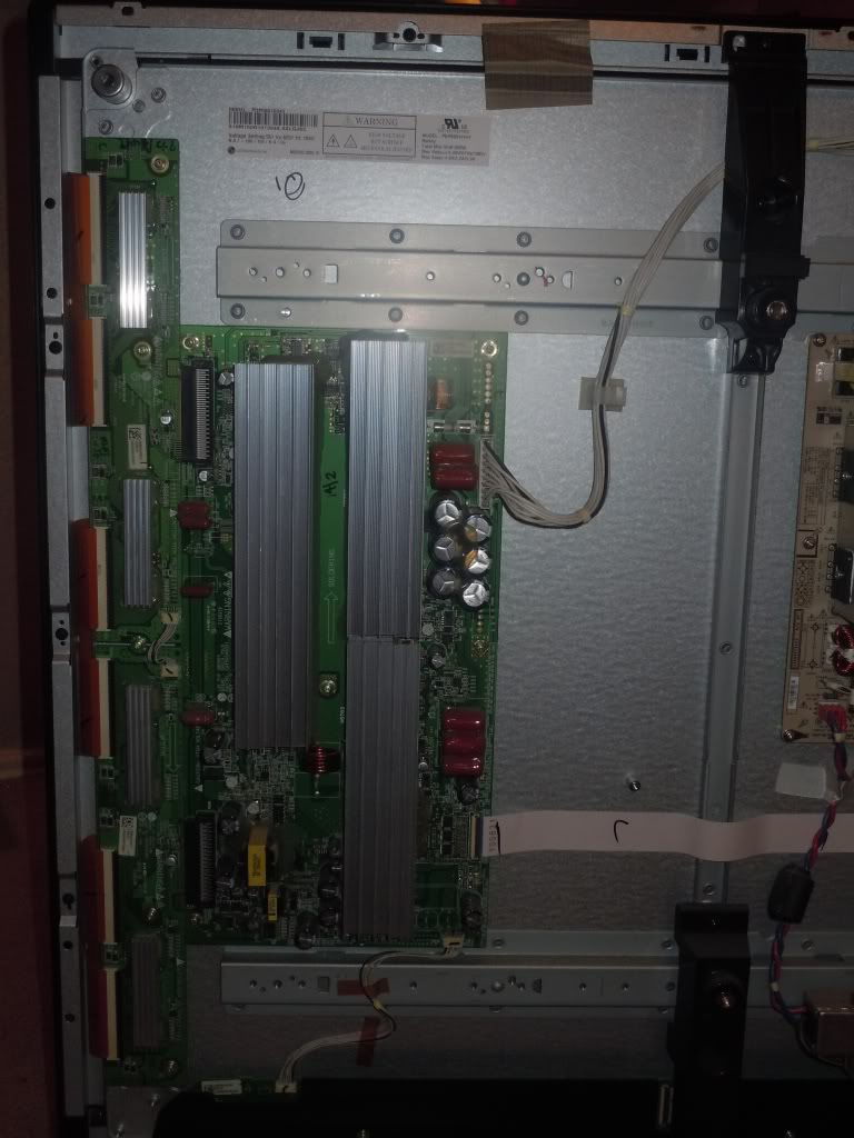

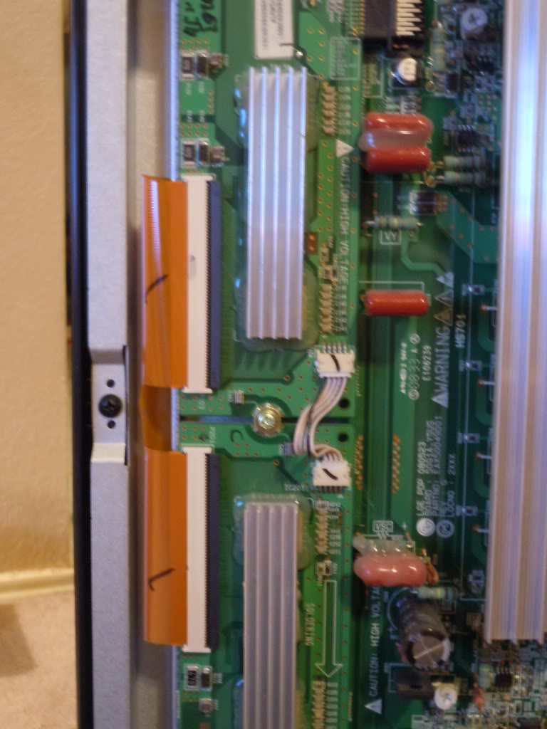

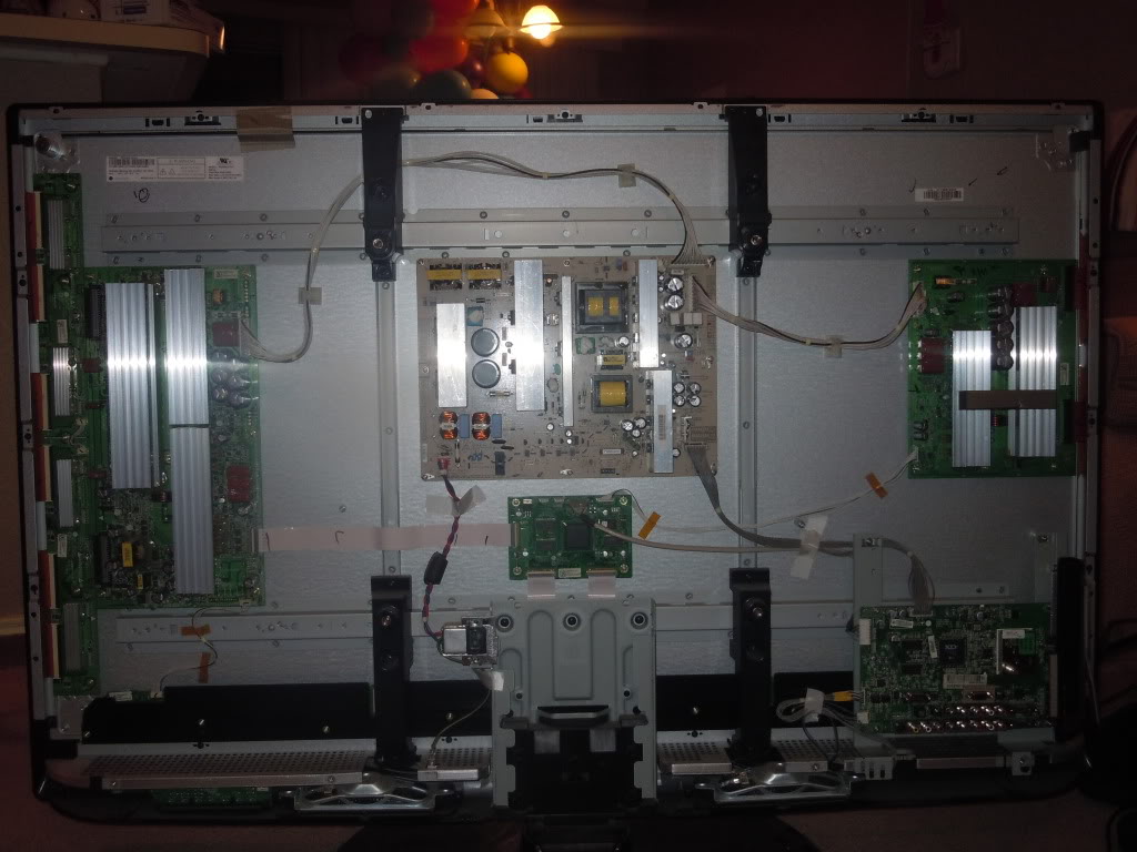

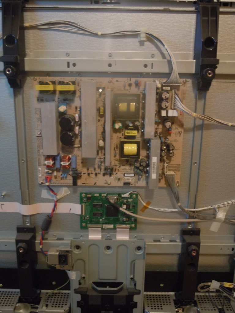

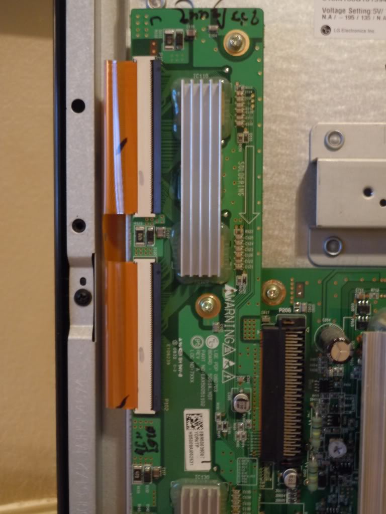

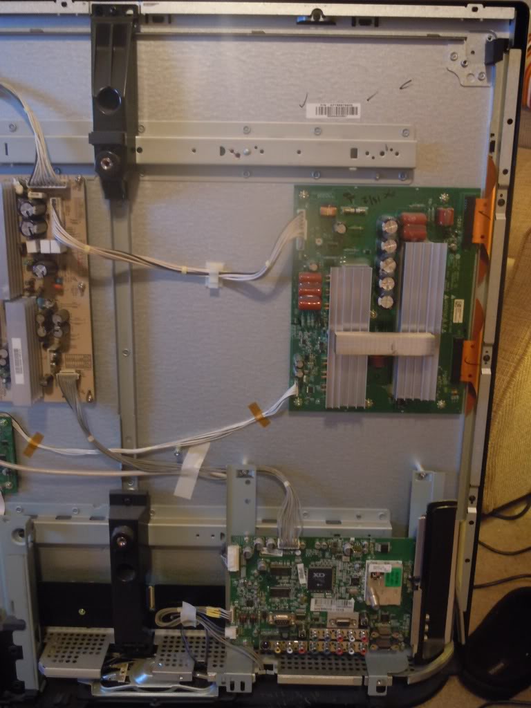

Yesterday the plasma tv picture turned black while watching. i have power and sound is good. I am trying to determine whether i need to replace ysus, top or bottom y buffer and how to test them. I tried disconnecting all connections from to main panel but still black. Next I tried disconnecting the top y buffer and half the screen turn a lighter shade of black but still no picture. i disconnected the lower y buffer and no results just black screen. I do not see any bulging or blown/leaking caps. I have a digital multimeter just need some direction on where to test to narrow down or single out the part i need to replace. I did put a temp probe on the following heat sinks. xsus warm, main warm, y top buffer warm, y bottom buffer warm, ysus cold. thanks for the advise this is my first tv repair but i learn quick.

ok first thing look on your y-sustain which is board to left which also connects to upper and lower ydrv board.. see if any of the fuse or open and also like wise on your z-sus? next if no fuse or blow then lets measure our VS&VA voltages coming from power supply,there a label on the panel that will tell you want those voltages are suppose to be most common fault for no picture would be y-sus failureRon Driver,BSEE,CET,ISCET,NESDA -
I checked the ohms and the fuses read good at about 2.0. I see the label but how do i check the vs&va? where do i place the red and black probes?Comment

red probe would go to pin or connector mark VA then black would be chassis ground,looking on your y-sustain board you'll see the connector and it will have the pinout connections label there for VA & VS measure each seperate with respect to chassis ground while powering set onRon Driver,BSEE,CET,ISCET,NESDAComment

You need to use VDC. Use the metal frame, e.g. screw holes, as ground.Please do not PM me with questions! Questions via PM will not be answered. Post on the forums instead!

set your meter to dc volts reading for around 200 volts scale or higher also to check your voltages for VS & VA, this link may help give you and guide of how to check your buffers
http://blog.coppelltvrepair.com/2010...er-boards.htmlRon Driver,BSEE,CET,ISCET,NESDAComment

No, but it does eliminate the PSU. The buffers and sustain could still be faulty.Please do not PM me with questions! Questions via PM will not be answered. Post on the forums instead!

Re: LG 50pg20 no picture/sound fine (pictures included)
You get 1 ohm on your top buffer? That's a dead short. Bottom buffer is probably okay.Please do not PM me with questions! Questions via PM will not be answered. Post on the forums instead!
