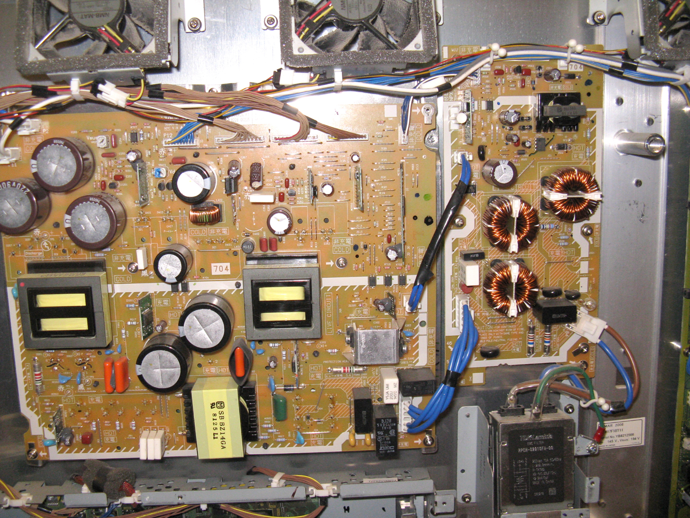

    TH-46PZ80U 46IN PLASMA no picture, no sound
    Hi everybody
    My Panasonic TH-46PZ80U 46IN PLASMA died last morning
    I have no picture, no sound but i can see in dark the display have some light
    any idea
    thanks

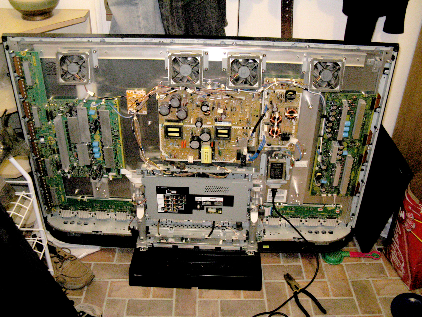

        Re: TH-46PZ80U 46IN PLASMA no picture, no sound
        Welcome to the forum-
        We can usually help a lot more if you please post good clear pictures of the whole chassis, and then pictures of each board, front and back and close up of connectors, (max resolution 2000x2000 and 2MB) using the manage attachments button, which is found by clicking "go advanced" under quick reply.
        Examples of what is needed
        https://www.badcaps.net/forum/attach...1&d=1290283049
        https://www.badcaps.net/forum/attach...7&d=1280167246
        It will be useful if you can say a bit about yourself - skills tools etc.

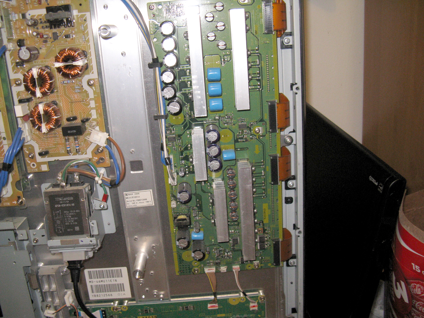

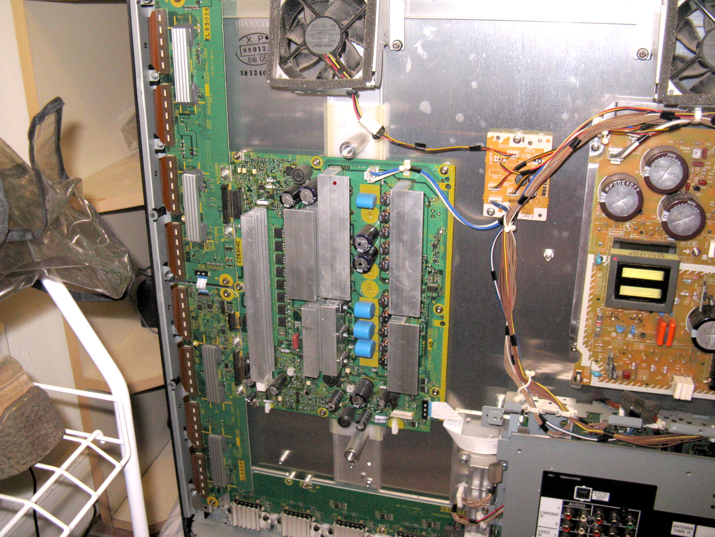

                i can't attache more image, some error on site think
                and my image is 2.5 Mb but the attached image is 256 KB

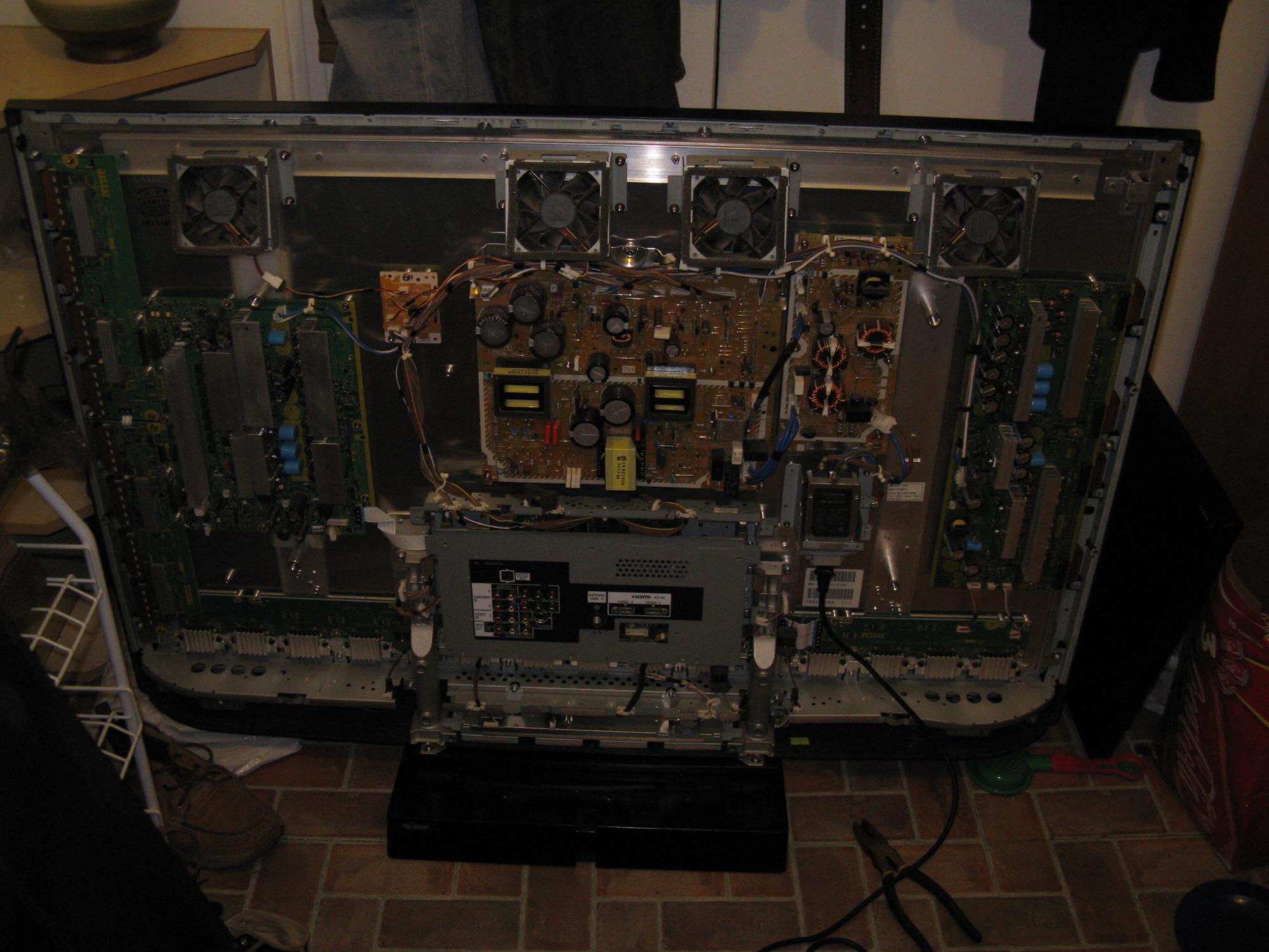

                  You need more light to get better pictures - it is ok for general layout but not for
                  troubleshooting. Jpg pictures should be less than 2mb for them to upload.
                  Please can you also update your profile with country and mains voltage.
                        i'll try one by one

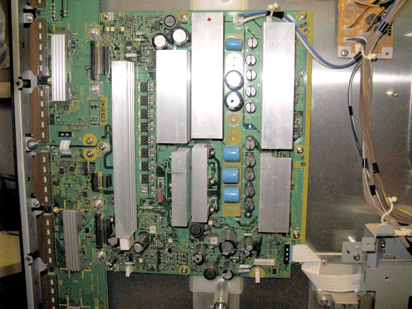

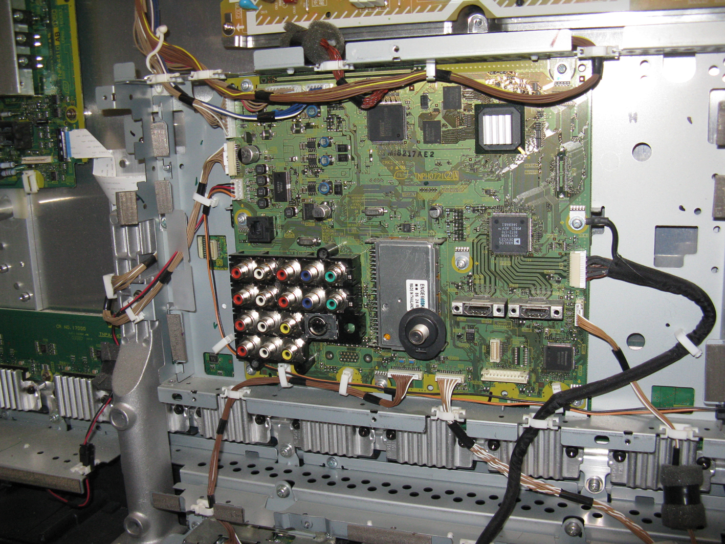

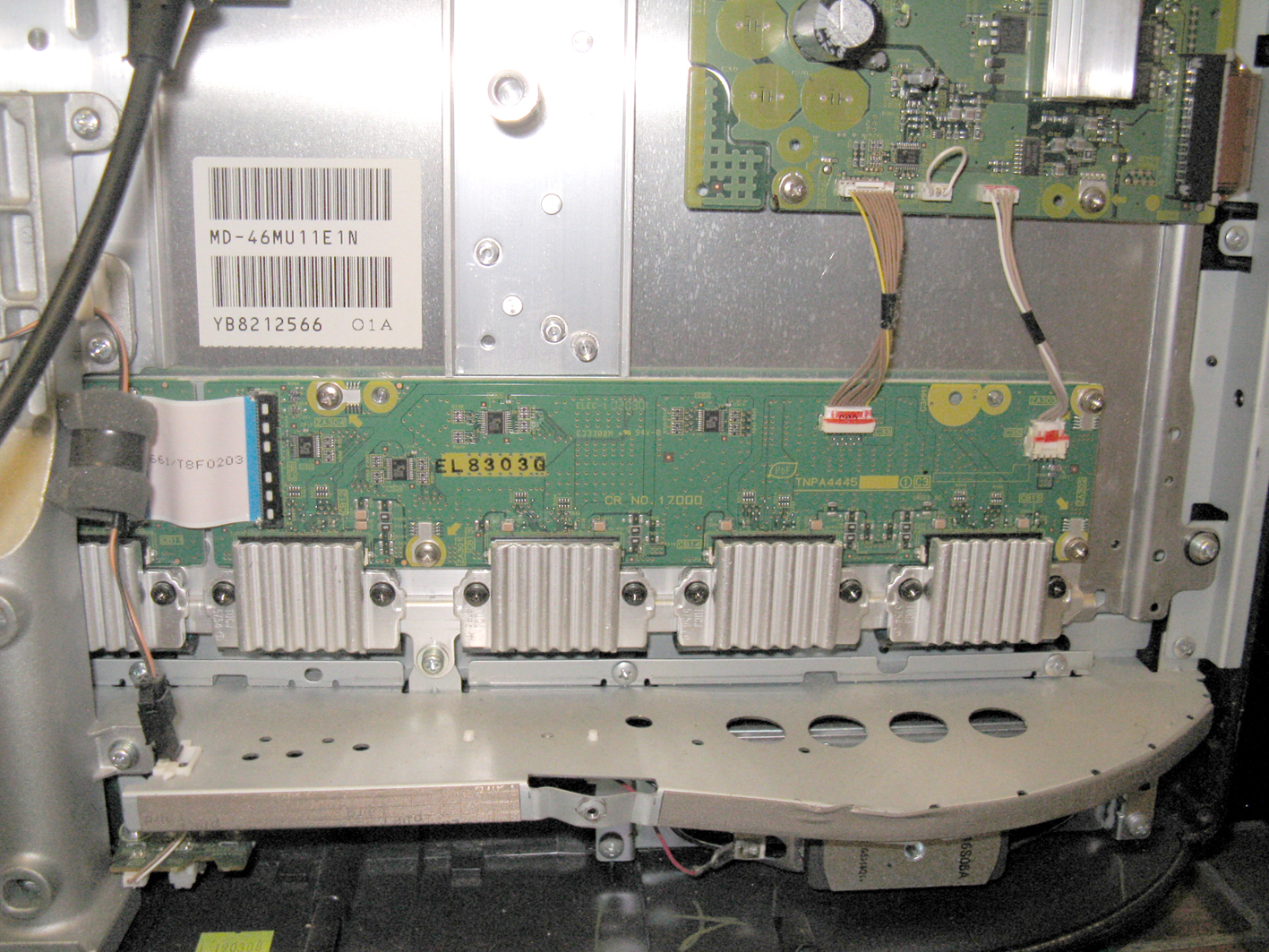

                                    Definitely sounds a lot like an A board issue there. If you remove the shield, we can suggest some places to start troubleshooting.

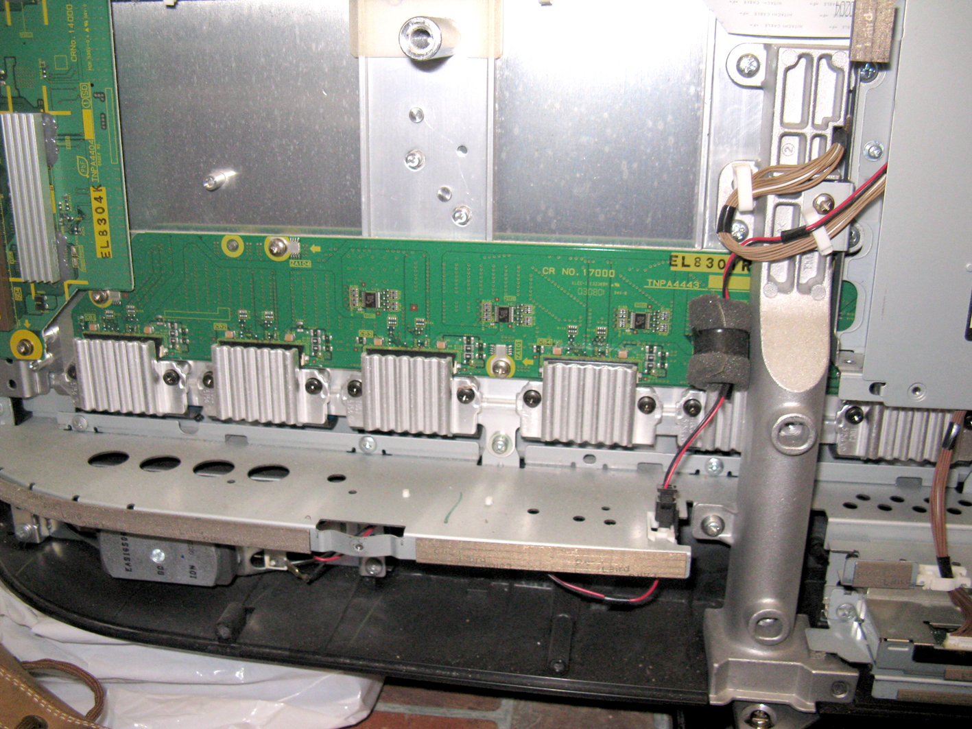

                                      a board
                                      • nickmatine
                                        • Jun 2010
                                        • 48
                                        a little bigger
