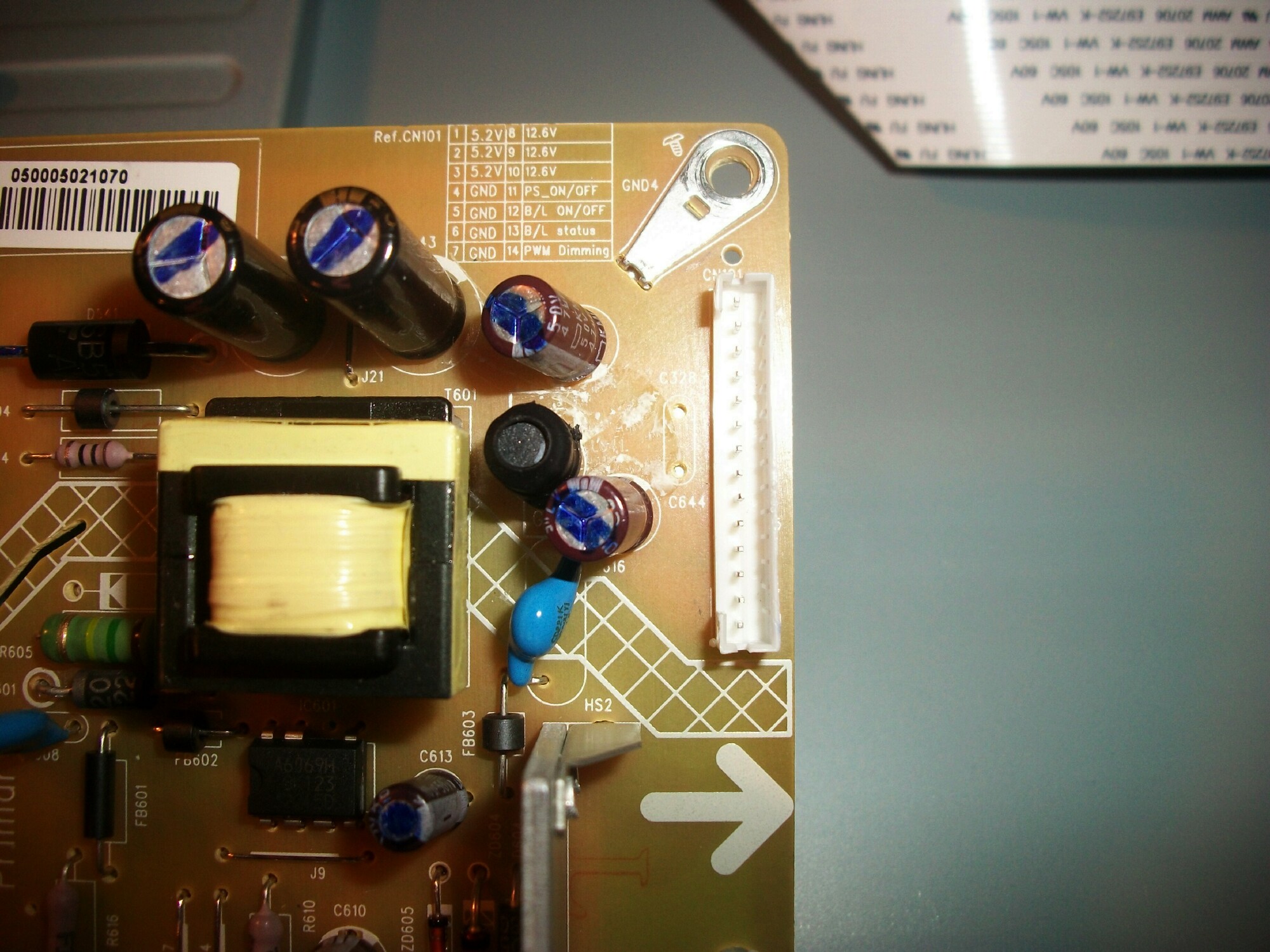

                              Attached are the pictures you wanted. Kind of gloomy outside today so I hope this is clear enough.
                              On the Inverter Connector picture Pin one is at the top.
                              On the Main Board Connector Pin one is at the bottom.

                                #55
                                Re: Vizio E321VL
                                OK, I will look at the pictures tonight, I cannot find any info on that PFC IC P/N L100 either, it may be difficuit to figure out the VCC pin of that IC, will see after I look at the pictures.
                                OK, picture#3 post 54, CN101 Pin 11 is PS_ON PIN, please check the voltage onthat pin, it should be around 3VDC or higher when TV is switched on.

                                    #57
                                    Re: Vizio E321VL
                                    It is 0.0V using common to ground pin on that connector and also to the ground screw by the AC Input.

                                      #58
                                      Re: Vizio E321VL
                                      OK, you do not have the PS_ON signal from the main baord when you trun on the TV, that is why the PFC and the 12/24 Vdc power supply do not turn on. So we need to find out where the fault is on the main board.
