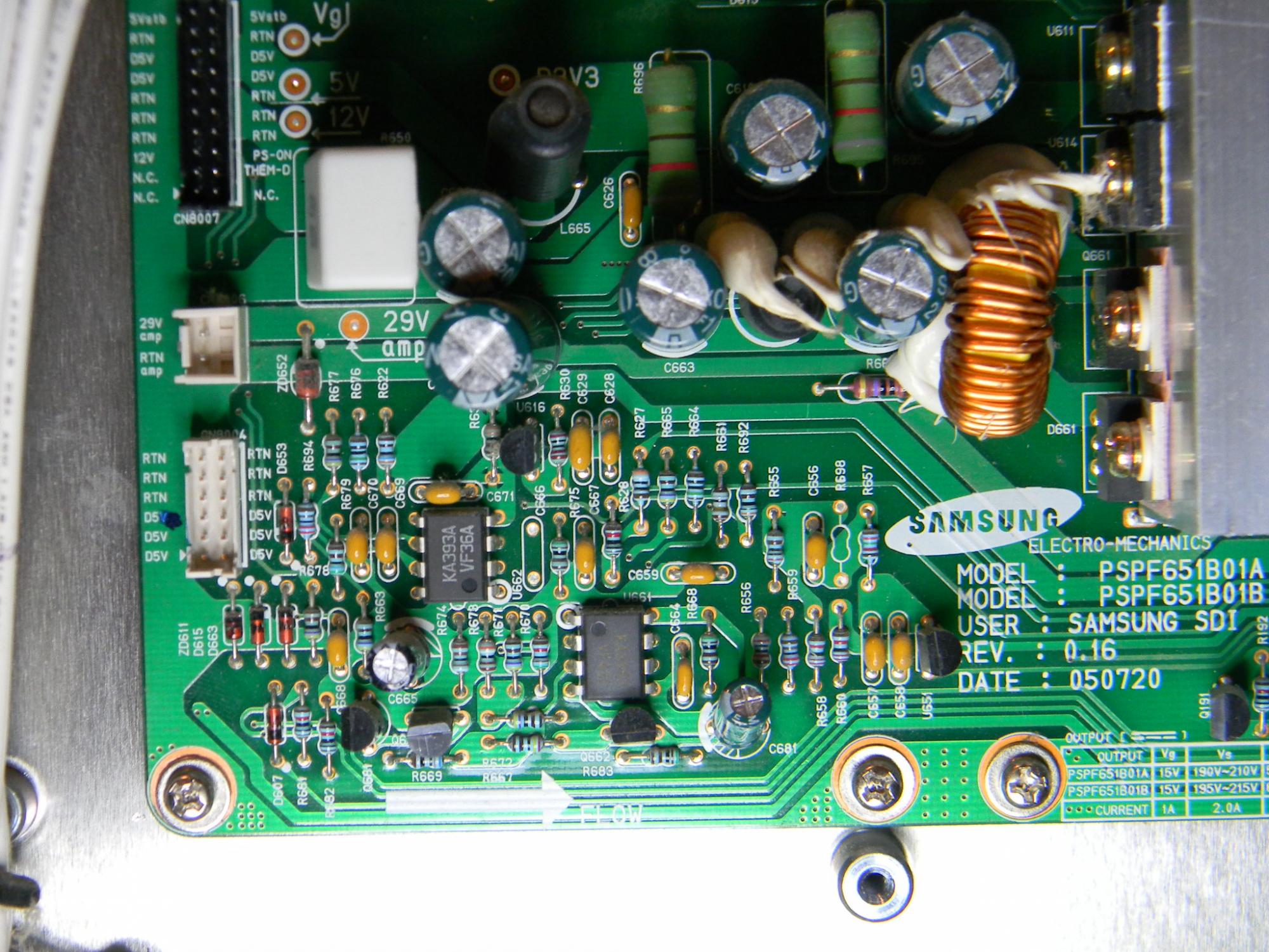

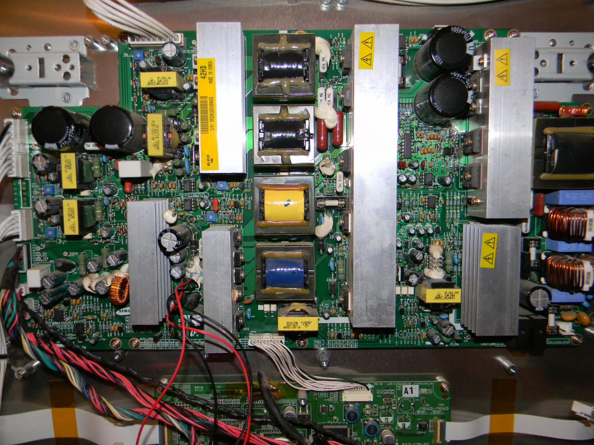

        Post a pic of your power board, clear and focused, close to 2000x2000 (but not exceeding these dimensions.) I recommend a sunny day for light.

          Re: Dell W4201C TV Bad Cable Picture
          I can take better picture when it is not raining outside but this is my power board. Is there a way to test the voltage to the tuner?
            I can't see your pic for some reason - can you upload it using the manage attachments feature.
              This is the most complicated picture post I have ever tried to complete, (PEBCAC error mostly).

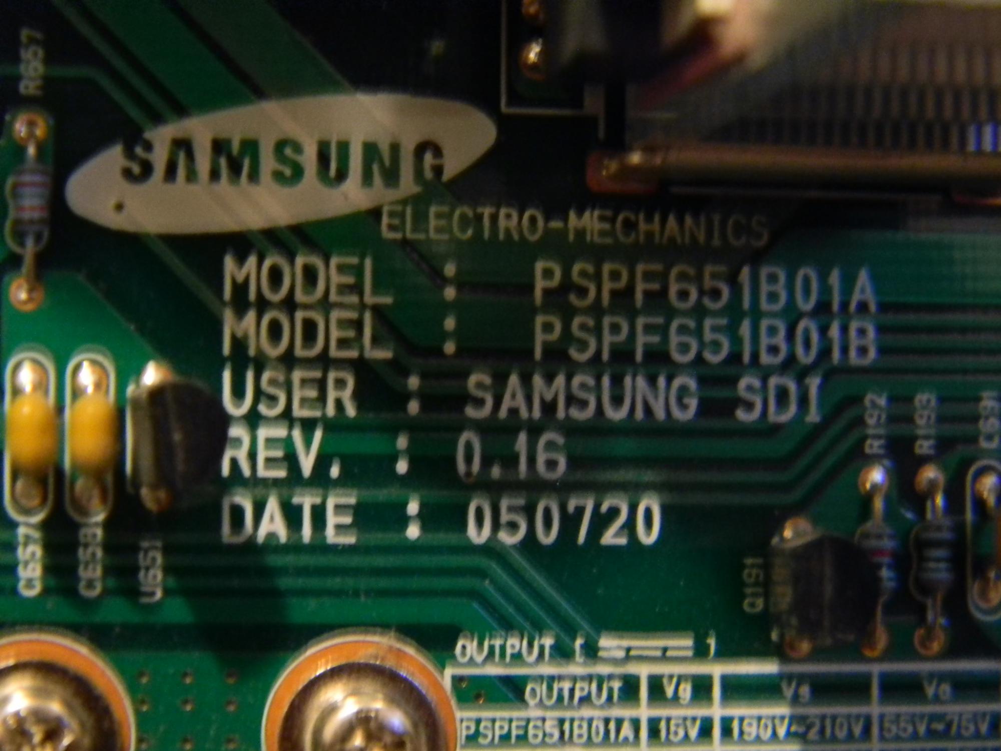

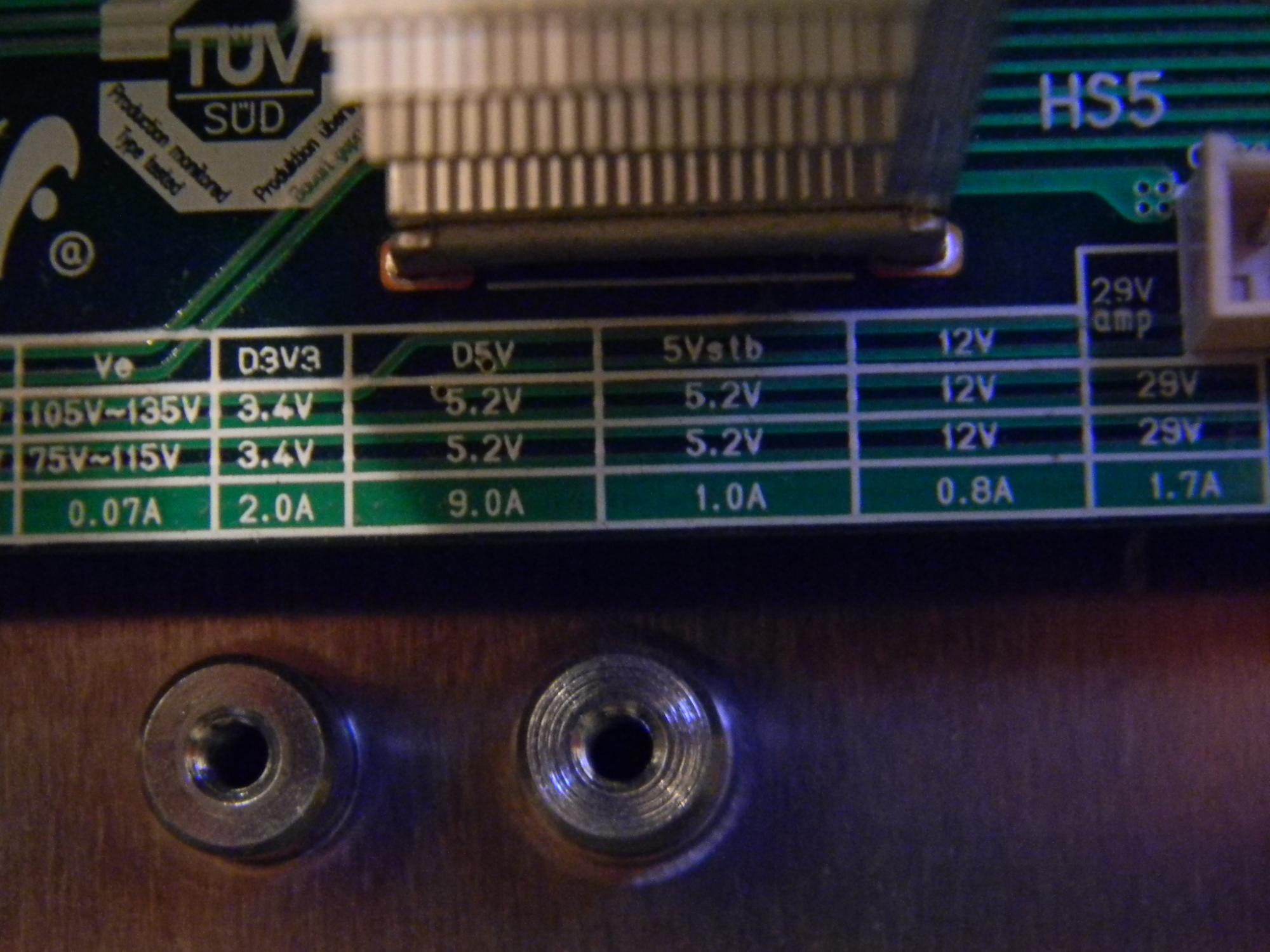

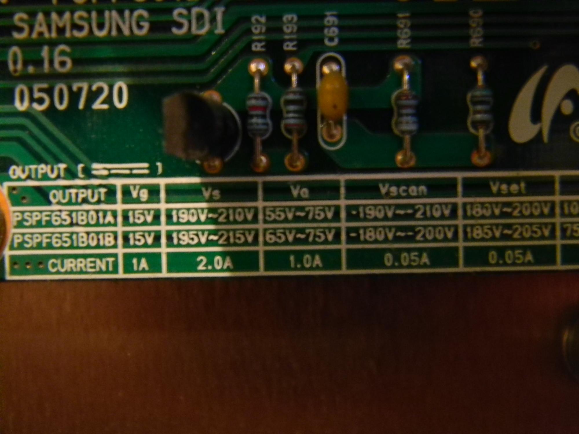

                Can you post a closer picture of the "Output" table near the bottom of the power supply (or you could list each output, don't need to worry about current or other things.)
                    Nice to know I'm not the only one with this problem. Here are more pictures of the power board. I'm hoping to find a solution and save this TV from the landfill.
                      Is there a test point anywhere for the +29V?
                        There is a 'test point' for the 29v circut however I have looked over the board and there is no ground, RTN 'tet point'. I used a multimeter to messure accrost the plug terminals. 28.9v very stable, no change in voltage.

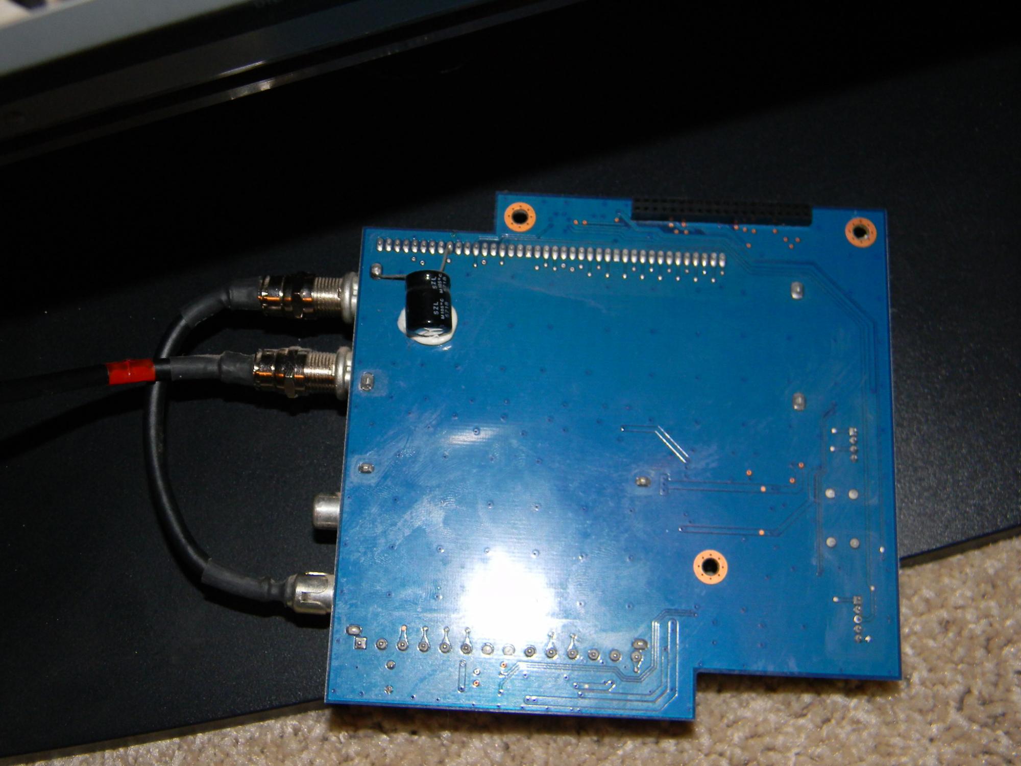

                                  Can you post pictures of the front and back of the tuner/input board someone may be able to spot something adrift. Also check carefully for bent pins or dirt in all the source connectors.

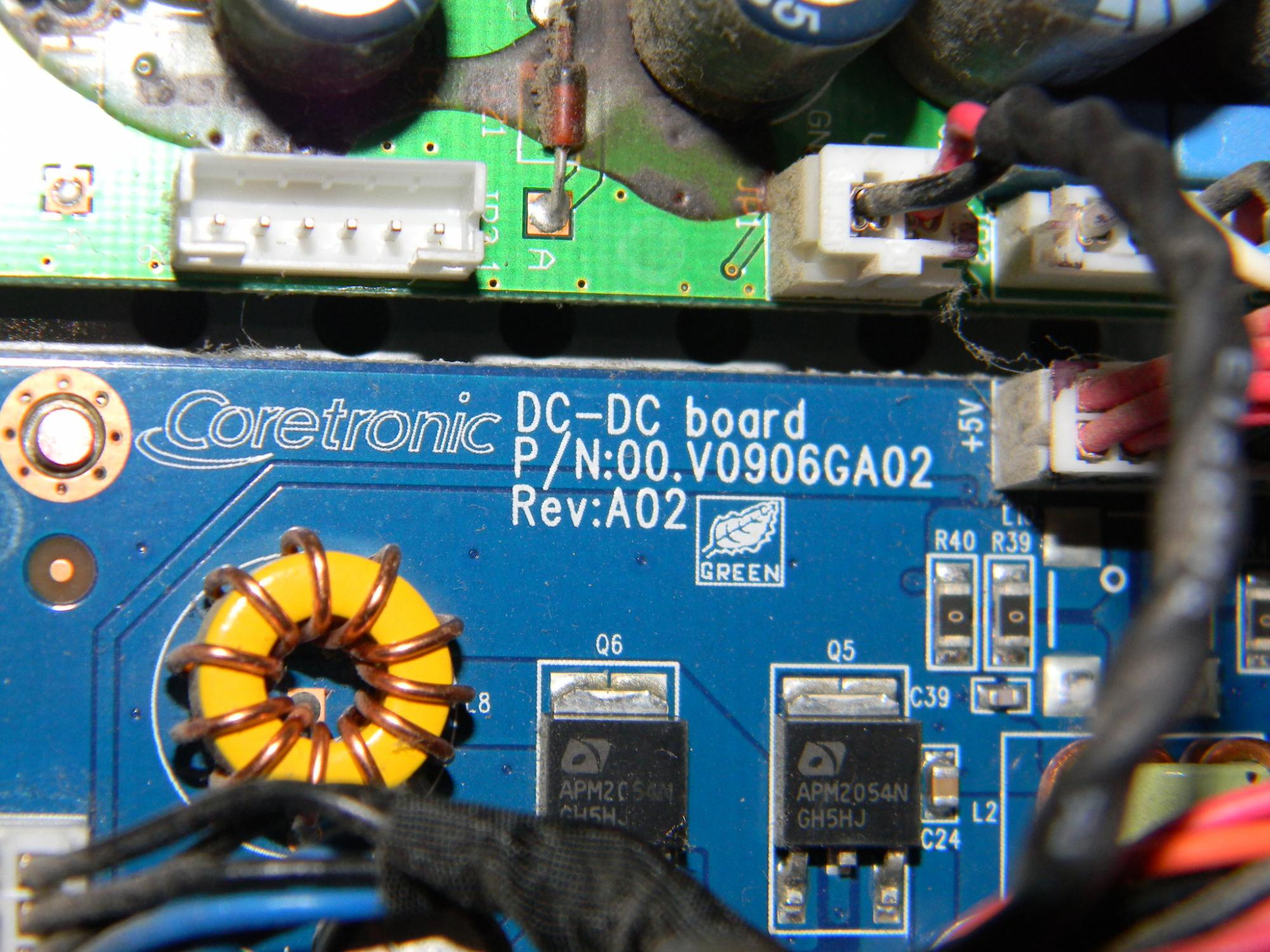

                                    Here are Photos of the tuner card and one of a DC-DC Board I'm hoping someone has more information about. Everything else on the TV is working fine; TV tuner picture is still not clear and the only voltage I can see is wrong is a 5v line running from this DC-DC board to the tuner card, reading 4.4v. Thanks to anyone willing to help me.
                                      That low 5V could be causing the problems. Can you post an overall picture of the DC-DC board?
                                        Ha ha ! Hmm! Hi Tom - did you see the board above the DC DC board - leaking electrolyte?
