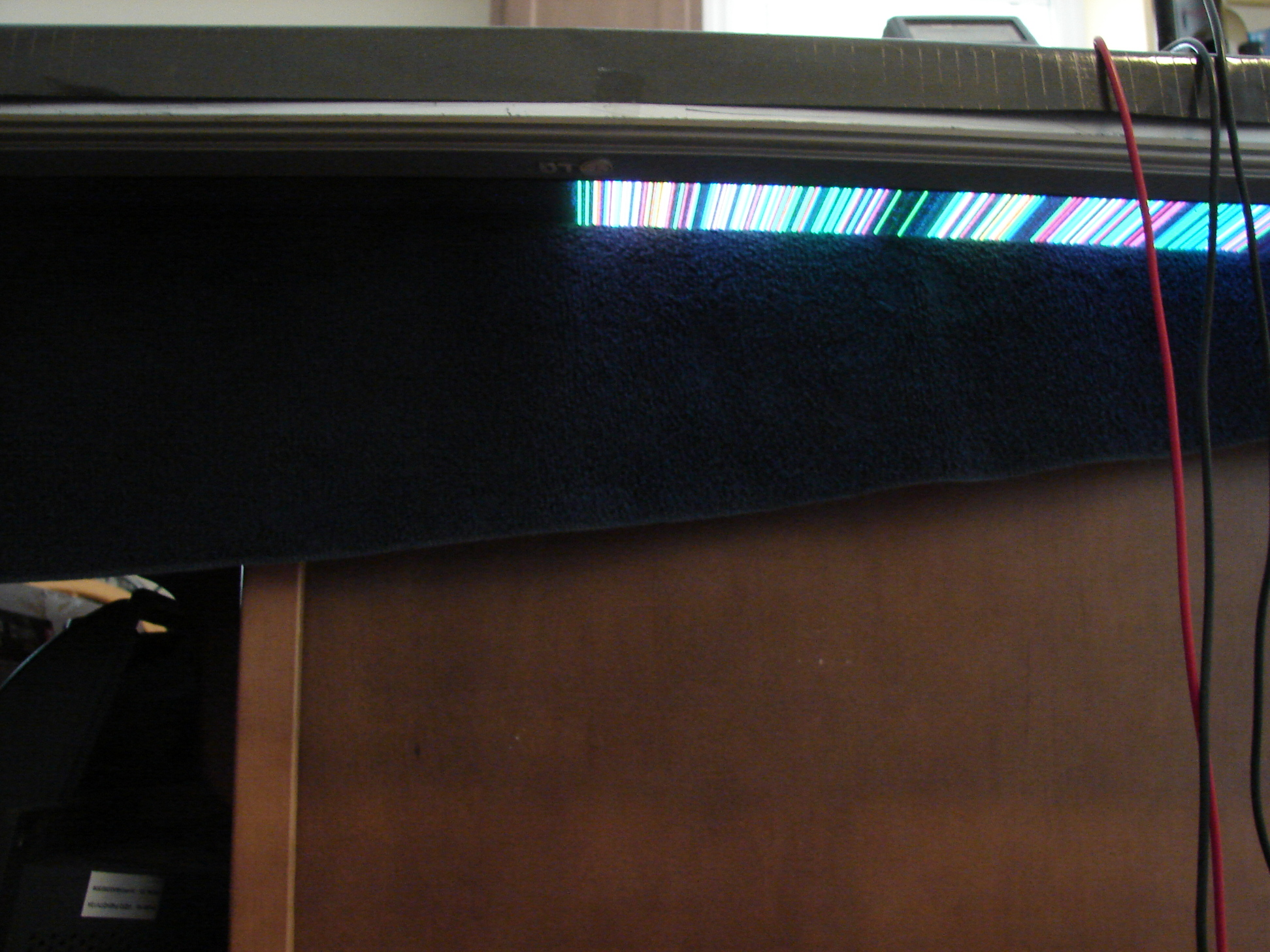

    Ok, so first off, this tv had the left (from viewing angle) side filled with colorful lines and the right had a big bar or two but was mainly black. If you lift up on the tv a little the lines disappear but you have like colorful static. And if you leave the tv on about 5 mins it shuts itself off.
    So was told that this would be a controller board issue and it fixed the lines on the right side...yay? (included picture)
    So bad controller board, or hoard of other problems? Oh, the Z sus board also is making a low whur sound right near the IPM.
    Voltages are good from the P/S.

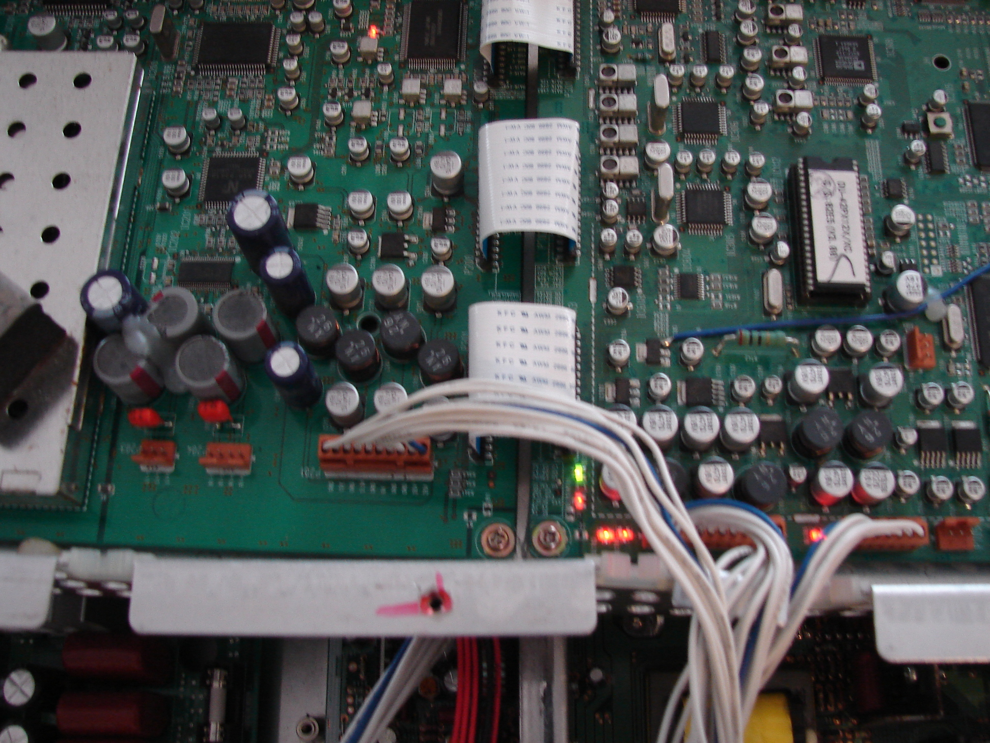

    The main A/V board and controller board both have these internal LEDs. Could someone name there function, especially on the A/V board since some are red. I believe they can be both red or green considering there are 3 terminals per LED.
    Thanks.
