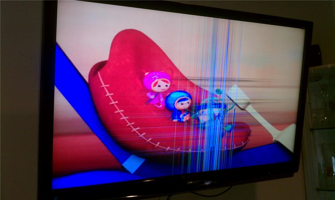

    I'm looking to buy a TV off of eBay to repair. It has vertical banding (see link or attachments) and what not. I talked with a TV tech about it, and he said, "anything that effects the picture like that, almost 90% of the time, it's the panel, which can't be replaced."
    If the banding could be fixed easily, maybe by just replacing some bulging caps and what not, then I would like to purchase it to fix. I already have a LC-46D64U with a band panel, so I can use that as a parts TV.
    So, the question here is, how much of a gamble would it be to buy this TV off of eBay and expect to be able to repair it? As long as it isn't the panel going bad, I have all the pieces needed to repair it.
    Thanks.

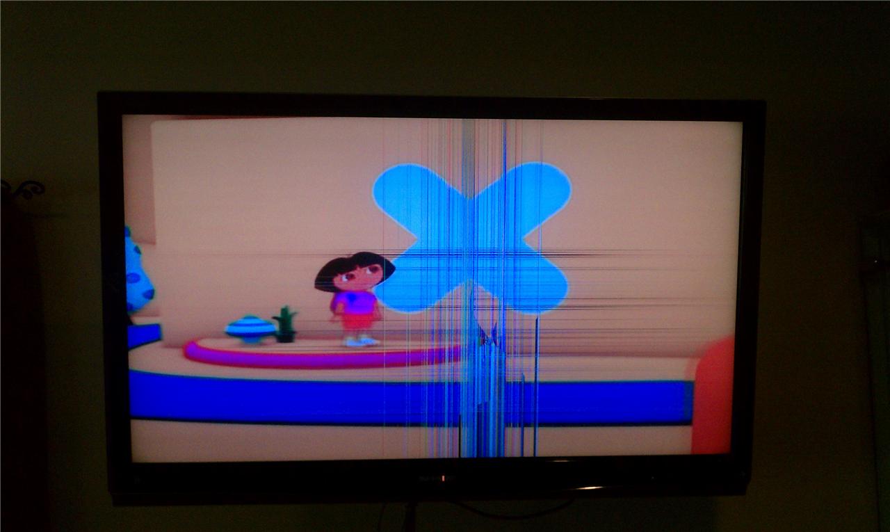

    Re: Vertical Lines Repairable? LC-46D64U
    Look at the second pic...
    The panel is clearly cracked in the middle...
          It's definitely a cracked screen. Only worth parts. $190 for that is crazy.
          Sometimes the crack damages the TFT lines driving the transistors, causing lines and dead pixels.
                              I am talking about the panel as shown on the picture in post 1.
