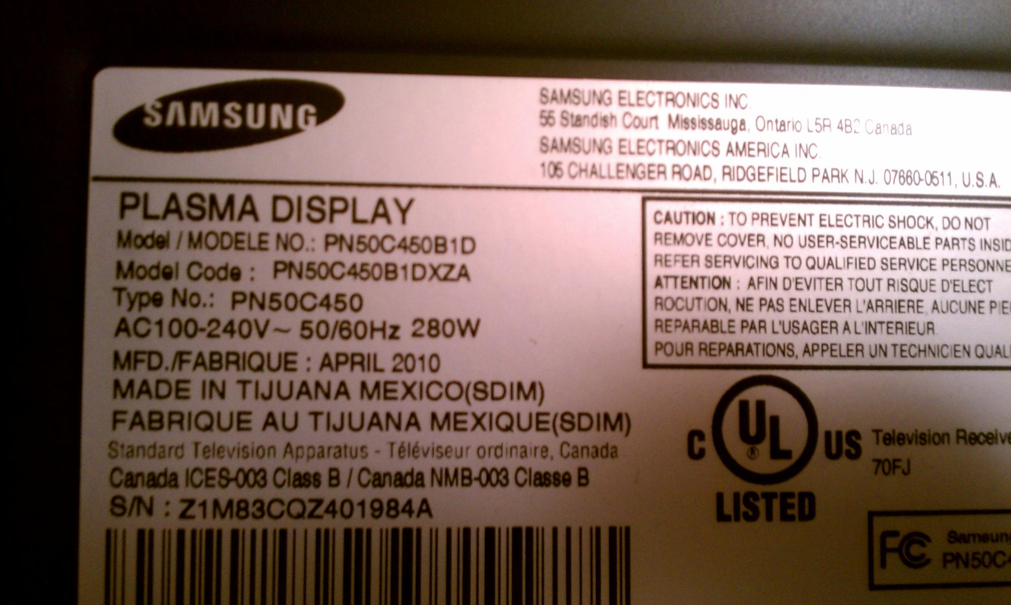

Okay; the tv was working bt it had a thin vertical line on the left side. i attempted to find out which board was going bad. Ok, i unplugged them and now no picture. I unplugged the x board and replugged it. that when it clicked a few times and now no picture. If i unplug the x board; it will make sound and it appears that he picture will come in, but it never does. if the x board is plugged up; no sound no attempted picture. wen the x board isnt plugged up; and i power it on; i can still see the thin vertical line. do i need to replace the x board and what can cause the very thin vertical line???
Samsung: PN50C450B1DXZA
