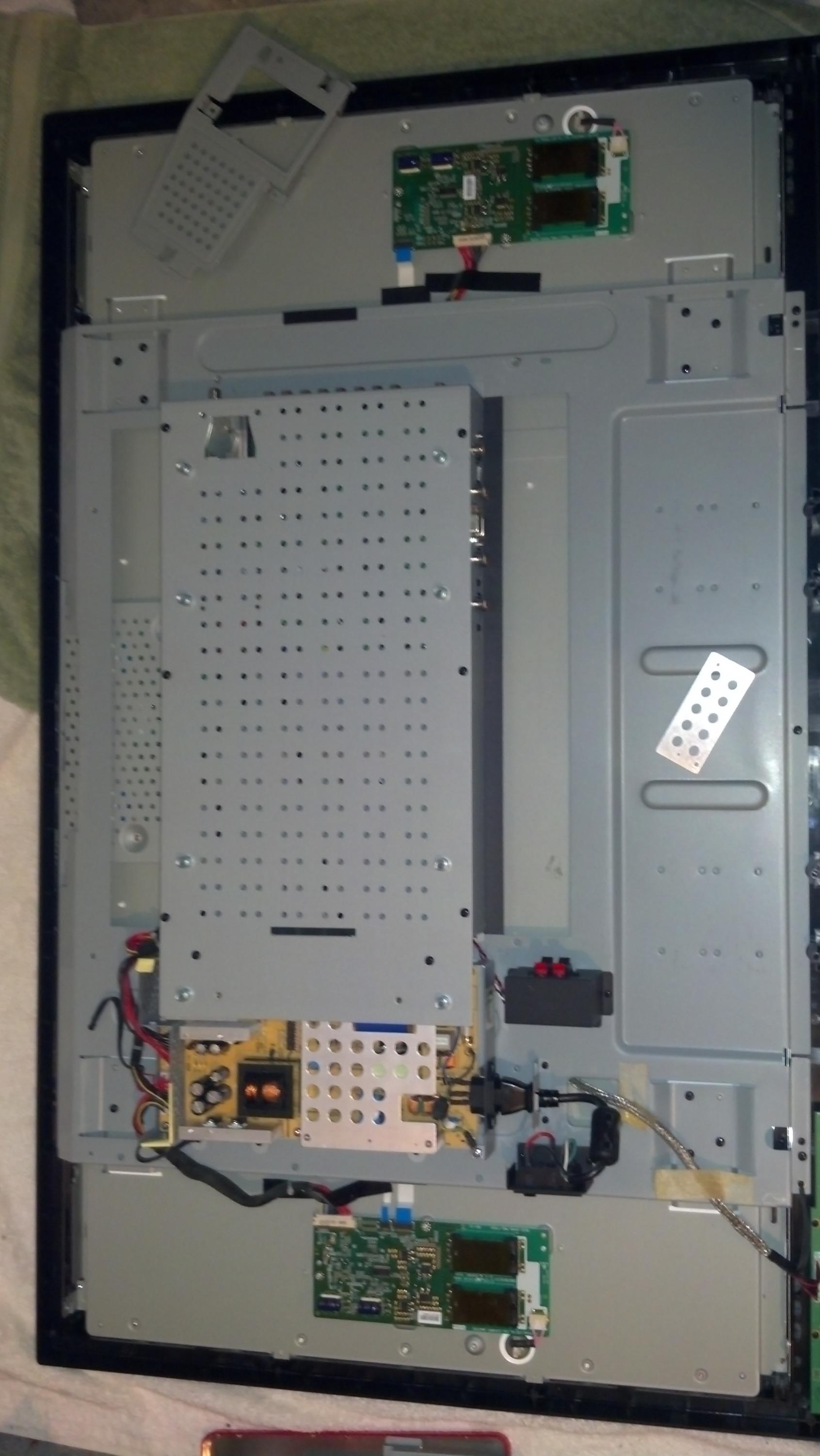

    Welcome to the forum- It does sound like it may be a cap on the power supply. As some caps warm up they sometimes start to work a bit better.
    We can help a lot more if you please post good clear pictures of the whole chassis, and then pictures of each board, front and back and close up of connectors, (max resolution 2000x2000 and 2MB) using the manage attachments button, which is found by clicking "go advanced" under quick reply.

                          As a start just post a picture of the power supply board - front & back

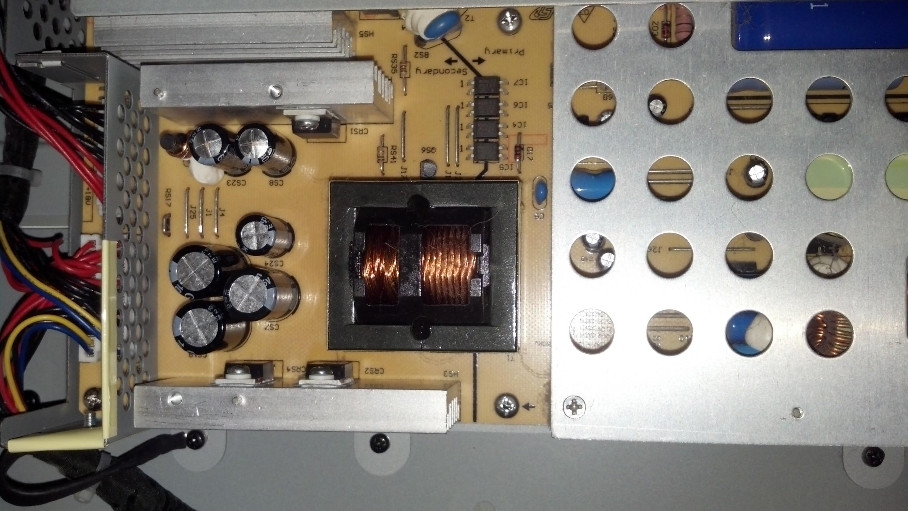

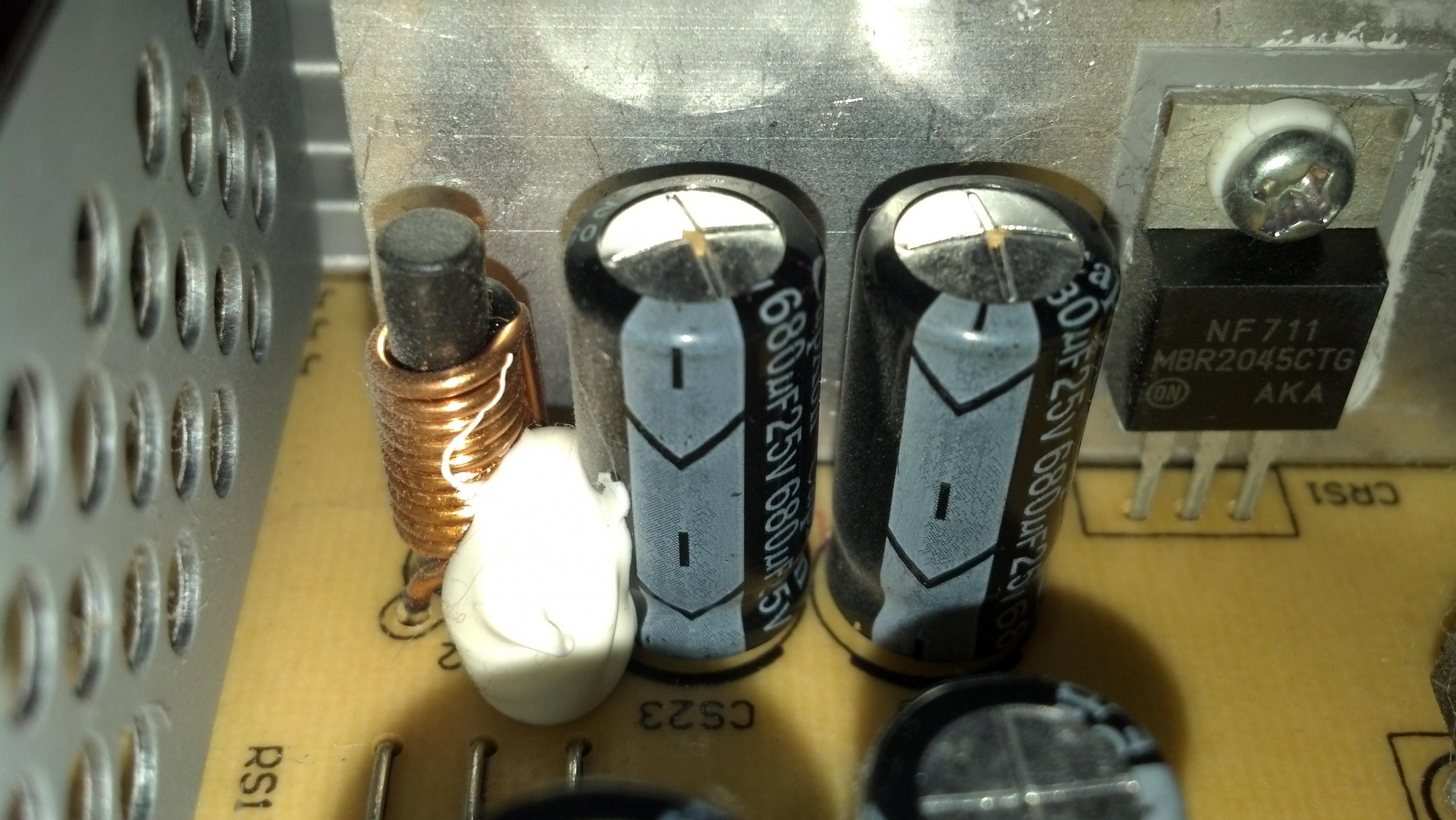

                            • broacke
                              • Aug 2012
                              • 6
                              Re: Olevia 242TFHD-T11 42" TV Start Up Problem

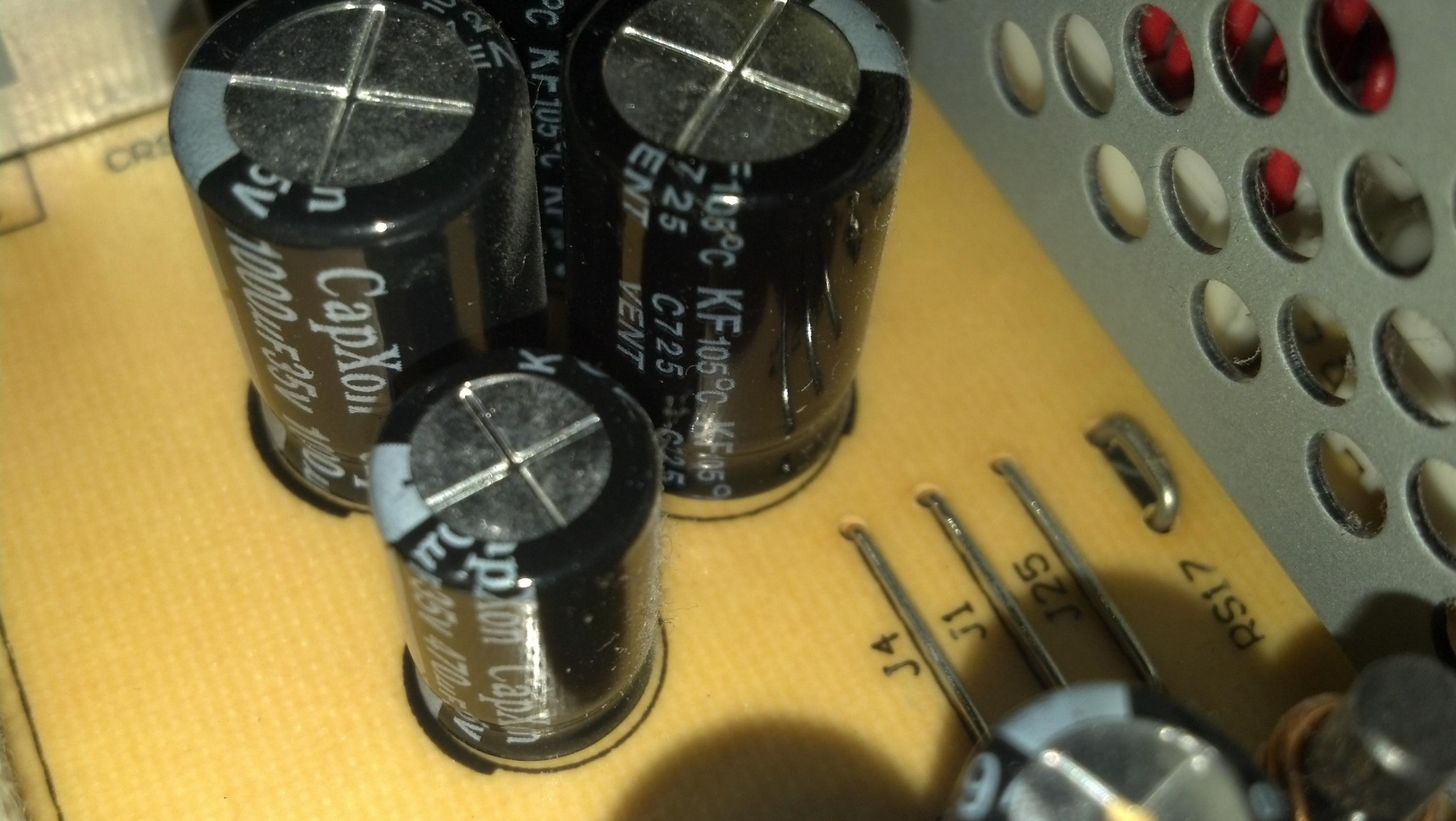

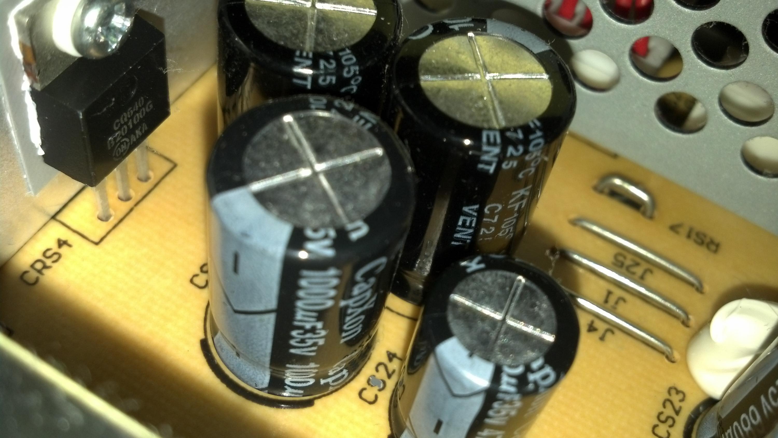

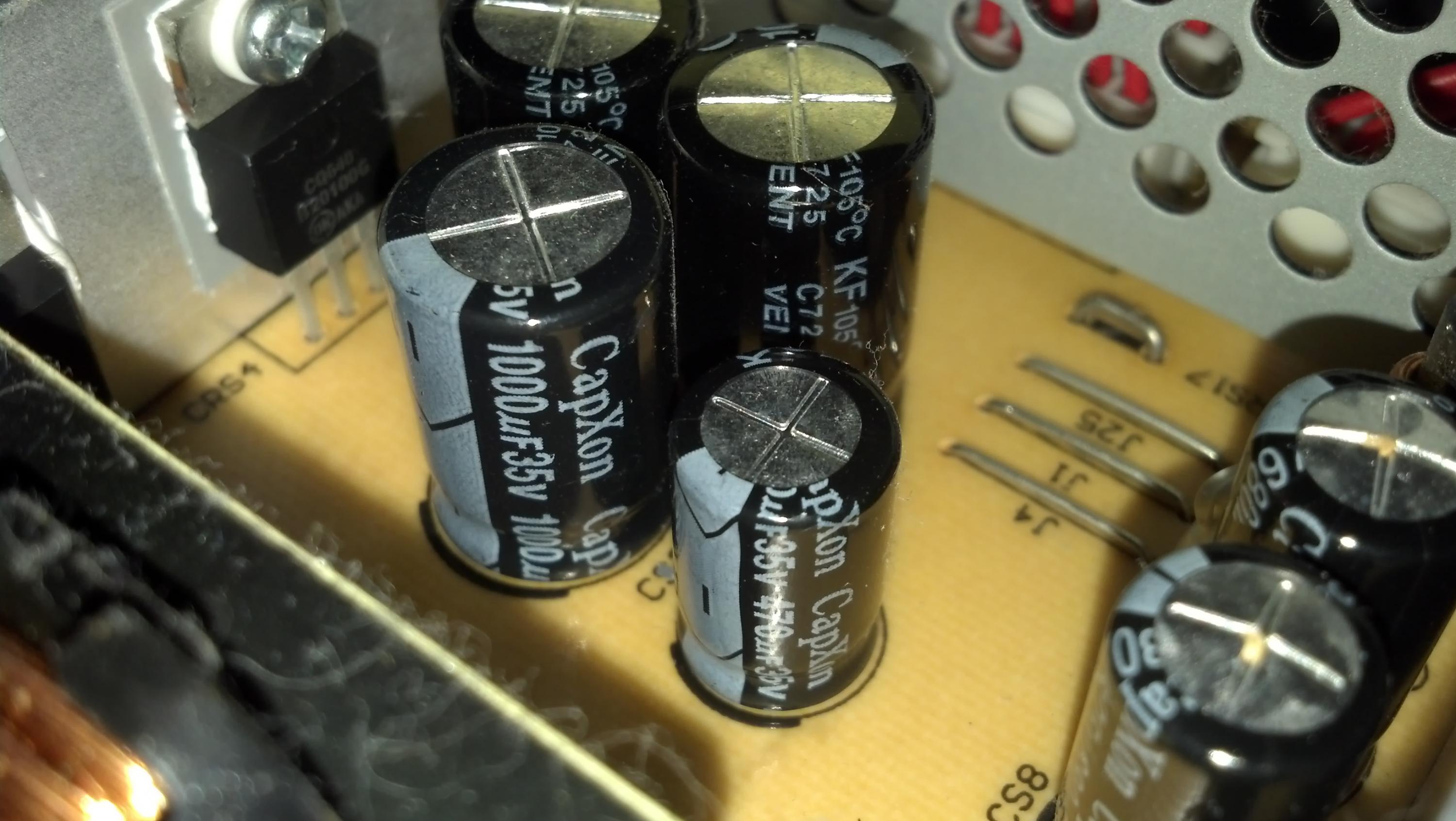

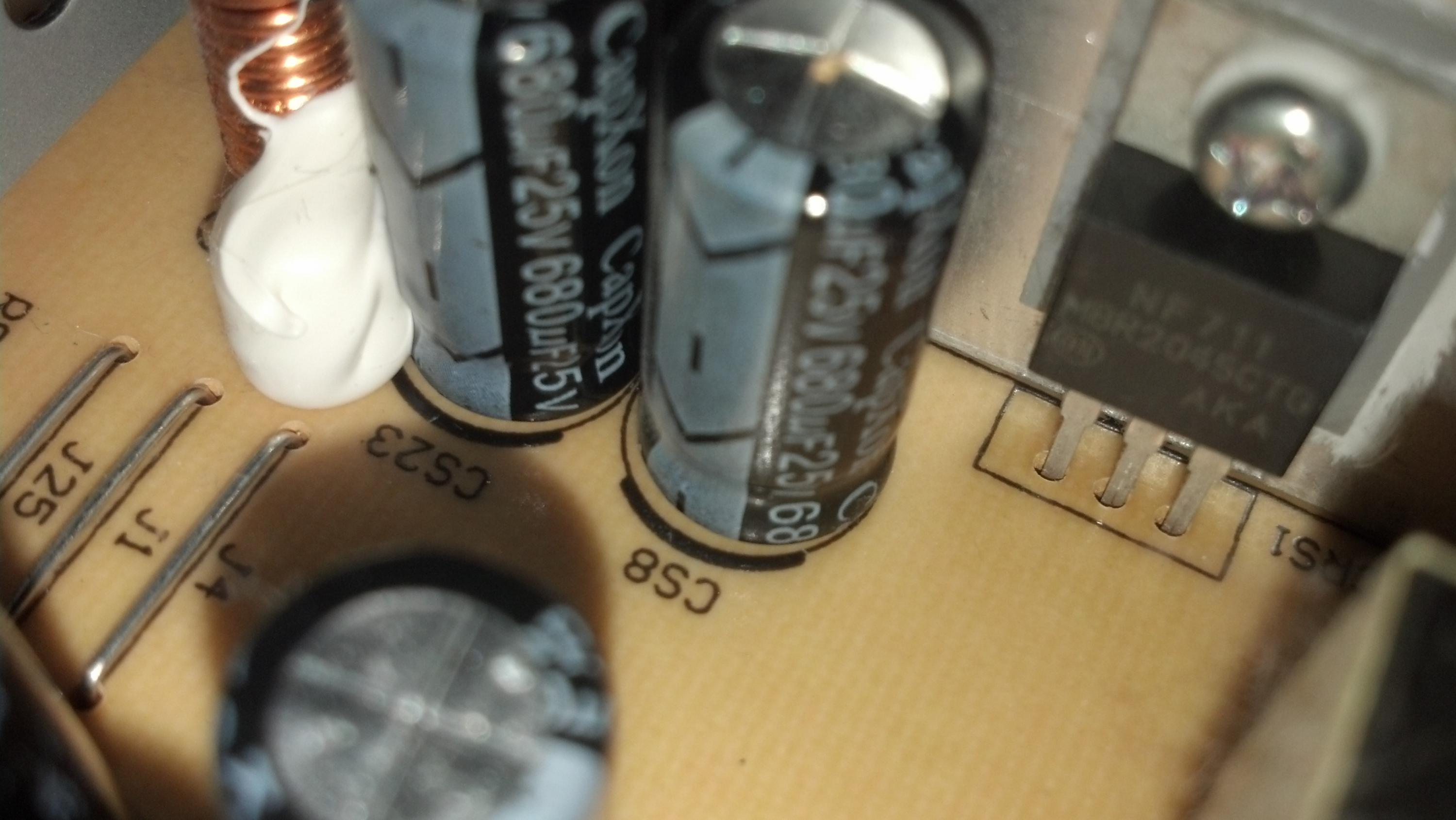

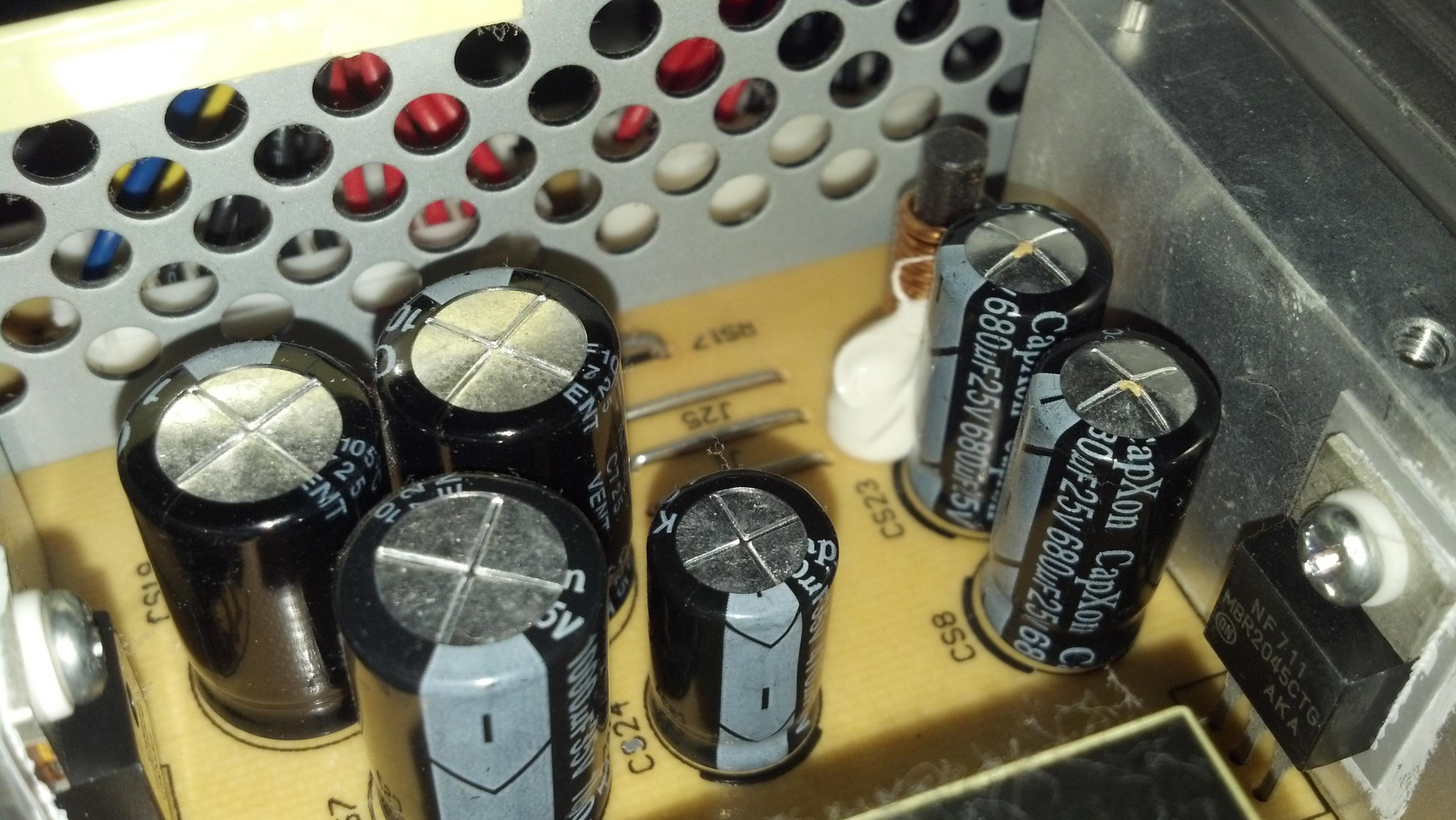

                              I am not sure if I have the same exact model. Mine just says 242-t11. Anyways, the past few days when I would turn it on I would have no volume on the main speakers. Power it offand back on fixed it. Today it would not power on at all. I unplugged itand letit sit. When I plugged it back in the blue standby light would come on for a moment then go off. No power or audio. I took the back off and found two caps that was bulging a little and may have leaked. Reading through these posts I am pretty sure this is what is wrong, but I really don't know all too much about fixing these sort of things. I hope the pics help.
                              • ricosavy
                                • Jul 2012
                                • 457
                                • united states
                                replace those two bad caps more likely they will be the problem.just remember when putting them in there is a neg and positive side.the side with the stripe is neg.
                                  I have the same TV, I recapped my PSU as well.
                                  You'll want to recap the whole thing, instead of replacing those two. It will save you time later on when it goes out again and you have to replace a few more.
                                  You'll want to go with Panasonic FC, FM, FR caps.
                                  The top heat plates come off with screws and desoldering was pretty easy, but also be warn too much contact time can damage the copper track. I had it happen to me when putting new caps in and had to bridge it to a near by transistor.
                                  I don't remember what the values are on the capxon or what series, if you list them here, I can look them up and give a parts list. Also include the small ones too the 2.2uf-47uf caps.
                                  • broacke
                                    • Aug 2012
                                    • 6
                                    Thanks much for the help! How do I find the values of them? Are they the numbers on the side? I took a couple pics if that helps identify them. Also, what stores would carry these or should I just order them online and wait? I have the tv laid down flat, some people are saying thats ok, others say it is going to ruin it....

                                      • cashkennedy
                                        • Aug 2011
                                        • 666
                                        Everything mad professor said is right on.
                                        If you have the whole tv completely on top of a flat table with a towel / or blanket inbetween so you dont scratch the plastic around the screen, then you wont have any issues from leaving it down for a month.
                                        Youll want to buy low esr caps, and replacing them all should fix your issue. Every brand makes many types of caps, so make sure you are looking at specific series that are recommended on this site.
                                        Generally panasonic FM series is a great choice for these. From the pictures you can see some 1000uf 25v caps, some 470uf, and so on. When searching for caps you want to first choose aluminum caps > radial caps> the voltage (25-35v) > the capacitance (470uf, 1000uf, so on) > the lead spacing > choose the right low esr series / brand you want, and make sure its not to large to fix within the tv (not usually an issue on these huge olevia tv's) . You can always increase the voltage on caps, so if they used a 25v you can use a 35v cap, since thats the max voltage before it will live a shorter life.
                                        Digikey is a little more exsp then mouser, but has a cheaper shipping option. They list a little less data on mouser (no lead spacing) so its harder for begginers to order from. They ship in 1 day to texas and neighboring states, but your between both companies so should get it fast either way.
