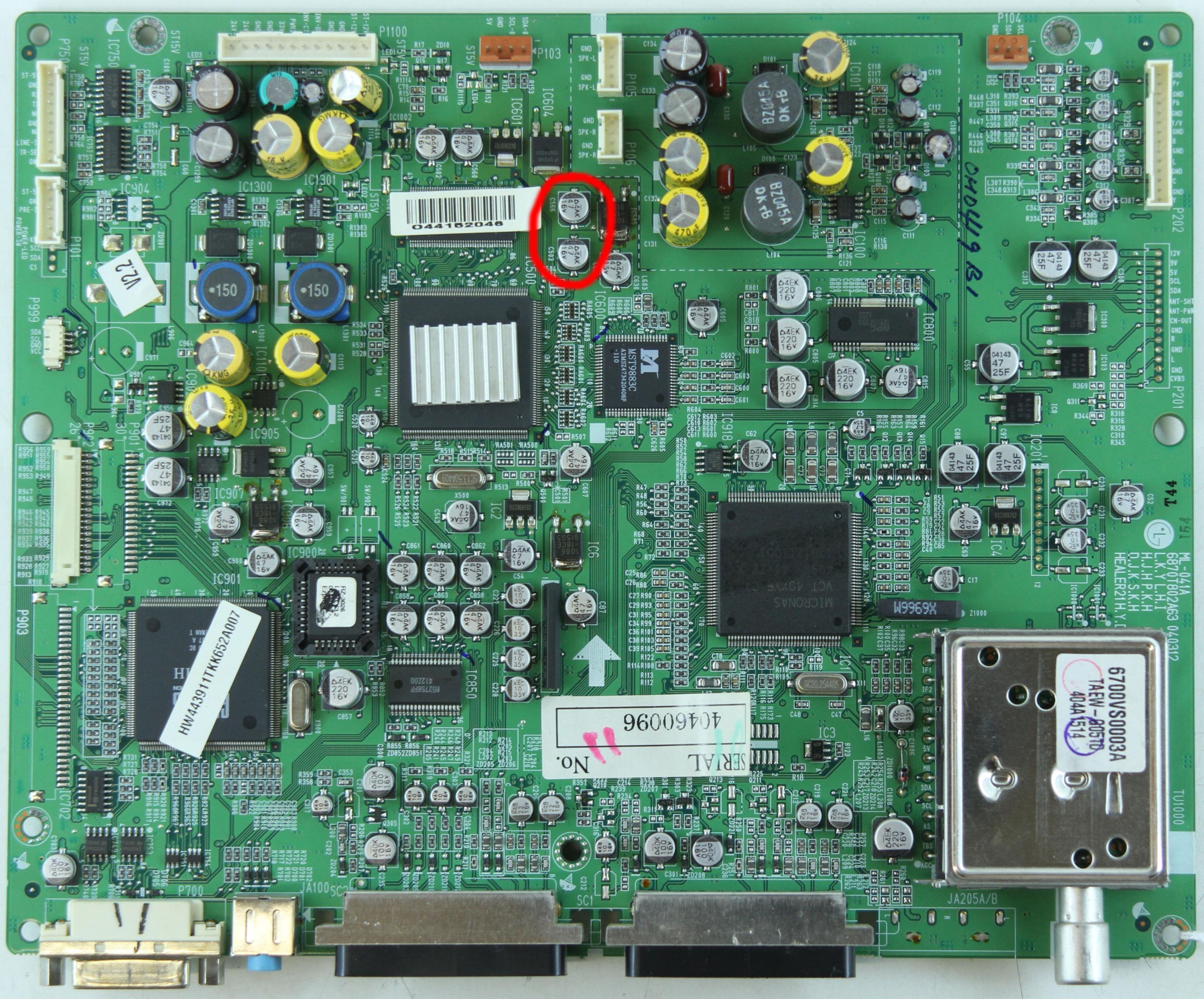

    Solution is to replace two 47 uF SMD capacitors just above center the center of main PCB near 1.8 V stabilizer, I don't know position number, but two above each other
      Re: LG RZ-26LZ50 green lines problem
      This is old post, but just minutes ago have repaired LG 30LZ50 LCD TV.
      Replaced C566 and C503 caps. Green screen and fuzzy screen issue solved.
      See photo for the location circled in red. Photo taken from google.

        Old post, yes! But just want to thank rjndebruyn and lin4sm for these posts above. With instructions I fixed LG-RZ26LZ50, which had green lines and wobbly picture at start. Fixing is just replacing those two capacitors (C566 and C503) from mainboard. Here's a quick video or more or less it is a slideshow...
