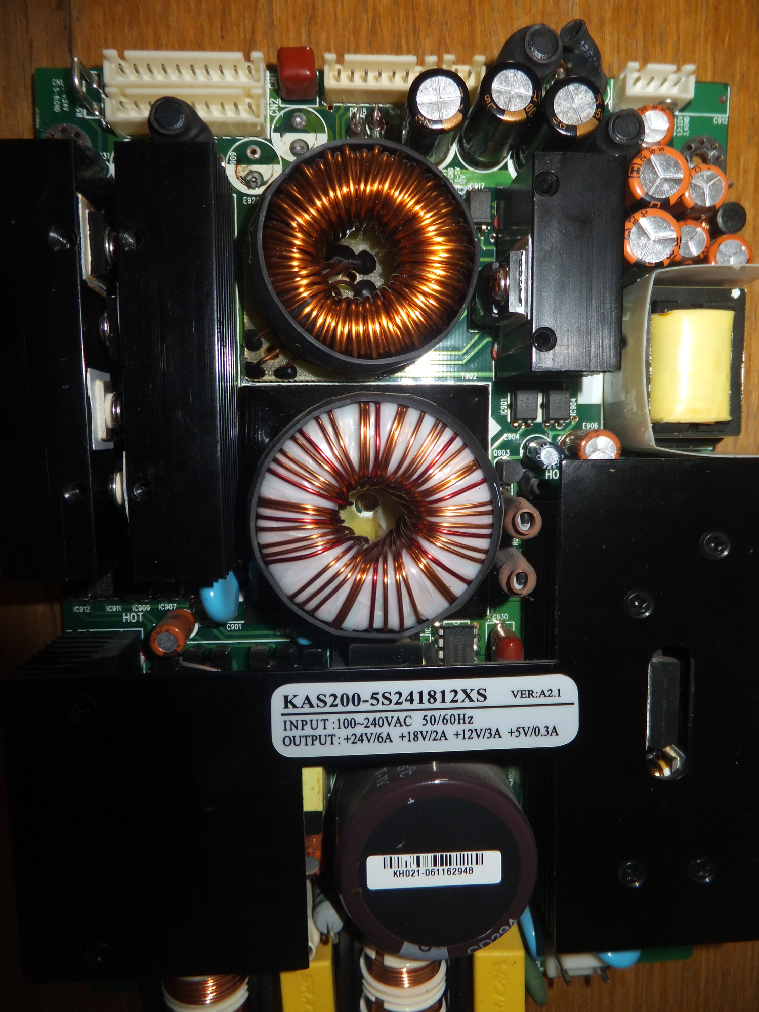

    A relative of mine has a 32" TV which is giving her problems, & I'm trying to help. The TV works perfectly for around 30 mins - 1 Hour & then vertical multicolored lines appear all over the screen, while the sound still plays fine.

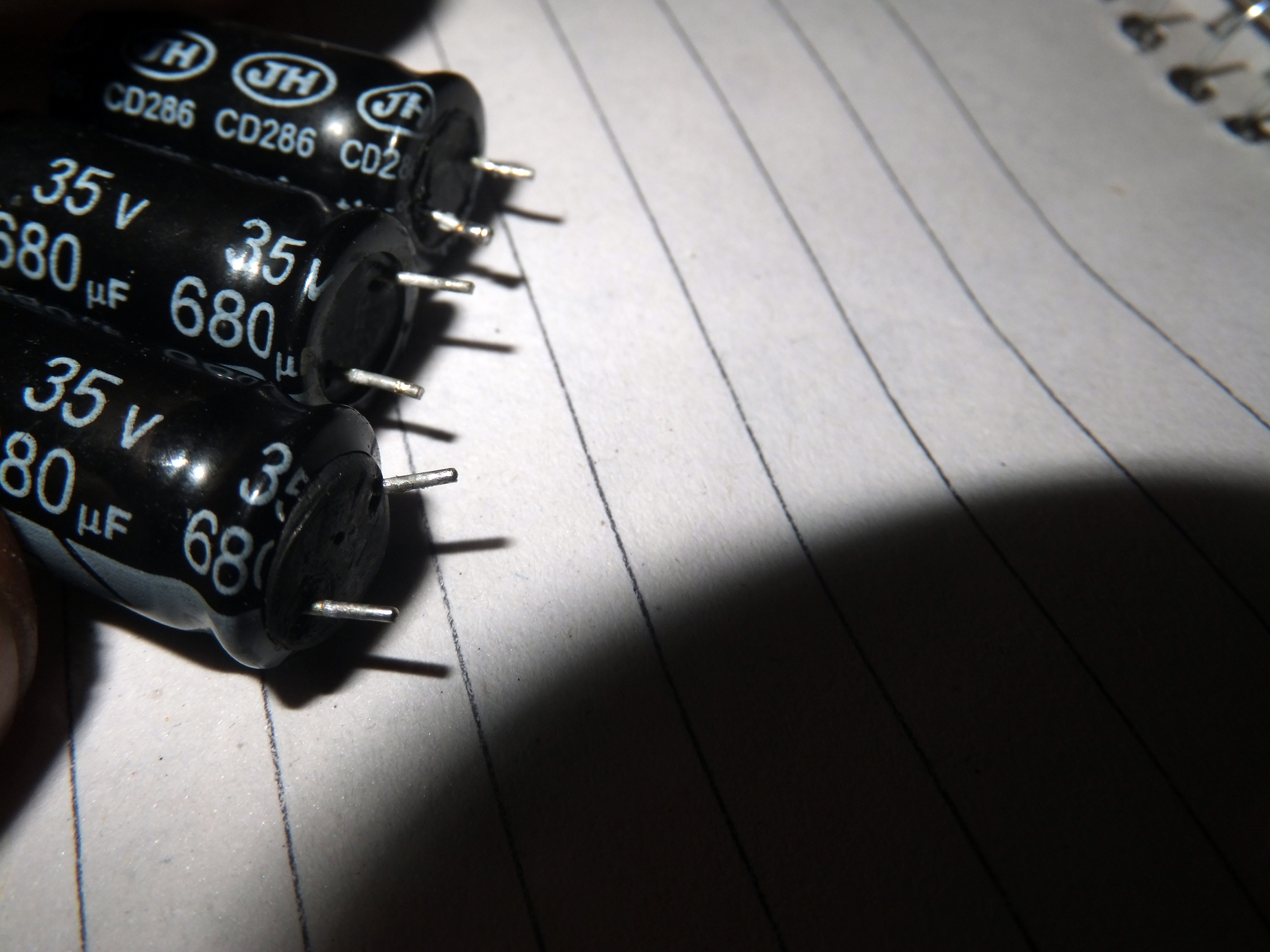

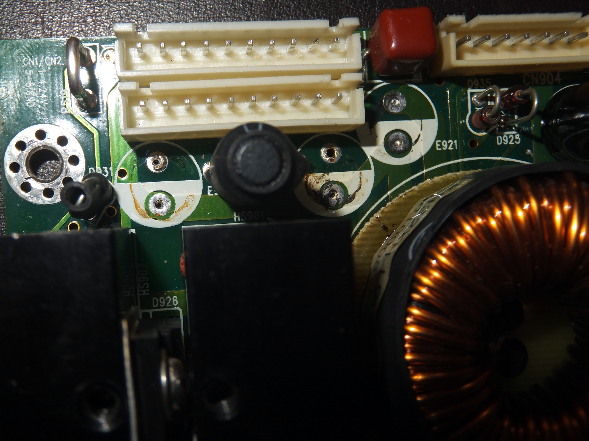

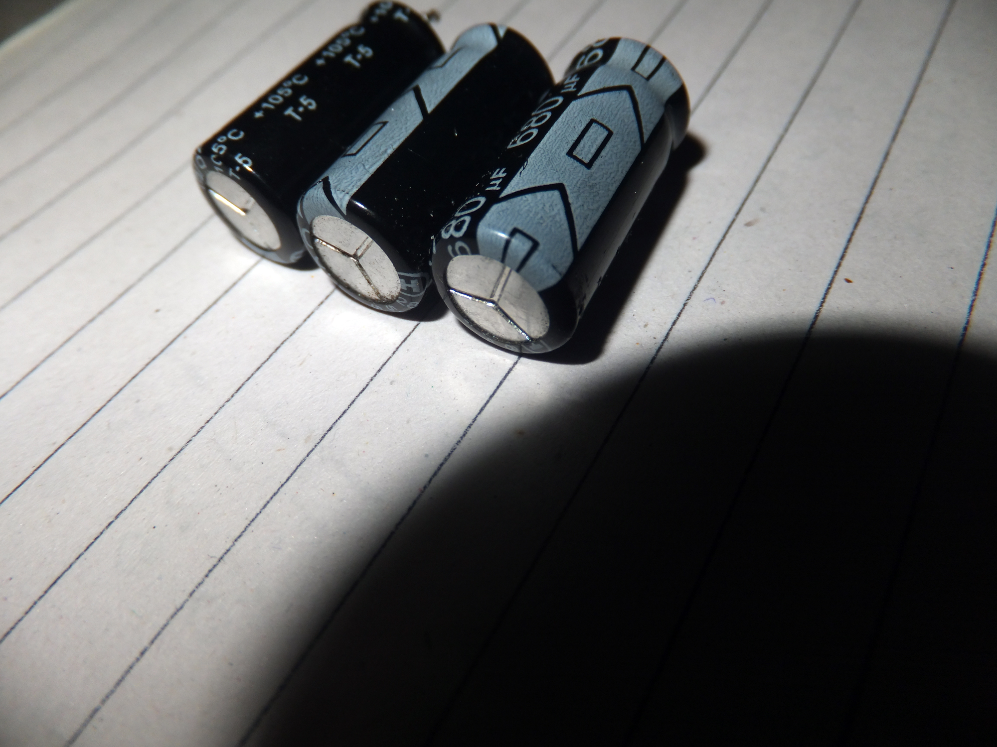

    I had a look at the Power supply board, & noticed 3 680uf 35V capacitors, one of which looked slightly bulged at the top & when I desoldered them I noticed the same one was bulging at the bottom also.
    The board itself also is stained where the 3 capacitors once were, I'm including HQ pics to show the caps in question & the board.
    My question is; Do you guys think I'm on the right track? & also; do you notice anything else wrong with the board, going from the photos? I can provide pics of the rest of the TV if needed.

    I have seen this problem before on the same PSU and probably the same TV. (Lexsor? Logik?)
    It is accelerated by the caps but it is also caused by the 5V supply for the T-con on the main board malfunctioning. This is a buck converter IC and it appears to fail as it is run very hot. It may be possible to replace it but it could be simpler to use a separate DC-DC board as I did. I used one for a model aircraft rated at 5V, 3A.

          Pics are great -thanks - Cant see anything obviously wrong in those - you will need to try and clean off any leakage from the caps. Just for the record what brand are the orange ones.

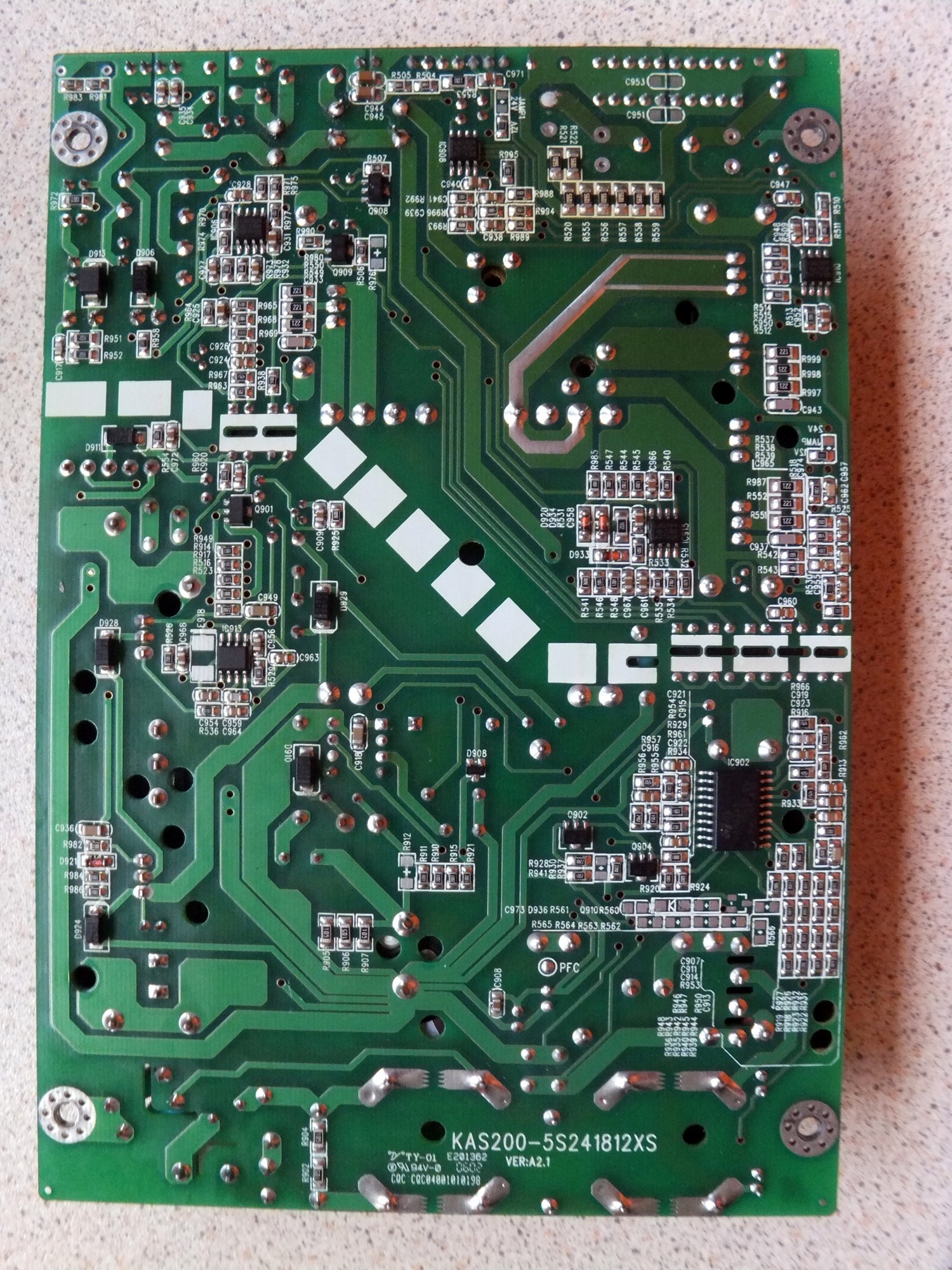

          One of the boards is numbered 782 l27w18 4000 which is an inputs board the same as in Lexor 27 and 32 inch
          Power supply is kas200-5s241812XS and is also used in lexor and polaroid. Hah just seen Tom66 was looking for schematics for this on ESI last September -( suspected failed toroid) remember that one Tom?
          If you post pics of the main board we will be able to point out the problem area mentioned by Tom.

              Hi you would need to take off the shield on the upper board to get to the DC-DC buck converter. It's on the righthand side. There are two of them. I think the lower one is the one that malfunctions.
              Caps may help, at any rate they are needed anyway to make it last.
              Selldoor I narrowed the fault down to the main board but the PSU developed another fault so it's sitting unused in the shed ready for parting out I suspect, not worth repairing anymore.

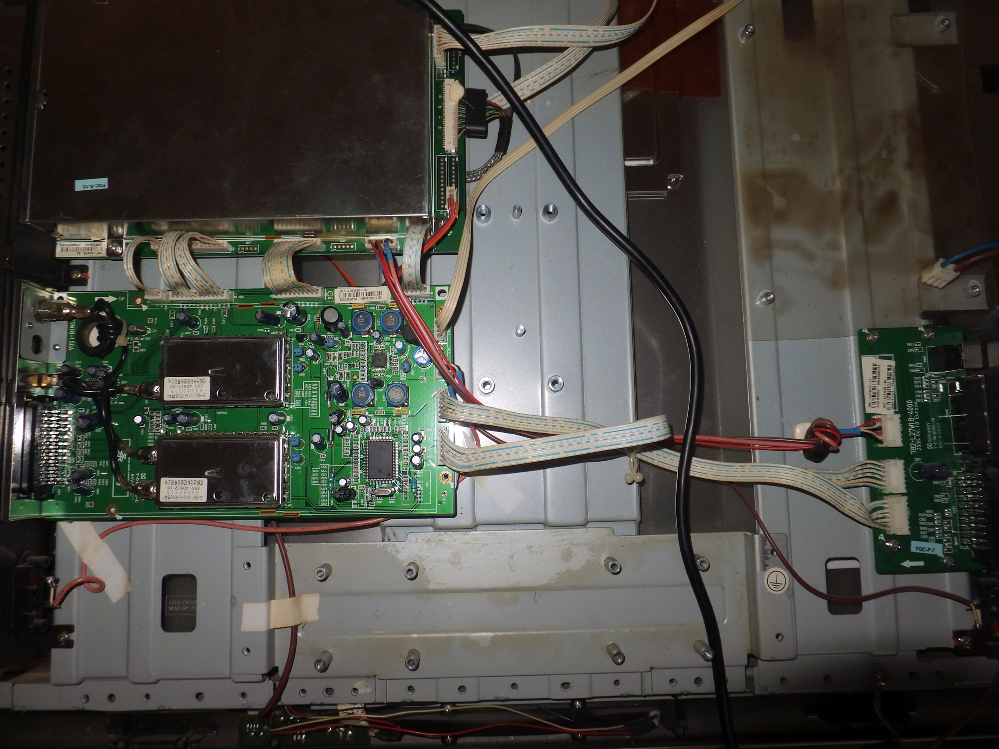

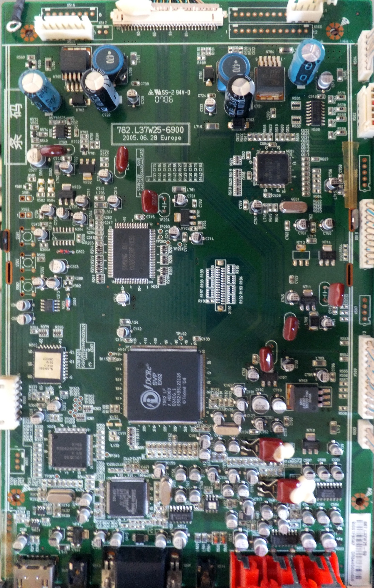

                OK, Thanks for bearing with me guys I'm back with the requested photo.
                My board isn't labeled "782 L27W18 4000", but is instead "782 L37W25 6900"
                & selldoor, the Orange caps say "JH" "CD263"
                Thanks for the help guys.

                    Re: help with 32" LCD TV
                    The devices with 470 written on them... the bottom one... check the voltage on both ends. When the voltage disappears you know this is the fault. The AOxxxx chip probably needs replacement but I just disabled it and used this: http://www.ebay.co.uk/itm/RC-3A-U-BE...item2560c9ea36
