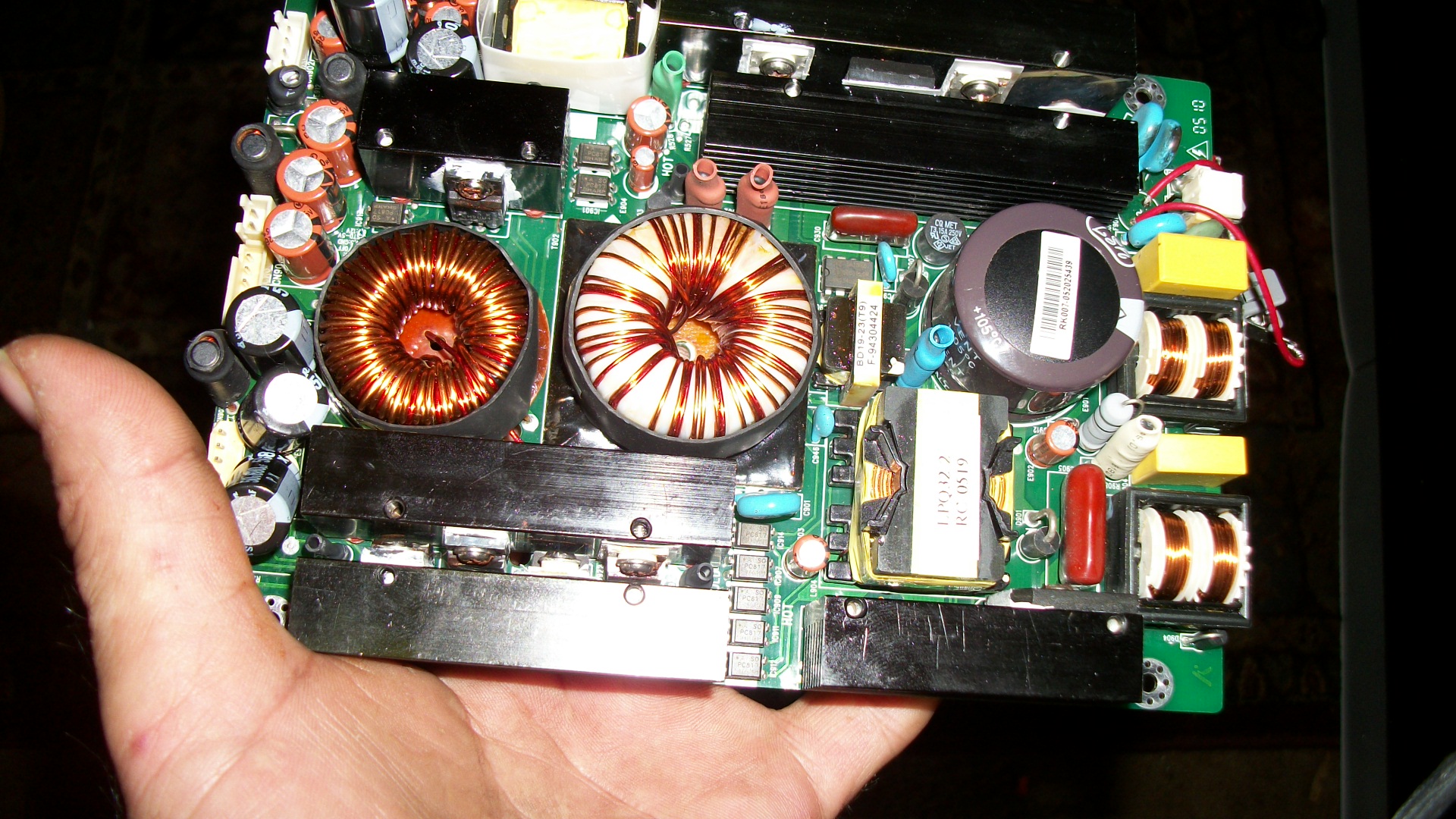

          pics wont upload it uses the Insignia 667-L32K5-20C Power Supply, cant find a schematic on it either. it was headed for the dump thought i may be able to save it. the previous owner tried to replace caps and made a mess, left the ps loose and it shorted across the maind took out fuse and protection diodes. if anybody has a print on this ps i would very much like to have a copy.i at least know the main and screen are good.

              trying to upload pics of the ps.

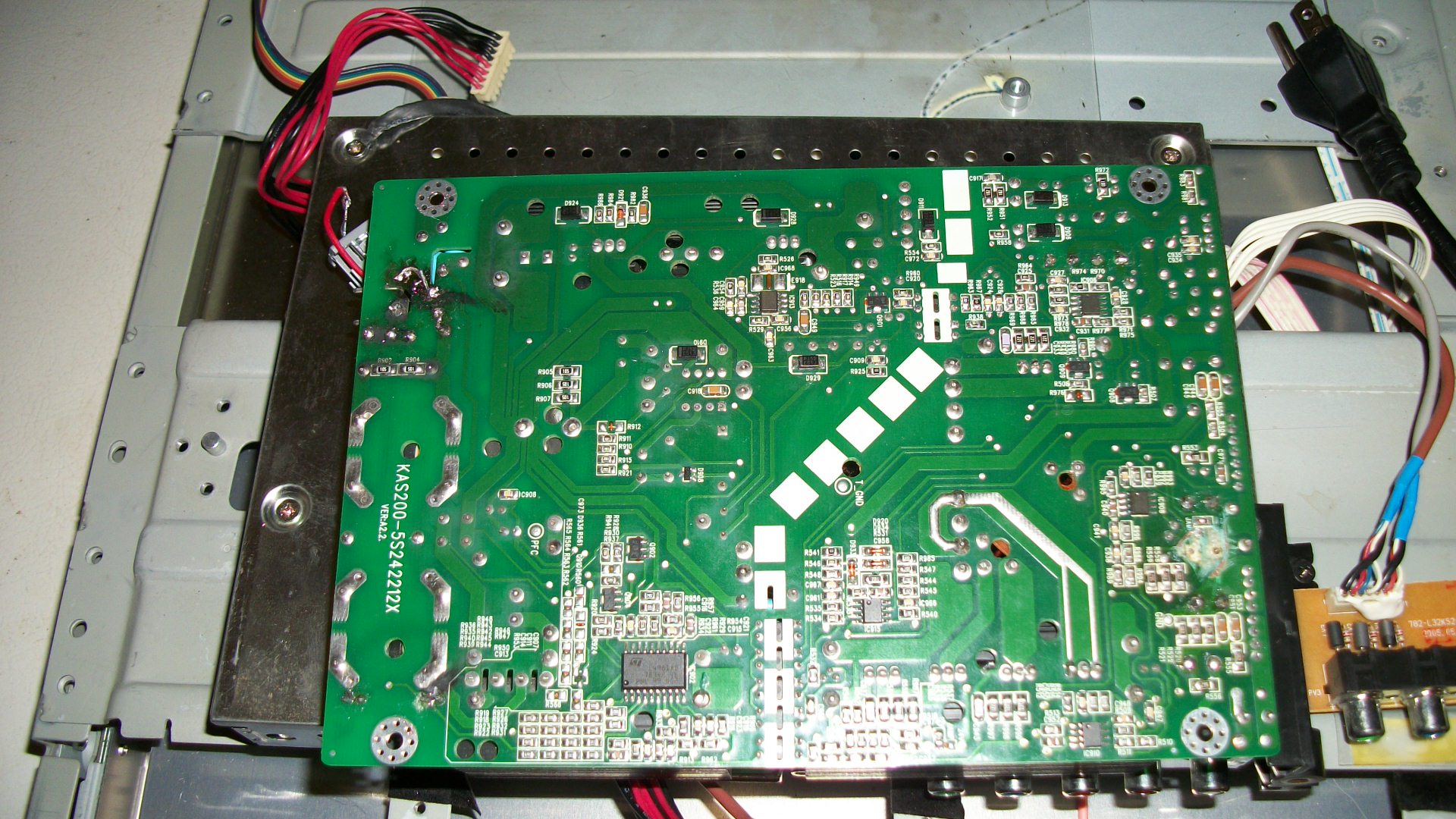

                Can we have pictures of fronts and backs of the other boards.

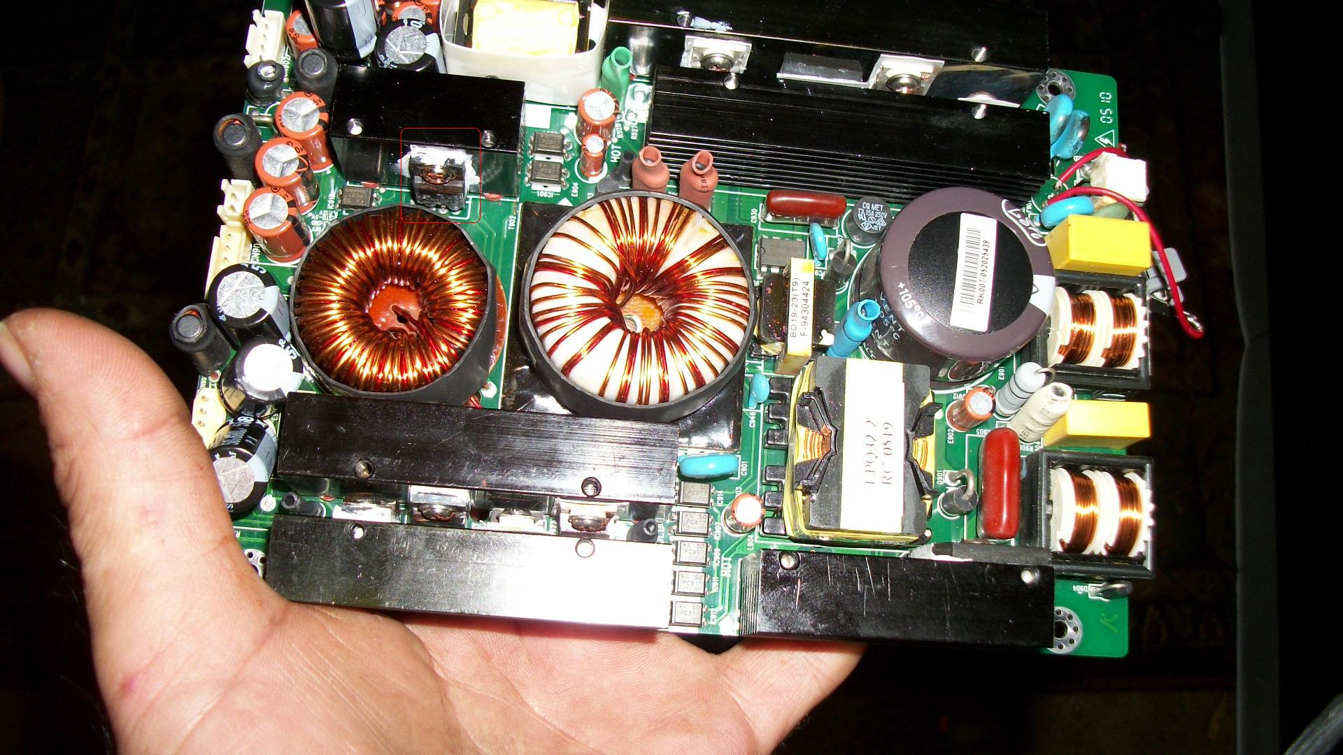

                On the picture attached the component in the red box appears to be cracked? Is it? - what is the part number?

                        nope the part is a 5 volt positive regulator and the 5v is stable. the crack is not a crack it is a bit of loctite that was a factory dribble. something on the 24 v rail, i have checked diodes , resistors and the fets. dont know but i am loosing 7 volts somewhere.

                          What voltage do you get across the main big cap?
                          • awyatt2
                            • Feb 2012
                            • 407
                            • america
                            Re: polaroid flm3201
                            166v across main.at the 3 fets there are 2 diodes, marked 24v, at the end of the string on the diode i get 23.98v. if i only had a print to work backwards. the blooming board is double sided and you cannot see all the traces for components.
                              This should be 375 - 425V and is probably the cause of low voltages.
                              Check if there are any small orange electrolytic capacitors on the primary side, if so, try replacing them. They can cause this problem.

                                well, tom, you were right on the small 22uf 50v cap high esr, but no change when replaced still 166 across the main and 17.88v to the inverter. i have all the other voltages, still trying to figure this one out. thanks i wouldnt have looked if you hadn't mentioned it. look at it as a problem wating to happen if not addressed.

                                  Tom, you led me down the right path, a shorted smd diode. now she works agian and i have to get it all back together. thanks man, i was looking on the wrong side for the problem,would have ended up junking it were it not for your insight on the input side. all is well here now and i can tell my daughter she has a lcd tv agian. i fixed her a proj rca for temp now she has a flatpanel.thanks to all, especially Tom!
                                    Good job, another failed PFC Voltage booster circuits. By the way, can you please post the pictures of the Diode and its location?
