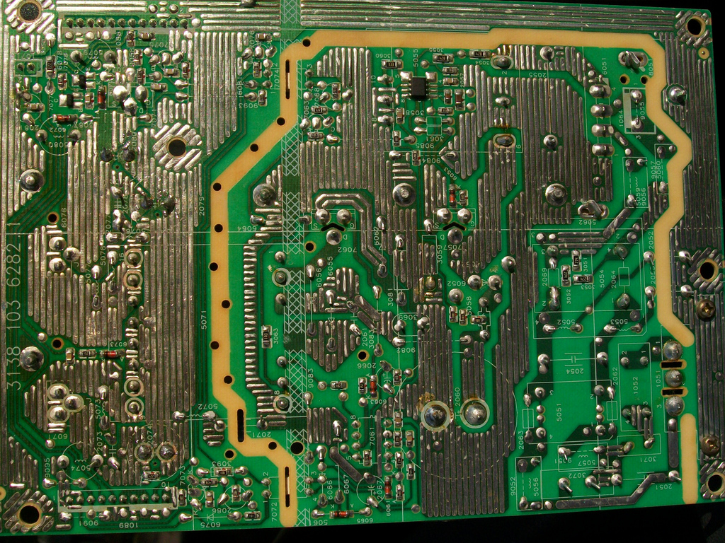

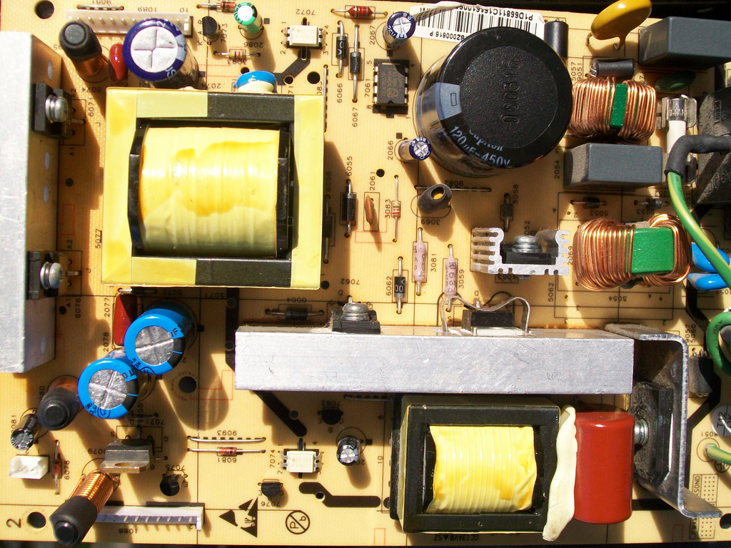

Ah, yes I forgot to mention I measured that too. It's 2066 right? That's 0.02v and yes I put black on -, red on +
On the edge of the board, cap 2067 reads 8.1~11.3v (it's connected to pin 1 on the SMPS IC).
The HQ photos are attached.
If you mean probe closer, I did that too
Actually, when I press harder on the probes, it [the big cap]seems to stay at 160.1v for a few seconds longer... so maybe that's not a big deal.
There's greater fluctuation on the 24v rail, and even the 16v shows 15~16.5v, but interestingly enough, at the plug, and at the 2074 (capacitor) it's a steady 16.3v like it always has been, so that cap is doing a good job, but the new panasonic FMs are acting weird. 22~24v across both of them, and I know I soldered them properly, this isn't my my first recapping. I do mostly motherboards, and this will be my 4th TV recapping.
Edit Note: I will probably have to replace 6076 and 6071. They are the VR ICs for the 24v and 16v respectively. However, I'm still not getting 5V at the plug, and that's important since it turns on the mainboard.
If you trace pin 10 (5vsb) of the mainboard plug (lower-left on the solder-side photo). You will end up at the little white IC at 7074, which is right on top of the HOT/COLD line.
I measured pins 3 an 4 on the HOT side, and they are fluctuating between 10~12v.
Pins 1 and 2 on the COLD side are 00.0v -- is that normal?
That doesn't have anything to do with the startup cap.
