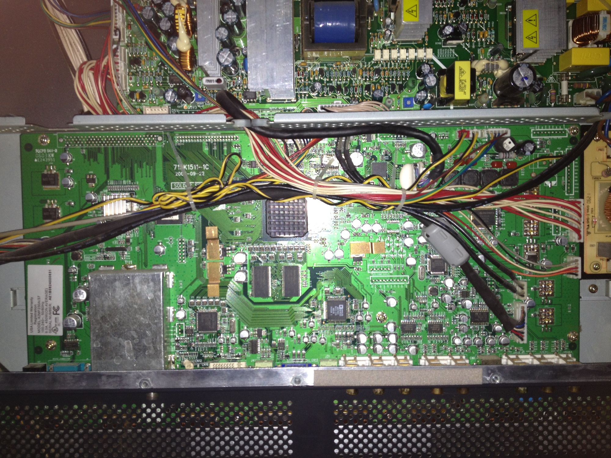

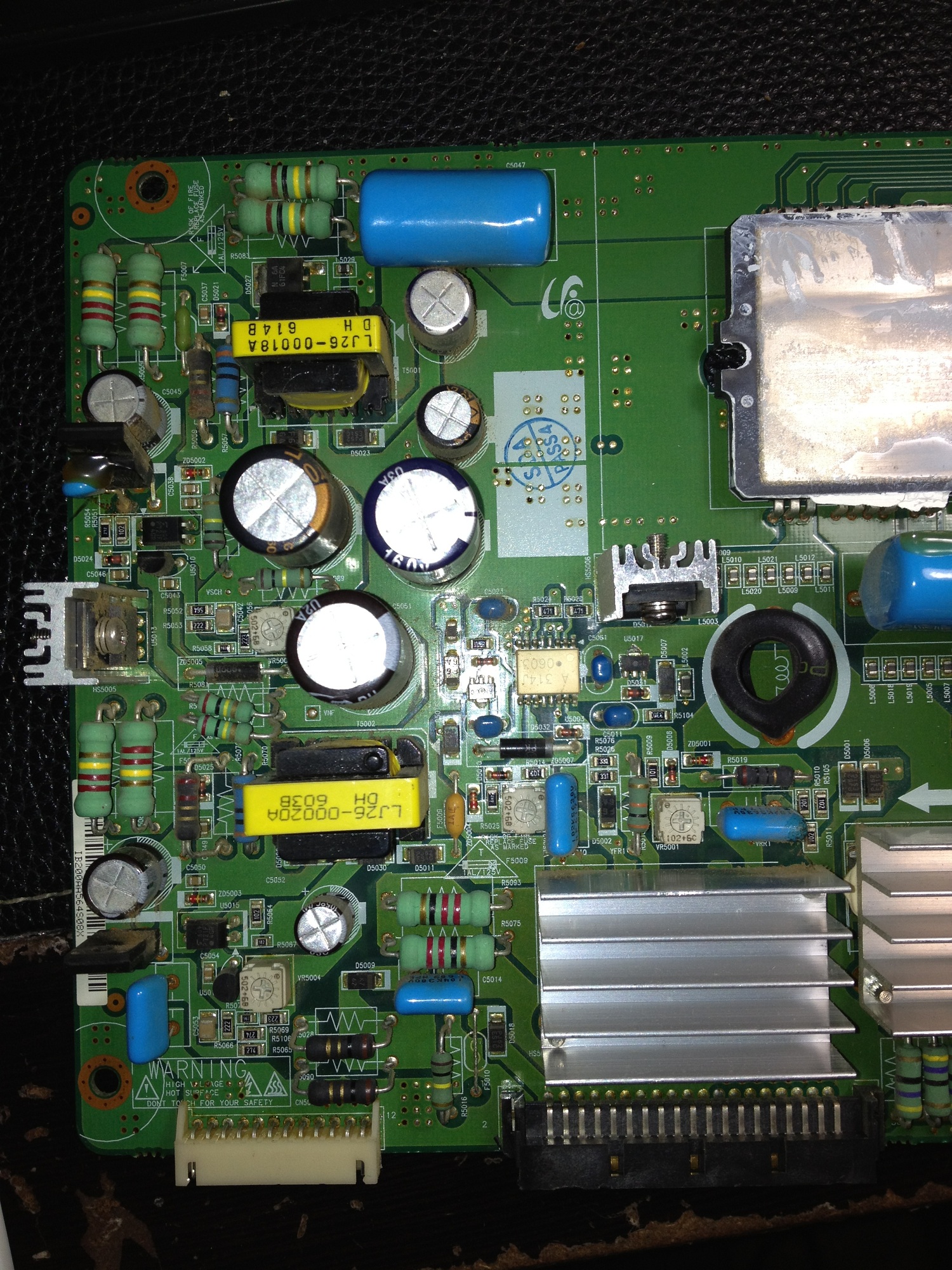

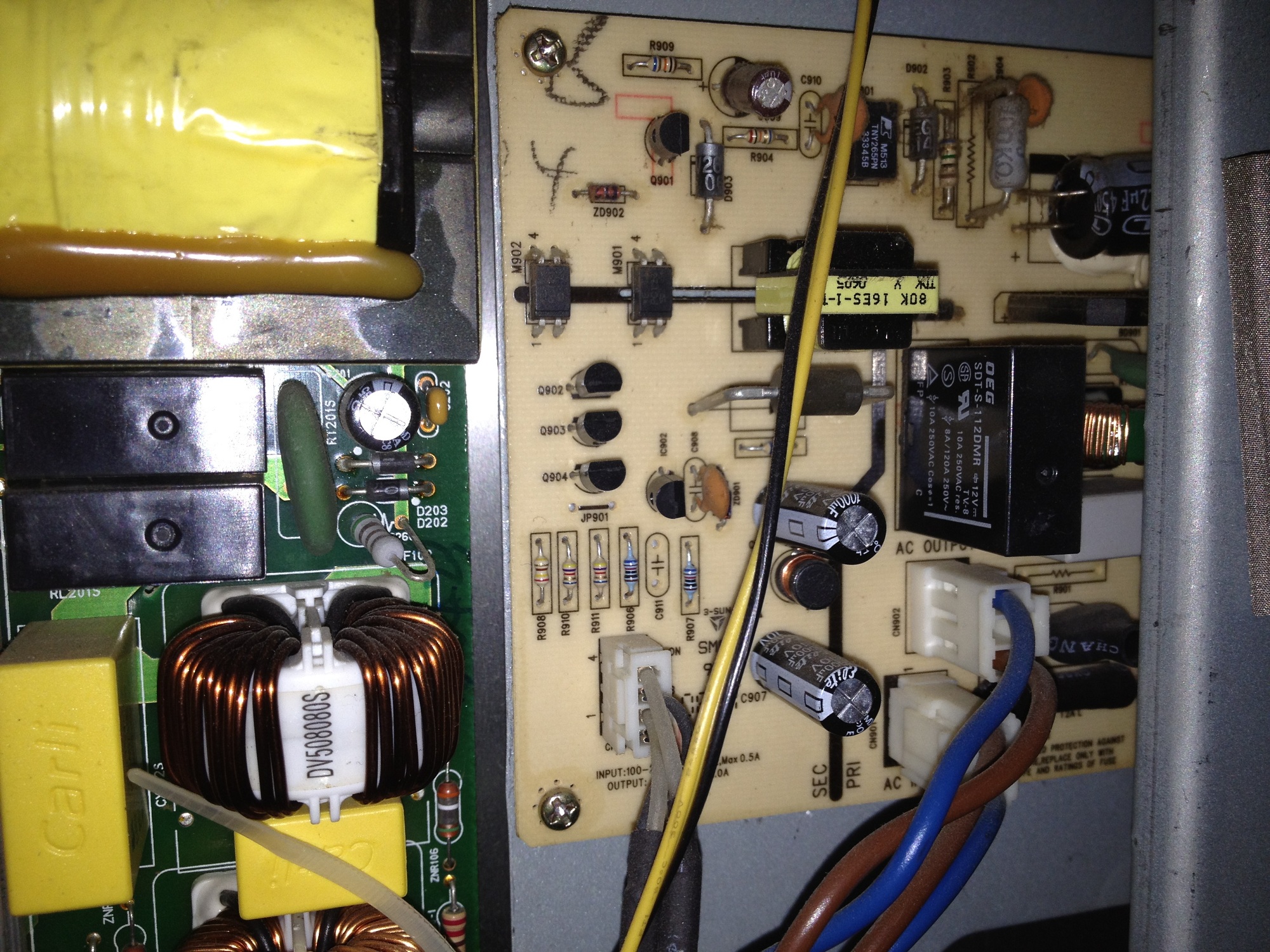

              Alright so I got the TV. The previous owner said that it wouldn't turn on, but after clicking the power a few times got the picture showed up one, but then soon after it wouldn't turn on again. Does it sound like a capacitor problem? I opened it up but see no bulging or blown capacitors. So now I'm lost ;(
              The first thing I noticed as soon as i plugged in the panel, the red power LED turned on. Seems strange to me that the light would always stay on even with the TV off. I can't seem to turn it off either, pressing all the buttons.
              I press the power button and hear the relay click and the red light turns blue, however nothing on the screen turns on. Pressing the power button again turns the blue light back to red.
              Any help would be appreciated! I have small to moderate knowledge of circuits though. Thanks! I uploaded pictures of the boards in the panel, if you need more close ups i'll be glad to include them!

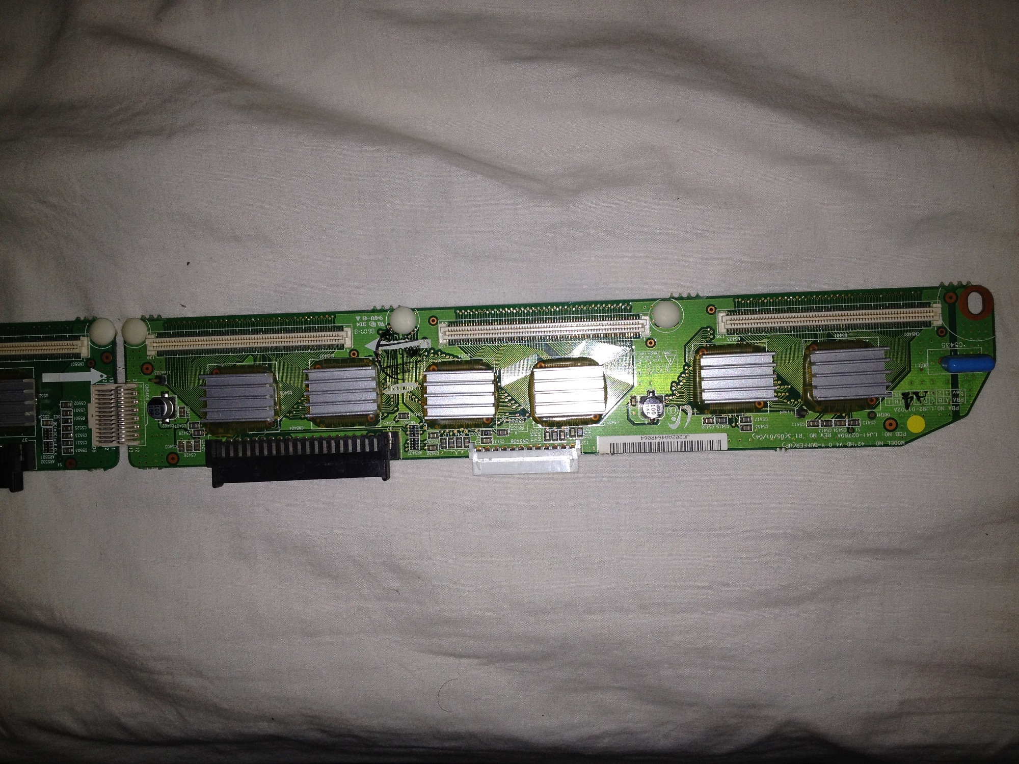

                the picture is clear?
                The heatsinks on the buffer boards are hot or warm?
                • XtraETN
                  • Mar 2012
                  • 12

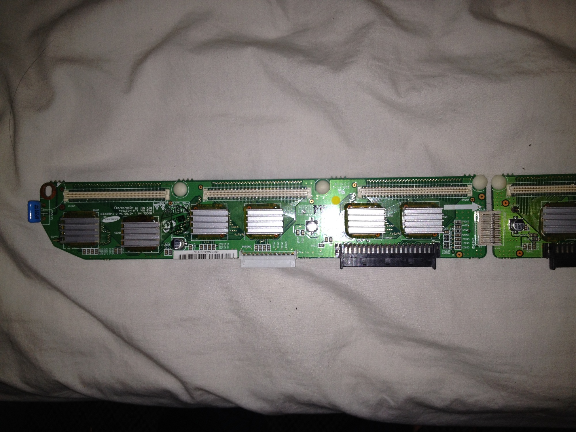

                  Re: Magnavox 42MF230A No Picture, Model info?

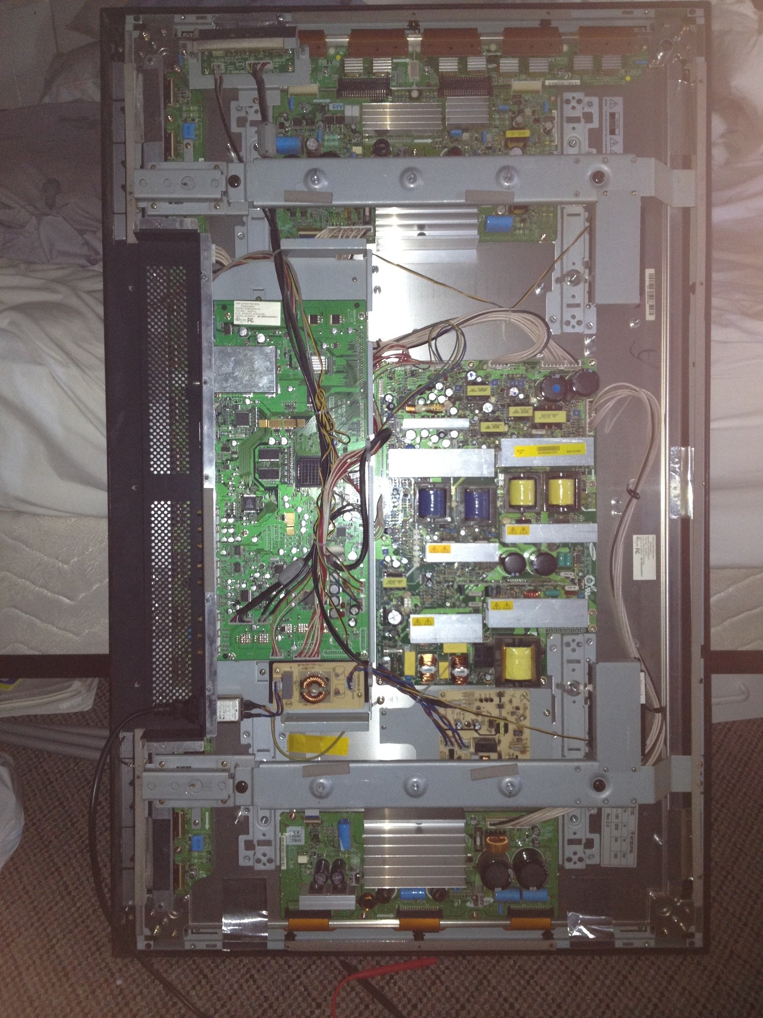

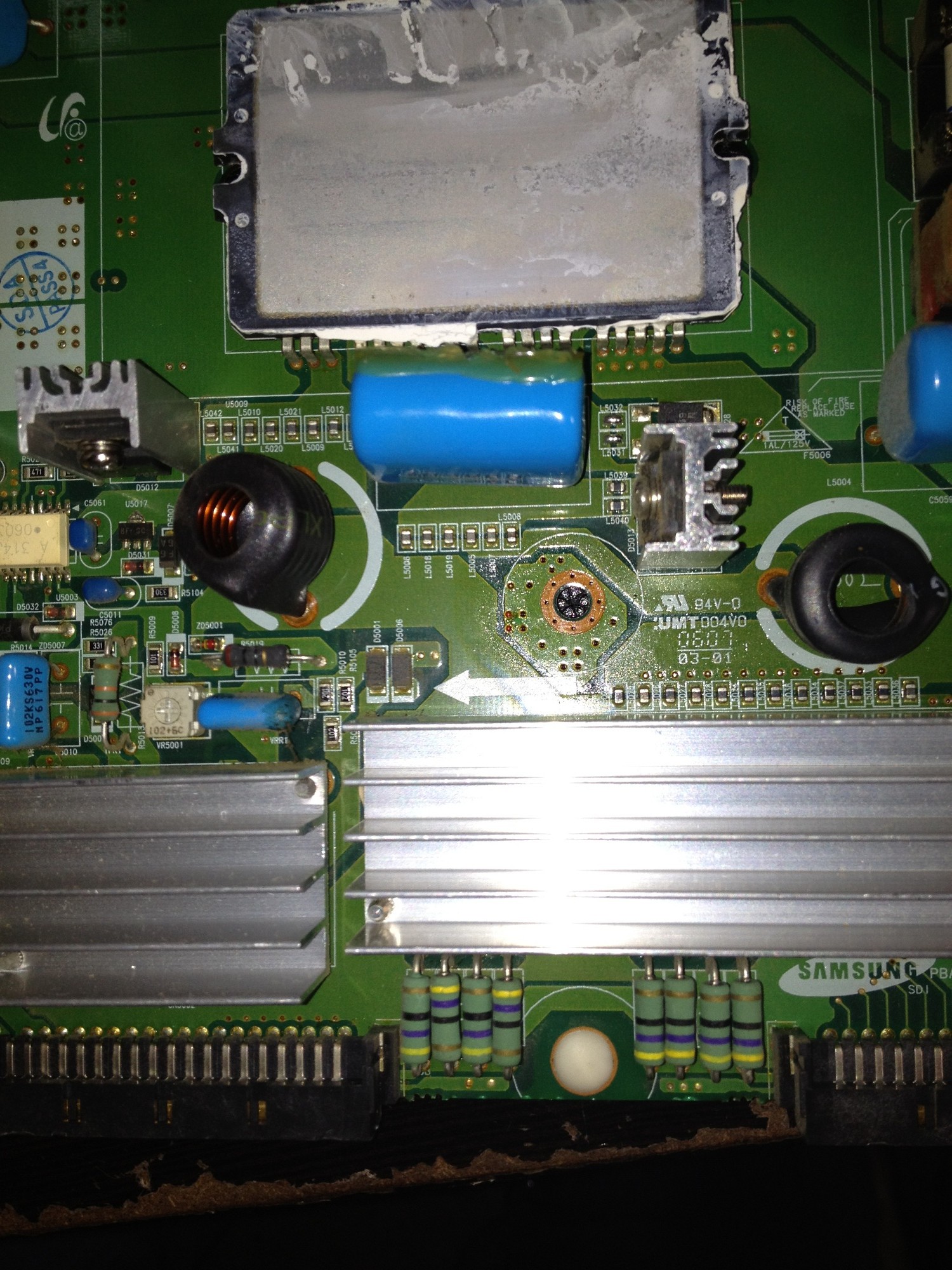

                  when you say the buffer boards do you mean the board in picture 3? If so, then yes after leaving on the panel for a few minutes (blue LED on), the bigger heat sinks seems very hot.

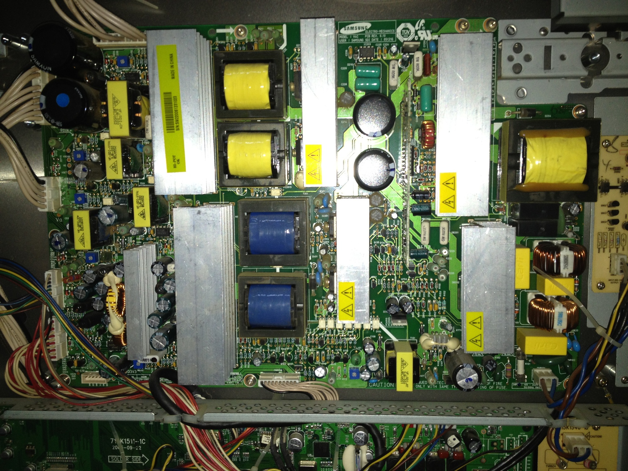

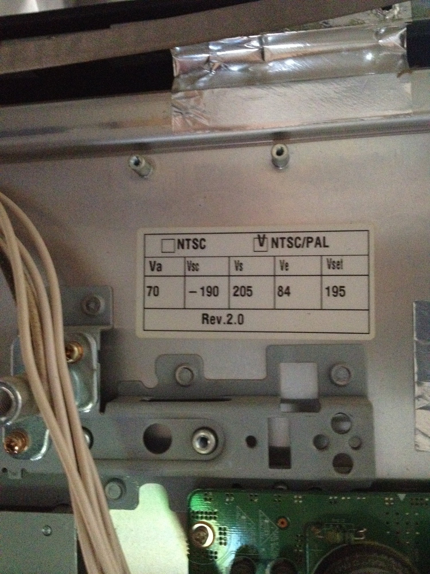

                    I measured the output voltages from the power supply and got
                    Va = 71V
                    Vscan = Negative Oscillating between 0 -180?
                    Vs = 206
                    Ve = 84.7V
                    Vset = oscillating between 198.0 - 198.3
                    All the voltages look good except for Vscan.
                    Is Vsc the same as Vscan?
                    What would this voltage oscillation mean? Would it still lead to a burnt IPM on the Y-Sustain board?
                    Touching the heat sinks, they seem very hot. However I didn't touch the largest one yet (not shown in any of my photos) that was under the panel holder bar so not sure about that one. It was a pain trying to remove the Y-sus board an I don't want to place it back yet in risk of damaging those ribbon cables leading to the screen I think.
                      the six little ones on each board(total 12) on the third picture. there is an upper and a lower Y buffer board. Each controls half the screen.
                      • XtraETN
                        • Mar 2012
                        • 12
                        yes the ones on the buffer board did also feel hot to the touch.
                        • tibimakai
                          • Jan 2012
                          • 3680
                          When I changed the buffer board on two previous 42" philips TVs the little heatsinks were almost cold.
                                In my beginner opinion, if do you fill hot heat sinks on those two boards, you need to replace them.
                                Then you can have the Y sus board bad too.
                                On my TVs that I have repaired I had picture all the time, there were some pinkish staticy horizontal lines, so the buffer chips were not shorted yet.
                                If you don't have picture, then most likely you have shorted buffer chips and they may have damaged the Y sus board too. Usually it's recommended to replace all three together. Read on that connel site about this. There is a guy on Youtube showing how to replace these chips. Not easy, I have tried it.

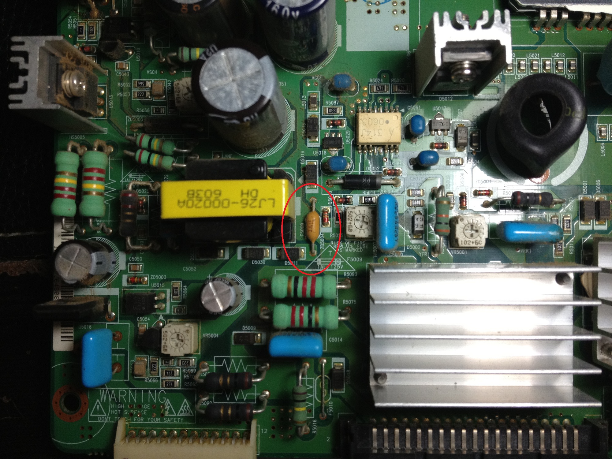

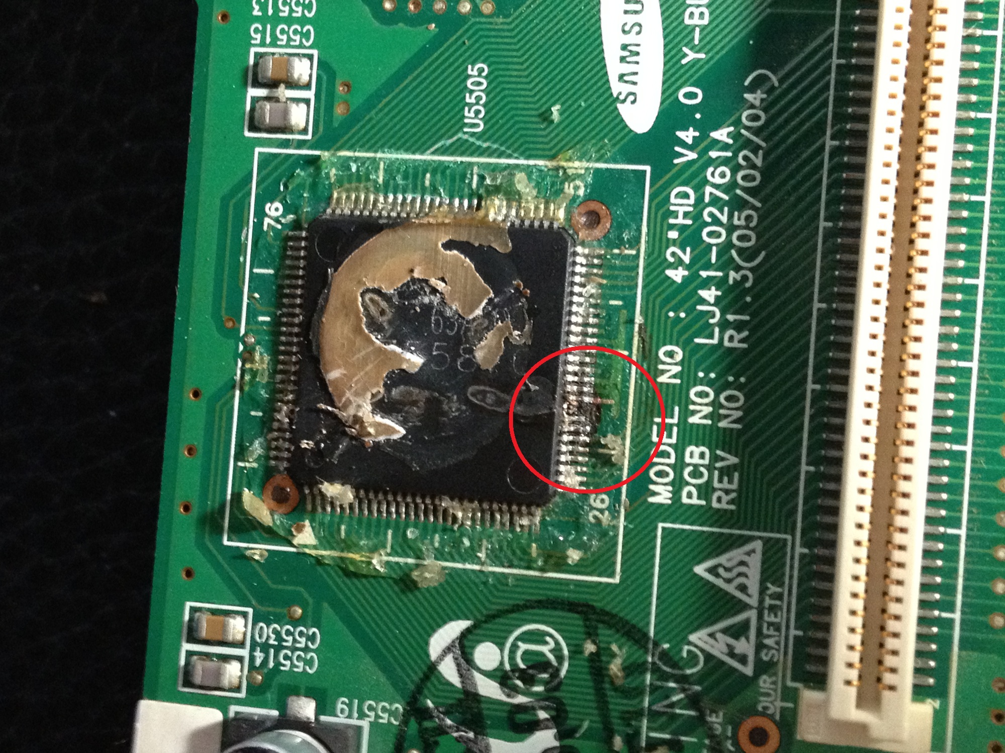

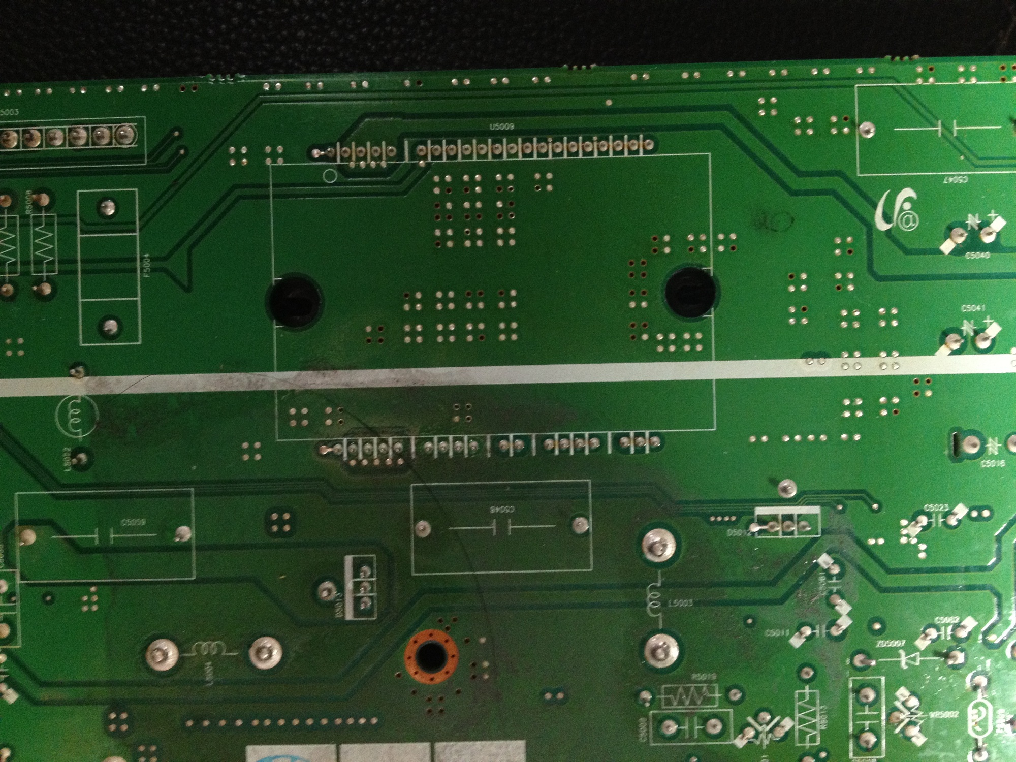

                                  Well I found the burned out IC chip on the Lower buffer board left with alot of burnt residue on the top of it.
                                  I tested that Top buffer board and there seems to be no shortages and its still working, I'm guessing.
                                  I don't think replacing the IC now is an option since it looks burnt through the pcb. So now the only option is to replace the Lower board.
                                  Question now, is there a problem with the Y-main board which would of caused the burned IC? and what should I test for to check that the Y-main is still working.
                                  Is there a way to test the main chip on the Y-main?
                                  I'm also currently testing for shorted resistors, diodes, and other components.

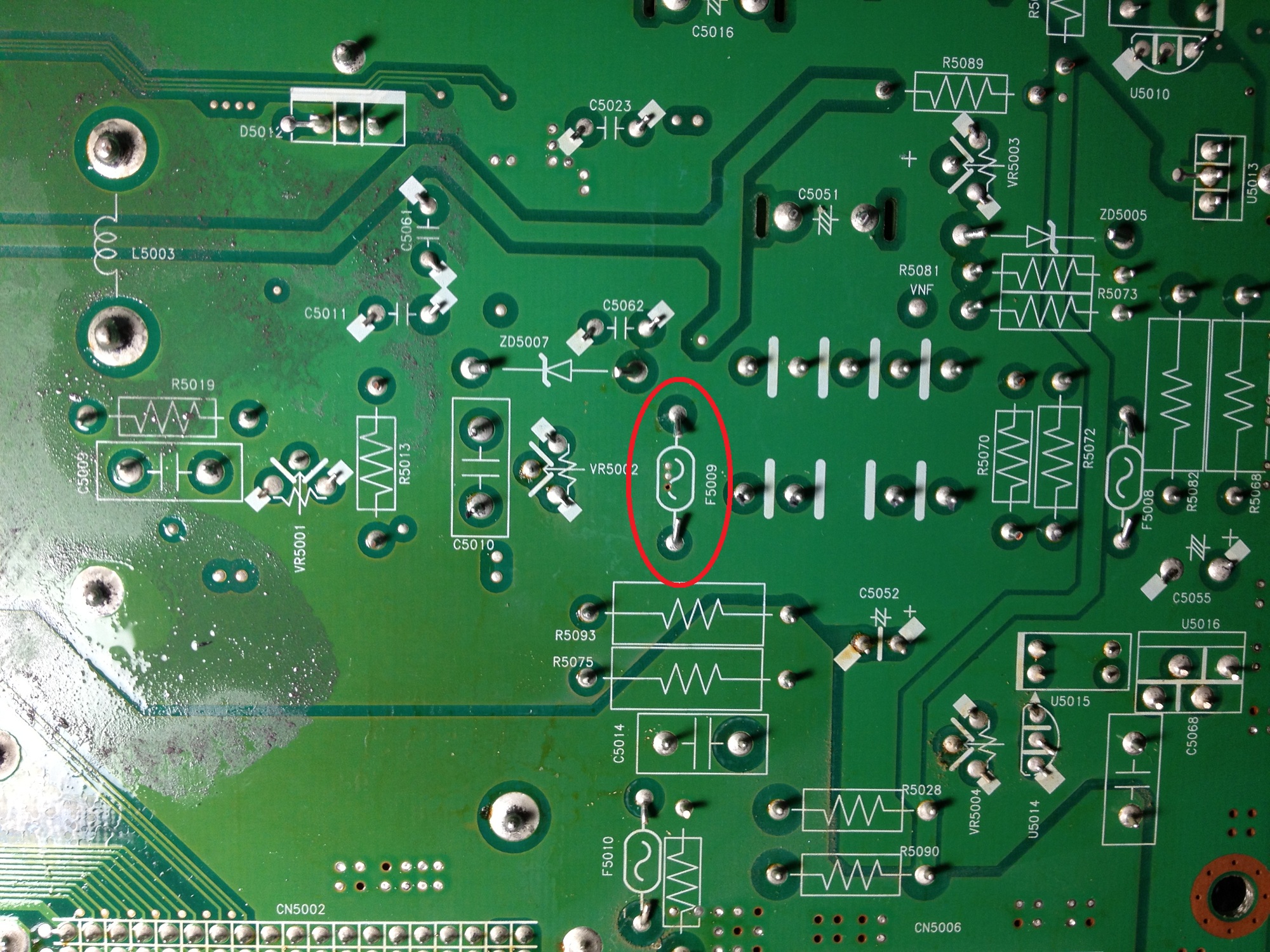

                                  I found one opened fused in the photo shown below. Anyone know what component could of caused this blown fuse?

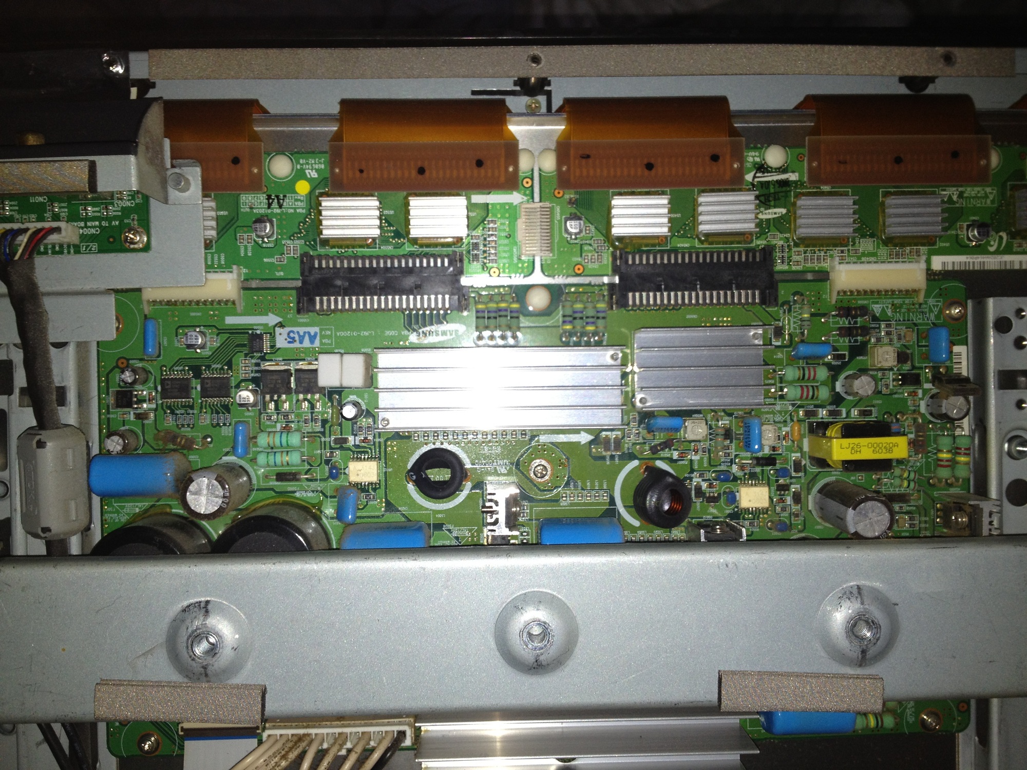

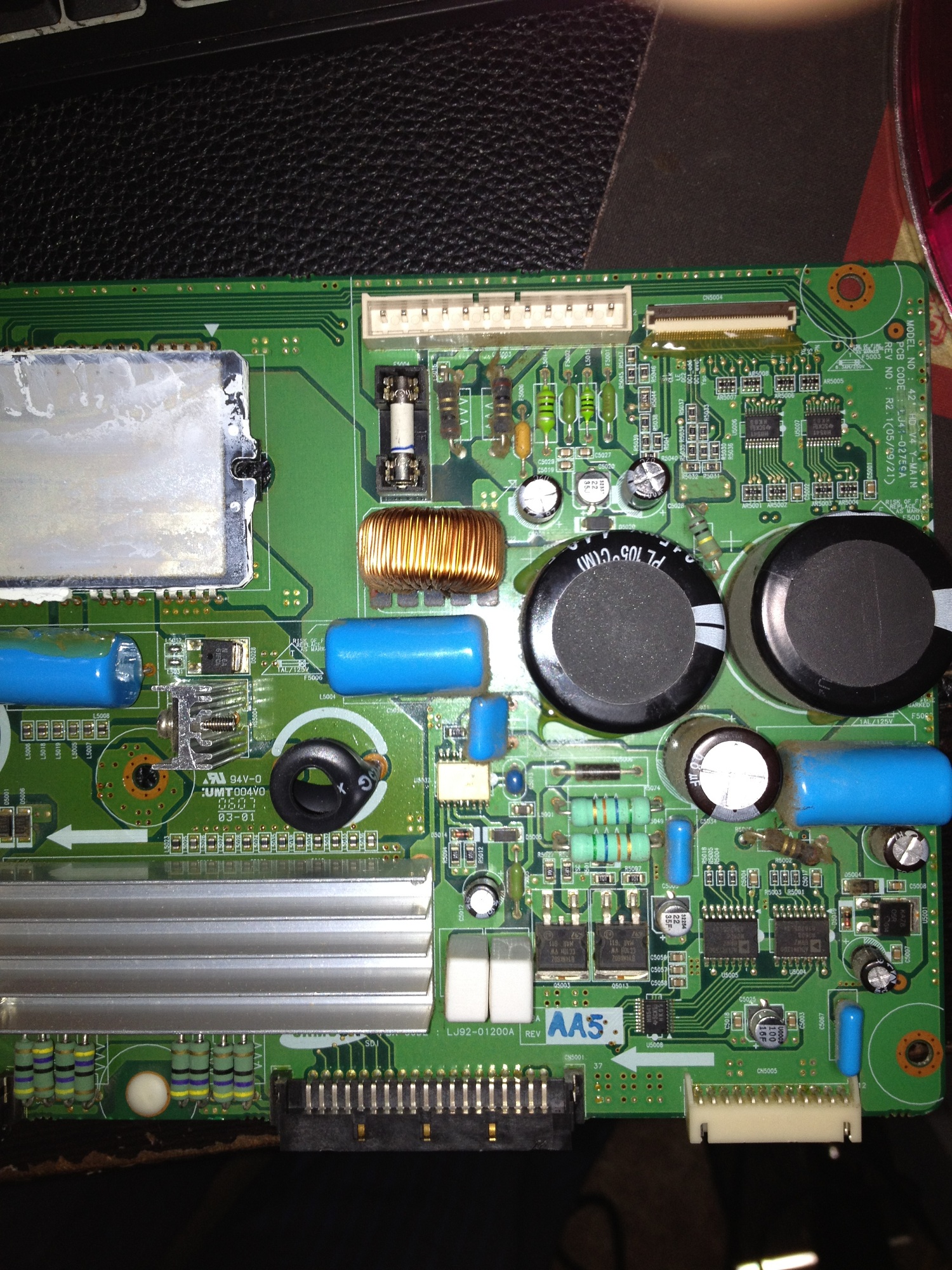

                                      Heres pictures of the Y-sus board.
                                      I meant to say the open fuse I found in the previous post was on the Y-main board.
                                      How do you test a fet and transistor?
                                      I don't see any blown/bulging capacitors, still testing a few resistors. Diodes seem to be fine. A found the big chip under the giant heatsink for about 10-20$ on ebay so should be easy to replace. But is there a way to check it if it is shorted?
