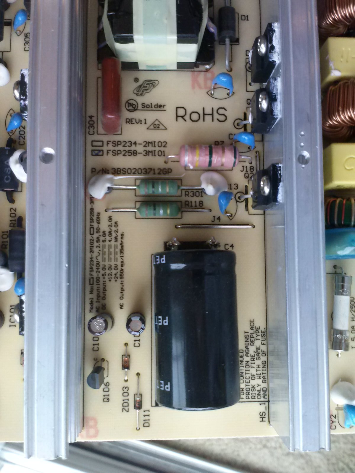

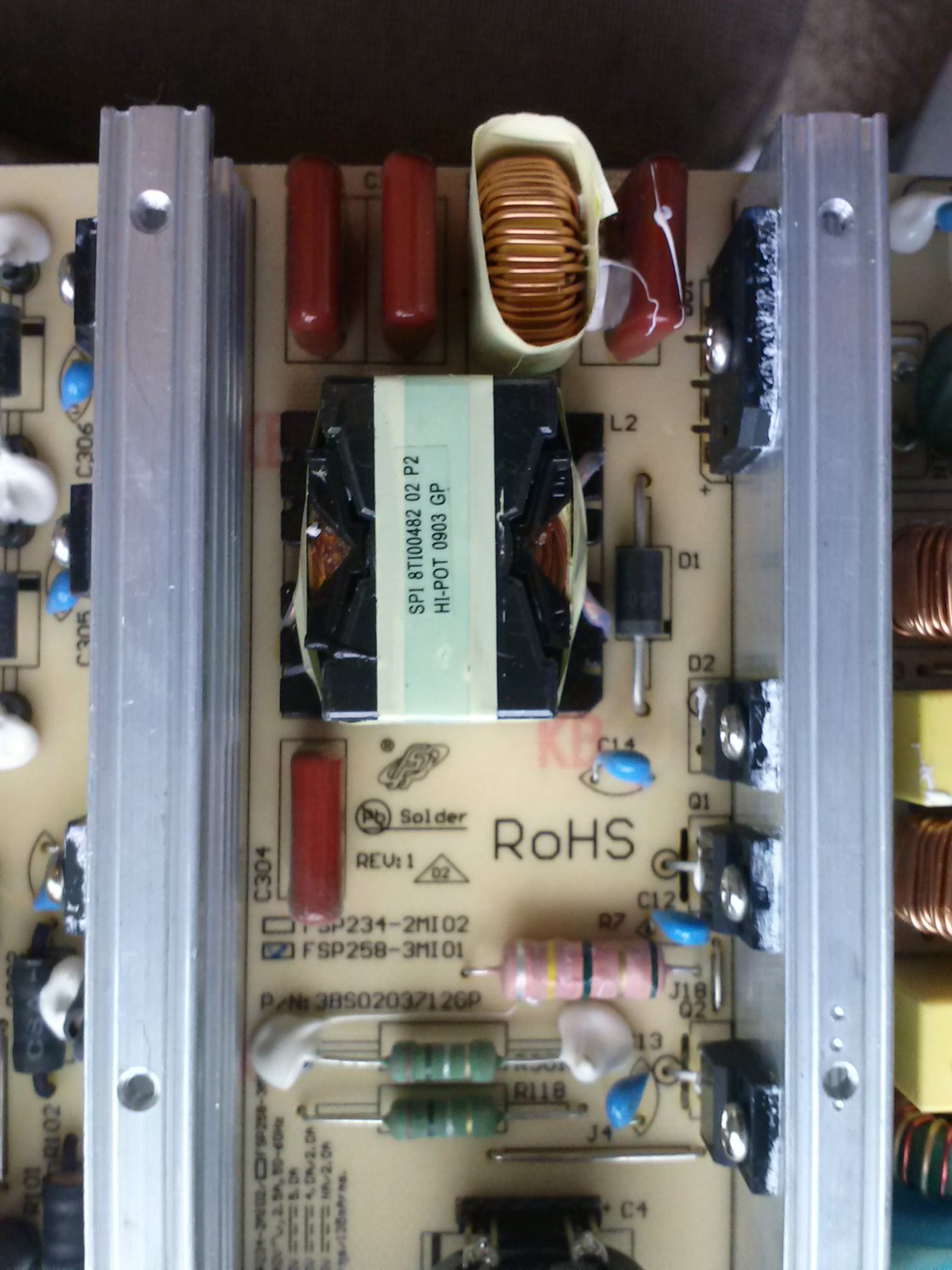

        OK, the ballast caps seems to be OK (but do not that is 100% true since they may break down when exposed to 2000v), next thing I need to do is to look at the Inverter connections and see how the components are connected together.
        Right now I need you to remove that flat aluminum heat sink on the power supply board to see what are underneath. One you have it remove, please make DC voltage reading on the two legs of that large main DC filter cap when TV is OFF (should be around 170Vdc) and when TV is ON (should be around 380~400Vdc). I want to make sure that the PFC is working or not, PLEASE BE REAL CAREFUL, YOU ARE WORKING ON THE HOT SIDE, DO NOT TOUCH THEM WITH YOUR HANDS, AND PLEASE DO NOT SLIP THE PROBES!

          I will pull the plate off and take pictures tonight. Along with taking those readings.

            Ok here are the uploaded pics under the heat sink. The readings are as follows plugged in 164 Vdc and after the power was turned on 391Vdc
            Is it normal for those rails to have a charge? I used the positive probe on a screw and then negative on the left rail and with the TV off its 60.3Vdc and with the TV on its 56.4Vdc. Is this normal?

                Re: Vizio SV420XVT1A LCD 2 Seconds to Black

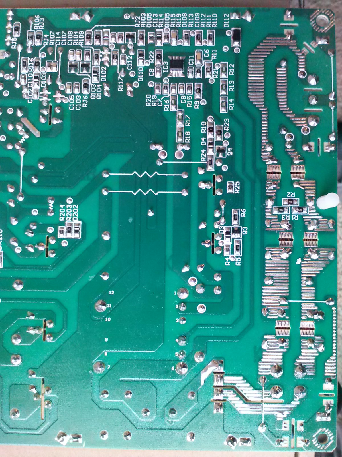

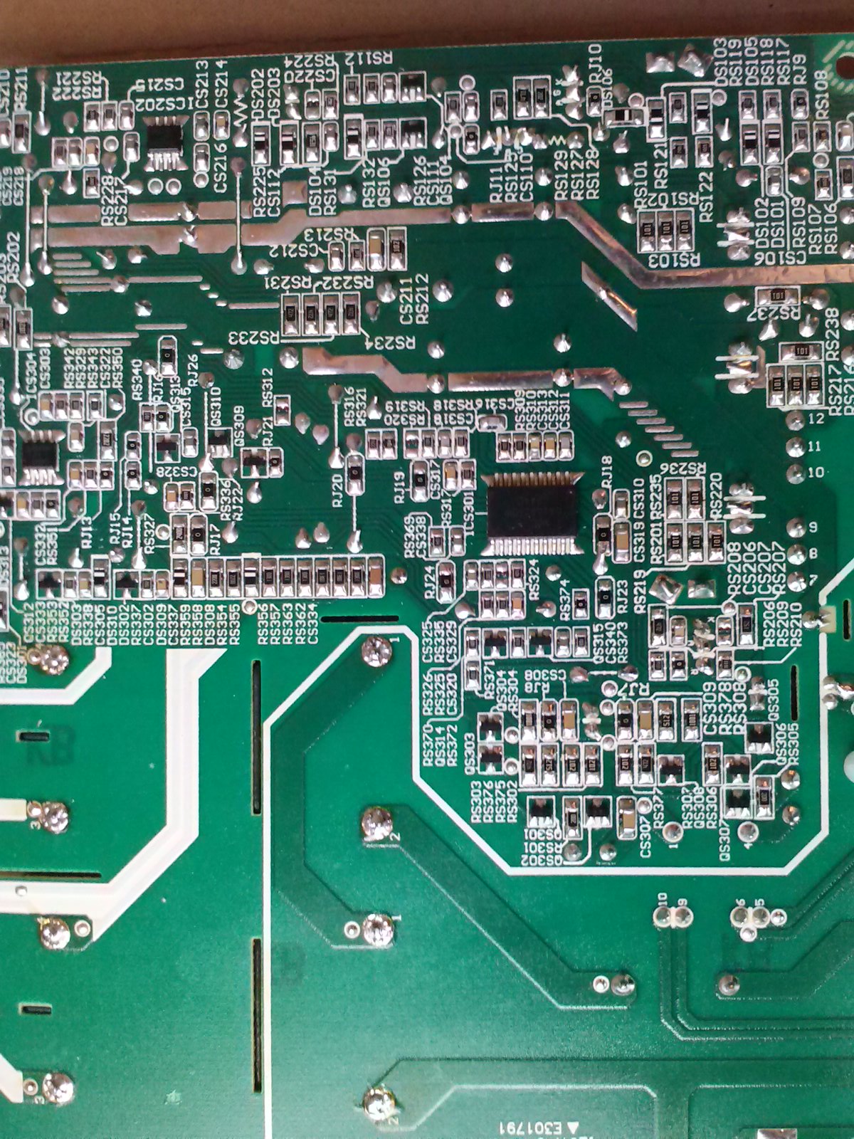

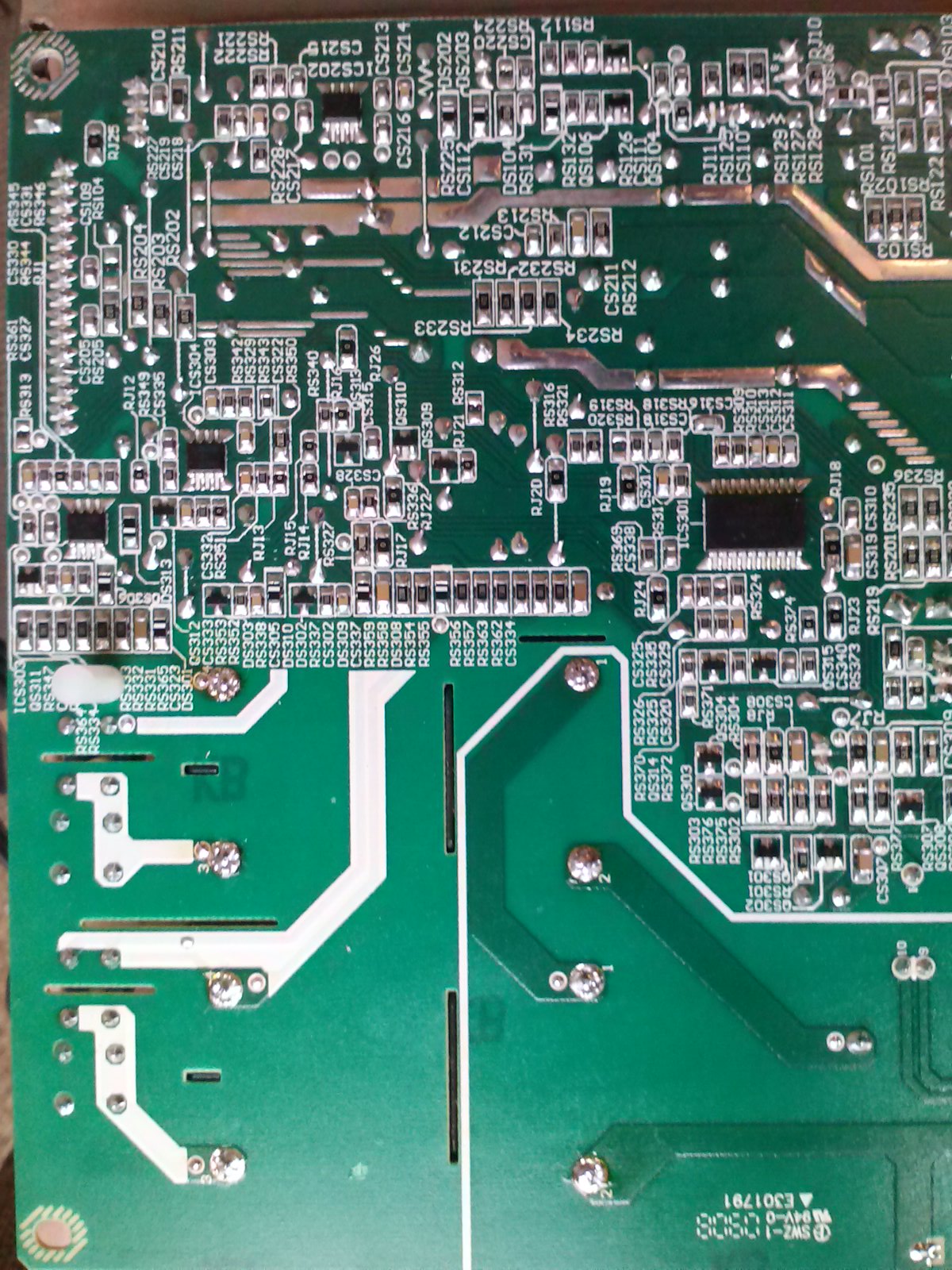

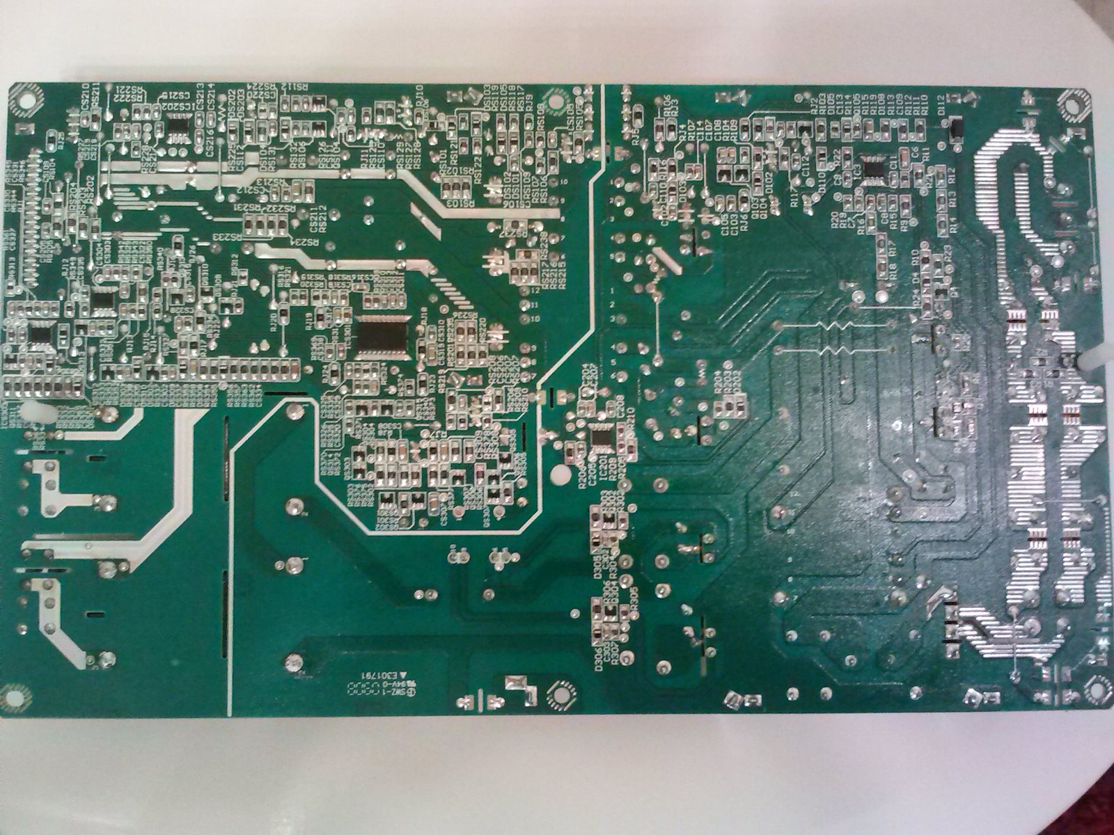

                That 391Vdc is good. You cannot use the chassis as part of the Voltage measurement in the Primary side. The Negative leg of the large cap is the circuit ground for the primary side.

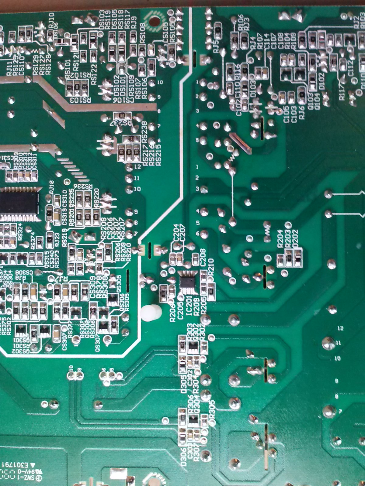

                Can I get the picture of the whole bottom side of the power supply board? I am having a hard time seeing the MOSFET's and the IC that drive the Inverter transformer.

                  Here are the photos of the bottomside of the power board. If you need better pics let me know. Photos are uploaded from left to right in order when the board is flipped

                    #49
                    Full bottom image of power board

                      #50
                      I already have those same 4 pictures you post #14, I will wait for the full view of the bottom side of the power supply bd.
                        uploaded image is where the left side is the where the transformers are, thought it would be good to bring them forward in the thread so its easier to reference

                          #52
                          OK, Please get the P/N of the IC as shown in the PDF. We need to check the VCC pin.
                            #53
                            I think it's pj487 7502 but that is with the naked eye, I will have to get a magnifying glass to verify

                                        #59
                                        Ahh i was so close without a magnify glass, Here is the number off the IC PJ HBY FAN 7602 i beleive there is a B on the third line too, i will be pulling the brown cap and teseting tonight.

                                          #60
                                          You can trace that pin to see where it goes to which I will need that any way, mat be it will be connected to somthing that you can access from the top side.
