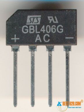

    If its the main fuse on the primary side of the power supply you might want to use a multimeter to see if the + and - of the bridge rectifier is not shorted. With the power disconected, see if the resistance is really low between the + and - pins.
    Bellow is a picture of a bridge rectifier, they almost all have markings showing what each pin does.

                        Testing a Bridge rectifier.
                        I really thought you had sorted this having seen the video and been told but I will go through it again step by step.
                        If the Bridge rectifier is still on the board find the pin designations (probably as in the picture in post 2)
                        Get a felt tip pin and follow the pins through the board and mark the board
                        + a c -
                        0 0 0 0 (This line is just to represent pins)
                        1 2 3 4
                        Mains power OFF
                        Set your meter to measure 2000 ohms.
                        Place positive (red) probe on the + pin. 1 above
                        Place negative (black) probe on the ac pin 2 above.
                        Write down the result. ohms
                        Place positive (red) probe on the ac pin. 2 above
                        Place negative (black) probe on the + pin 1 above.
                        Write down the result ohms
                        Place negative (black) probe on the ac pin 3 above.
                        Place positive (red) probe on the ac pin. 3 above
                        Place negative (black) probe on the - pin 4 above.
                        Place positive (red) probe on the - pin. 4 above
                        You can cut and past the above and write in your results.
                        I have not re read your other posts but here you say you have tested all
                        the fuses on the other boards - were these glass tube fuses or have you checked the smd fuses,if there are any, some of which may be on the back of the boards. However none of the other boards would make your PS board
                        blow a fuse as soon as it is plugged in.

                            Hi - for info, the film I mentioned is here http://www.youtube.com/watch?v=dqkT6hF0O3E.
                            The results you should get are + to ac high ohms one way nil opposite (as with a diode) - to ac the same. Ac to Ac is just checking for a short.
                            You can see the results on the meter right at the top.
                            In circuit, the results are not as clear cut due to other components but usually it is high ohms one way and low ohms with the leads reversed.
                            If results show up a short or results are close together it would need to be
                            removed for out of circuit test.

                              i only get a reading when i put the red lead on the positive leg and the black lead on the negitive every other configuration gives me nothing.
                                Re: plasma tv power board fuse keeps popping
                                Nothing as in, more then 2000 ohms so your multimeter displays a 1 ___ , or nothing as in 0 ohms?
                                Fixed so far 12 lcd's , 1 plasmas, 5 monitors, 0 dlp's (plan to keep the dlps at 0). and 3 atx power supplies, and 2 motherboards.
                                  0 ohms
                                    Thats not the failure state i would expect, but if your really getting 0 resistance between both AC leads, then you either have a bad bridge rectifier, or a short in the very few parts that are before the bridge rectifier (usually theres the power cord > fuse > a few inductors > then the bridge rectifier. )
                                    You could unsolder the bridge rectifier and do some proper testing on it out of circuit. http://www.ehow.com/how_7918714_test...rectifier.html
