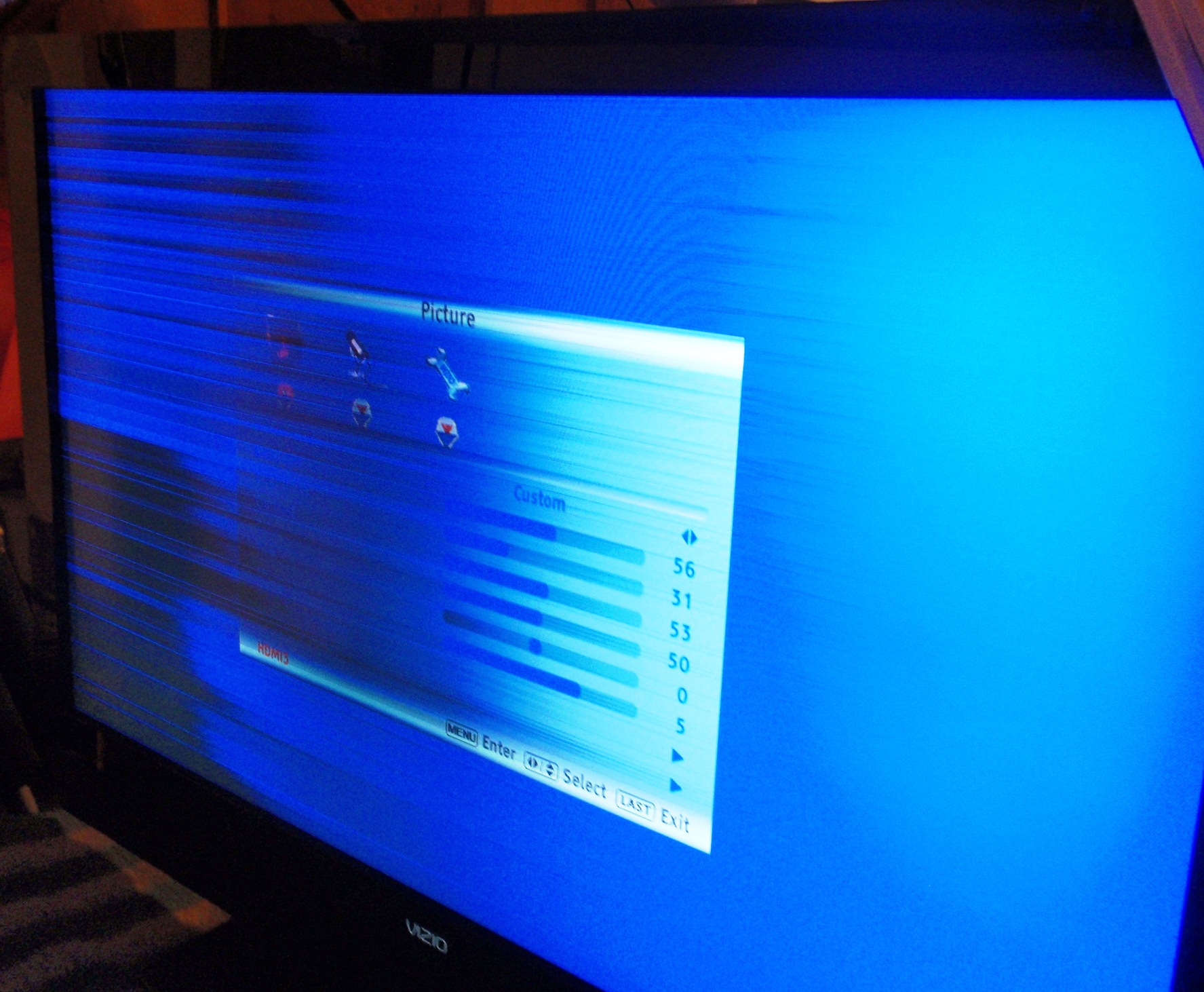

    Sorry its a VW46LFDTV10a.
    I have just picked up this TV in the rain and I haven't had time to really look at it, the screen has some scratches, but that it's another issue. By the way there is a method of reducing the visibility of scratches on a screen?
    I was told that it takes like 30 minutes until I see a picture, but when I have tried it at home it just started right away and it showed some horizontal likes mostly on the left side and with video signal it looks like it's very slow that side and I believe that it's called ghosting when do you see a trail of a moving object.
    It could be a bad T-con board?

    3 things that might be the cause
    1) bad t-con
    2) loose / dirty / missaligned ribbon cables from the t-con to the panel, im sure someone has a guide on how to clean them with a pencil eraser on this site
    3) tab bonding on the screen, try placing light pressure every 3 inches or so around the edge of the screen and see if any of them change the picture (this is least likely based on what the pics show)
    you might want to also test the output voltages from the power supply just for the hell of it, since thats really easy.
    Fixed so far 12 lcd's , 1 plasmas, 5 monitors, 0 dlp's (plan to keep the dlps at 0). and 3 atx power supplies, and 2 motherboards.

        Ive never seen a dirty ribbon cable, but the commonly recomended trick is to use a pencil eraser to erase / clean the metal pads at the end of the cable. Not really any trick to it, but just be soft, and make sure all the eraser lint is off before reinserting. Im not sure why a pencil eraser is recomended over rubbing alcohol and a cotton swab.
        Having the cable ever so slightly missaligned can easily screw up the picture though, sometimes ive had to retry inserting the cable 3 times to get them to work properly. Usually half the screen is handled by 1 cable, and the other half by the other cable, so usually when you dont have them in properly only half the screen is affected.
        In your pictures theres 2 effects that are noticeable, but i think one might just be from your camera angle. Is the tv just having the black lines that end around the middle of the screen, or are you also getting a curvy set of lines through out the middle (cause that might be just from the camera angle).

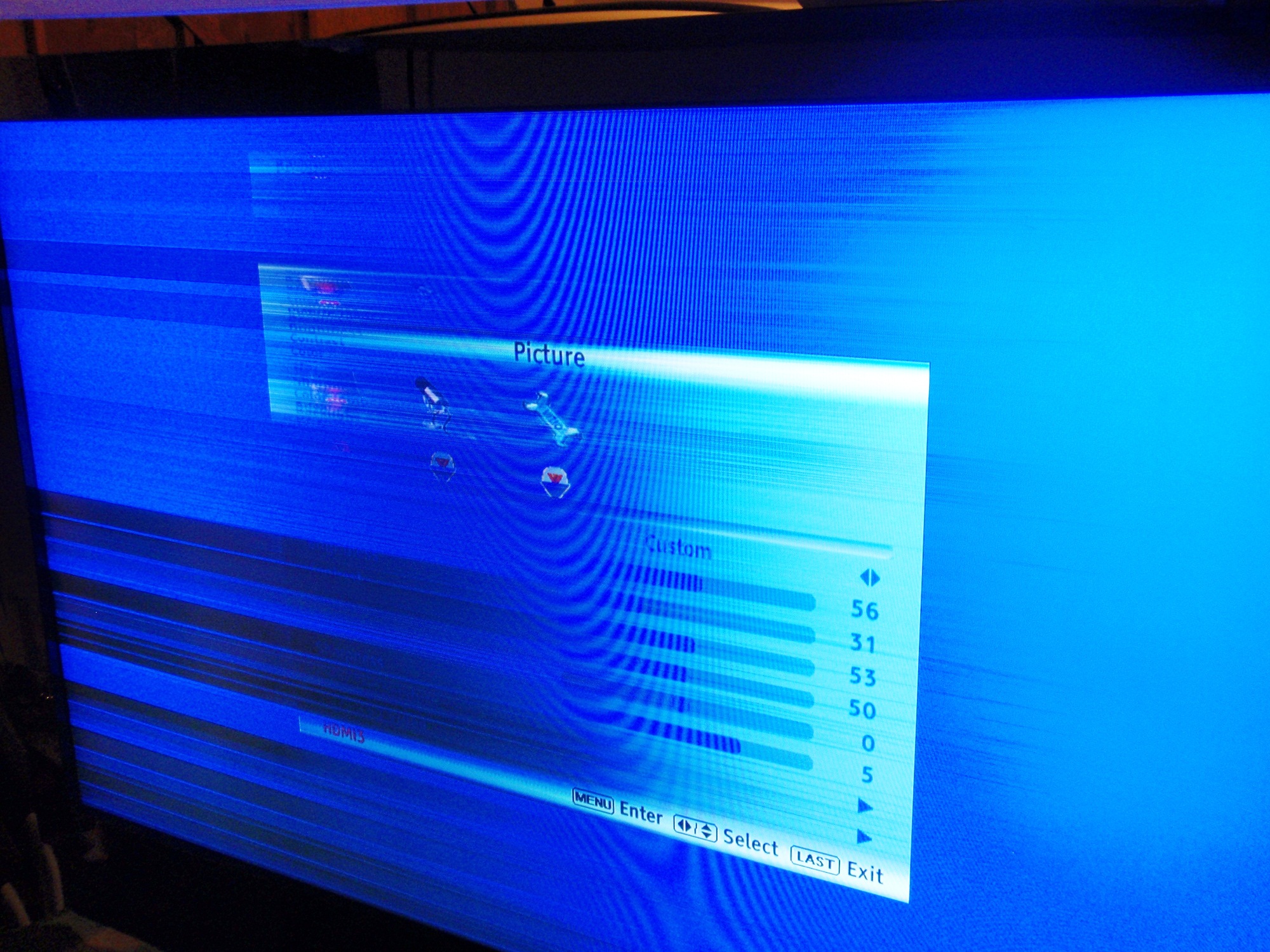

                  After having the mishap with the flex cable, replaced the blown fuse F2 and the TV is back.
                  I have watched the TV with signal and the screen shows all kinds of things.
                  What do you see in my first post clears out, center has a darker spot which stays. Picture becomes horizontally sliced in like three, some of these freezing the image, some flicker.
                  Some times I have very good picture, specially the right side, the left is darker and the moving image is very slow.
                  If I restart the TV after a while the screen is mostly green, but it's keep changing.

                      In addition to the ribbons going to the T-con, there are usually ribbons going from T-con to the LCD. See if you can get access to them and reseat them.
                      The characteristic glowing and blurring of the screen "looks" like a T-con issue, but the loss of the vertical sync makes me think main board problem! Does the sound go when it freezes? The fact that it gets worse as it warms up seems to me like a BGA problem - you can thank lead free solder for that. Try applying some light pressure to each of the large processors on the main board and T-con. If that fails to change the results, use a hairdryer to heat up the boards until the fault occurs, then shut down the TV (leave it to cool down), then when it powers up heat the component again and see if the fault occurs immediately.
                      To reduce the appearance scratches on the screen you can try cleaning it with a soft moist cloth but mostly it's not repairable.

                              That's what it reminded me of. It's worth trying if you can get access to the LCD panel. Sometimes it's difficult.
                              It could also be T-con, since a missing waveform causes both problems, but with tab bonding issues it is because the tab physically separates but T-con simply doesn't send the data, so the effect is similar. The digital noise and jumping on the other hand doesn't look like tab bonding.

                                        YEP!!! if twisting helped you probably have bad tabs, welcome to the family lol! now figure out if that 10w resistor trick to a side tab works, cause i dont want to spend 3 dollars on some 10w resistors from radio shack unless it works lol!
                                        But it would be a good idea to take your tv apart all the way down till the flimsy lcd screen is loose so you can see the tabs and apply pressure to them. If you can get pressure on 1 to consistently fix it, then id just use some foam, put it back together and sell it cheap.
