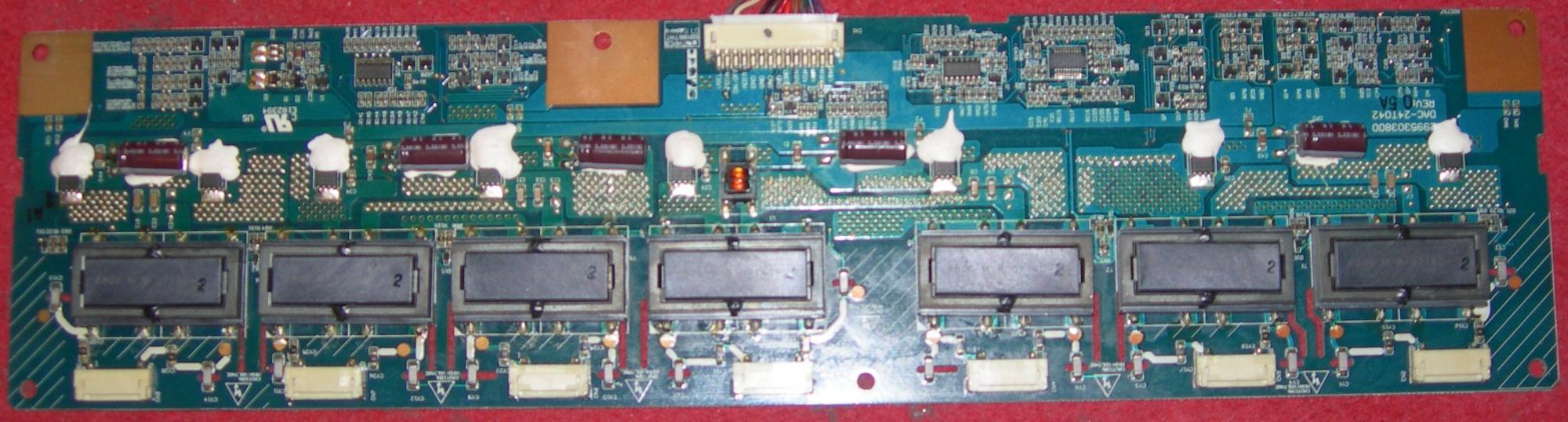

                        Okay, so PSU tests good. Low ripple on most rails, below noise floor on 5Vstby for my scope!
                        No backlight. So I'm thinking an inverter problem? And maybe the user accidentally changed sources or muted the input so the sound went away a couple of days later too.
                        Noticed the second FET was being strange too, but the gate was 0.02V. The source voltage was 11.88V, but drain was only 2.0V, similar to the other fet stuck at 2.0V. I'm not sure what to make of these readings!
                        But even with both shorted, it doesn't work.
                        I may have to take you up on that offer of a main board Scenic. I'm currently disassembling it to get to the inverter and will test that (fuses, transformers, drive waveforms.)

                                  Re: Hanspree "Unknown Model" 32" LCD: No picture or sound, power LED
                                  Okay, so I finally got the back cover off (which is quite an operation...)
                                  Disappointed to find a Chungwha LCD, as I consider those among the worst. (Poor motion performance, poor colour/contrast and worst of all, they develop mura after a couple of years.)
                                  The inverter looked good on first sight, all fuses are okay. But the transformers on either end of the board tested at 90kohm - the ones in the middle tested around 9.4kohm. I'm thinking that it's quite likely I've got two faulty transformers... but I've never seen that happen before... and the symmetry of the failure (or not) is annoying my OCD brain!
                                  Two inverter transformers are £20+ so I want to make sure it's definitely these at fault. Scenic, could you please test your transformers on your board and see if the measure 9.4k all the way through or if some measure 90k?
                                    might work out cheaper to find a replacement board, what is the number on the transformers, i have a invertor here that may have the same transformers
                                      the number on these is 4015A513010
