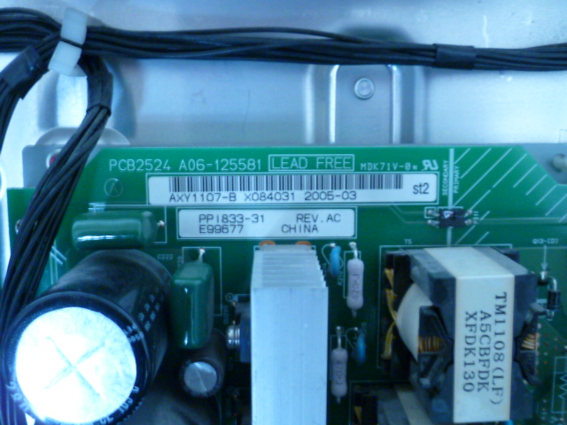

        I have the 50hdt50m version of this tv made by pioneer for Hitachi (2003) with the updated power supply. I would not trade it for anything!
        Find out if the tv power supply is an axy-1059. The updated version is an axx-1064 and will be tagged on the aluminum back of the power supply.
        Your tv may vary slightly from mine pending the year. There were a few different models that used the media boxes.

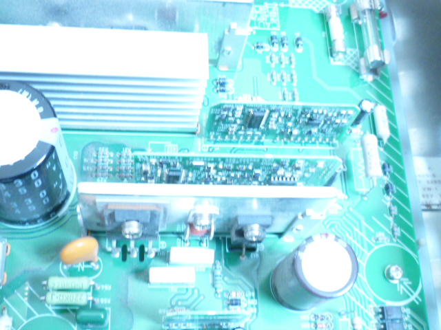

          Hi cadiman..theres now bent pins on either of the lead ends..heres a pic of tv psu model no..with the tv disconnected from the MR the leds on tv green & red flash together indicating MR unplugged..with the MR plugged in the tv led is red flashing 2 times indicating a problem with MR..all you get from the MR is both power on & standby led both been on together..thx

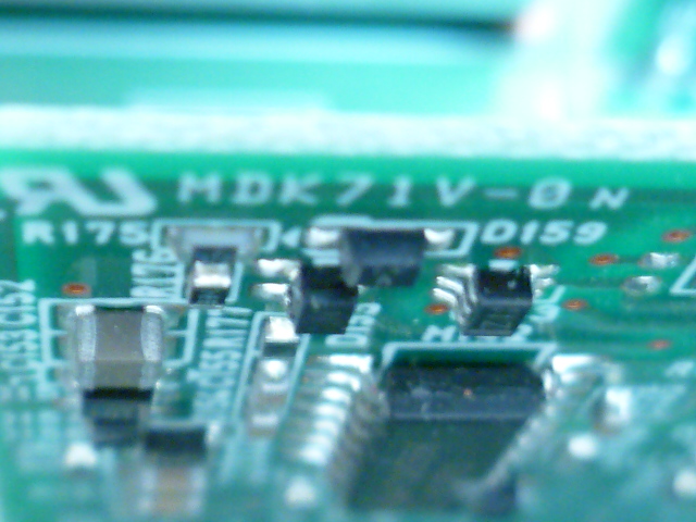

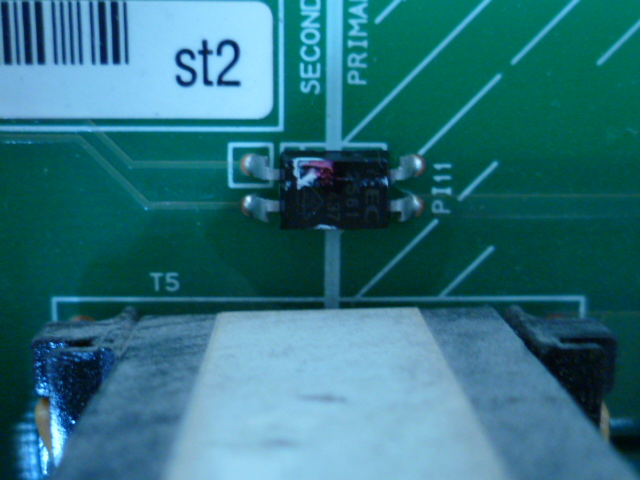

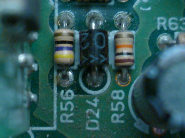

            What's up with that 4 pin black chip with a mark on it, top right of picture? It looks like an optocoupler but the marking on it looks like damage.
              #46
              Re: pioneer plasma PDP-435PE
              Will open it back up & get jewel eye out

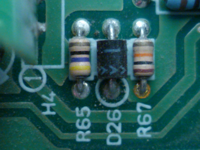

                Looks like tipex..when probing diodes etc on this tv psu there is 2 diodes D24&D26 which both measure .032 with a continues beep on diode check function..will i need to pull a leg to retest as all the other diodes measure a reading & OL..thx
                  #48

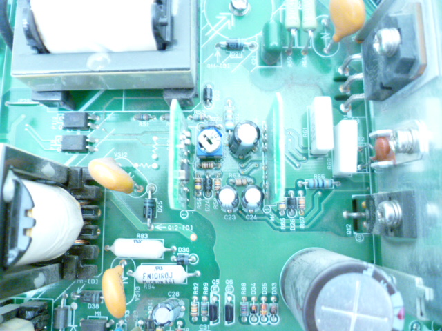

                  Better pics of them diodes..also this card thats soldered in has a orange led lit when the set is on..thx..its the card behind the heatsink
                  Them diodes are measuring good out of circuit

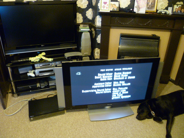

                    Well ive took dog for a walk & to clear my head cos this set done my head in so far..ive stripped remote down & cleaned with isproponal..plugged everything back together & tried the remote sequence again & BINGO it fired right up
                    Once in the service mode i dont want to mess any settings up so i set time n date & left it at that...it dosnt have freeview built in so trying with a cheapy 1..I want to do a full factory restore to the set & could do with..thx

                      Ive sussed it out..what i did if any1 ever comes across this problem..
                      to enter service mode press display button wait 3secs then left arrow/up arrow/left arrow/right arrow then power button..then in service mode keep pressing mute button till you get to initialize page..then press & hold the display button untill the red led goes out from the MR..
                      Thx guys n gals for your feedback & help

                                Here she is fully working
