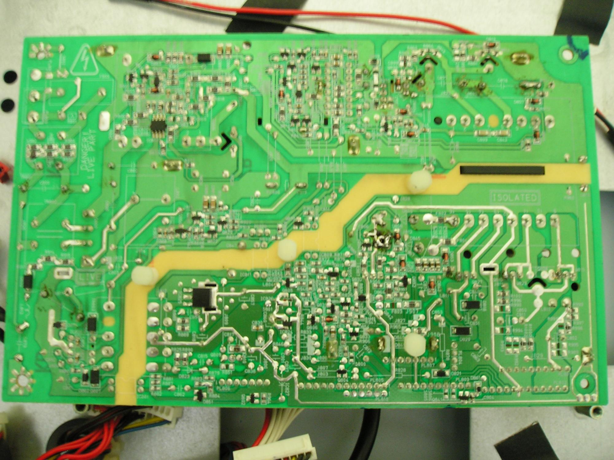

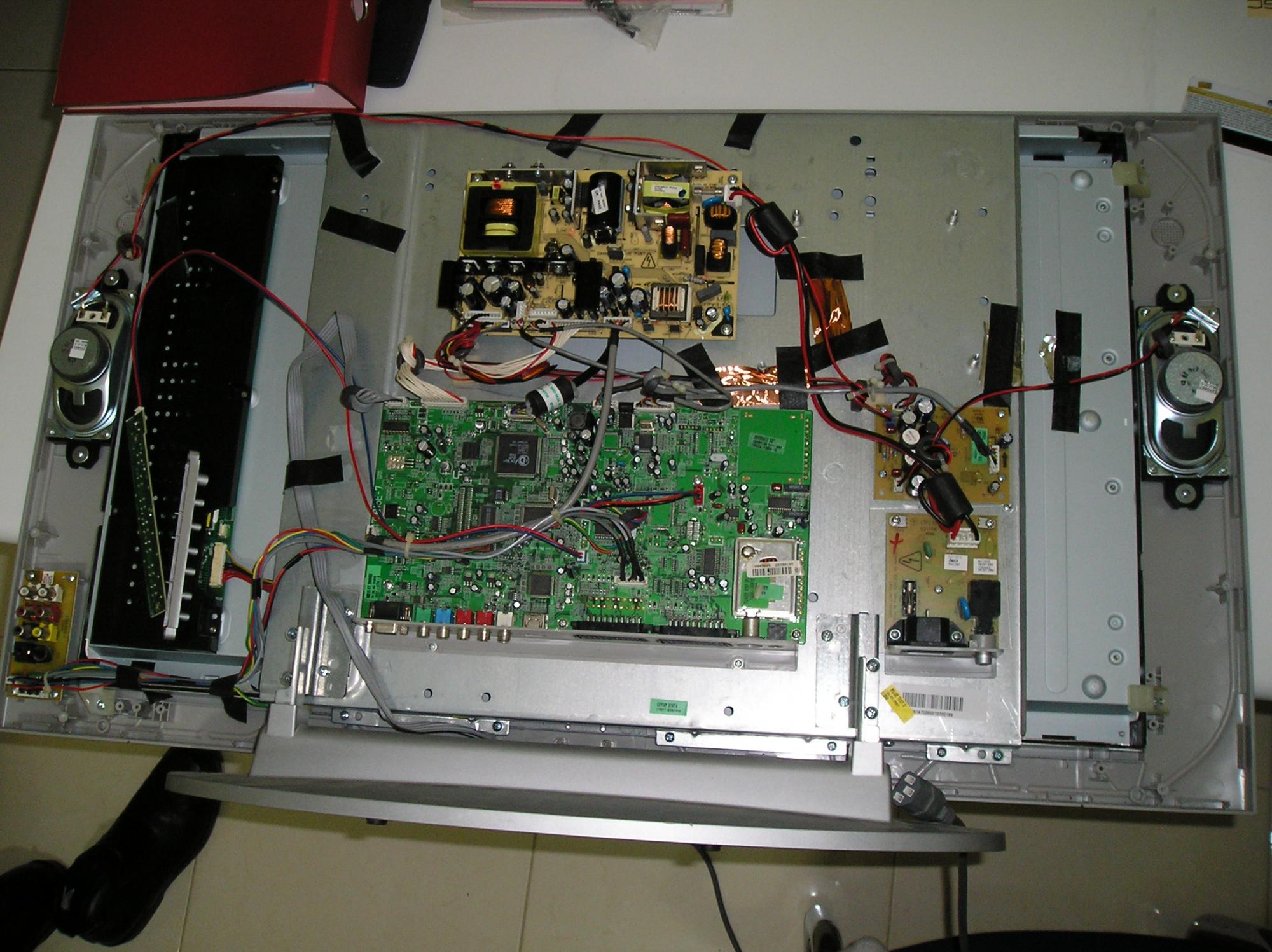

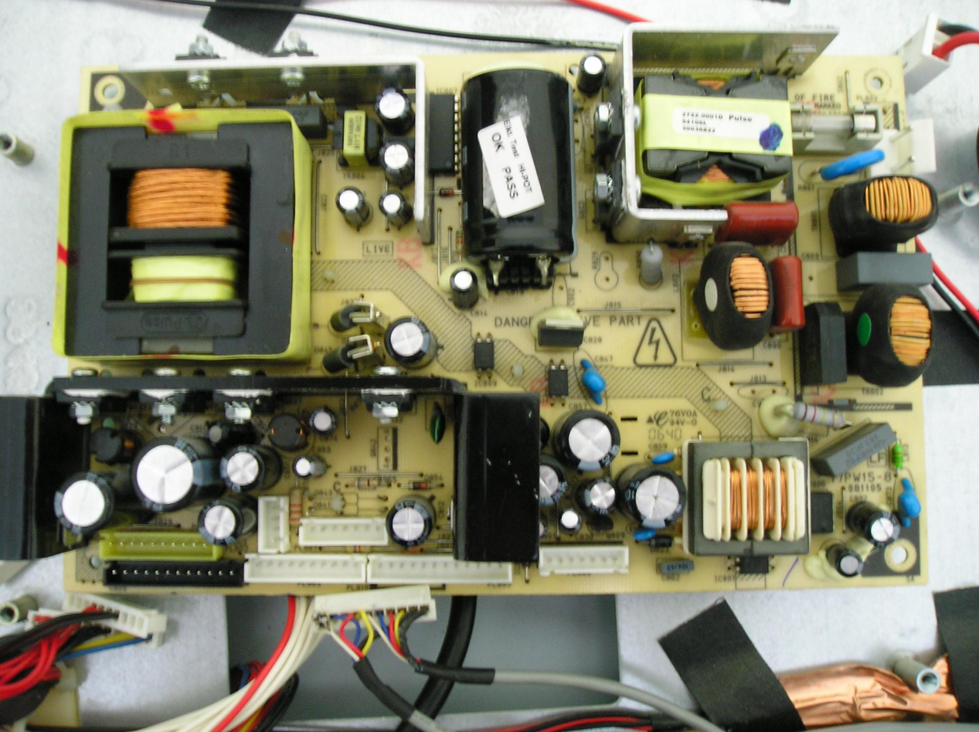

            i've uploaded some pics, i hope it will do,
            if its not that clear i can try my girlfreind's iphone camera.
            i need to share some new discoveries,
            before giving the tv to me, my freind took it to someone, who hasn't been able to repair it, and i dont know what he did. :-(.
            new problem appeared when i wanted to do the flashlight test,
            the tv stanby led was flashing in red colour, and there is some strage noise, i think i comes from the power supply pcb,
            asking my freind if it happend to him also, he said that the tv had no pic whith sound or this situation alternately.
            another strange thing i found is that are two diods missing in the power supply. their legs are cut from the upper side of the pcb,
            note sure if the seller did that or the former repairman.
            its D840, D841.
            Please guide me :-)

                  Re: VESTEL 3208 Sound but no picture
                  check voltages coming out of the power supply with reference to you pdf schematic,you will notice that some of the connectors are missing on the schematic,,write down the voltages from your pdf linked to the connectors on your board,mark it on paper ,on these supplys there are no markings for voltages printed on the board,then reference to what the voltages coming out actually are,im guessing your missing a 24v rail to the inverter,if you are ,esr the output capacitors out of circuit,take it from there then
                  fixed so far...376 lg lcd tv's,24 onn tv;s,24 panasonic lcd,16 jvc lcd,12 marshall jcm800 amps,refurb of various disco equipment lighting,old style disco decks ,and a flymo!
                  please let us know if everything works ok if your tv gets fixed, as it will be and aid for anyone else having the same problem and wishing to fix it.it would save people clogging up this site with topics that are duplicated,and can be found easily using the search function.,and taking up valuable space.enjoy your fixed tv!,hopefully!
                    p.s the output caps on these supplys do fail without bulging/leaking
                      thanks multimeter, i really appreciate the help,
                      i will test the voltages on the inverter connector pins,
                      and update tommorow,
                      i should be getting 24vdc right?
                      your theory about the caps, sounds reasonable but what would you suggest,
                      try reccaping the whole power supply pcb?
                      as i said im currently serching for an ESR meter,
                      but can's seem to find someone on EBAY who is willing to ship to Israel.
                      iv'e saw a post cant remember where, that there are 2 15nf gray rectangular caps that could be faulty, upper left side of the pcb,
                      you are able only to see the side of the cap in the picture,
                      there is another one on the right lower side.
                      do you have any expirience in checking those caps,
                            I looked at the SCH (17pw15-8), since you indicted that you do get sound but no pictures, it means that the 12vdc is working which means PS_ON is working OK and so as the PFC Voltage boost circuits, so you should have the 24vdc at the PL801 PIN 1~5.
                            Also look at the BL_ON PIN 12 of PL802, what do you have there?
                            Also any pictures of the inverter board, do you get 24vdc at the inverter board power connectors?
                              hey guys, sorry for delay,
                              so i did some more testing,
                              when i disassembled the inverterboard i noticed there is a lamp missing,
                              added a picture, and saw some burn marks on some of the lamp connectors on the inverterboard.
                              i really dont know if its normal or not, you tell me.
                              when i assembled the inverter back, i saw that few of the lamps where not sitting staight moved them a little and turn on the tv, i got a white light for a sec on the upper side of the screen, where touched the lamps, no picture though. when flashed with a bulb got no picture (maybe doing it wrong)
                              is there any way of testing the inverter?
                              from my expirience from monitors, the lamp came with a 2 pin connector,
                              that i could plug a test lamp to, in this inverter the lamp is connected with only one pin staight to the inverter.
                              how is it working with one side only anyway??
                              (maybe the otherside is connected to somewhere, don't know where)
                              by the way checked both fuses on the inverter and turned OK.
                              got nothing connected to CN14- is it ok?
                              PL802/G800 Conector on the power supply pbc goes to the inverterboard,
                              pin 1 (red) +24.5vdc
                              pin 2 (red) +24.5vdc
                              pin 3 (red) +24.5vdc
                              pin 4 (red) +24.5vdc
                              pin 5 (red) +24.5vdc
                              pin 6 (black) (-)
                              pin 7 (black) (-)
                              pin 8 (black) (-)
                              pin 9 (nc)
                              pin 10 (nc)
                              pin 11 (yellow) +21.8vdc
                              pin 12 (blue) +21.4vdc
                              PL801: (goes to the speakers pcb)
                              pin1 (nc)
                              pin2 (nc)
                              pin3 (nc)
                              pin4 (red) +24.5vdc
                              pin5 (red) +24.5vdc
                              pin6 (black) (-)
                              pin7 (black) (-)
                              pin8 (nc)
                              pin9 (nc)
                              pin10 (nc)
                              what should i test next?
