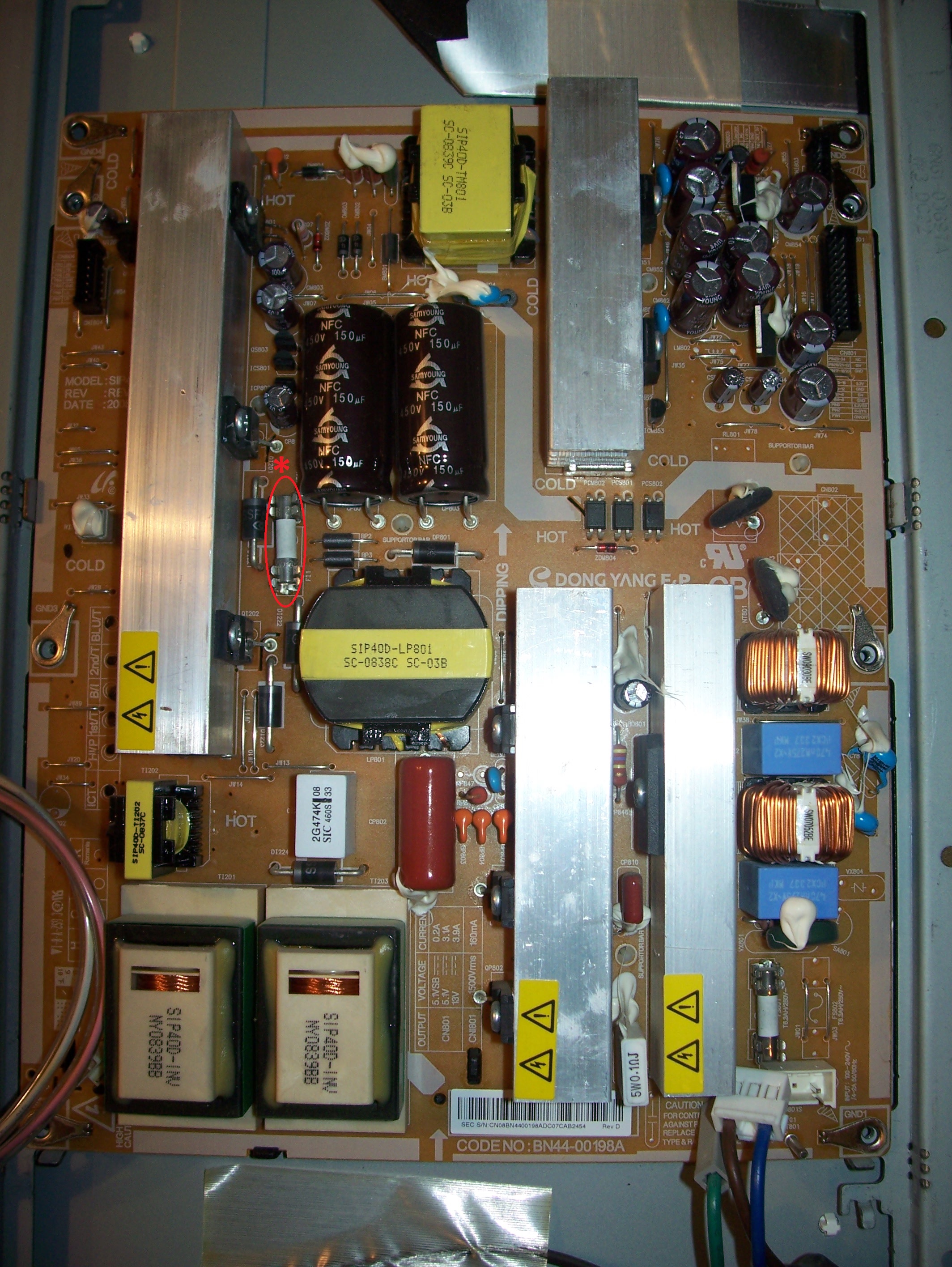

                            I apologize in advance if this is bad manners by bumping a old thread, but since it is so similar to my problem I thought it would be better to keep the entire discussion contained.
                            I have a Samsung LN40A550P3F 40" LCD, that was purchased new by me, back in the day. Never had a single problem with it, beautiful picture. It was our first non CRT TV.
                            This past week, I was watching TV, went into another room and came back to a black screen, but sound still playing. Unplugged the TV for the night and came back the next day with same issue, sound but no picture and no back light. The red light on the front of the TV now flashes when the TV is powered on.
                            After a lot of searching, reading and more searching; I stumbled upon this thread, which appears to have possibly the same problem. The power board looks identical. Not sure what all is different between the model numbers.
                            Anyways. I checked the fuse FI1, circled in the picture and it was indeed blown. I am not quite sure where to go next. I de-soldered and checked a few diodes that appear to be good. Hesitant to start pulling the mosfets and checking them as it has been a few years since I've needed to probe out a circuit so I am a little rusty.
                            If someone could point me in the direction of where to go next, in simple terms I would greatly appreciate that.
