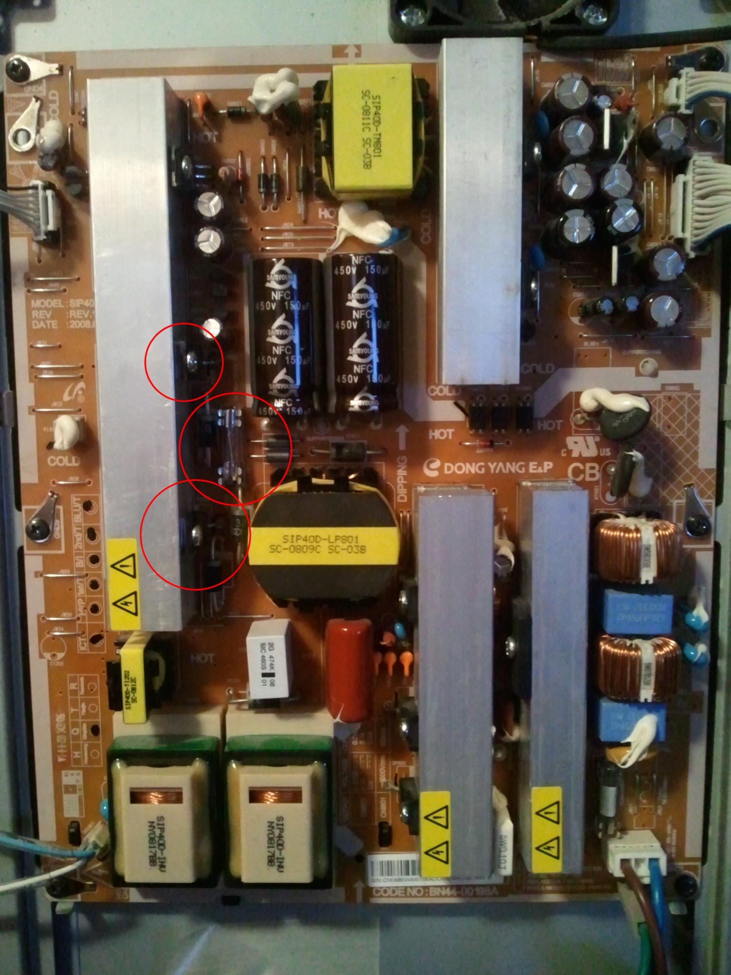

    Hello everyone! I'm a little new to TV repair and I was looking for a little help with this Samsung LCD TV. It will power up (red LED goes out) and you hear the startup sound as well as sound from the HDMI input I had connected to it. But the LCD screen stays dark. I opened it and noticed a blown 3.15A fuse on the power supply board (BN44-00198A). It wasn't the main fuse (obviously) but after looking over the board a bit I saw it protected the control circuitry for the high voltage transformer that powers the inverter board.
    After a little testing I found two MOSFET transistors (FQPF9N50C) that were shorted source-gate-drain. I replaced these and the fuse and powered the TV up. Fuse stayed intact but still no backlight.
    Now to show my newbiness. I'm an automotive tech with 13 years of experience troubleshooting and testing low voltage DC circuits. I have some understanding of how electronics work and I have a DSO and know how to use it. But I'm not exactly sure what I'm looking for. I did test the power source for the fuse that was blown. It comes directly off the bridge rectifier and the two 450V 2200uF filtering caps. I was reading close to 400V but it seemed to have a lot of AC riding on top of it. Again this may be normal I'm not sure.
    I diagrammed the main circuit for the two mosfets (minus the small SMD control circuitry) but I'm still a little unsure what they do. From the diagram and what I've read it looks like they convert the DC into a high frequency AC for the transformer. There's also a small SMD 30K resistor and a zener across the gate and source. Any information on how this works or how to test it would be much appreciated. Unfortunately I don't have a high voltage probe to test the transformer output directly.

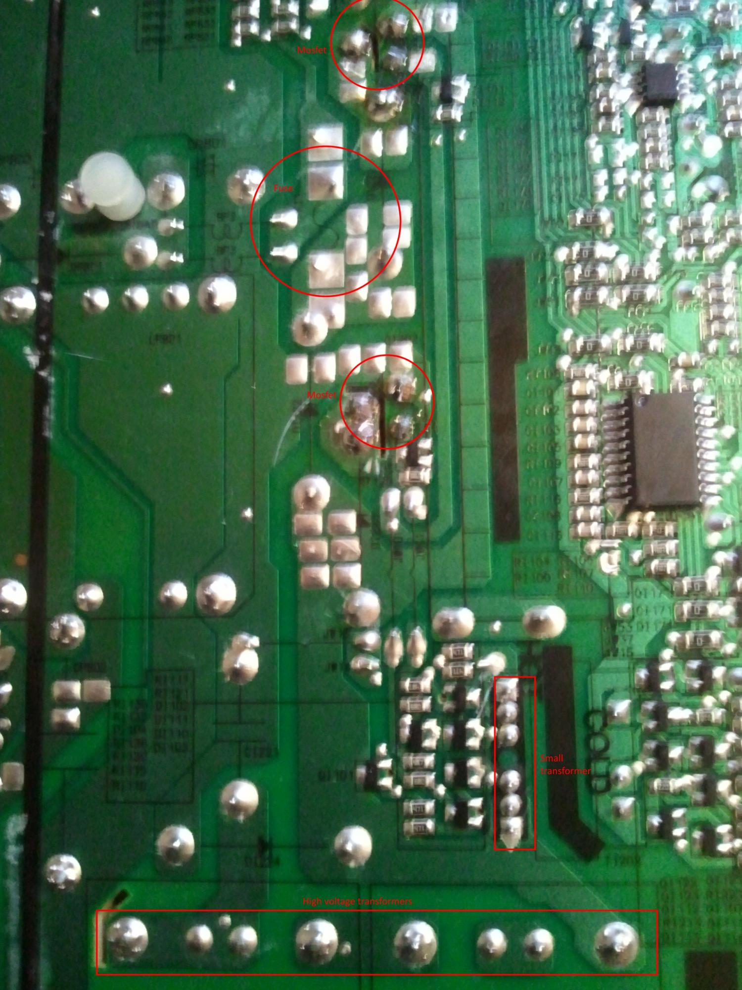

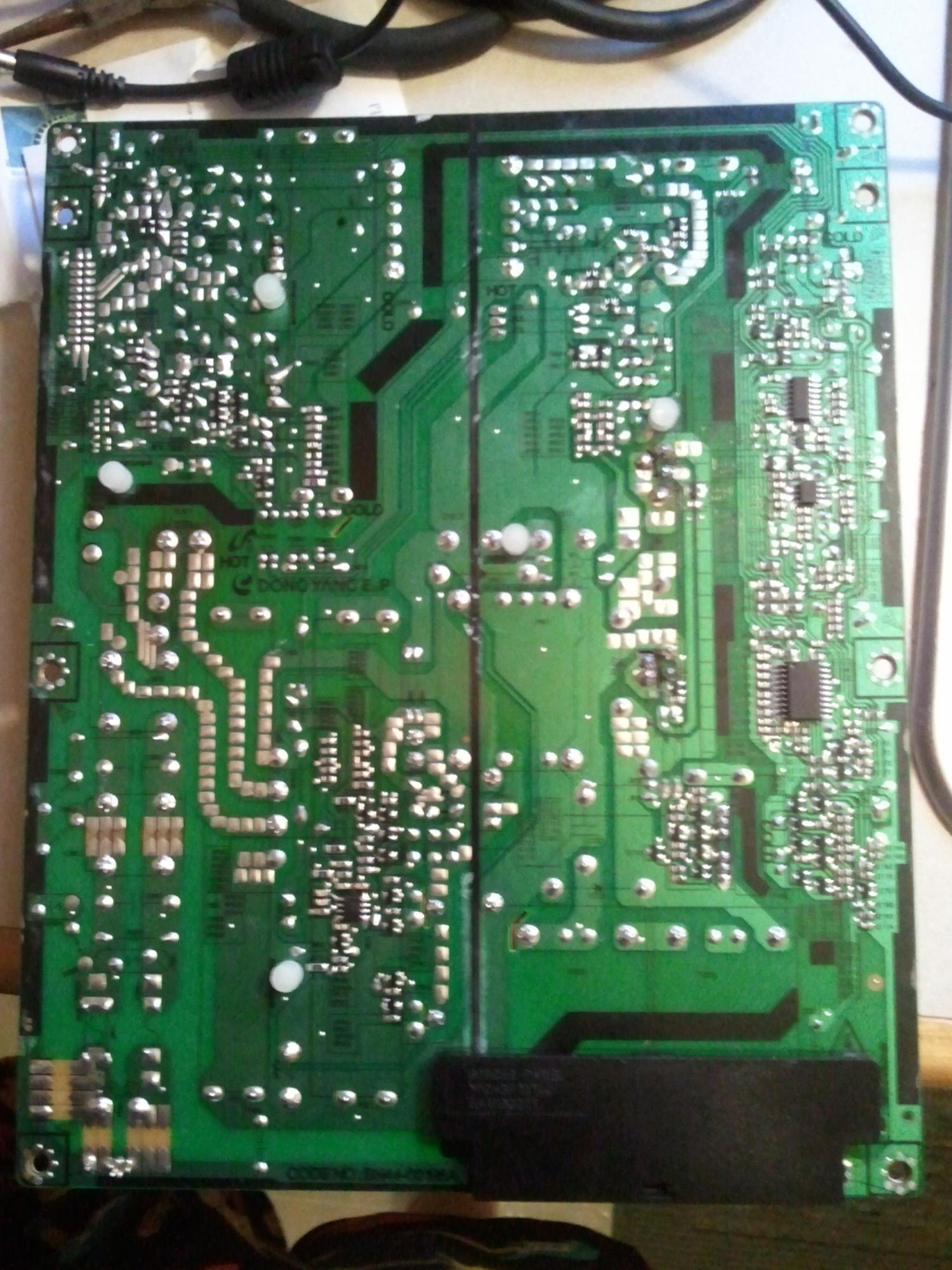

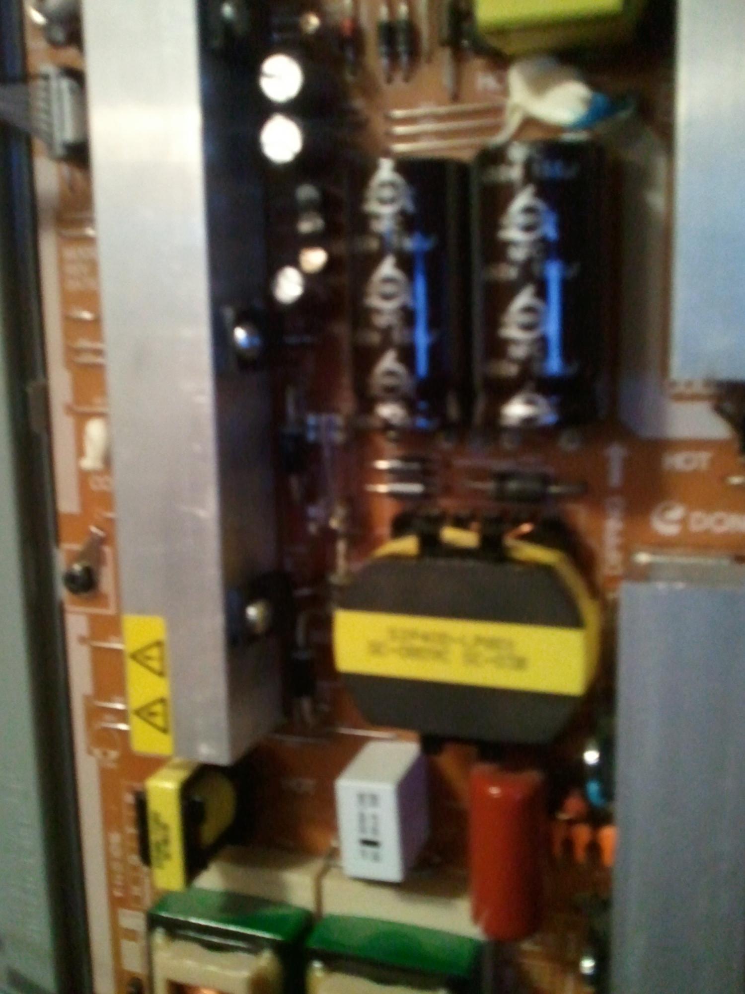

      Here are the pics. Sorry I should have done this in the first post...
        Re: Samsung LN40A650A1F, no backlight
        OK, when the that high voltage MOSFET's shorted out like that, more likely it will take out the Gate resistor and Gate draining diode (there should be a low Ohm resistor in parallel with the diode which will be connected to the Gate of the MOSFET) for each of the MOSFET and it more likely taken out the SMPS IC output sections that drive the MOSFET also. If you travs out the gate conections, it should be connected to that 20-pin surface mounted IC on the bottom of the board.

                        Now I see what blew the fuse. When the MOSFETs shorted it gave diodes DI221 & DI223 a straight path from ground to power. I did notice the solder trace on one of those had been hot. I forgot to mention that I tested the larger power diodes DI221, DI222, DI223, and DI224 with one leg unsoldered and they tested fine with the diode test funtion on my multimeter. I'm wondering if they're failing under power.
                        So from what I can see (with my limited knowledge) it appears that UI101 uses the AOUT and BOUT terminals to control the transformer TI202 through a series of mosfet and bipolar transistors. I'm assuming those are used to step up current. The transformer amplifies the voltage of the control signal (AC at this point?) into the MOSFETS I replaced (QI201 & QI202). These MOSFETS control the high voltage transformer TI201 that powers the inverter backlights.
                        So now for more newby questions. Will the transformer isolate the damage from the shorted mosfets to DI103, DI104, DI110, DI111, QI101, and QI202? I'd like to check these control signals with my scope, so if anyone could give me a little operational theory on what's going on here it would help me a lot. For example, what is the whole circuit trying to accomplish? I know the high voltage transformer is stepping up the voltage to light off the backlights, but is the control circuitry amplifing the frequency as well? Any idea which components might be damaged?

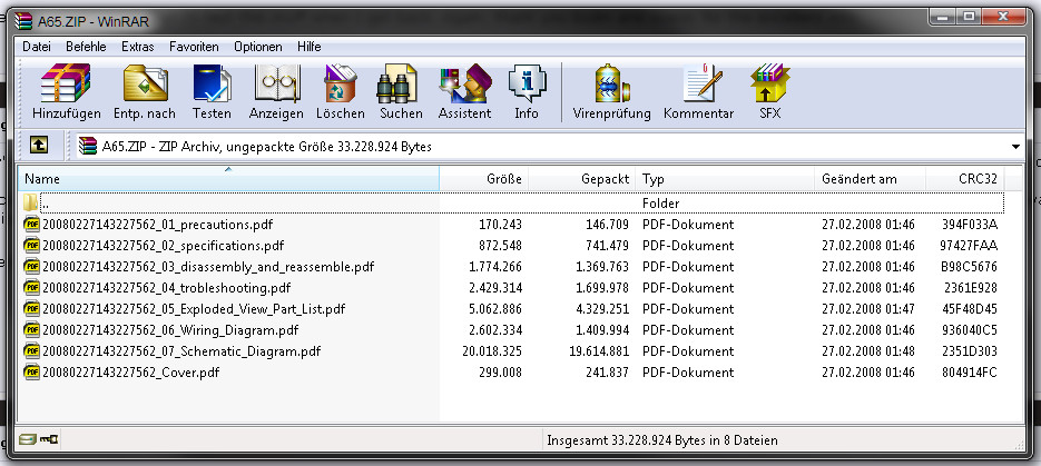

                            Scenic I found a service manual for the european version of this tv on a similar site. I had to manually dump the text into google translator to figure out how to register and download. No schematic for the power board in that manual, but I really don't need it now do I?
                              I just took a look and found the service manual for the A65x series (LE__A65_) LCD TV's (the LE indicating it's the european model)
                              It's probably the same thing you found, except I didn't have to register to download it.. instead I had to deal with a shitton of popups -.-
                              It's a ~30MB zip with the SM split up into several PDF's
