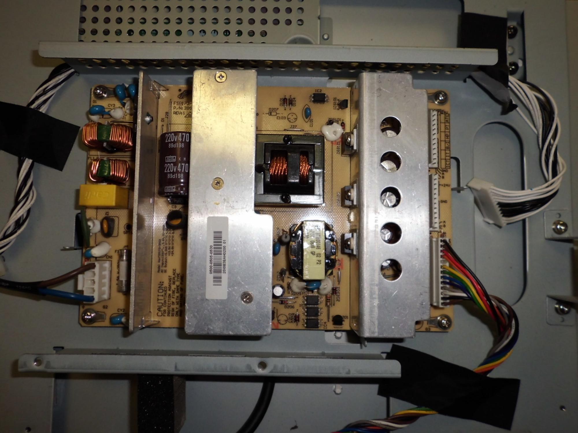

    Using an isolated transformer, I removed the power supply board and tested the various points (filtering cap, +5/12/24 volt diodes). I do have +5 volts on power up. When I connect +5V through a 3.3K ohm resistor to PWR_ON pin, I get a brief +12/24 volts but it quickly decays.
    Can anyone suggest a next step in troubleshooting? It seems as though my power supply is OK, but it is shutting all but standby off shortly after power up.

        You should bench test the power supply again, using two 12v bulbs in series and attach them to the 24vdc output, then turn it on as before sunig the 3.3K resistor, the lamps should stay on, if not, you still have problem in the 24/12vdc power supply circuits.

          OK, tried the dual 12v lights in series and get 1 second of lamp life.

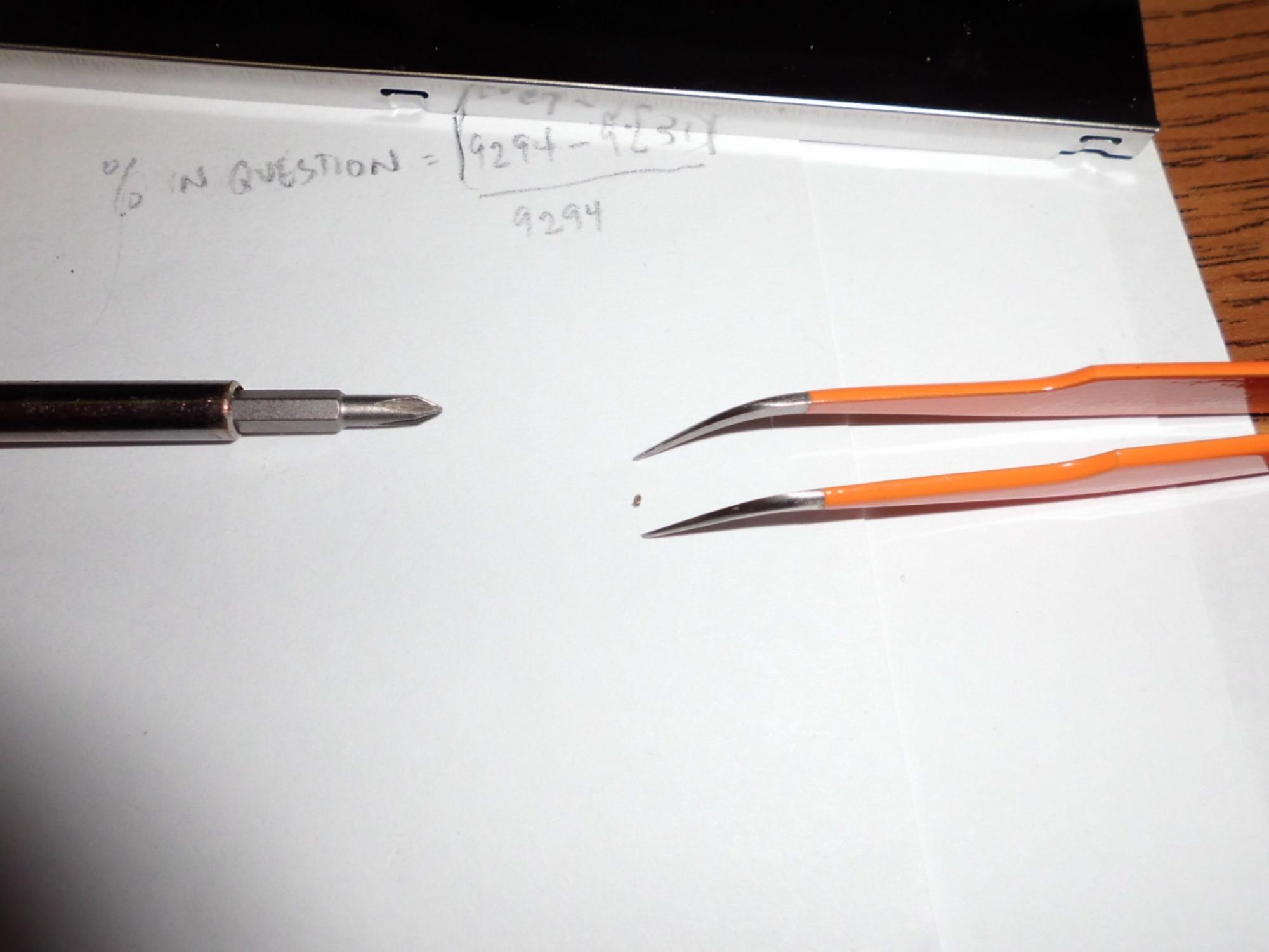

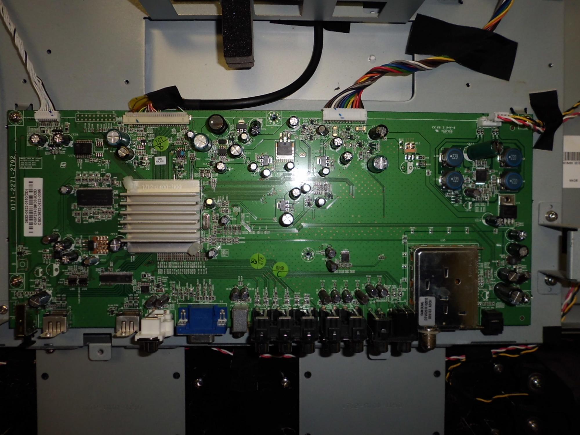

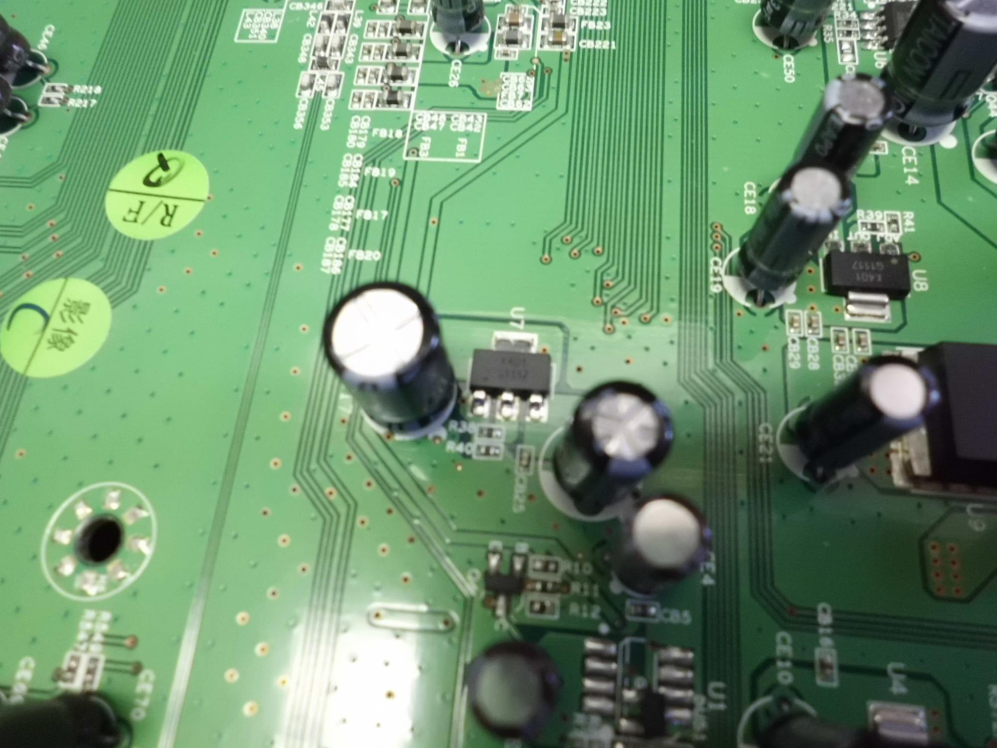

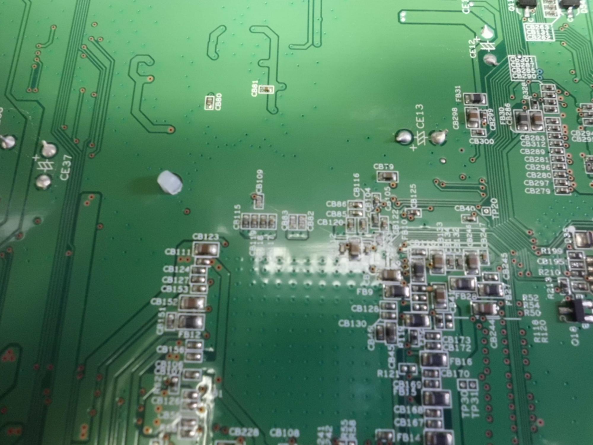

              With only the controller board connected the power supply, I noticed the processor heat sink was a bit warm. Inverting a can of compressed air, I sprayed the board down and then blew moisture from a breath of air across the board to look for hot spots. Found that U7 (marking on chip is K401, G117 which Digikey shows as a 5V LDO regulator) was extremely hot. So hot that I burned the pad of my finger! This looks like the power to the processor. I flipped the board over to test the caps ESR and noticed that somewhere along the line I had dislodged three VERY tiny SMD capacitors (CB82, CB83 and CB109). So small and little chance of finding them. Ugggh!

                      I just saw you post about the LDO. The LDO is probably hot because it is unstable without the caps. If you find the datasheet for the LDO, you can find the manufacturer's recommended capacitors and replace them. I wouldn't recommend running it with the hot LDO. It could damage the processor.
