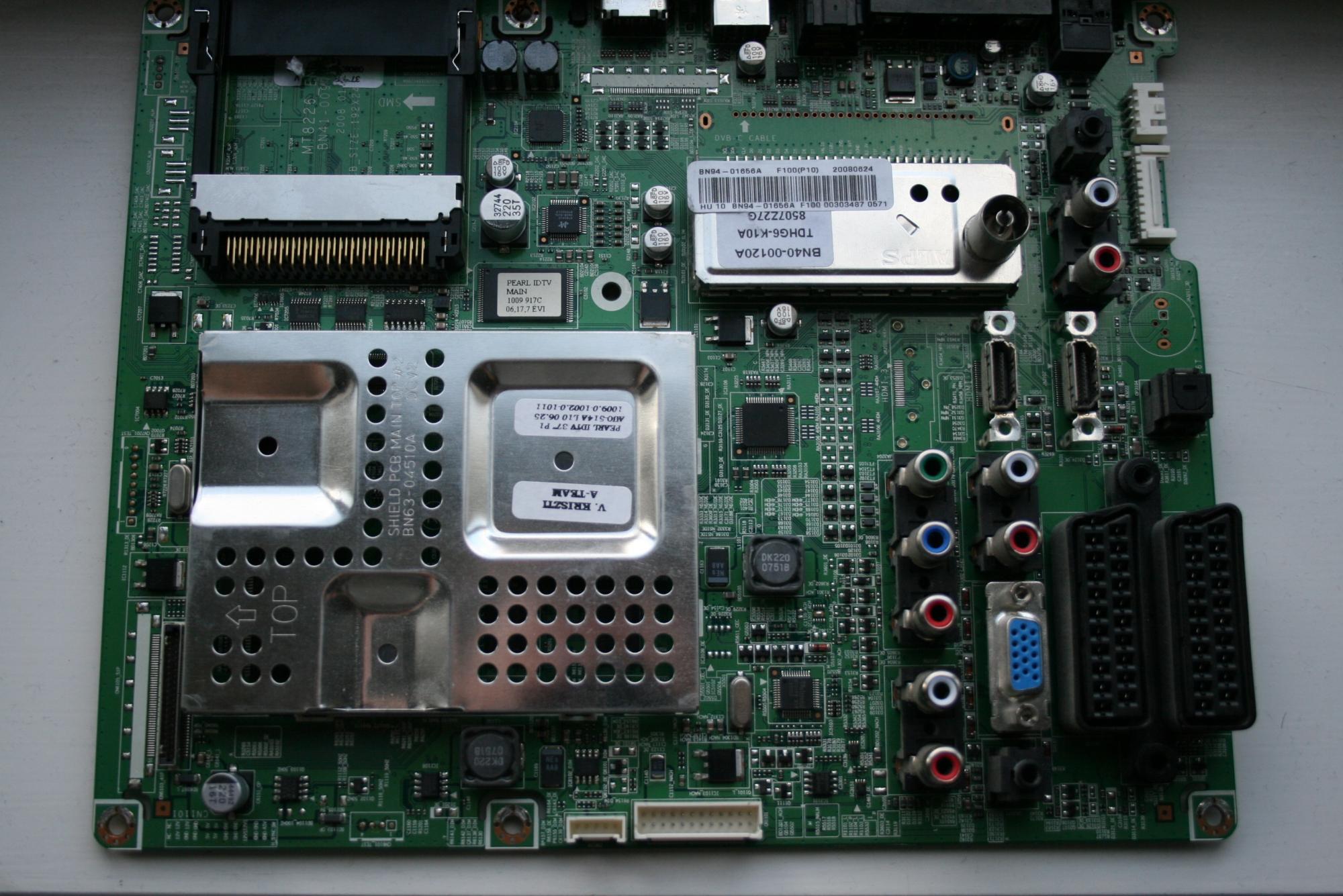

                                  @ Jasgriff: Look for 8leg IC's on the backside of the board, close to the CI card slot (the one that looks like Cardbus/PCMCIA on older laptops) that says either "24C256" (or some variation like AT24C256B) OR "2EB 1" in the 2nd line.
                                  If the first line starts with "ATMLxxxx", that just tells you it's made by Atmel and a cryptic datecode. Doesn't help identifying the IC at all.
                                  I've been "out of service" for a week or so because of a lumbar disk herniation. REALLY sucked. Couldn't stand, let alone walk. That combined with a cold makes for a REALLY fucked up week of not being able to move and every cough feeling like someone's punching your back/spine with needles..
                                  I'll try to read through this thread again from the ground up, trying to ignore all the damn off-topic posts of different boards.

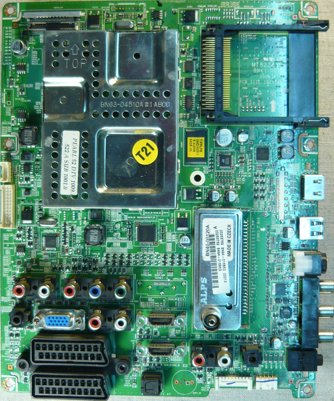

                                  If the attached pic (BN41-00974B mainboard) is the one Jasgriff has, I'd need a pic of the back of the board, preferably labelled which of the 8pin IC's is which somehow.
                                  The slot in the top right is the CI card slot I was talking about earlier.

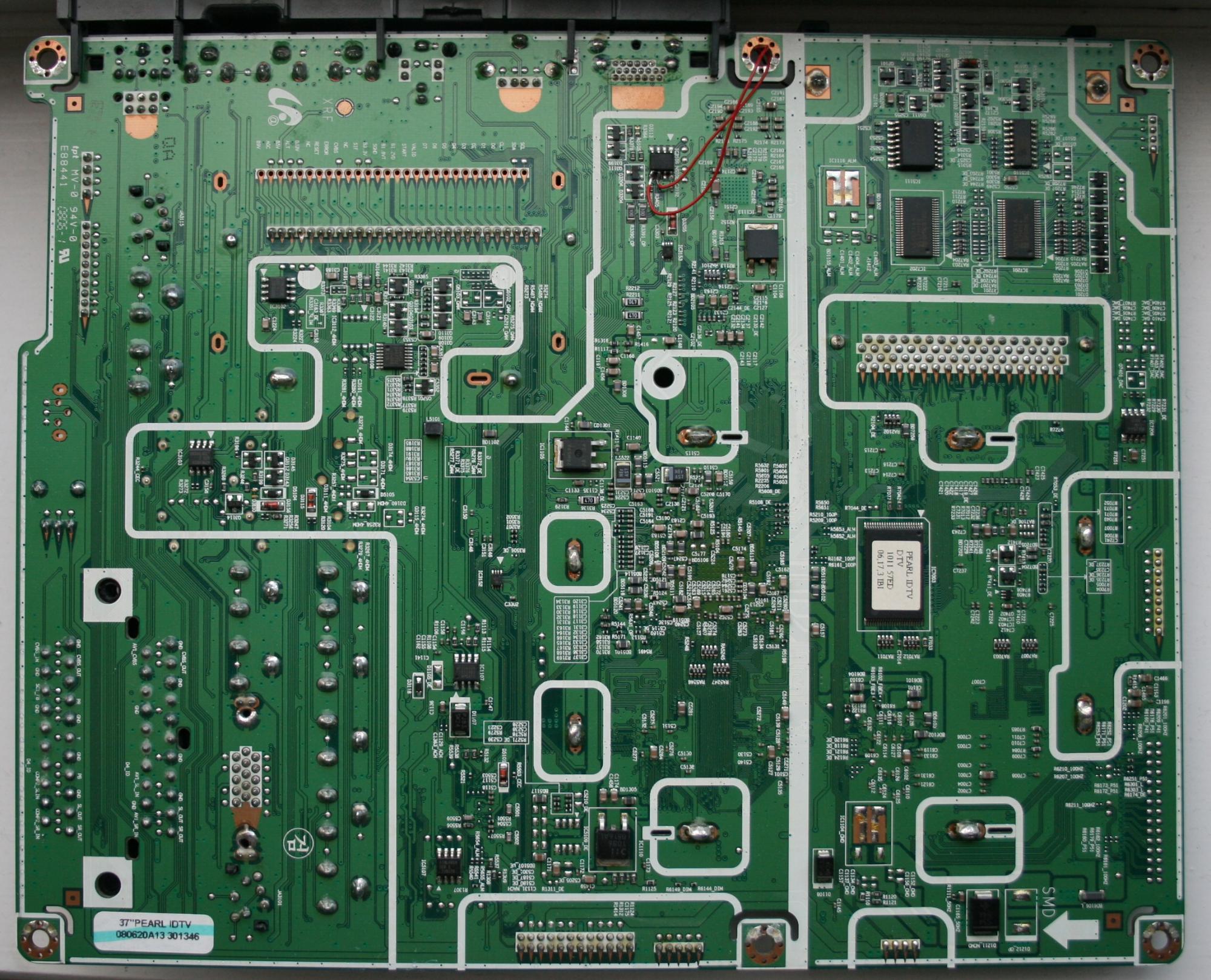

                                        Right I have taken these new pictures of the set and I have highlighted all of the EEPROMS.
                                        Hope this helps us identify which one may be causing the issue.
